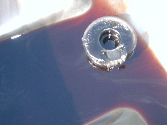

Me too, more is better. For 200k miles that pan has never been off so it will be interesting (to me) what's in the bottom.
Maybe like this?
