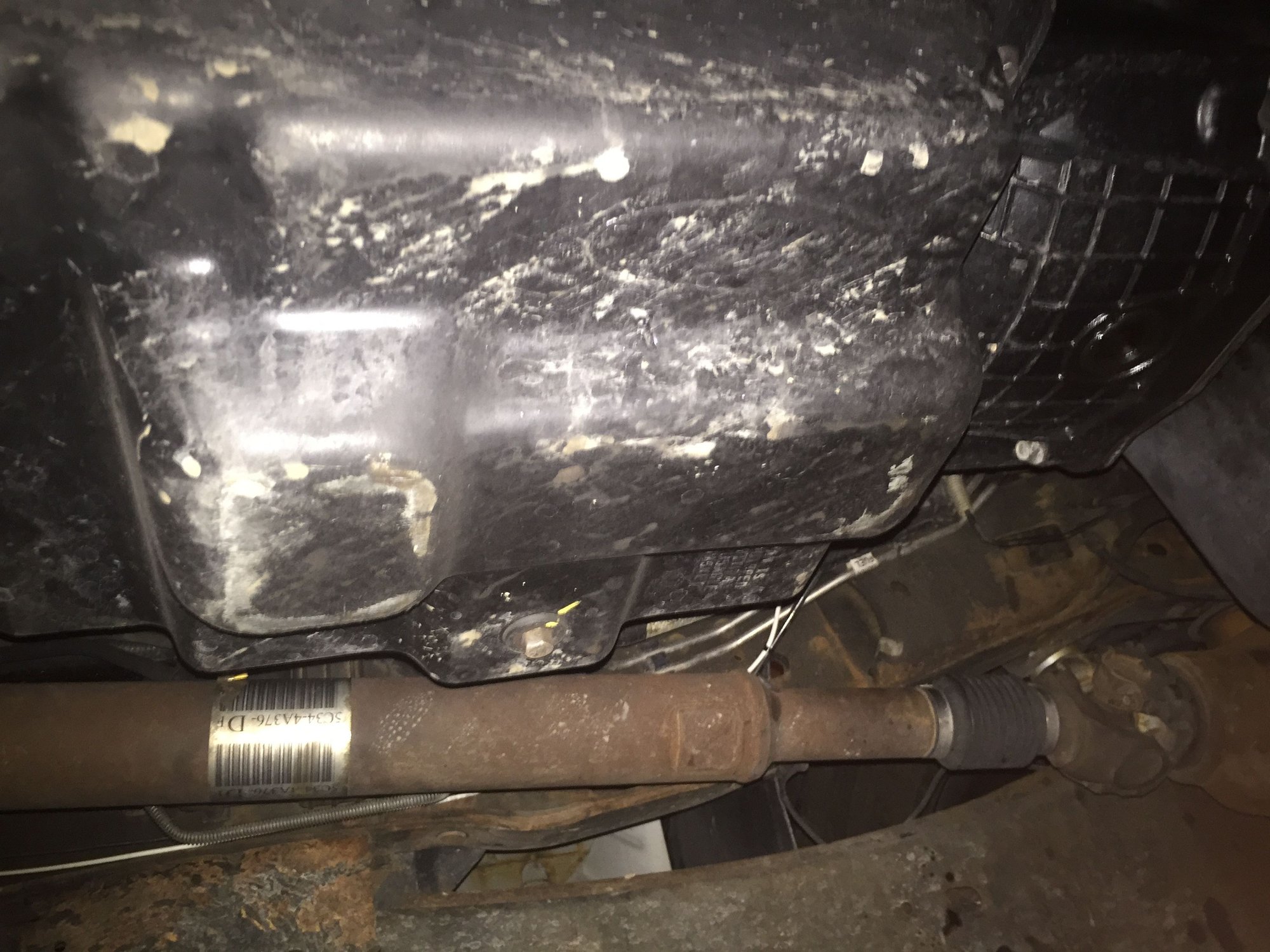

From below the truck (aka looking under the truck) do the 07 & 08 pans look the same?
You can tell the difference: the '08 stamping will have a more rectangular shaped bottom (lowest point).
Go back to the link I posted a couple times here and look at those picts and imagine the outside view and you will see what I mean...

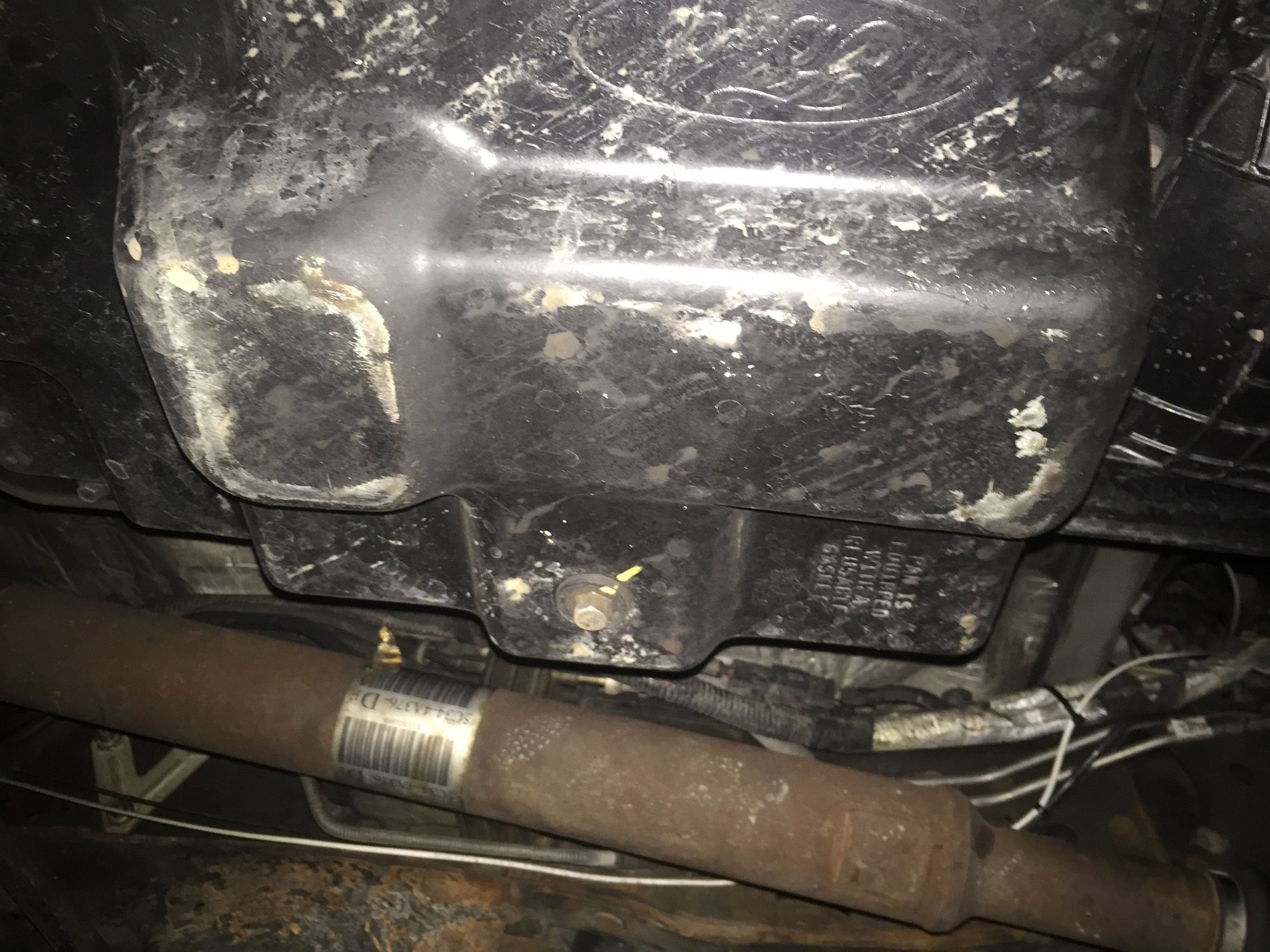

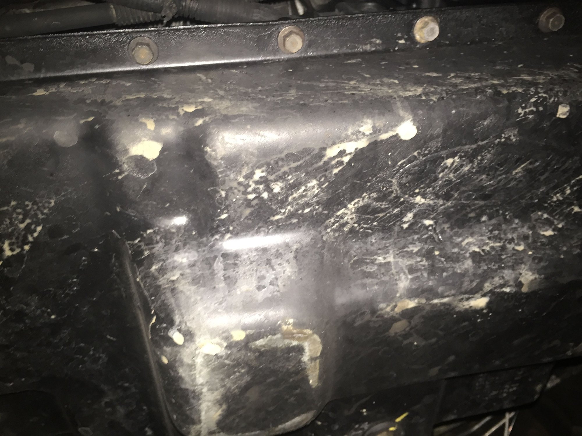

07 or 08 pan?

SniperVision: '07 or earlier...
see how the deep area narrows as it goes towards the right? Look at the pictures I posted, the early ones do that the '08+ does not...
On edit: I also noticed, when I went back and looked at the picts., the Ford logo is stamped in the sump area of the '08+ pan, versus off to the side in the earlier one...
My Ford stamp is off to the side so my Dynotech tranny pan is therefore a 07'.
