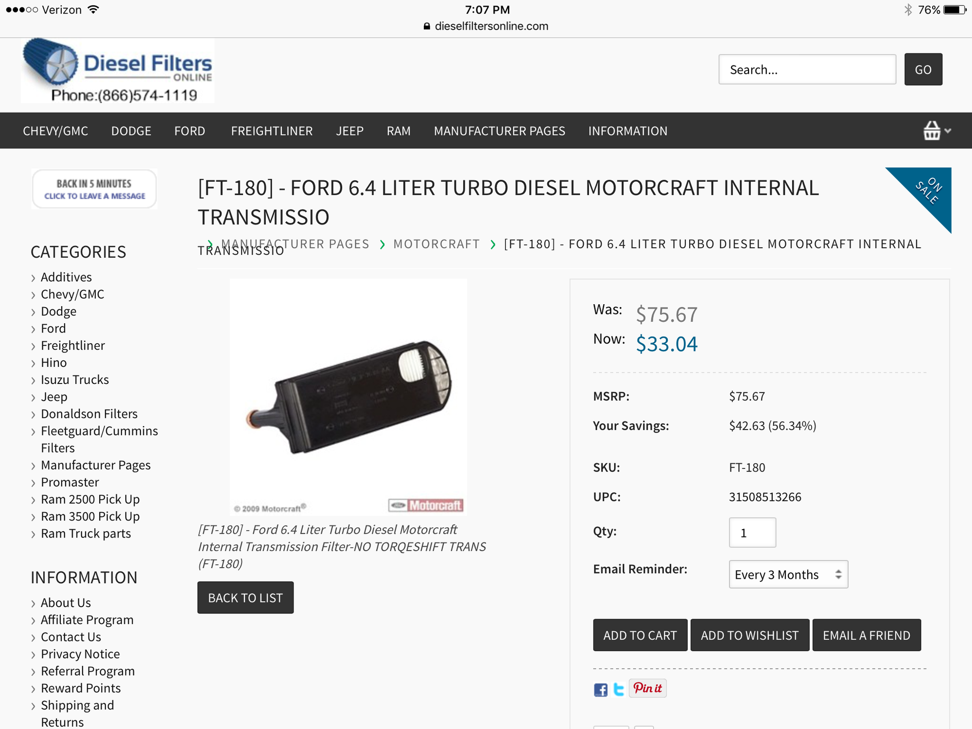

Old Aug 27, 2016 | 07:04 PM

It would appear that some research is warranted....
$33 for a filter and $93 for the pan..... or $93 and get both, not a very difficult choice.
