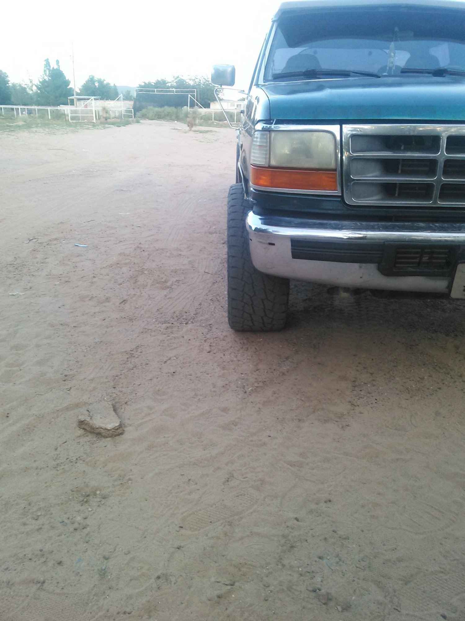

I had nothing to do so I put the big ugly wheels on the Mule just for the hell of it and here's how she looks
I hate the wheels but I love the stance, I like the width of the tire and how if fits the wheel well real good. If only Alcoa's made something that wide with a 16-17" wheel with the design of the stockers. I believe the its a 12.5" wheel. I know there are wheel options that resemble the stock wheels , but they all have the exposed lug nuts and I hate those kind of wheels, I like the sleak look of the stockers with the hub caps.
