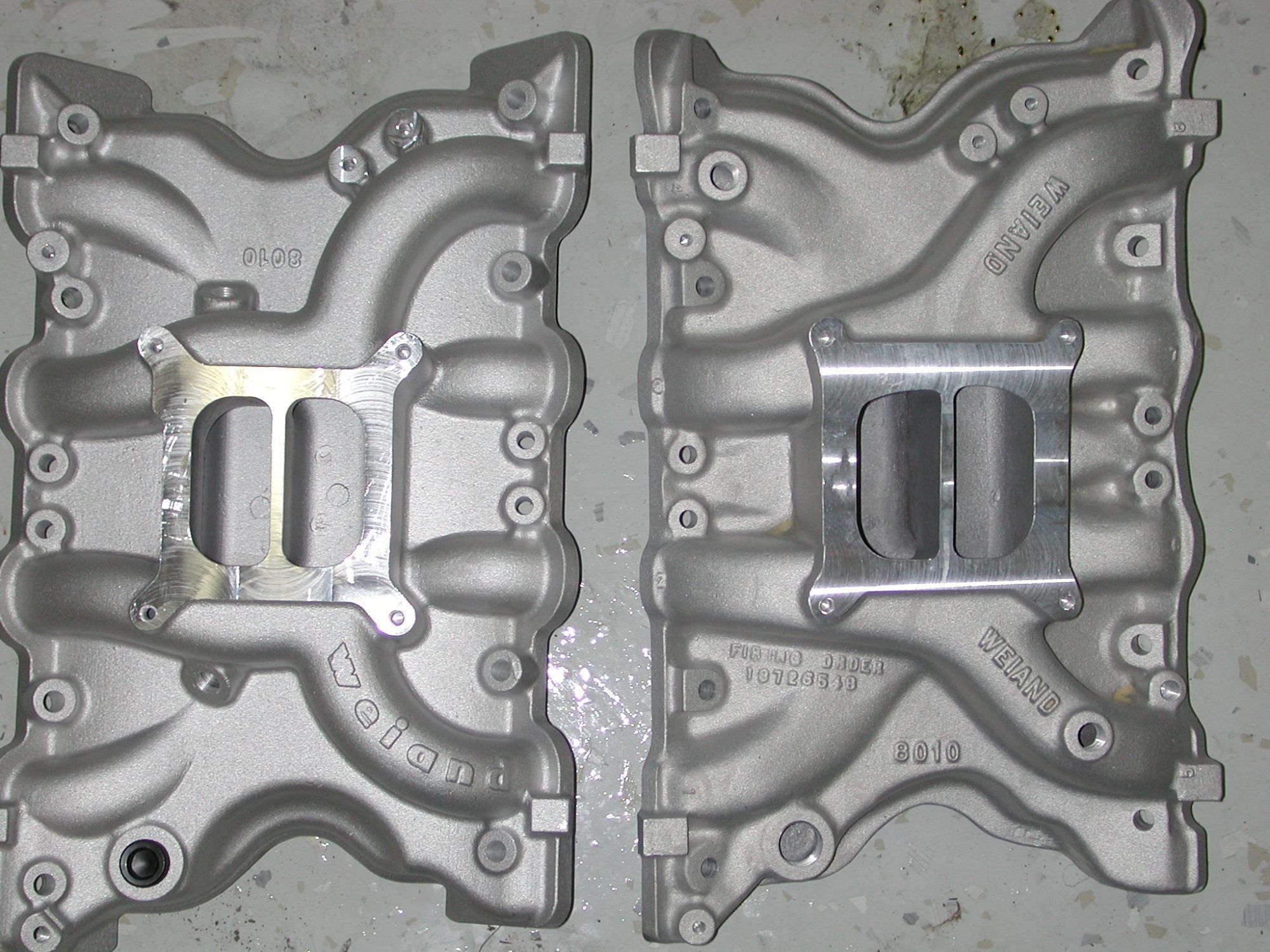

Weiand
The USA-made Weiand came in today. And, it fits! Here's a shot of the tops of the two, with the Chinese unit on the left.
And here's a shot of the Eddy (left), Chinese (middle), and US-made Weiand (right). Yuk! I'll have to retake that shot tomorrow. Sorry. And, when I do you'll see that the Chinese made unit is completely different than the US-made one. The US manifold's ports are more rectangular, closer to the Eddy's. And there is another difference - weight. The Eddy weighs 15 lbs, the Chinese Weiand weighs 17 lbs, and the US one weighs 21 lbs. You think there might be a difference somewhere????
And, continuing the discussion of powder coating and colors, I think I'm going to PC the lettering Blue and then protect it when I PC the rest of the manifold Blasted Aluminum. Thoughts?
Old Jun 25, 2014 | 08:41 PM
  #1211
Fordzilla80's Avatar
Fordzilla80
Joined: Jun 2008
Posts: 4,990
From: Florida
The US intake looks much better Gary!
Old Jun 25, 2014 | 09:14 PM
  #1212
Gary Lewis's Avatar
Gary Lewis
Joined: Jul 2010
Posts: 32,875
Likes: 48
From: Northeast, OK
I agree, Shaun.
Later today I started thinking about your work on the throttle linkage and had a fleeting thought of asking you to take measurements on your Eddy manifold from the throttle bracket mounting bosses to the carb mounting bolt holes. That was so I could compare to the Weiand. But then it dawned on me that I have an Eddy manifold and the Weiand so I can easily compare the two. I think I'll do that to see if maybe Weiand relocated the bosses.
Old Jun 25, 2014 | 09:57 PM
  #1213
Fordzilla80
Joined: Jun 2008
Posts: 4,990
From: Florida
Just taking a quick look at your pictures, I don't really think so. The thread boss closest to the driver's side of the manifold would have to be close to even with the left edge of the carburetor mounting flange for it to be different. It looks the same to me.
I feel like the location of the thread bosses on some aftermarket intake manifolds are like the mismatched coil springs you get with TTB lift kits. No attempt was ever made to verify correct application, and even after years of production the problem has never been addressed.
Old Jun 26, 2014 | 05:09 AM
  #1214
ArdWrknTrk's Avatar
ArdWrknTrk
pedant
Joined: Jan 2008
Posts: 23,576
Likes: 40
From: EXTREME southwest CT
It looks like the U.S. intake at least made an attempt to keep runner length the same.
The Chinese exhauts crossover looks massive.
At least, the bungs in the Chinese one should distribute PCV vapors to multiple cylinders though.
Old Jun 26, 2014 | 07:24 AM
  #1215
Gary Lewis's Avatar
Gary Lewis
Joined: Jul 2010
Posts: 32,875
Likes: 48
From: Northeast, OK
Shaun - You are probably right about the bosses. But I'm curious to see if they are different. And, as I think about it I might be able to figure out mathematically where the bracket needs to be. I have a factory 351HO intake, which surely has the right spacing between the bosses and the carb's bolt holes. If the 351HO took the same throttle cable as the M/400's I could compare that to the spacing on our manifolds and note the differences. However, the empirical method you used is probably the better one.
Jim - I plan to use the PCV port on the back of the carb to do an even better job of distribution. The bungs on the US-made Weiand are almost well-positioned for port injection, and wouldn't be very good even for a vacuum source. I think the plugs may be in when I PC the thing to try to hide them.
And I haven't heard from Tim on how to return the Chinese version. If no one wants it I may put it on the wall for decoration. Should be a good conversation piece.
