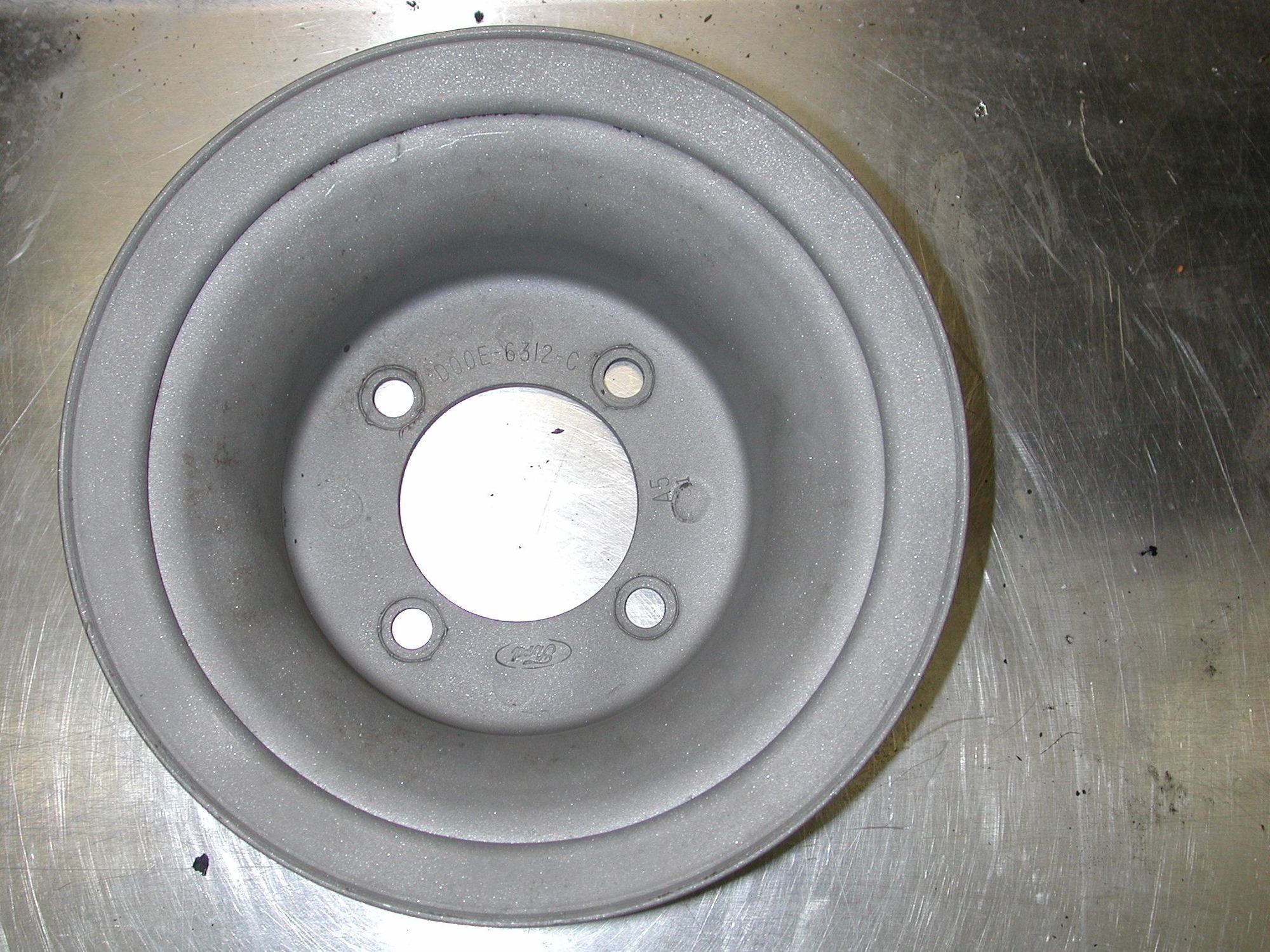

The other day Shaun was at the salvage and found a pulley from an 84 302 which has both those sheaves the same side. So, he bought it and shipped it to me. (Thanks, Shaun! ) I got the pulley in today and cleaned it up a bit, including running it through the blast cabinet. I've included some shots of it at the bottom of this post. But, I want to document things a bit in case someone else wants to do this. Here's what I found:
  • 1984 302 Crank Pulley (D00E-6312-C)

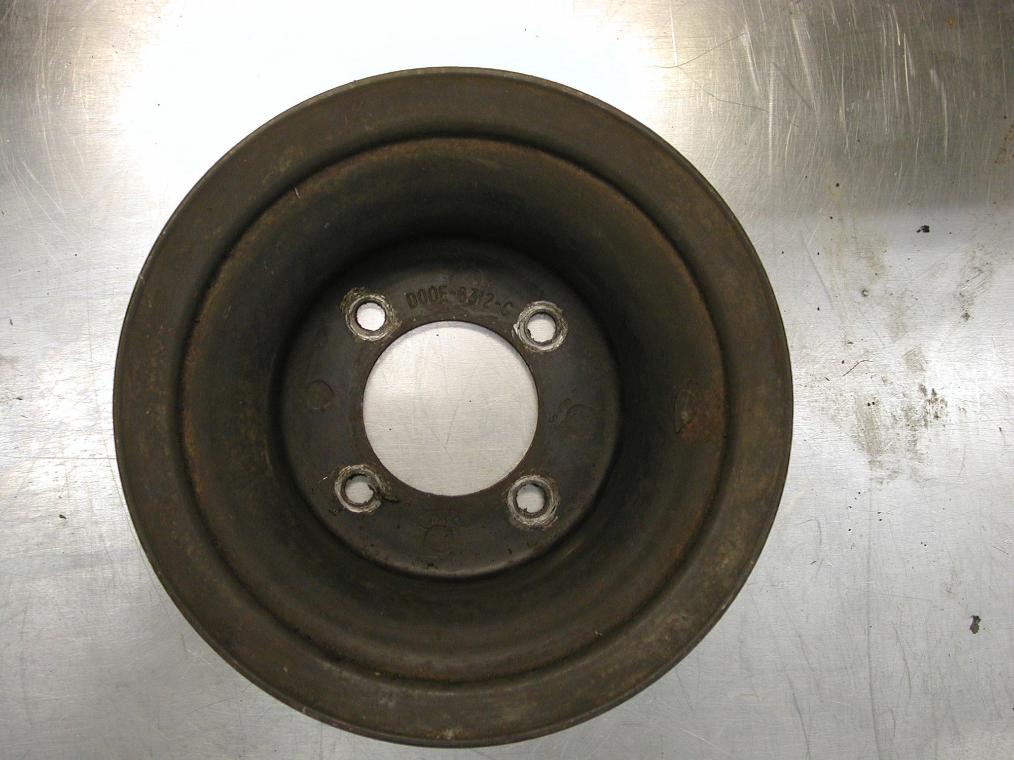

However, I'm confused about what I see in the catalog re pulleys vs what the pulleys actually say. (I bring this up since if someone is wanting to do this in the future s/he should use the number D00E-6312-C for the pulley and not those shown in the catalog.) Here's the page for the 302 pulley:
The first thing to note is that there is no pulley matching the # of the one from the 84. And, lest you think the 84's pulley has been swapped I should add that the pulley on Ray's 86 302 bears the same part #. Now, I grant you that the difference is only in the suffix, with the catalog showing a B and the pulley showing a C. Also note the catalog shows that the B pulley is a 2-sheave pulley while the C pulley is a 3-sheave. Could it be that A = 1 sheave; B = 2 sheaves; and C = 3 sheaves?

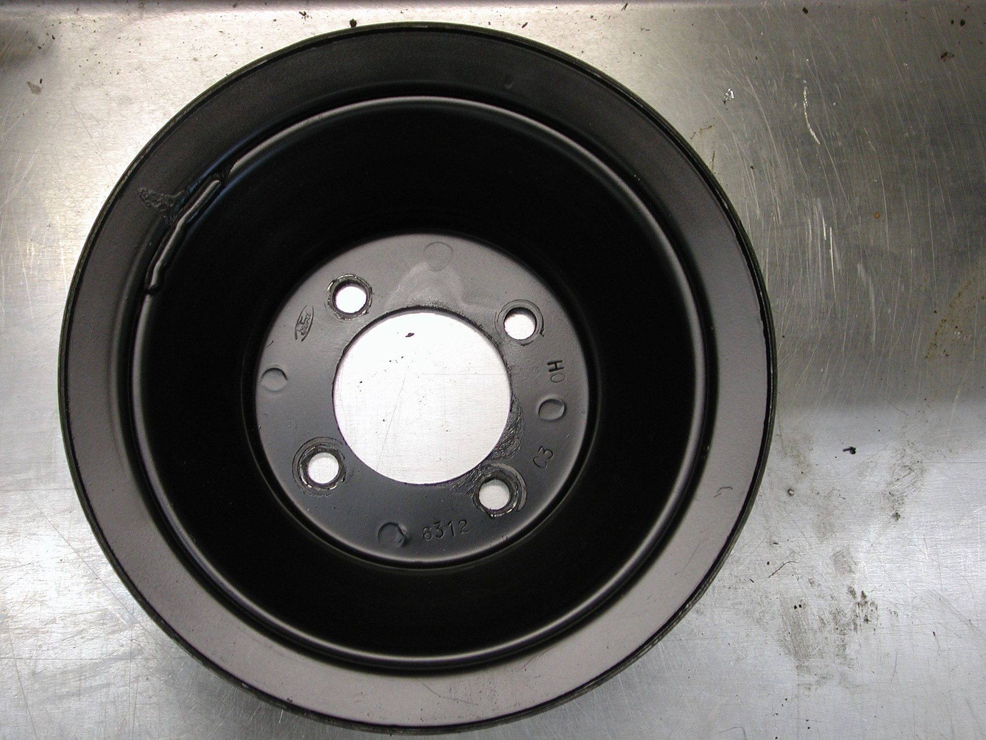

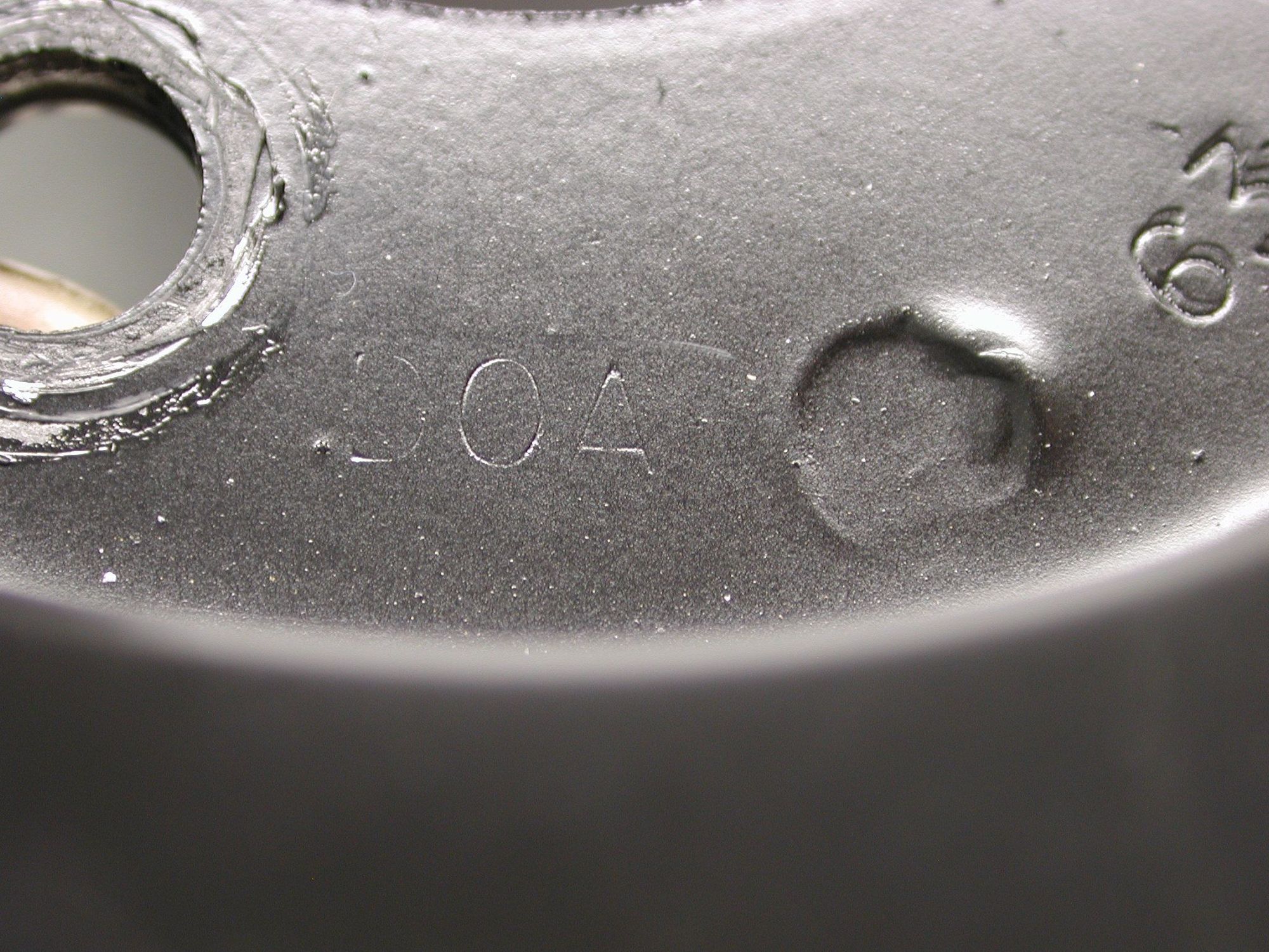

I've highlighted the # that Dad's pulley should be. But, as shown in the pic below, in reality it is D0A?-6312-C3. As you can see the 4th character is not legible. Oddly enough, the pulley on Rusty has the spot-weld at essentially the same point, but I can almost make out the 4th character as an E. Further, Rusty's pulley has the "C3" suffix. I say all of that to say I'm really confused by the parts catalog. But, I am confident that the desired pulley is a D00E-6312-C, regardless of what the catalog says.
And now for the before/after on the pulley Shaun sent as well as a couple of shots of Dad's original pulley.

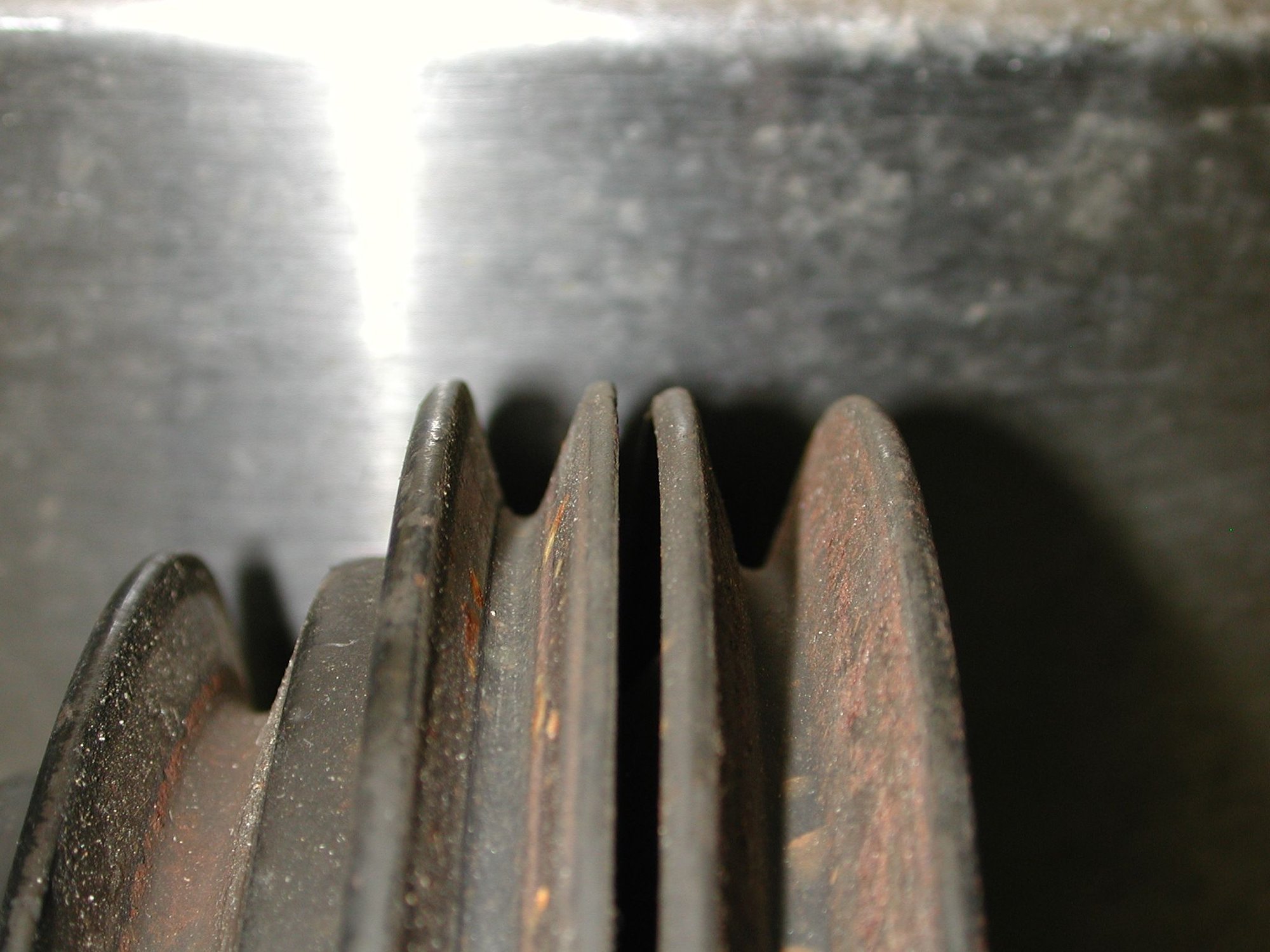

Here's Dad's original pulley:
And, here are a couple of shots of Dad's original pulley.
