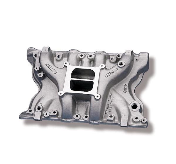

Nope...We have not seen those yet. Last Weiand intake we saw was ordered about 2 months ago.
Yes, Gary's manifold got shipped directly to him.
But just to confirm, when we move parts in and out of here, we don't open the boxes to see what the part looks like. Every once in a while we do see a miss-boxed product. Does not happen very often.
Yes, I think the old Weiand intake was better than the Edelbrock.
This is very disappointing.
I have seriously considered having a manifold cast for us. I have been considering more of a single plane since there is nothing out there. But this can changes things.
Here's what the old intake looked like.

Well, I guess that answers the question. The Weiand manifolds are now different and, IMHO, not acceptable. Tim, please advise on how I return this and what intake you recommend. My leaning is to the Eddy as I have one in almost new condition, as shown in the pics.
As for the little circles, I've taken a closer look at the head flanges and the circles wiped off. And it doesn't look like there are any impurities showing up in the casting, as I don't see any changes in color or texture.
But, I did find something I'd overlooked - see the pic. Those are tooling marks, probably made on the mill when they were machining the runner openings. I'm not a bona fide machinist, and especially not a CNC machinist (surely the Chinese use Computerized Numeric Control rather than manual machines) but I would have rejected the piece if I were doing the work or inspecting it based on those marks alone. Yes, they will probably seal with a good gasket (or gobs of blue RTV ), but that's not appropriate for a new out-of-the-box part.

Gary, I would be glad you have a good Edelbrock, I would not be surprised if a new one is now also made in China.
As was pointed out, between over regulation, unions and taxes, we are driving manufacturing out of this country. NNS foundry used to be one of the leading makers of yankee dryer shells (what paper is dried on during manufacturing). The EPA shut that down over 30 years ago so we sold the technology to a German company. Our lab metallurgist and one of the foundry supervisors ended up having to go to Germany to teach them how we did it.

Tim called and we've come to the conclusion that Critter got an old-stock, probably US-made, intake and I got one of the first of the Chinese-made manifolds. Obviously there's a serious error in manufacturing of the new ones so Weiand/Holley is going to have to either re-machine or melt down all those castings.
But, Tim says the Weiand design performs better than the Edelbrock, especially with the Trick Flow heads. So he's going to see if he can find another old-stock unit for me. And, he'll arrange for the one I have to be returned.

But, Tim called today and said he's talked to Weiand about the problem. They seemed unaware their manifolds are useless. And he's found several of them in a warehouse and has gotten their attention about the issue. They are supposed to be checking to see if any of them are the US-made ones. He needs at least two as someone else has ordered one as well as my replacement. And, he would like to stock up to ensure his customers can get them.
