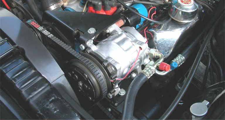

HOWEVER, there's the issue of the AC bracket. I like the compressor to be mounted low, not high like the Windsor bracket mounts it. So I want to use the bracket that came with this truck, assuming there isn't one that mounts lower. Here's a shot of the compressor I want to use mounted on one of those brackets: Well, the icons aren't working nor are the emoticons or I'd put a really frustrated face right HERE. Instead, here's the link to the pic and I'll pick it up later when things work again.
http://cimg6.ibsrv.net/gimg/www.ford...997e30db3d.jpg

Is that the bracket that came in Dad's Truck?
It is pretty unobtrusive, but I can't make out the power steering reservoir.

Jim - You really think I'd run the wire through that hole w/o a grommet?
Actually, that is a shot from Classic Auto Air's site. But that is exactly like my brackets, both the bottom one that you can see below the compressor, and the top one off to the left. So, it is no wonder you can't see the Saginaw pump.
And, I knew I could paste the tags, but figured I'd come back when they stop working on it for the night and fix it. But, thanks.
Luke - Your compressor is higher and further outboard than I want mine to be and might well interfere with the snorkel on that side. I like the way the CAA compressor sits low and closer to the center.

I knew it wasn't your truck, but didn't know if it was the exact same brackets.

The pump in the picture Jim pasted is not the same saginaw pump you have. That is the type that came on my old 70's 302's and FE block engines.
