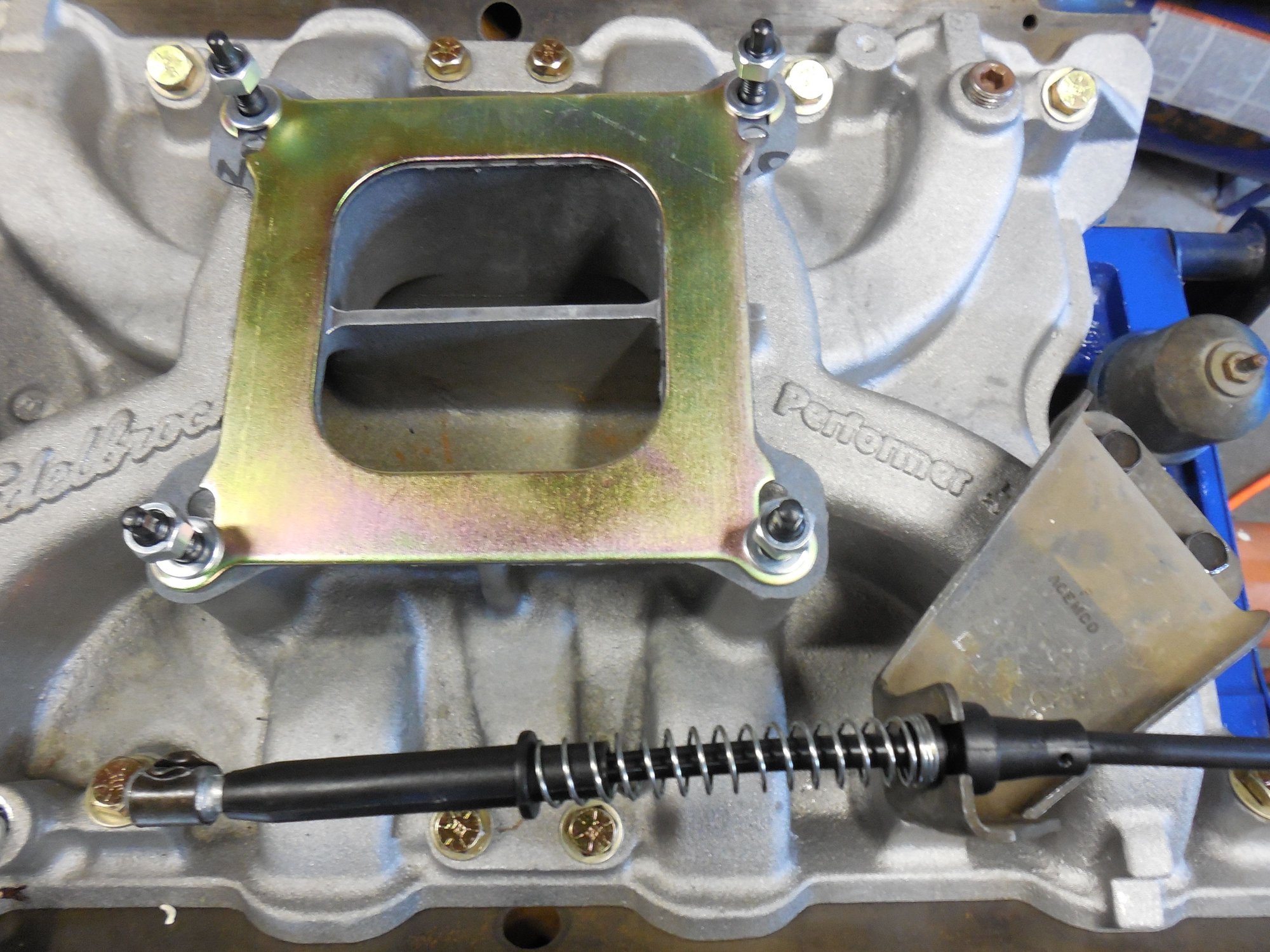

Well, Edelbrock provides a special plate that is basically the carb flange. You lay that on the intake, and then screw the studs through that. Of course it's one more leak point, but I just used the supplied gasket in between the intake and the base plate. Not sure if that's what it's meant for, but the carburetor usually comes with one too, so I'm not short a gasket.

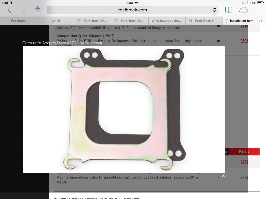

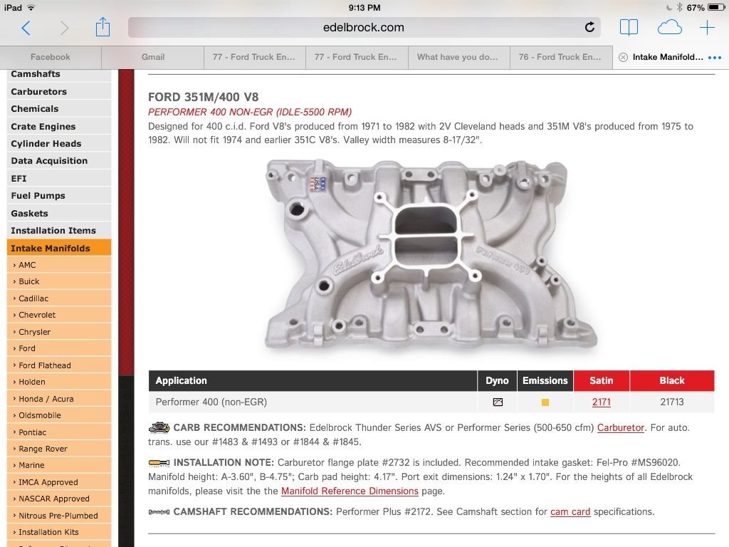

Interesting, Shaun. Neither intake I have, both of which I bought used, came with that plate. But the Edelbrock web site confirms what you said - flange plate #2732 comes with the intakes.

And, here's what the adapter plate looks like:

Hmm, that's interesting. Mine didn't come with the original box, but he did send the plate, gasket, and a vacuum tee that were all vaccum sealed against a piece of cardboard.
Here's a picture of the plate for future reference:
