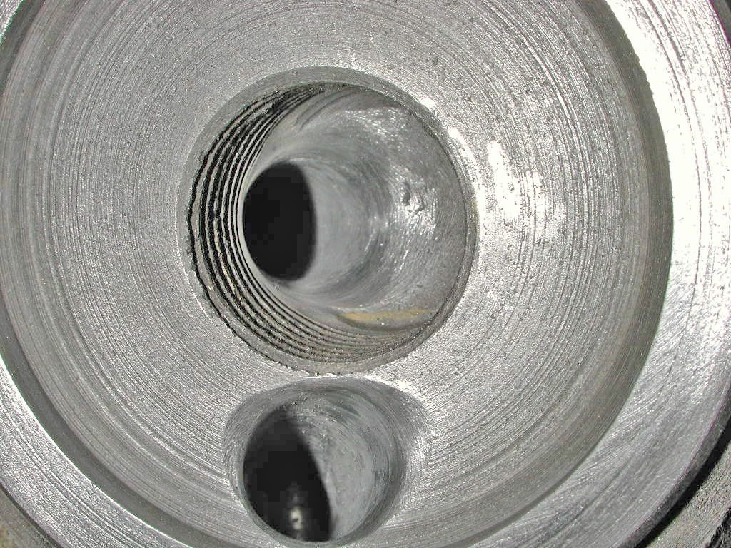

The ball-hones came in today. I'm not impressed with the quality as the .500" one is a very loose fit in a 1/2" hole. But, I did get some done with it. Here's a shot of the oil filter boss before using the hone:
And here's one after:
Not a lot of difference, but some. And down where I really wanted to make a difference, where the bore from the oil filter's discharge hits the bore across the front of the block, I spent a lot of time and think I made a difference. But, you can't see it nor feel it, so I'll have to assume that I helped it, although something is getting smoothed up as the oil ran out black. In any event, I'll go back and spend more time on it tomorrow as I want to make that sharp corner more of a curve.
