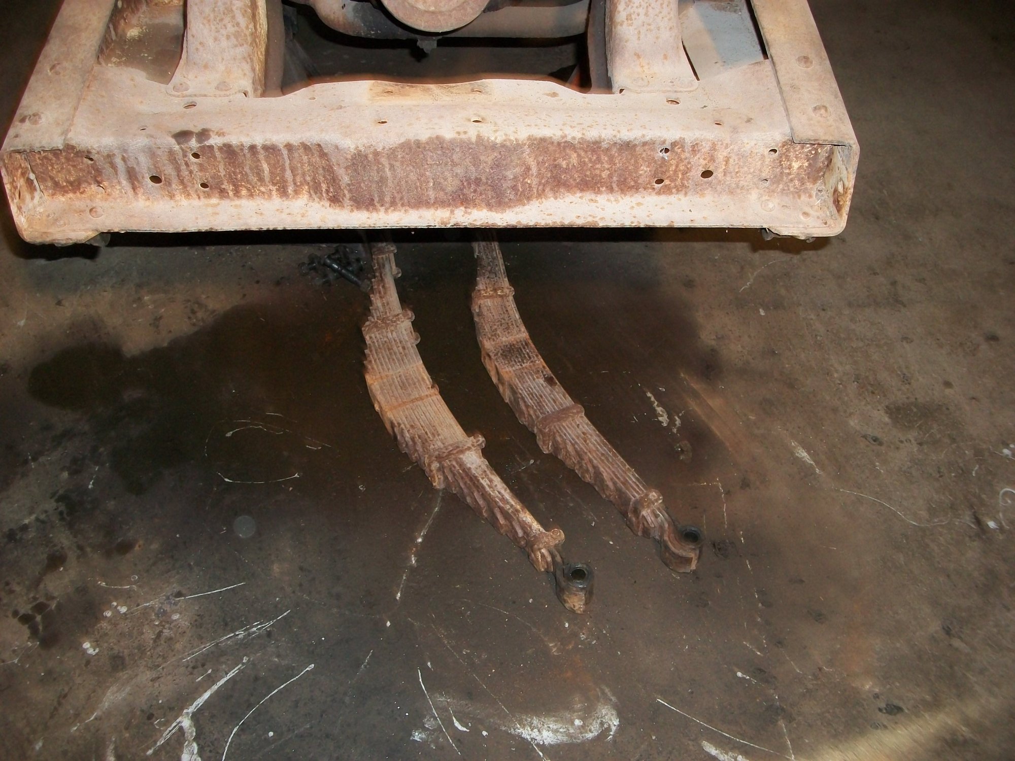

now i know why it was leaning,leafs are thicker on right side. i found it strange it had 1 extra leaf on the left, and was still leaning to the left.
Now that's a new one on me. I would think the thicker leafs are the stock ones. I wonder what the thin ones are from. Tonner? Could be almost anything. I have been known to use stock top leafs with the eyes and use whatever seems good stacked up below, like from an upside down chev station wagon in the woods.

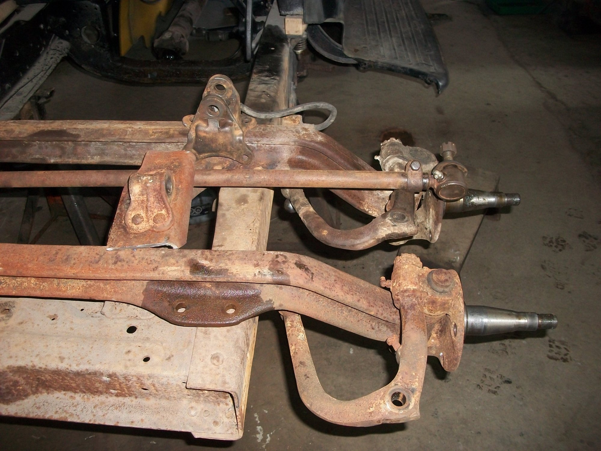

got alot of stuff done! doesn,t really show! i had bought a old frame it was a newer truck. cab supports were different axle is about 1 inch wider. i think i did good with my frame, it cost me 250 dollars delivered home. i managed to make 2 spring packs , i removed the 4 spring hangers. i replaced my drag link tube ,and used 1 tie rod. my spring shackels were done, they were good on that frame. plus the wheel bearings mine were done . and the pitman arm the ball on mine was half wore out. i might be using the axle because my king pin loose is in the axle not the bushings,1 inch shouldn,t change much! i now have spare backing plates,with brakes ,2 main leafs and a bunch of spring leafs. it had a different hydrovac system .pictures to come!

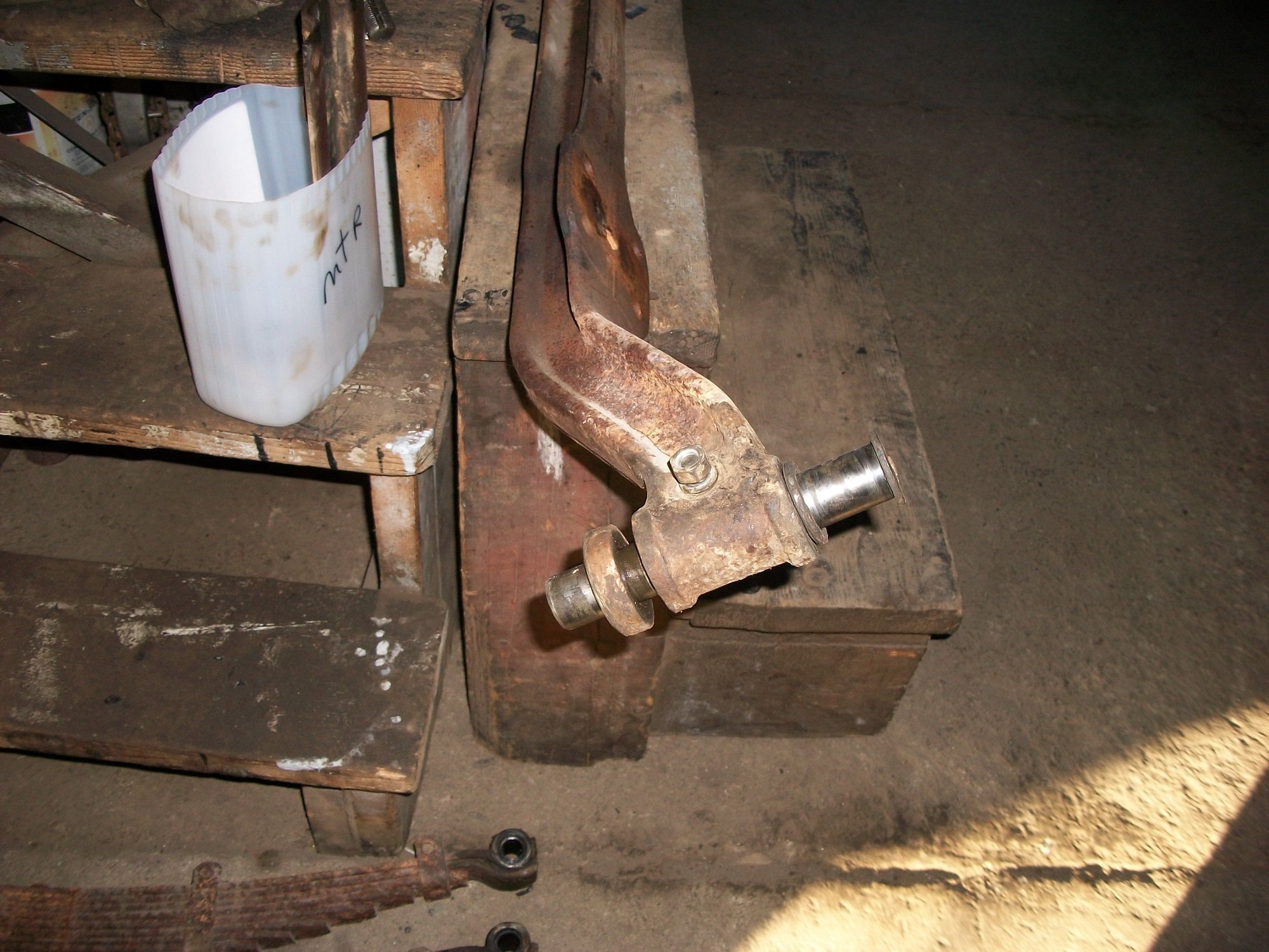

thats were i had slack in my kingpin,the bushing are tight they must of been replaced at some point. not sure yet if i will use the wider axle or get a sleeve made!
here the axle difference
my old pitman arm
my now new spring
I used front springs from a 47 1/2 ton when I built the 1/4 eliptics on the rear of my hot rod. It sat just a bit too high and dropping one leaf was too much. I had a set of front springs from a 39 IH 1/2 ton and those leaves were about 1 1/2 times as thick. Solution, drop 2 Ford leaves and add one IH leaf.
