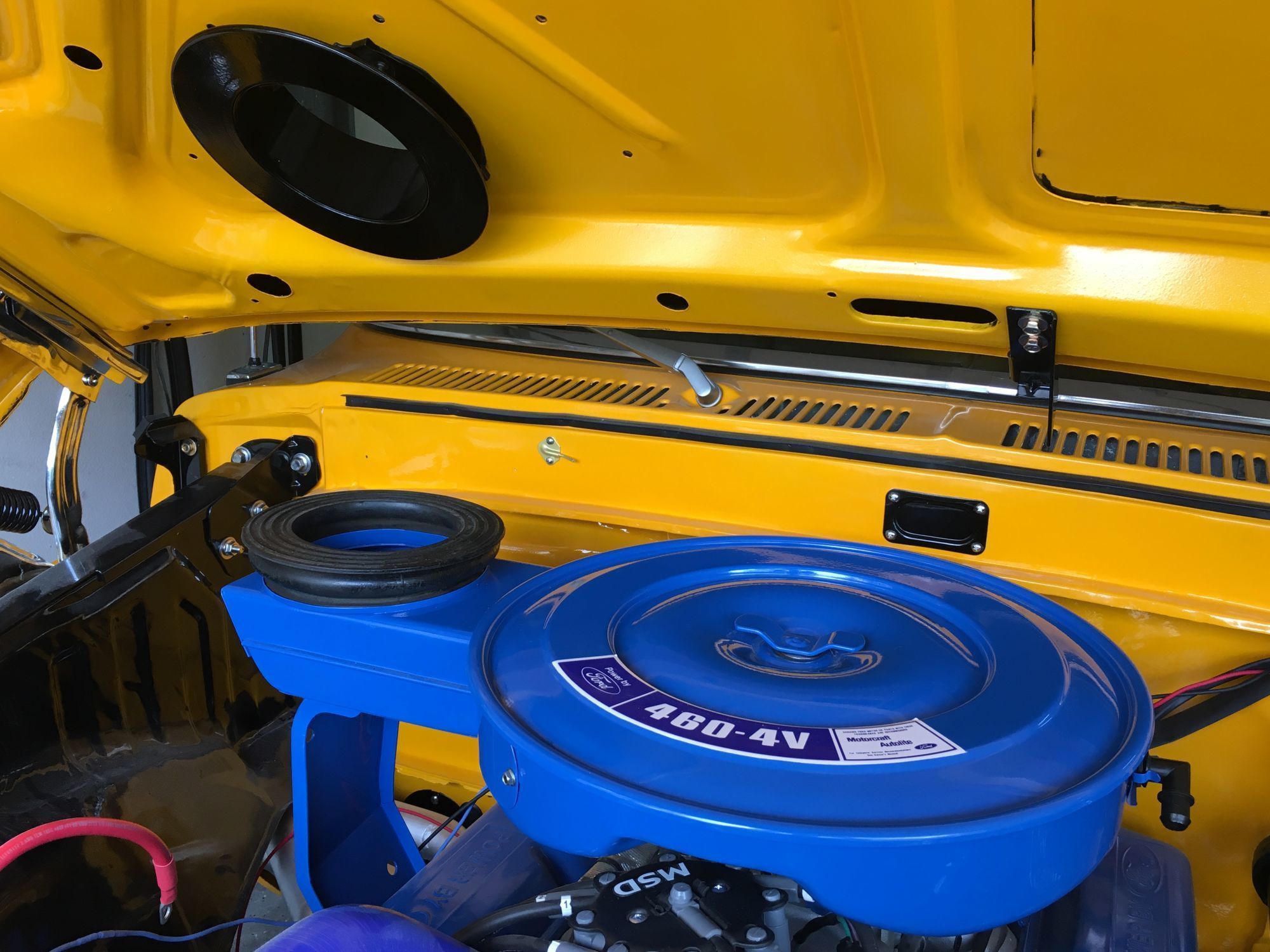

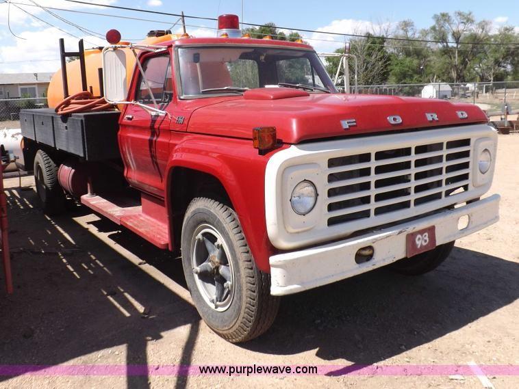

I am currently looking for the air intake system from a '74 F750 (or similar, like the pic below) from the hood scoop to the carb to install on my truck. When I explain it to the Salvage yard employees, they look at me funny. Can I get a drawing of this style intake to better help me get what I'm looking for?
This is what I'm looking to do. Got the idea from pauly3wood, a fellow FTE member.
What engine does it (or did it) have? 460's were not installed in anything larger than a F350.
