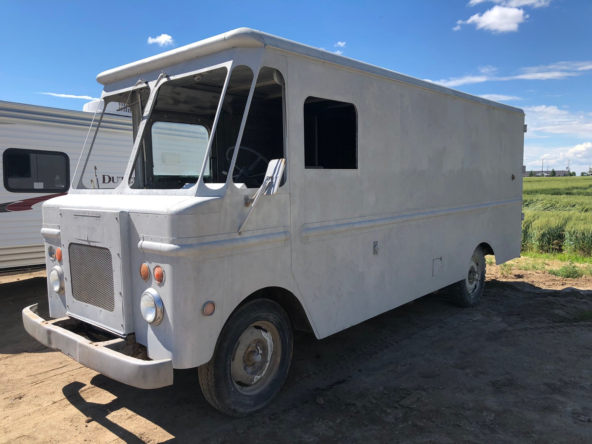

What I think is a 1965 Grumman Olson. Can’t find a vehicle ID plate anywhere. Has an in-line 6 with a 3 speed. No driver side door...all aluminum, single rear axle.
Any info would be appreciated.
VIN: P40L680712

Decode this plate?
VIN: P40L680712
can you decode this plate?
Thanks!

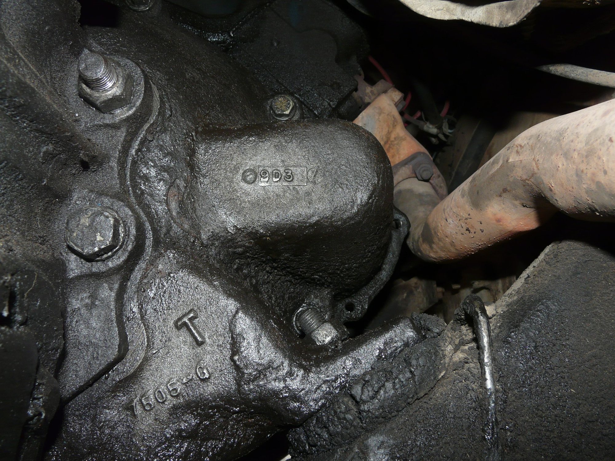

ND, You've helped me on the '61-'66 forum on my bell housing and starter problems. Another member on the FE forum thought that my bell housing may be from an MD or HD setup since it has mounts on it. If it is and you have any reference to it, Are the FE flywheels of a different diameter on MD and HD trucks than those on a car or light truck? What kind of engine mounts do they take? Mine are shot. The engine block has a "C6ME-A and 7A26" cast in it. (pic of the bell housing marks)
Thanks.
john
Not from what I see it isn't.
This appears to be marked: C5TA-7505-C = C5TZ-7505-C .. FE Bell Housing / Obsolete
1965 F100/250 4WD 352; 1965/66 F350 352; 1966 F250 4WD 352
Does the upper pic look familiar?

Thanks for the parts picture. I'm guessing that my truck should have part 6A061 on each side, for the upper support. Instead it has two of something like 6068, for the top and bottom.
