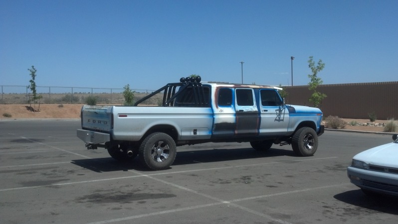

I found this one while visiting Northern AZ. I don't know if he is a member here as I didn't read this whole post. The truck is really cool and has had some nice work done to it.

That is a cool looking truck. Now it just needs paint.
