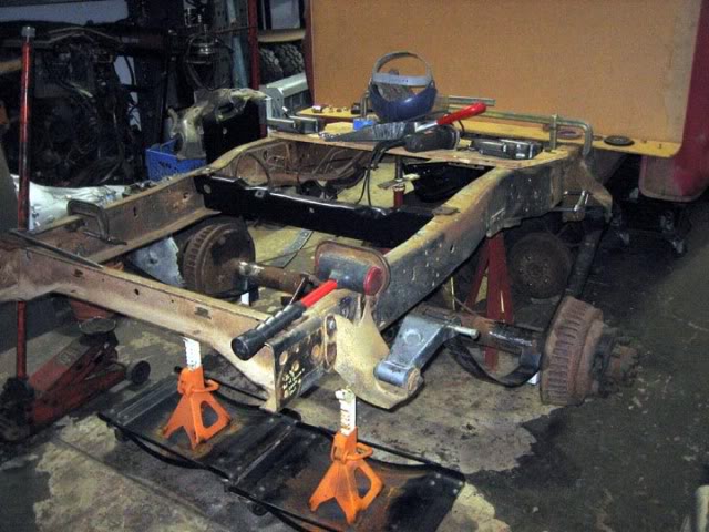

Does your rear cross member look like this?
or like this? (minus the square tube welded in the middle - as that was part of the hitch the PO WELDED in )

looks like the one with no springs
My buddy sent me the measure From rail to rail its about 28 inches
from crossmember to crossmember its 17.5 give or take an inch.
It doesnot have a crossmember at the very rear of the from, just has the bumper brackets welded on. But it does look like the 2 picture with no springs Thanks for the pictures

Originally Posted by srshll
Maybe it had an in cab tank at one point and someone changed the cab to a 79. Ya never know
This is what was thinking. Have you verified the frame VIN vs. the one of the door jamb?
See the pics above for reference otherwise. They aren't exactly what you asked for, but were all I already had loaded in photobucket.
*edit* - above post came in while I was typing again.
you sir seem to have a highboy frame under the truck. Do a search for "highboy gas tank" and you'll find lots of threads on people's ideas for this. It boils down to an SCS tank, a weird tank out of a cab & chassis 80's/90's (not 100% sure) truck or a custom tank - IF you need it to go in the rear behind the axle.

Let me re-phrase. "You seem to have a highboy width frame".
As I said in the post above I thought the only 2wd with the narrow frame were the SCS's but I very well could be wrong. The 28" your buddy measured is the inside dimension of a 34" outside frame width (I know this offhand as I am currently making a custom rear tank for my truck - which is why I have the pics above). That is the same as my '74, 4wd crew cab in the 2nd & 3rd pic I posted above.
