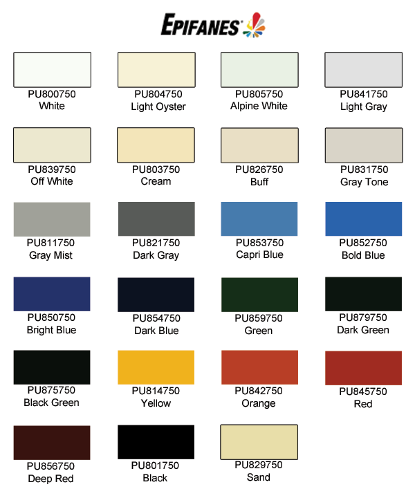

IIRC I ordered Capri Blue

Fancy, @SkySkiJason might approve!
