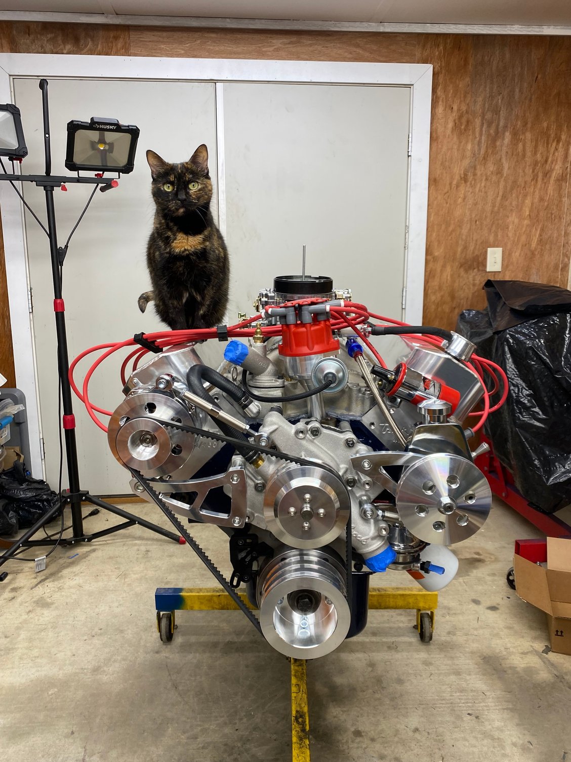

If must not of been to much of a hoot, I did not get a disco ball video at 03 hundred this AM...... with Free Bird playing in the background. Your initial pre start up tune needs to be Jimmy Hendrix playing the anitham.... at least the 1st few rifs.
Here ya go, Rich. Now you've got disco *****.
Edit: Just for continuity purposes, the pic does show some new work on the engine. If you look really hard, you can see the stainless steel bracket I made for the dipstick tube.

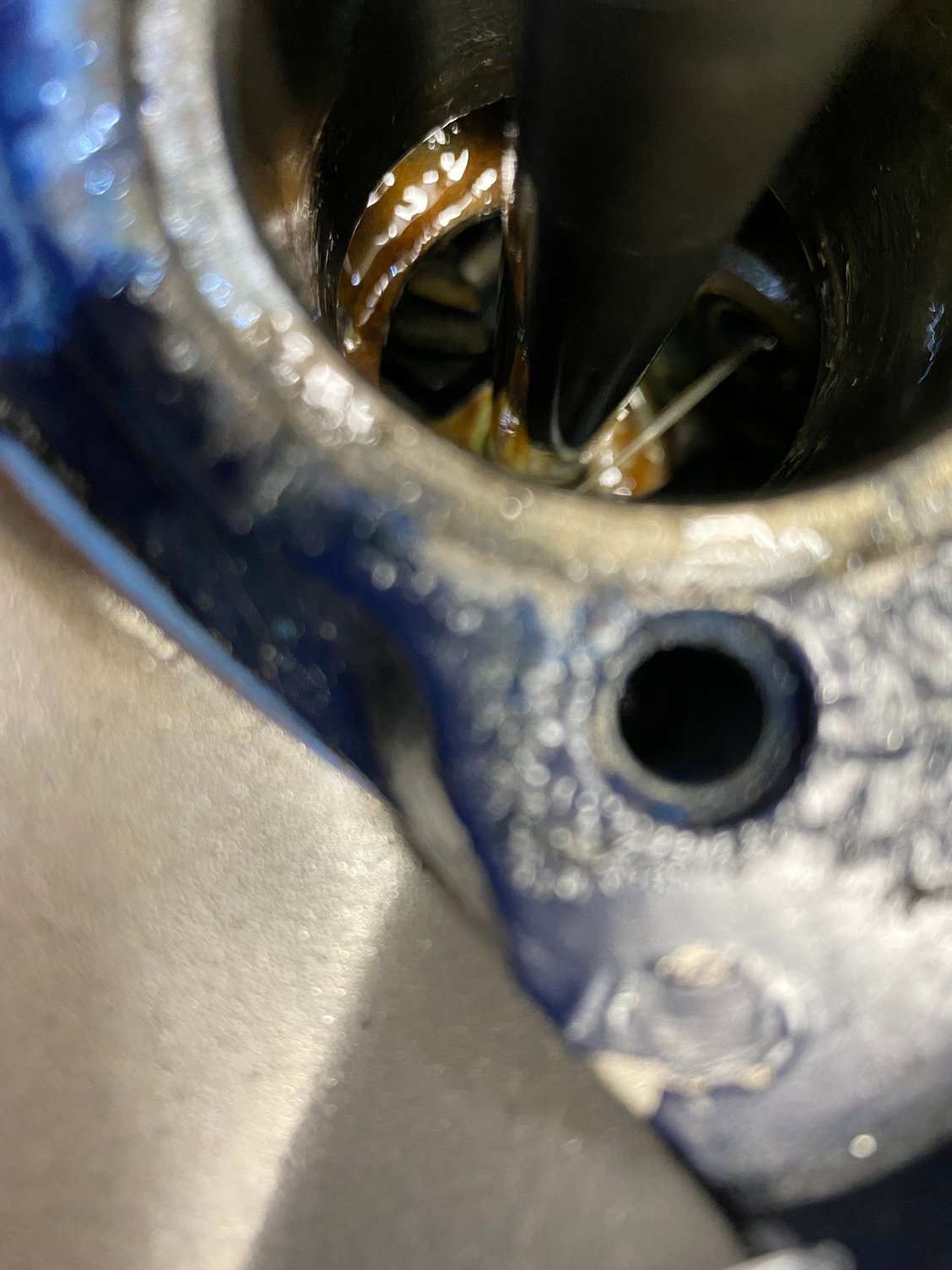

I filled the pan with break-in oil, then used my gutted distributor / pre-luber with a cordless drill. It made 90 psi, and all the pushrods were oiling their rocker arms. I slowly rotated the crankshaft about 20 rotations, and didn't see any dead spots on the oil pressure gauge. Happy, happy!
Then I pulled the distributor body, and just used the shaft to turn the oil pump shaft, so I could see how well my oiling modification works. I couldn't be happier. The second pic shows down the distributor hole, without the shaft turning. Third one is with shaft turning, and you can see the steady stream of oil that's squirting directly where the distributor gear will be. Yippee!

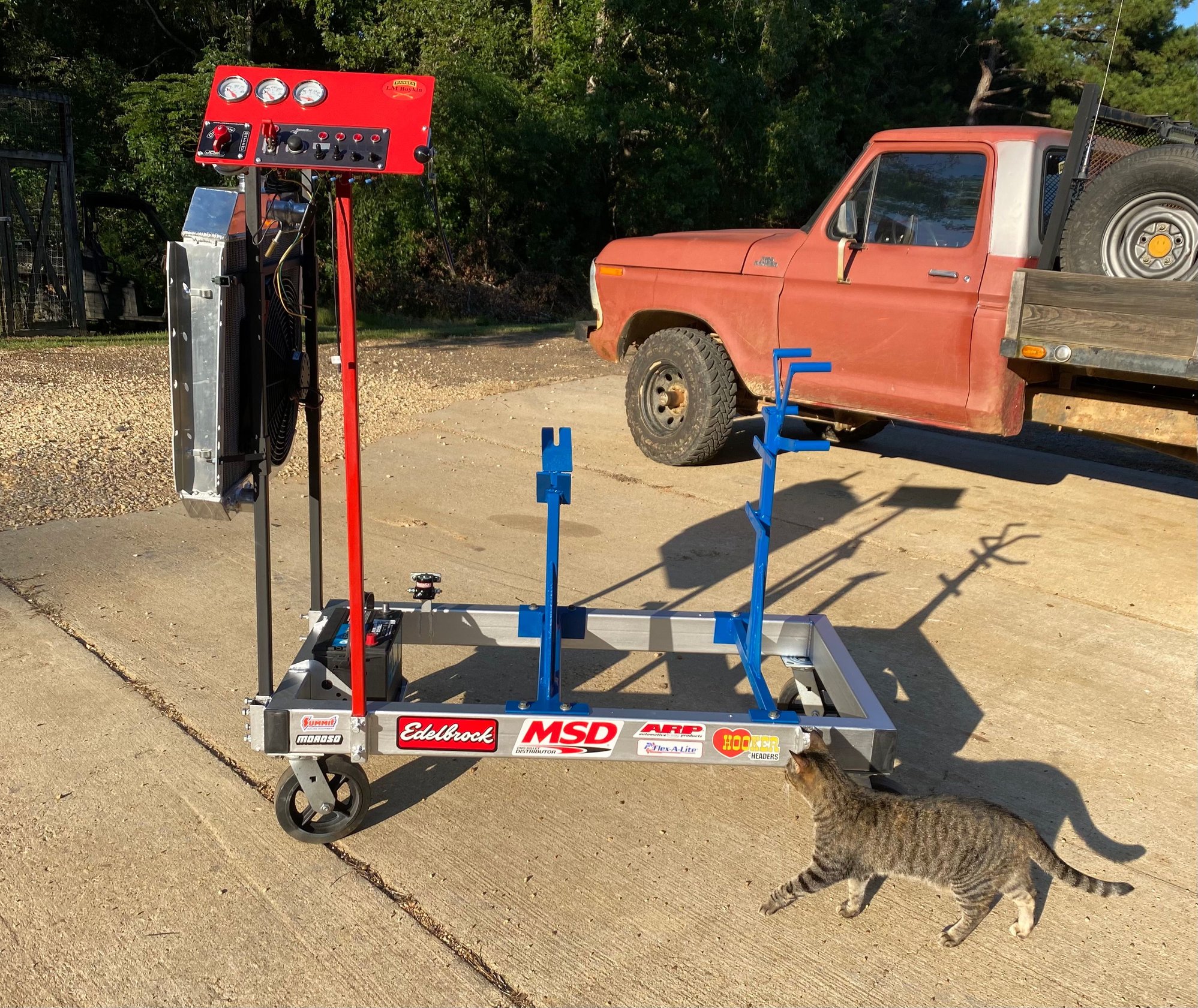

Engine is ready to run. I finished welding solenoid bracket and couple more inserts on the test stand base. Painted it this morning. Gotta make the lower brackets for the radiator, and wire the stand, then I should be good to mount the engine.

Only thing left to do is a bracket for the MSD box, and then wire it up. That's Scrappy's sister, Baby doing the inspection. She picked out the decals.

That is the 1st 500 horsepower engine stand (even before you have a engine mounted to it) that I have seen.
I was gonna put flames and pinstriping on it, but I was told those casters couldn't handle that much torque.
