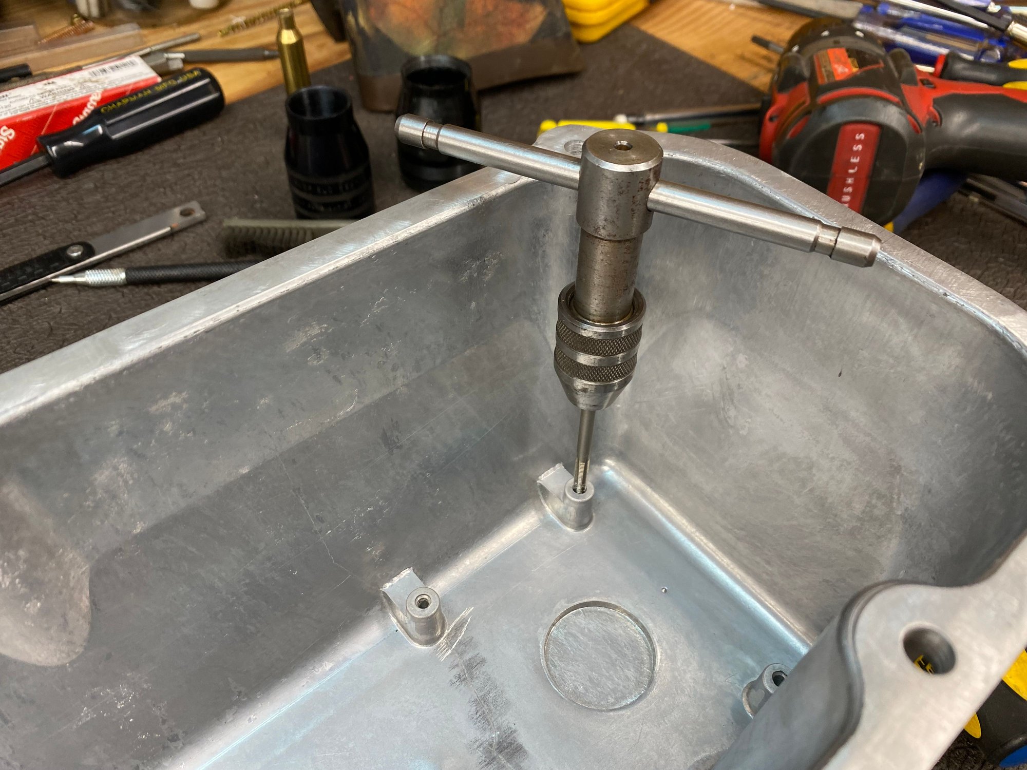

After four sets of gaskets, I finally threw in the towel on those fabricated aluminum valve covers. Their misaligned flanges split every gasket.
I replaced them with Ford Racing valve covers, and they're really nice. They look good, and the flanges match gaskets and cylinder head perfectly. There are two drawbacks to them, but were easily remedied. One corner hole on each valve cover is so close to the vertical part of the valve cover, that you cannot use a standard hex or 12 pt bolt. I read where some guys ground reliefs in the valve cover, but I opted for small headed bolts. And the baffle plates come with some really janky chinese self threading screws. I can see those breaking or coming loose, then destroying the engine. So I drilled and tapped the bosses to 8x40, and used quality fillister head scope base screws with red thread locker.
Another cool feature, the valve covers come with two extra baffle plates, and each valve cover has relief for opening up another breather or filler cap hole. I drilled and tapped the extra baffle bosses, and may install a dedicated filler cap later.
