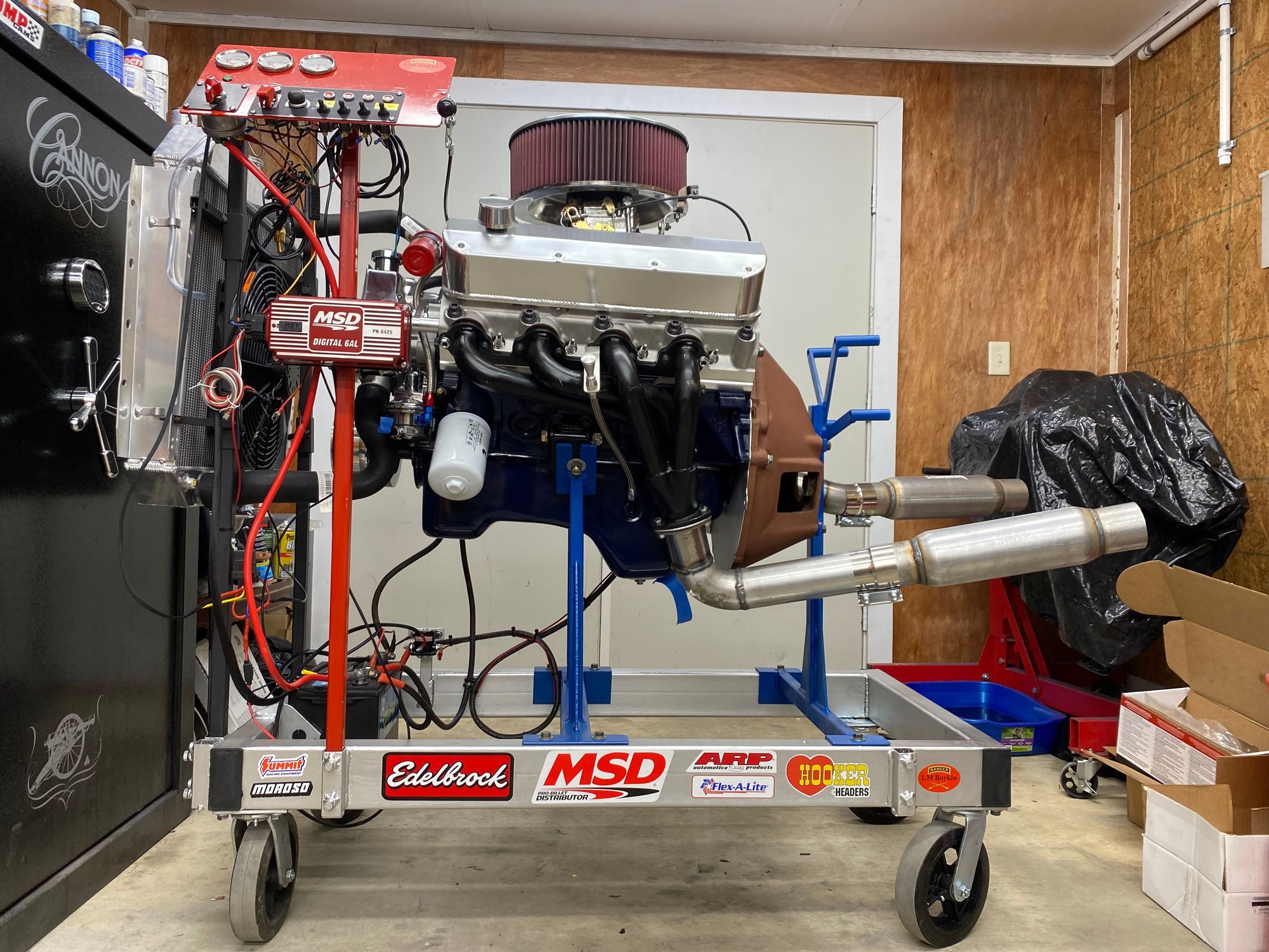

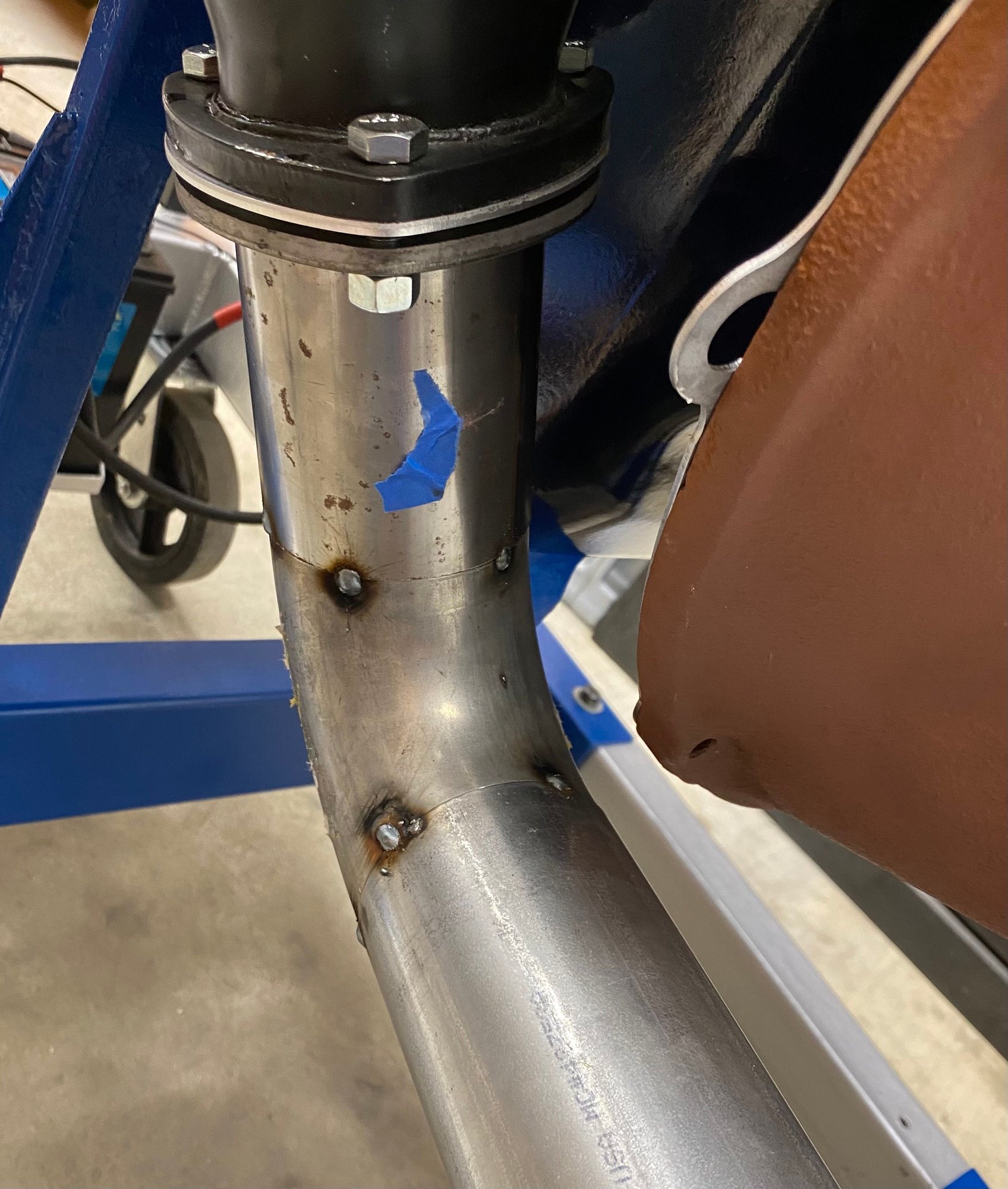

Got the exhaust pipes welded up and glass packs installed.

I got it. I did consider routing the pipes a few different ways. It would have given me some useful experience at exhaust system building, which would come in handy since I'll have to make custom exhaust for the truck. But for expedience and money sake, I opted to just run it short. I can back the stand up to the double doors, and blast the exhaust outside. But for the first fire up I'll move the entire thing outside. Don't want any unforeseen fuel leaks burning down my shop! I've been fretting a bit about how to get it outside, then back inside. The shop wasn't built with a ramped entry. And there's a threshold at the double door. So, I'll have to build a small ramp for the inside and a big ramp for the outside, or just pick up the whole works with the forks on the tractor. I'll probably go the tractor route.
