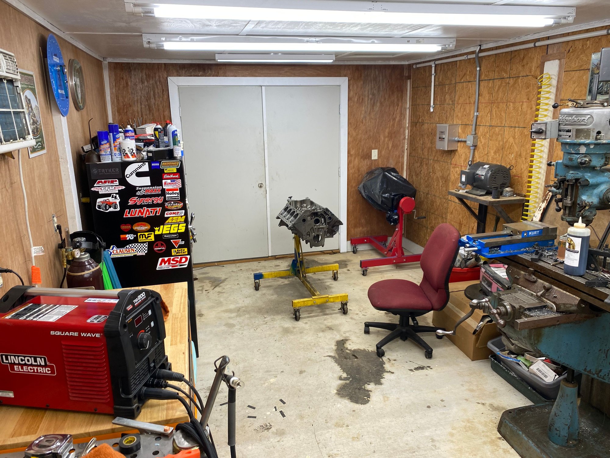

I picked up the block today from Diamond Racing Engines in Hammond, LA. Shot blasted, bored, honed, square decked, line honed, cam bearings & freeze plugs installed. It looks great. We've been getting rain every day, so I took the Jeep to keep the block dry. As soon as I got home, I got the block brushed out, rinsed, dried, oiled, and on the stand in the shop. I'll paint it later this week.

Now I see what Scrappy does with the stickers Great news on the block. Looking good. If you wouldn't mind could you break down the machine work with individual prices.
Nice Bridgeport I'd love to add one to my shop some day.

Yep, Scrappy's shop safe is high horsepower and very accurate. That Bridgeport is old and a little rough, but it's still tight and accurate. Best part about it is that the PO put a single phase motor on it. I do have a phase converter, which you can see, but it's kinda loud and wouldn't be much fun working right next to it. Converter is wired to the lathe in the next room.
Total was $1460. Clean, inspect, blast $200. Square deck $200. Bore cylinders $250. CNC hone with torque plates $400. Camshaft bearings installed $125. Complete plug kit (freeze plugs installed) $35. Line hone mains $250.
