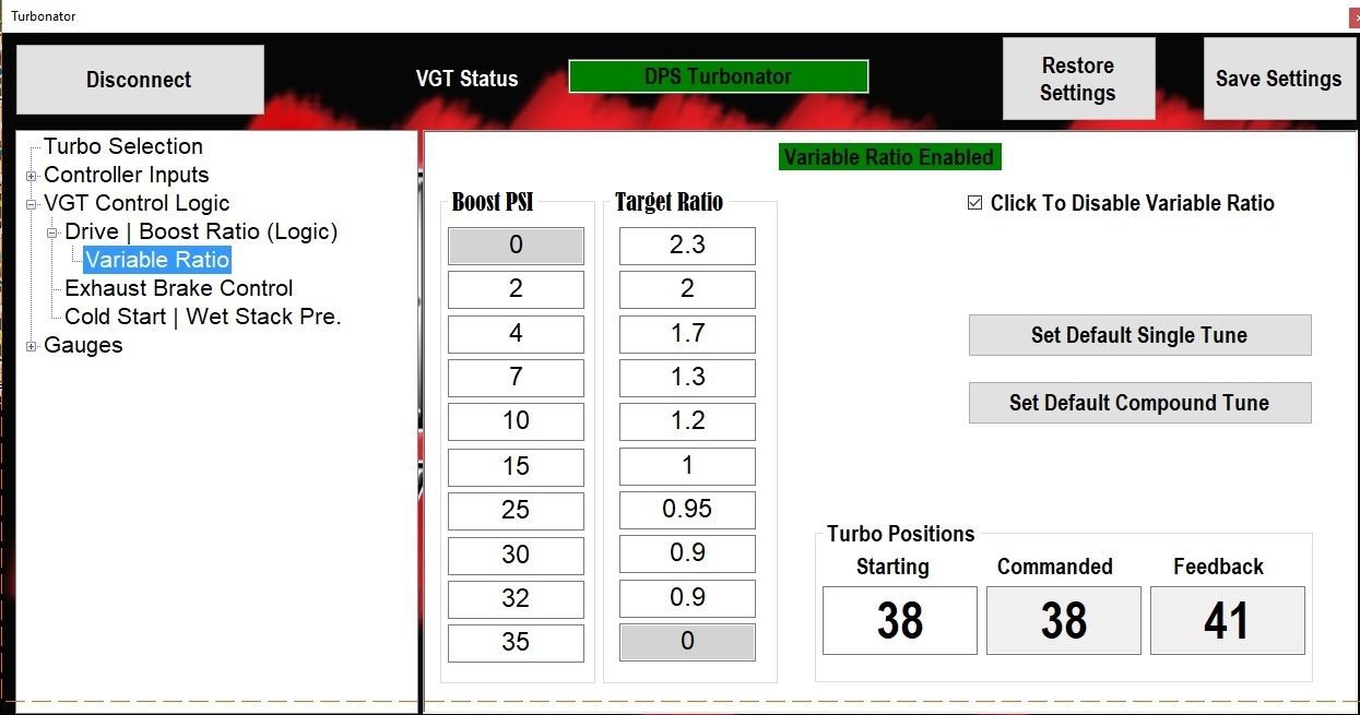

I went data-logging today.
Laptop in passenger seat logging FORScan and screen recording DPS Turbonator s/w, iPhone normally on the end of that arm thing if not tking this ****ty panaorama, action cam on window recording gauges.
Tweaked the Turbonator's settings to lower boost.

Do you know what vane % is equal to what "turbine housing AR specs". Remember seeing on their site its something like .55AR-1.20AR (IIRC) range. Random example; 33% open is similar/equal to a .91ar standard housing.
I asked DPS that exact same question and they said "that's not how a VGT works." Their marketing copy says "Performs like a .50 a/r housing up to a 1.1 a/r turbine housing." A/R ratio is just shorthand for mass flow vs expansion ratio, which is what really matters in turbine performance. What complicates matters is the controller readout is of ACTUATOR position, not vane position. What the actual vane position is depends on the geometry of the linkage from the actuator to the unison ring operating lever and is probably non-linear. I'm guessing the actuator travel is slightly less than vane travel by design so the actuator doesn't over-actuate the vane mechanism. I think that's why their actuator calibration procedure says to activate the exhaust brake function (i.e. actuator at 0% position) and then gently lever the actuator outwards away from the scroll so the vanes are at their 0% open position. At least we know 0% actuator = 0% vane in that respect. I will try to mount a camera to catch the entire mechanism in action as I drive.
