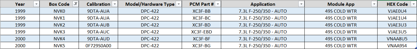

Sous I’m confused. The information you shared gives a tie in between original hex code and strategy. But it does not show cross compatibility. The Hydra and FU burner will give a “recommended” strategy based on the hex code. These do not match up with the original strategy. Various strategies will work with a hex code.
Your right, the spreadsheet does not show cross compatibility and is a draft document as it stands. I was attempting to help identify additional Box or Hex codes for use while looking up information in the Titan Unlock interface in relation to the known Box and Hex codes.

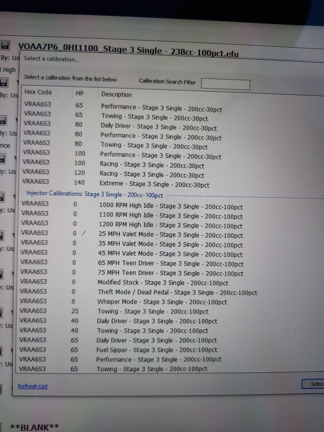

Originally Posted by lpzd
Entering Nvk4 , php prompted me to use vnaaas3 no tunes for that came up in modified injector tunes, not sure if there is a different strategy that would work instead.
Originally Posted by Bonanza35
Wonder if Cody is on here, he would know. I believe he worked for PHP at one point. I think it is DP tunes also. What was your boost? i didn't see that gauge.
That’s strange. Dad’s is NVK5 and when I did his burn years ago with the PHP FU burner it recommended VRAA6S3, same as my PMT2.
So just now I checked in the Hydraflash software and see both NVK4&5 call for VRAAAS3. I’m thinking the VRAA6S3 would also work. I’m almost certain this is the strategy I used on his NVK5 truck.
I'll hook it back up using that strategy

The information below is from a "draft" spreadsheet that I and a couple of other FTE'rs are working on in creating a thread. So, it may not be 100% accurate, but should be pretty close. In addition, I don't think the PHP Titan Unlock allows for modified automatic transmissions and FTN has a BTS 4R100.
This is what I have listed as possible Hex Codes for the NVKX Box Code.
This is what I have for the VNAAAS3 Hex Code.
This is what I have for the VNAA6S3 Hex Code.

Hoo boy. you Hydra guys have got my head spinning. Coming from an F5 where one knows not of hex codes and the like, I only have the faintest clue what you're talking about.
