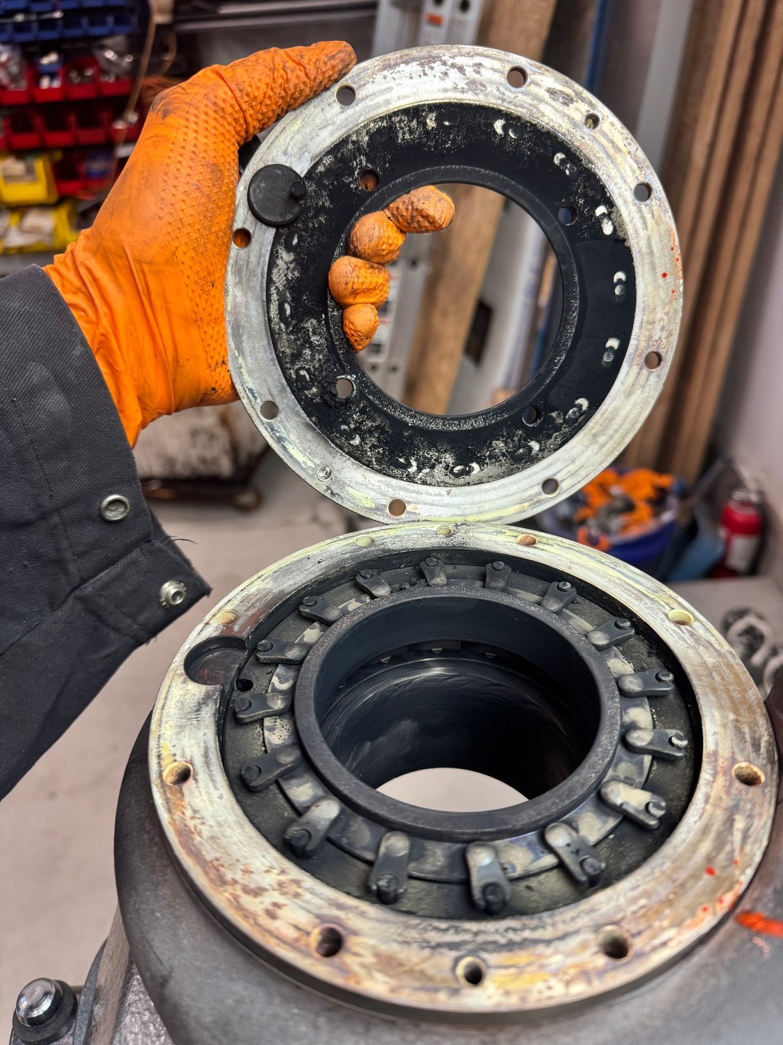

After being left alone in the truck since 2022, the VGT is startting to show signs of sticking with random EBP surges. Time to perform some maintenance.

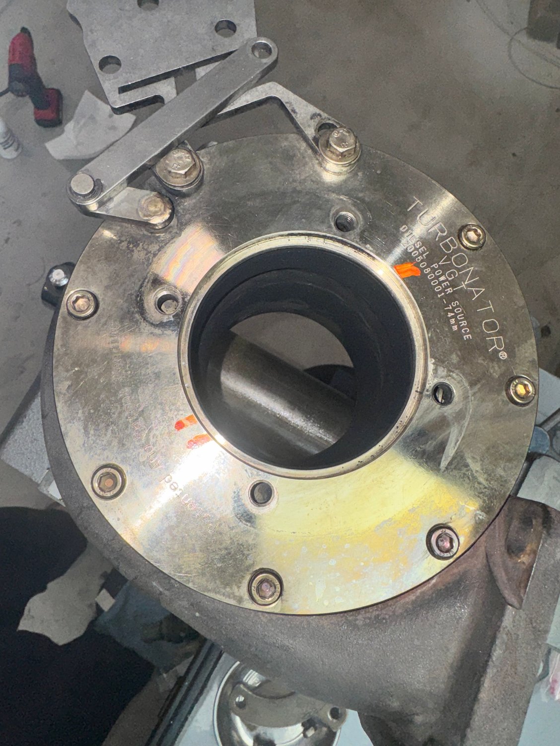

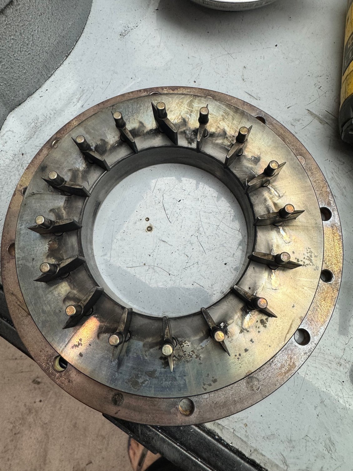

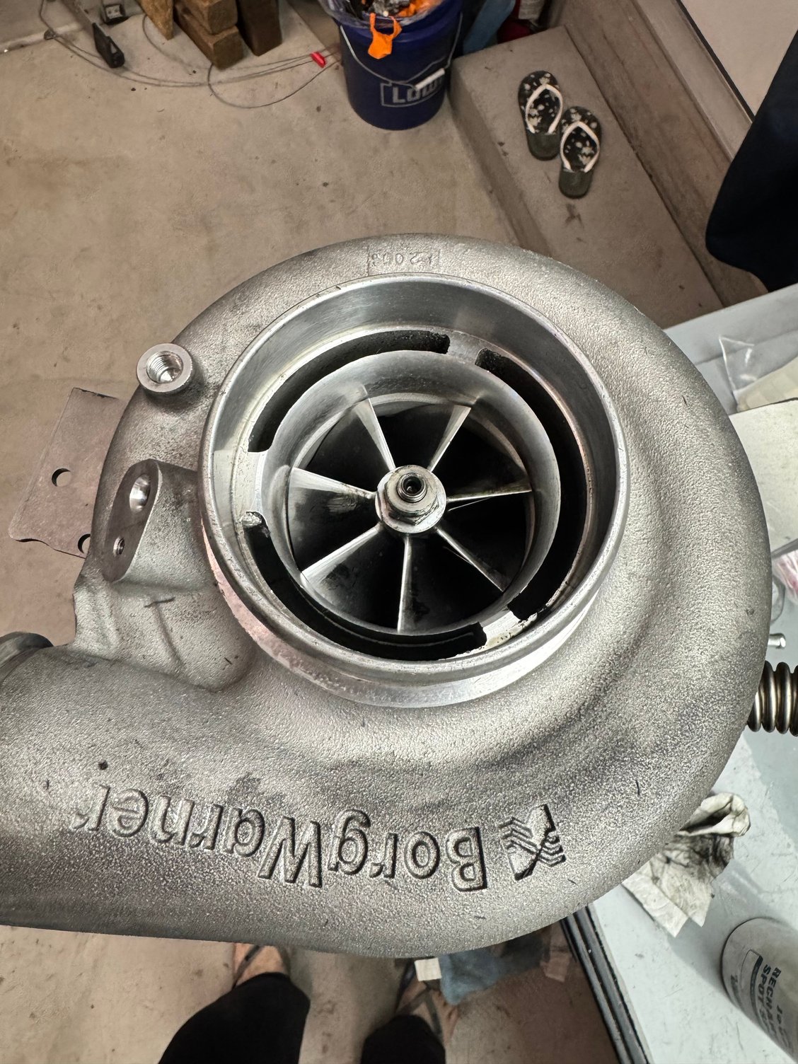

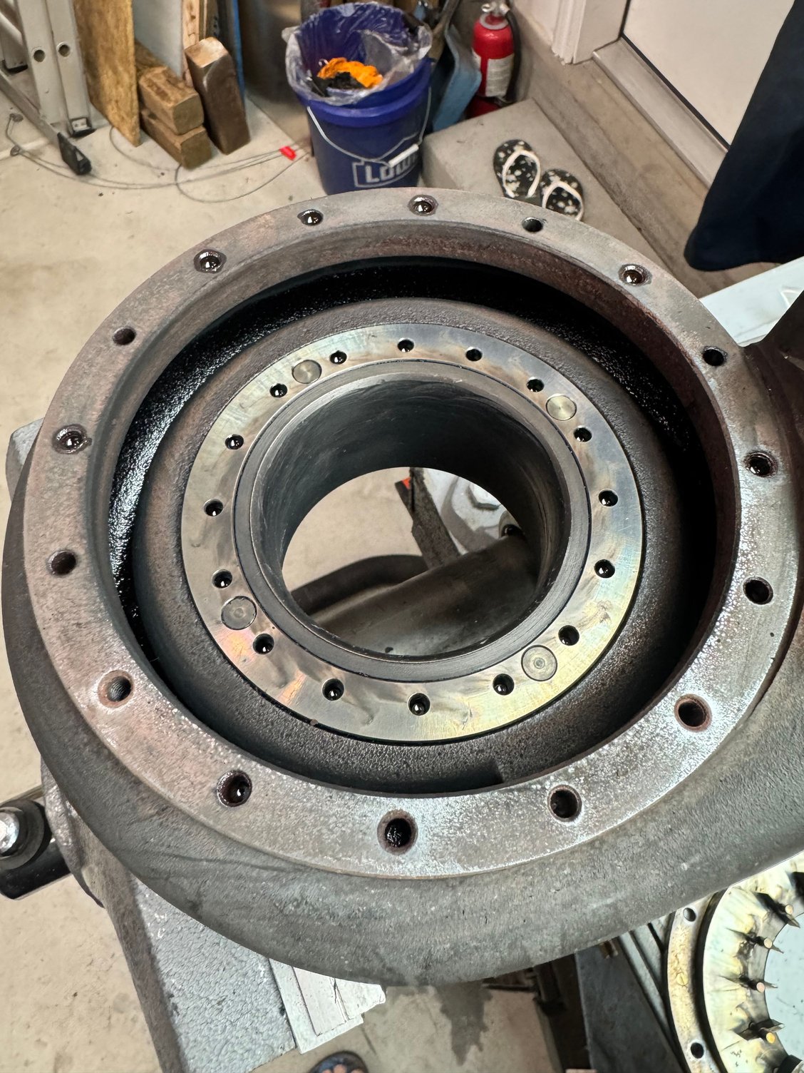

The turbocharger is out of the truck and apart for inspection and relubing. It is in better shape than I had expected. No play in the shaft whatsoever. No signs of wear on aerodynamic surfaces.
