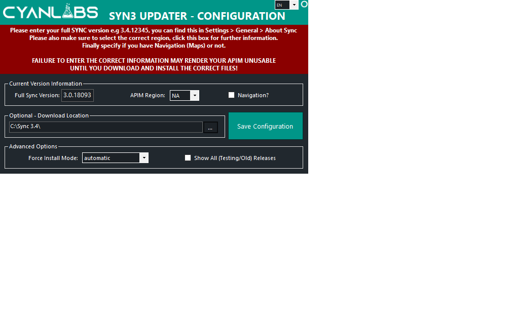

Fingers crossed. The warning message that the download path should be different than the USB location kinda worries me a bit but hopefully itll work. It started downloading after I clicked ok to that warning message.

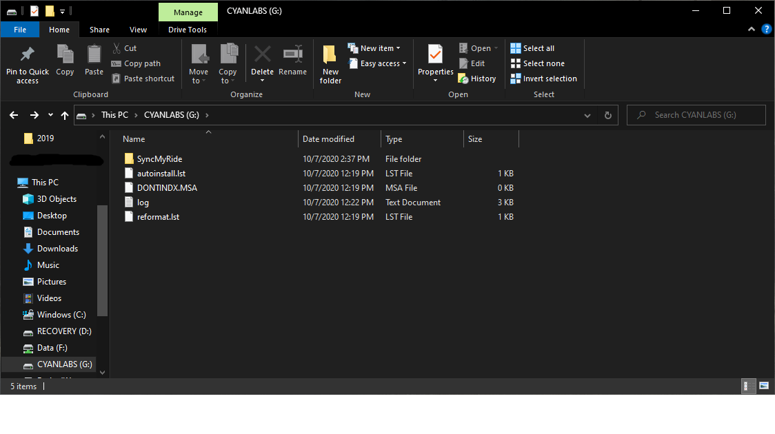

Okay, so unfortunately that did not work the program closed down as it always does when it finishes the download. But there was nothing installed whatsoever. When I reopened my G CyanLabs drive it was completely blank as if nothing installed at all. So now I'm redownloading again to my C drive as before. I will attach photos of what my stuff looks like and what I am getting.
I don't understand why mine is being different. The image of my CyanLabs drive is after copying the files on C over to the drive. Based on your guys' screenshots it appears I'm getting the SyncMyRide files but I'm missing the autoinstall.lst and all of those files. So the question is why are those not installing?

The file structure on the USB has to be exactly like depicted below. Your screenshot of your G: drive USB shows the TAR files in the root of G. They have to be in the SyncMyRide folder. It is concenring that the program closes/crashes out on you. I don't have that behavior.

I can create the SyncMyRide folder manually but that never showed up on its own. All that I got from the installer was those 4 files and that's it. Nothing else. And I'm wondering if that isn't why because it crashes. It closes out every time after finishing downloading. And then my CyanLabs drive disappears. I have to "Eject safely" and then reinsert and it shows back up but it's empty until I manually copy files over to it. I don't get it?!

The crash is your issue, as the last step after downloading everything is formatting your drive and then copying in the files. Create and move the four TAR files to a folder called SyncMyRide.. Download the files you need in the root here. Make sure your final structure look's like depicted above.

Thanks for the files! I setup the USB drive to match how it should be (See Screenshots). I'll give it a shot after work this evening and let you guys know what happens. I think the crash is definitely the issue, it crashes before it completes the download and copy and thus I dont get any of the info where it needs to go. Hopefully this will force it to work! Lol. Thanks again!
