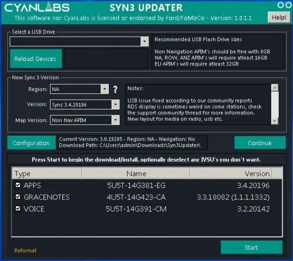

Is it possible to use that syn3updater to go straight from 3.0 to 3.4? I have a non-nav unit but it looks like syn3 will do a non nav update? Don't care about having nav anyway as I use Carplay anyways. But I have a second device I use sometimes for Media and the media controls on sync 3.0 are pretty terrible not to mention buggy and unresponsive at times.
I much prefer the appearance of 3.4 anyway but from what I've read it appears to improve the responsiveness as well which would be an added bonus.
I've got a 2018 F-150 with the 8 inch unit.
From what I've read it looks like with syn3updater I can just download the file and choose what I want (ie leave out nav and save the space on my unit) and then be able to update right on to 3.4 just through that.
At least I'm hoping it's that simple!
Thanks for any advice
Old Oct 6, 2020 | 06:11 AM
  #104
h20camper's Avatar
h20camper
Joined: Apr 2017
Posts: 3,924
Likes: 321
From: Lost in the Ozone....
Originally Posted by BeardedMtneer
Is it possible to use that syn3updater to go straight from 3.0 to 3.4? From what I've read it looks like with syn3updater I can just download the file and choose what I want (ie leave out nav and save the space on my unit) and then be able to update right on to 3.4 just through that.
Yes, it should do that all on one USB stick.
https://cyanlabs.net/applications/syn3-updater/
https://cyanlabs.net/tutorials/updat...s-3-4-19200-2/
Example:

Originally Posted by h20camper
Thanks for the response, man! That answers my question exactly. I just downloaded the files to flash drive. Will give it a shot later this evening.
