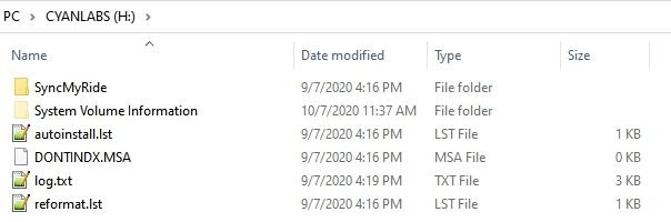

I would try writing the files directly to your USB stick, not your local disk. You definitely don't want to unzip them. Sync 3 expects them to be compressed. Here's my USB stick created by their software (note that I selected v3.3 as didn't want v3.4 so my files in the SyncMyRide folder would name different names).

Here are screen shots of my usb stick (note the volume name, not sure if that matters)
Not sure if this will help or not...

So I redid my stick for the version you're wanting (latest non-nav v3.4). Looks like this.
those are the files I had. I just had to move them over to the drive. Not sure why that didn’t work. But I have them installing directly to the drive as we speak. when I went to do it I got a warning message that my download directory should be different than the USB location and to change the path but I clicked ok and then it started downloading anyway.
Taking MUCH longer to install this way versus the other so not sure if that’s a good thing or not. Will see what happens after this.
