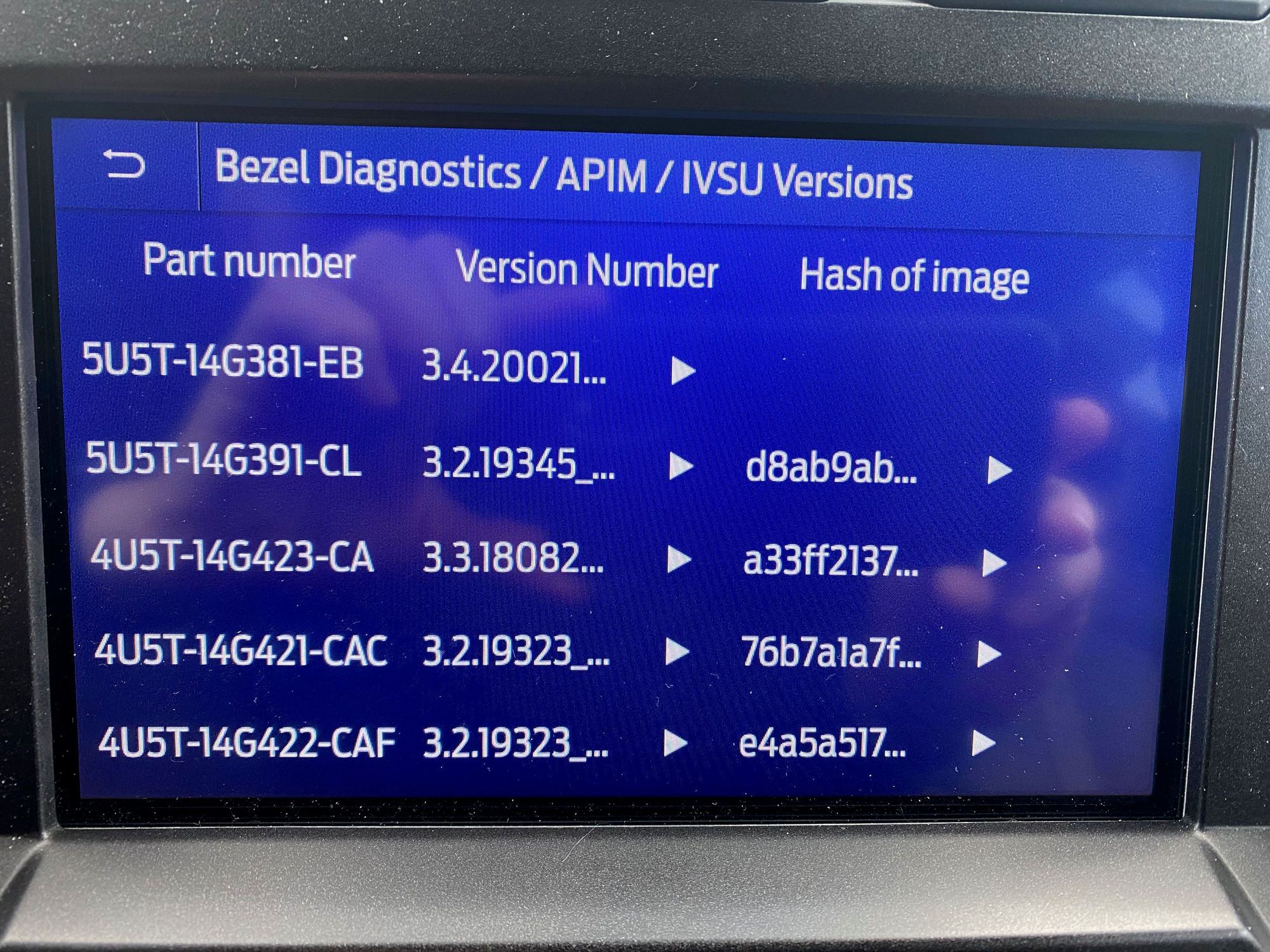

The correct voice file for 20021 is 5U5T-14G391-CL.tar.gz

My rig was running just fine with only the 20021 apps, but decided I wanted the 1.19 maps and all the correct files. Performed a complete reinstall of Sync and now have all current files. Good discussion here for anyone interested.

Leon,
What exactly are you stating. I too installed the 20021 the other day. Is there a different, newer file or just the Nav map.
Thanks
Old Feb 29, 2020 | 06:20 PM
  #35
leonmckee's Avatar
leonmckee
Joined: Dec 2019
Posts: 136
From: Peyton, Colorado
All Sync files have been updated and include the Maps version 1.19. Unless you have any issues with voice or you want the latest maps then you're good. This update involves a reformat and reinstall so it's not for everyone to say the least. Good discussion here for anyone interested.
Here's a list of the new files for reference (NAV version):
APPS = 5U5T-14G381-EB.tar.gz
VOICE = 5U5T-14G391-CL.tar.gz
VOICE_NAV = 4U5T-14G422-CAF.tar.gz
VOICE_NAV = 4U5T-14G422-CBF.tar.gz
VOICE_NAV = 4U5T-14G422-CCF.tar.gz
GRACENOTES = 4U5T-14G423-CA.tar.gz
MAP_LICENSE = 4U5T-14G424-CC.tar.gz
MAP = 4U5T-14G421-CAC.tar.gz
MAP = 4U5T-14G421-CBC.tar.gz
MAP = 4U5T-14G421-CCC.tar.gz
MAP = 4U5T-14G421-CDC.tar.gz
MAP = 4U5T-14G421-CEC.tar.gz
MAP = 4U5T-14G421-CFC.tar.gz
MAP = 4U5T-14G421-CGC.tar.gz
MAP = 4U5T-14G421-CHC.tar.gz
MAP = 4U5T-14G421-CJC.tar.gz

Leon,
I finally got to drive my truck and noticed the speed limit road notification shows the European circle. Am i to reinstall the 3.4 to get back to what i had upgrading to 20021 5U5T-14G381-EB.tar.gz or do i need to install the 5U5T-14G391-CL.tar.gz to correct this?.
If needing the 391-CL where do i find it.
Thanks
Thanks
If all you did was install the 20021 Apps then this is a mystery. CL is the Voice file. You can downgrade to prior versions of 3.2/3/4 using the same method as you used to go to 20021. Just change the file and script.
You may want to recheck whatever file versions you last installed for NAV. It's easy to click the wrong link and get non-NA files.
