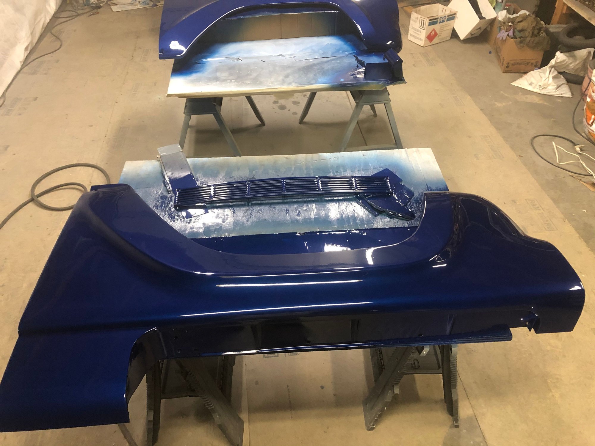

A lot of Blue!
Sprayed a lot of blue today!
RH fender
LH fender
valence
ashtray
glove box door
cowl vent
inside door stripes

That's a nice shade of blue, not a lot of over spray.

It is worth having a good HVLP spray gun. I like it better than the old high pressure gun that I learned on! Bottom line, if you plan to spray your own paint invest in a good gun and quality materials.

I suspected that it was a HVLP spray gun, they are amazing.

Looking good, keep going

I was amazed when I switched to hvlp. When I painted an old tractor with an old siphon feed gun I had orange clothes, shoes and a ten-foot circle of orange sand. I only have trouble with the vent on top. I usually manage to tilt gun a little too much and get dripping from top. You're almost finished now. Looking good.

Looks like more quality work to me!

Thanks guys! I solved the run/sag clearcoat issue by double flash time in colder weather. 30 minutes between coats worked perfect! I can’t help but start getting excited, only door exteriors and bed left to paint!
