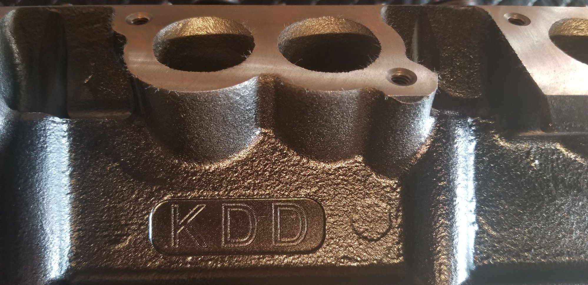

HTM101, Looking good! When you get those heads can you post a pic of the head surface so we can see the placement of the ring. KDD claims they figured out the specific placement of the ring so I'd like to compare. Appreciate it.
I sure will.
I thought you had KDD o-ringed heads?

He does. He's trying to compare the two applications.
I do, he doesn't.
^^What he said.
Heres mine for comparison.
I'm looking for a comparison shot of the UCF heads.
