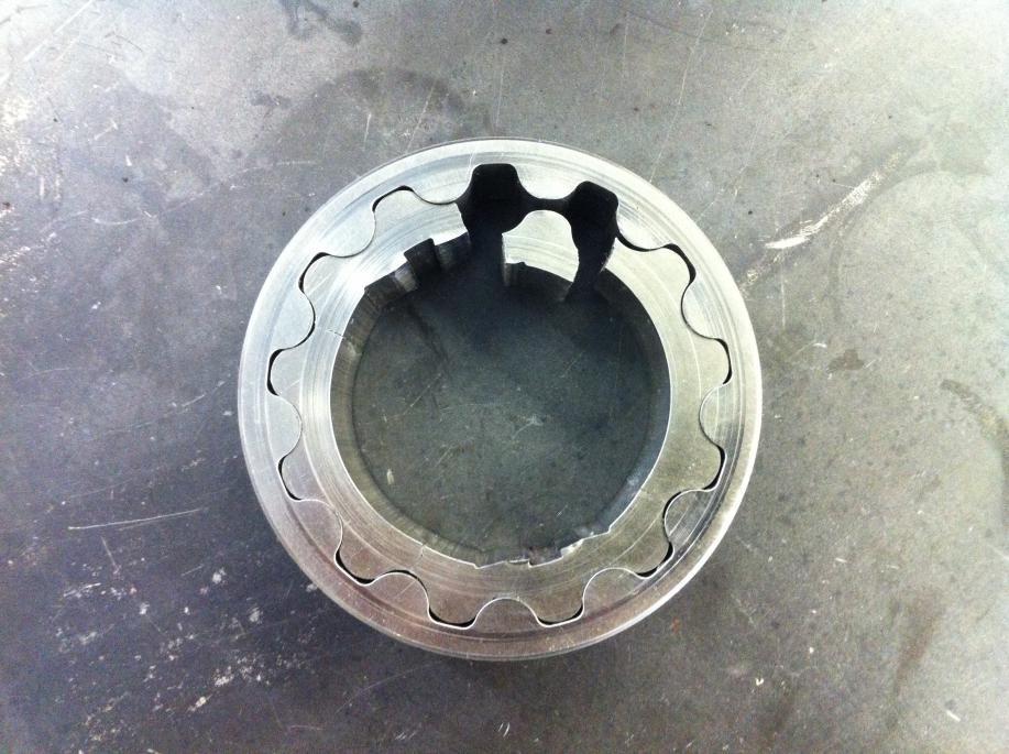

Here's one I just pulled (a couple of weeks ago) from an over 200K Powerstroke engine that is being retrofitted to fit in a Ford Medium Duty Truck.............while dirty, rusty from sitting outside it has no mechanical marks (like yours).............I'm putting a new Ford part in so this is just on the waste / recycler pile.............I'd say (given the 10s of 6.0L engines we've worked on) that yours is in the "bad" category -- 85%-95% of the teardowns don't show any damage, a few the same level of damage as yours, a few far worse..........

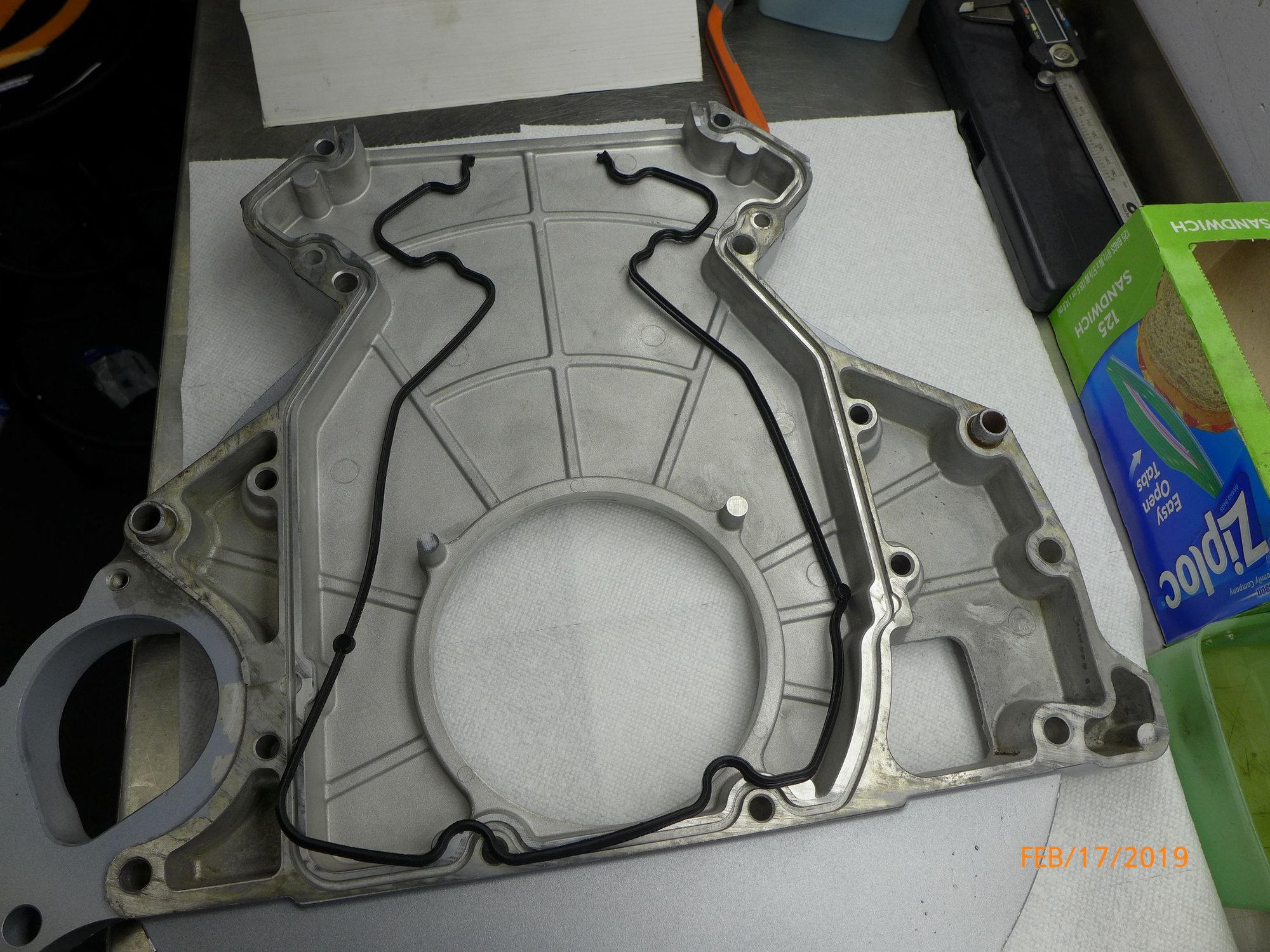

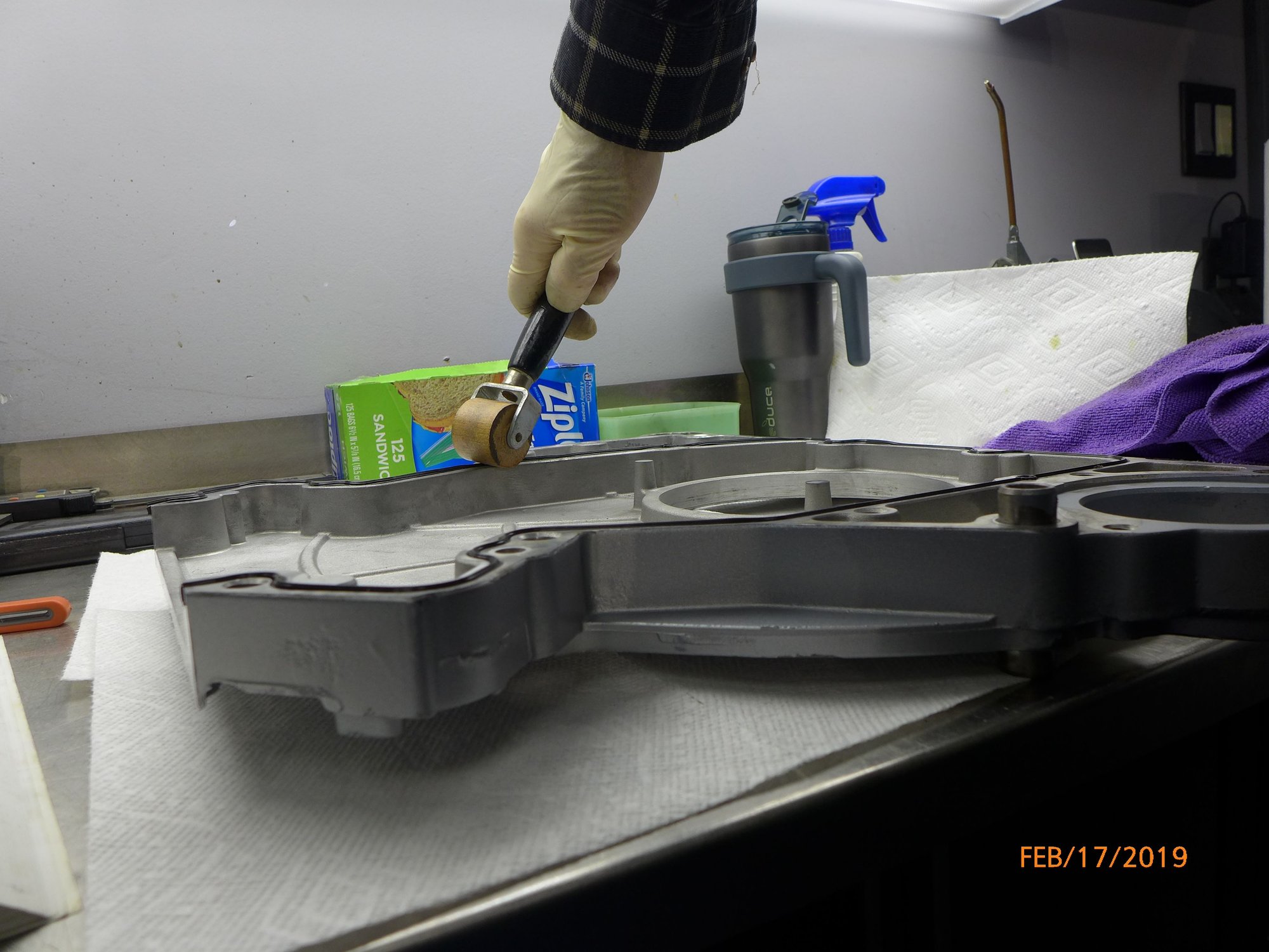

Ready to lay the gasket into the rear cover.
I mentioned this tool earlier when smoothing out the anaerobic gasket material. It also works well to uniformly set this type rubber gasket into the channel.

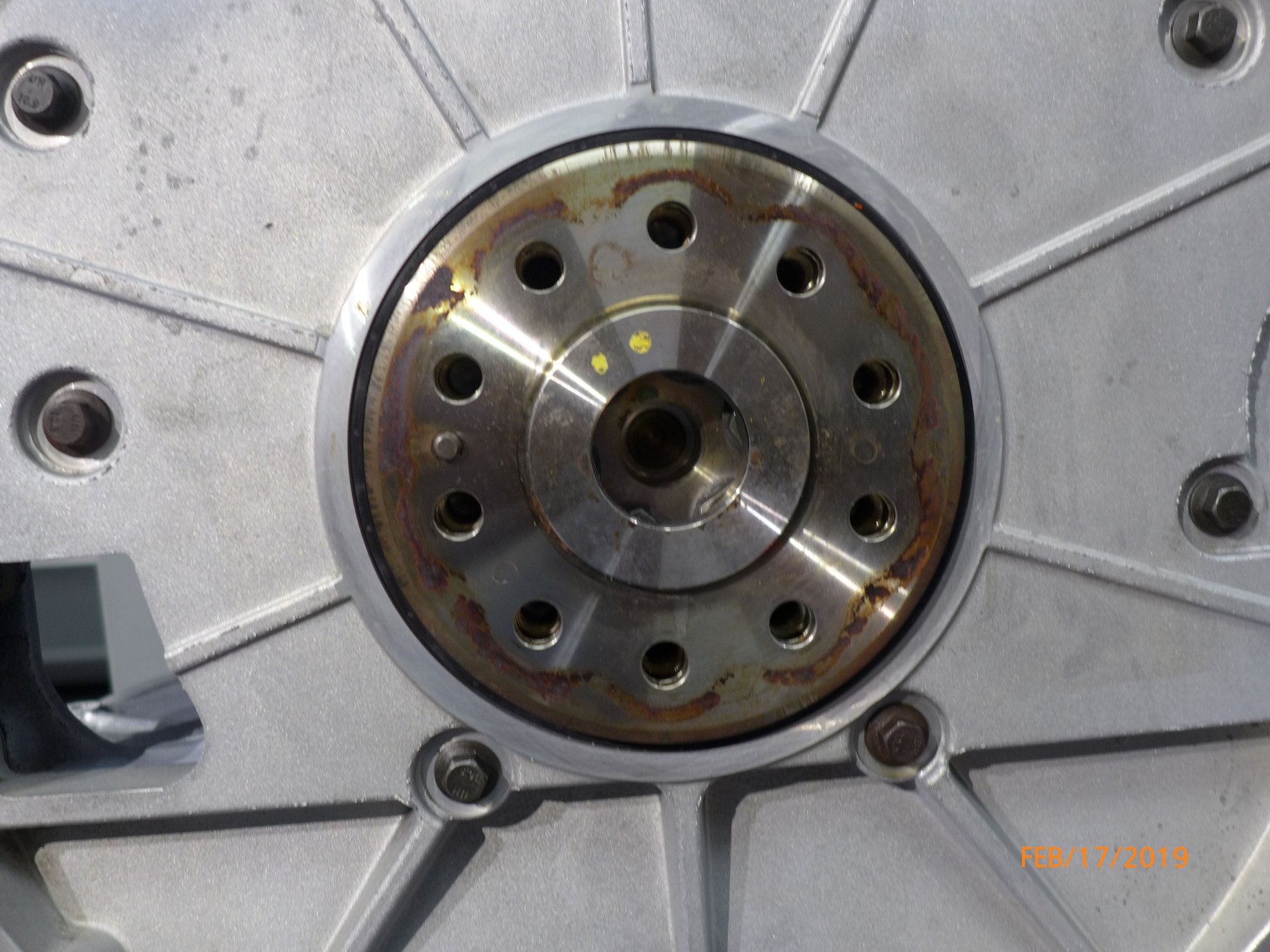

Rear cover in place and torqued down.

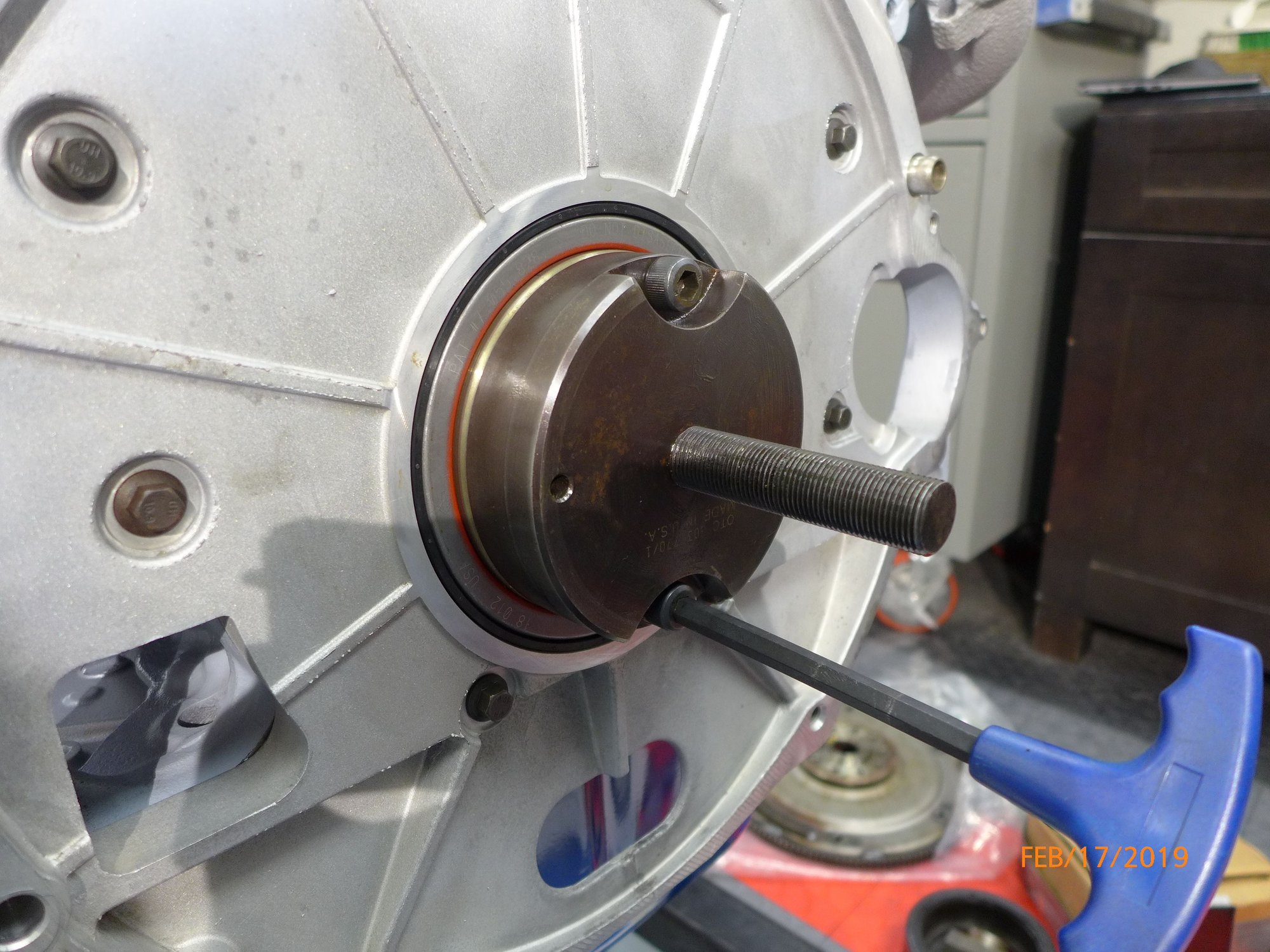

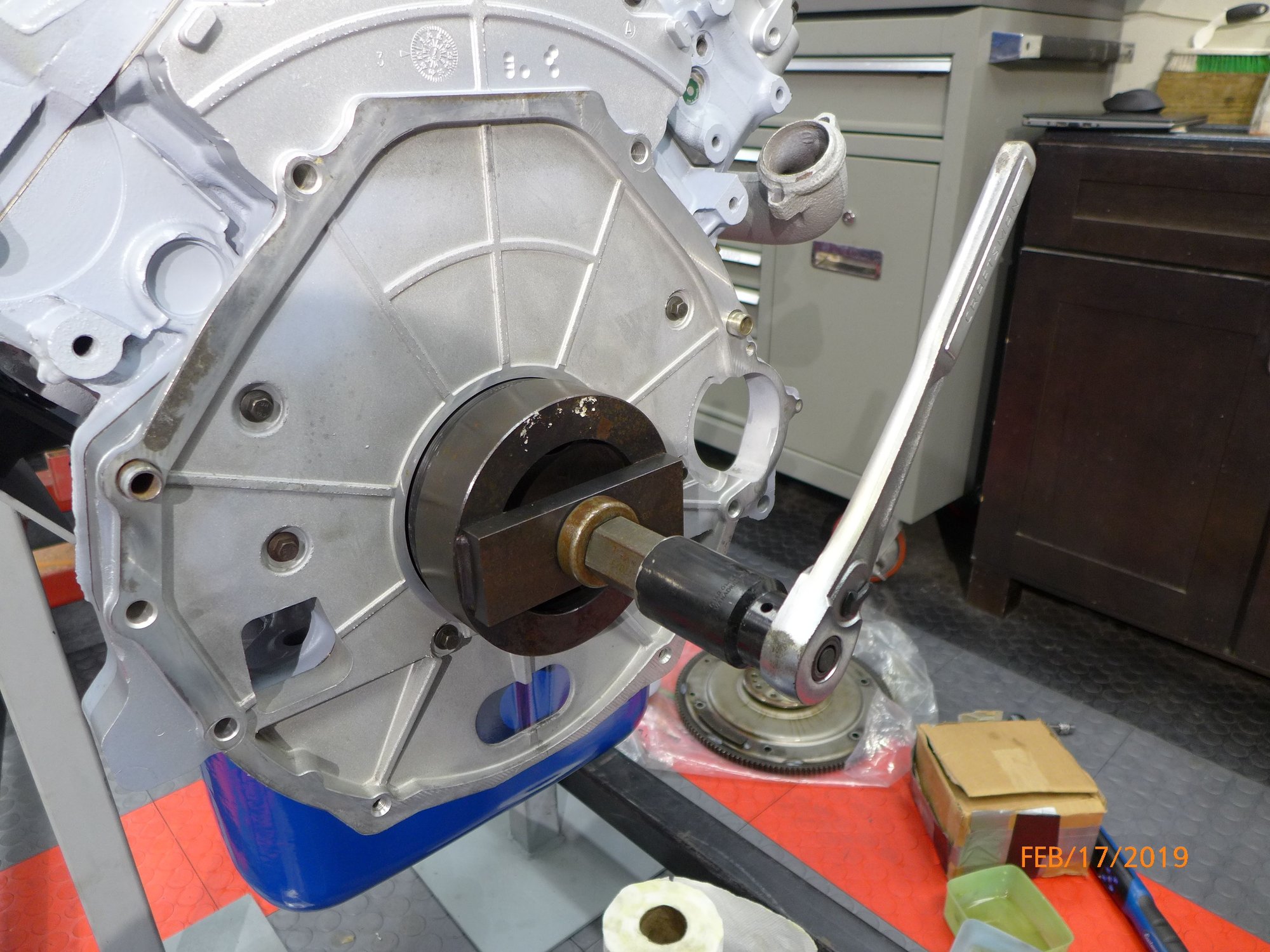

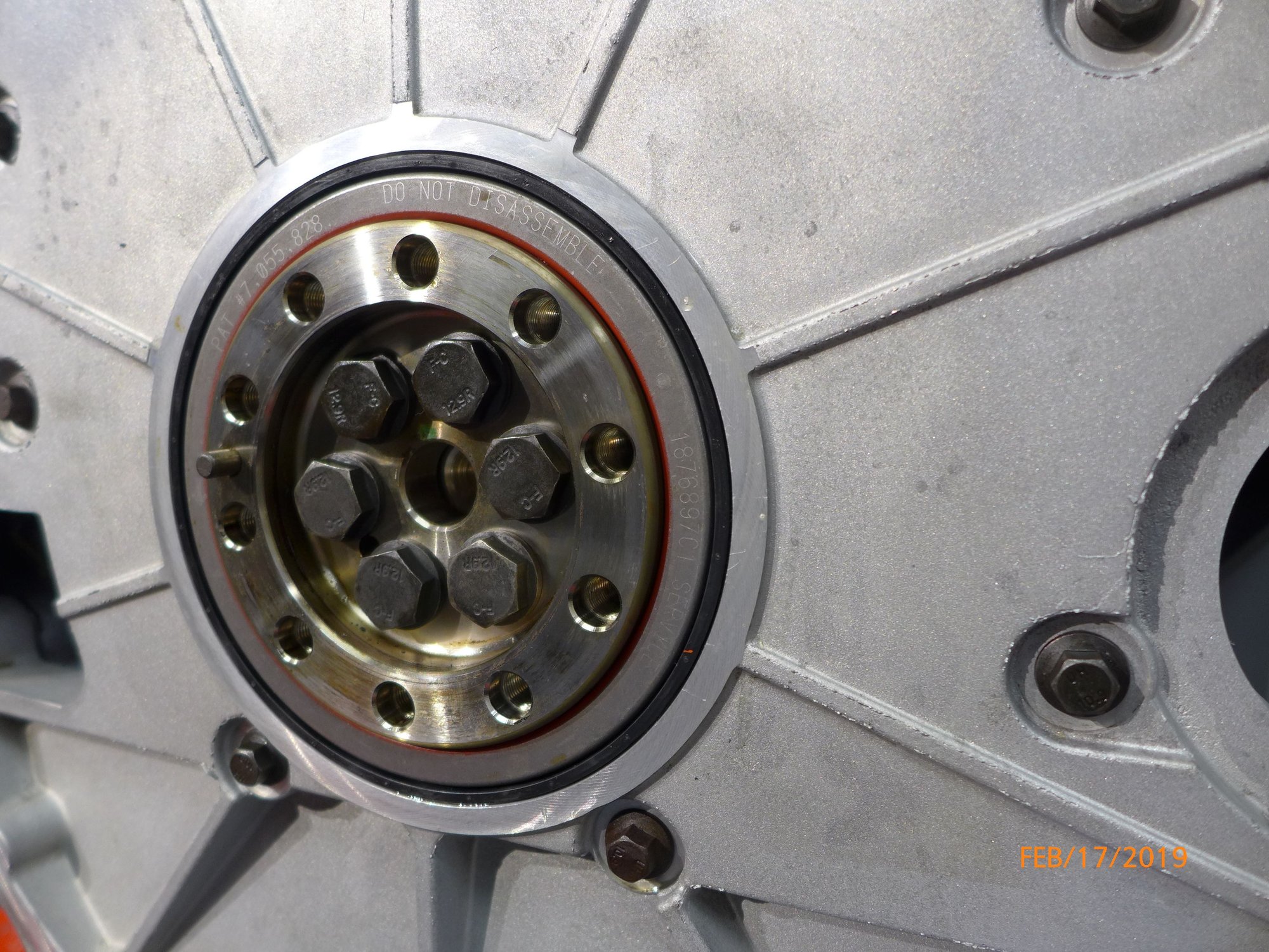

Next item is installing the rear main seal. Read the Ford manual description, watched the DieselTechRon video, and then mounted this used installation tool I snagged off Ebay.
Done, and it was a very smooth install.

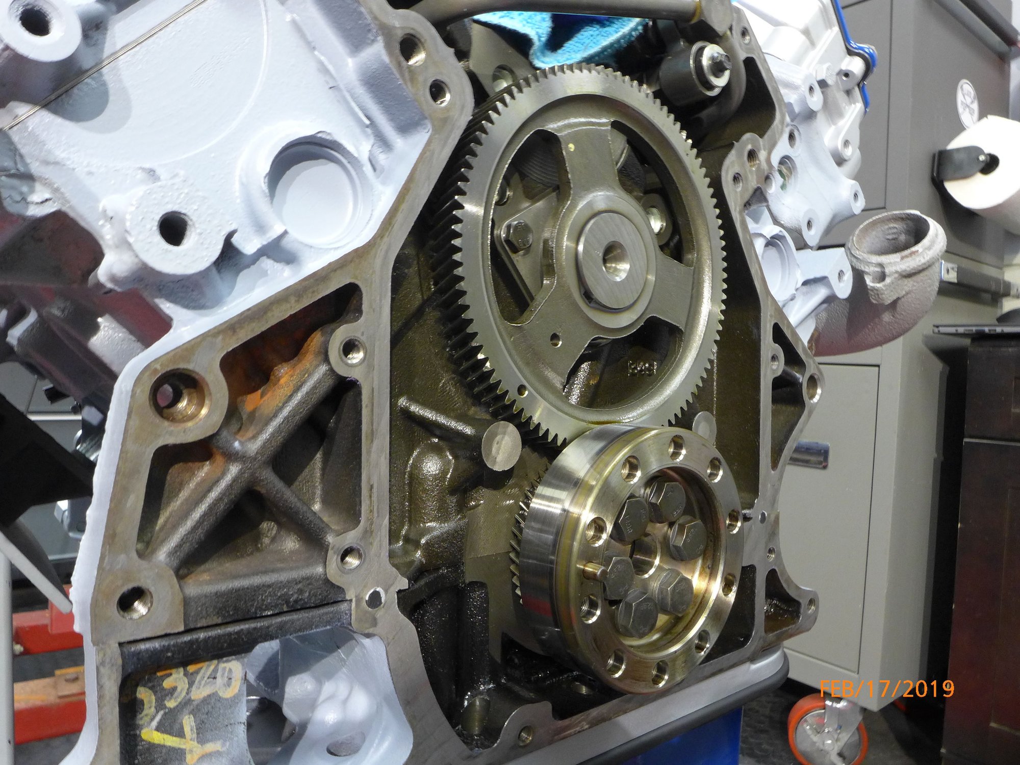

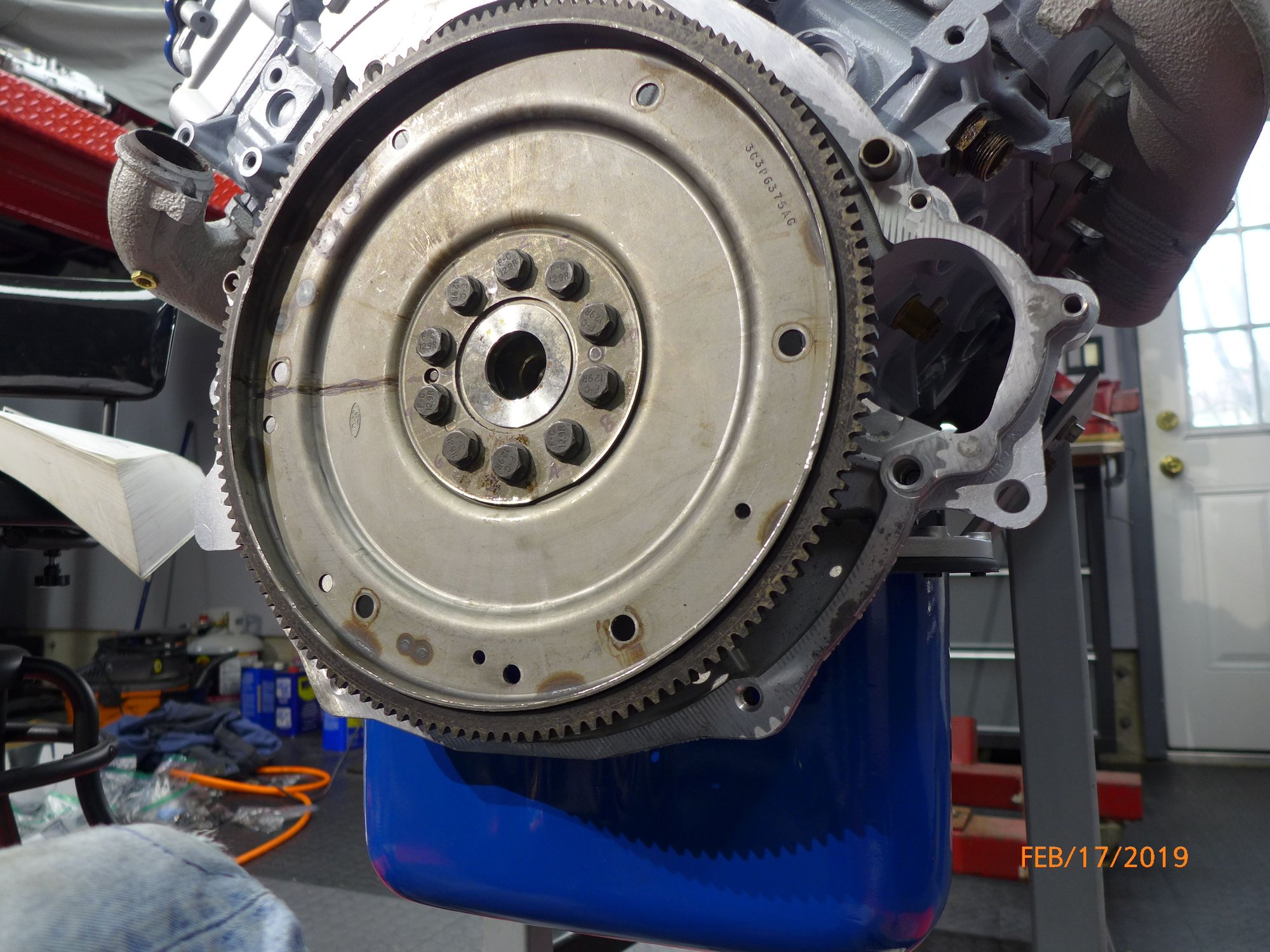

Tapped on the flexplate adapter.
Then the flexplate.

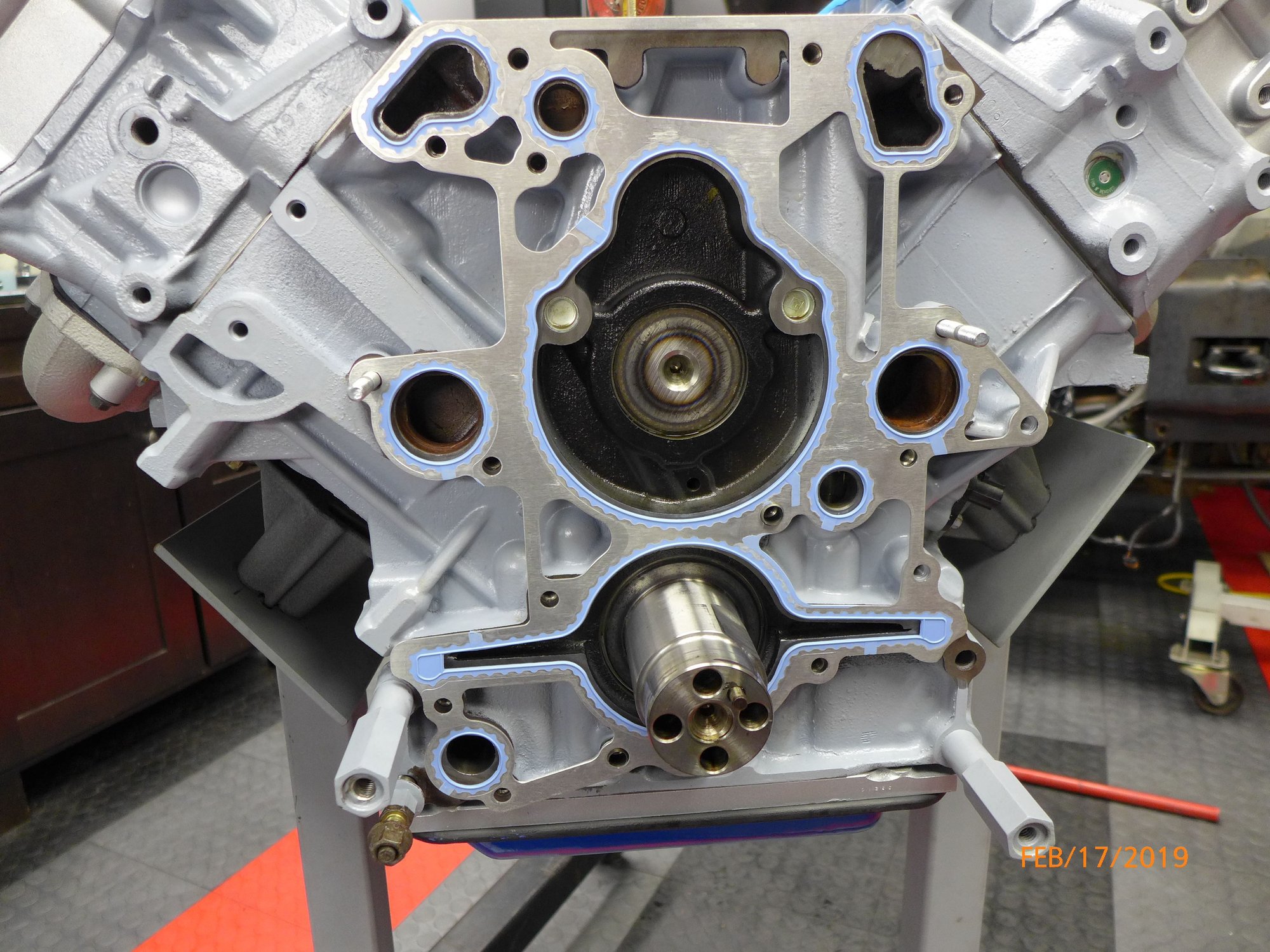

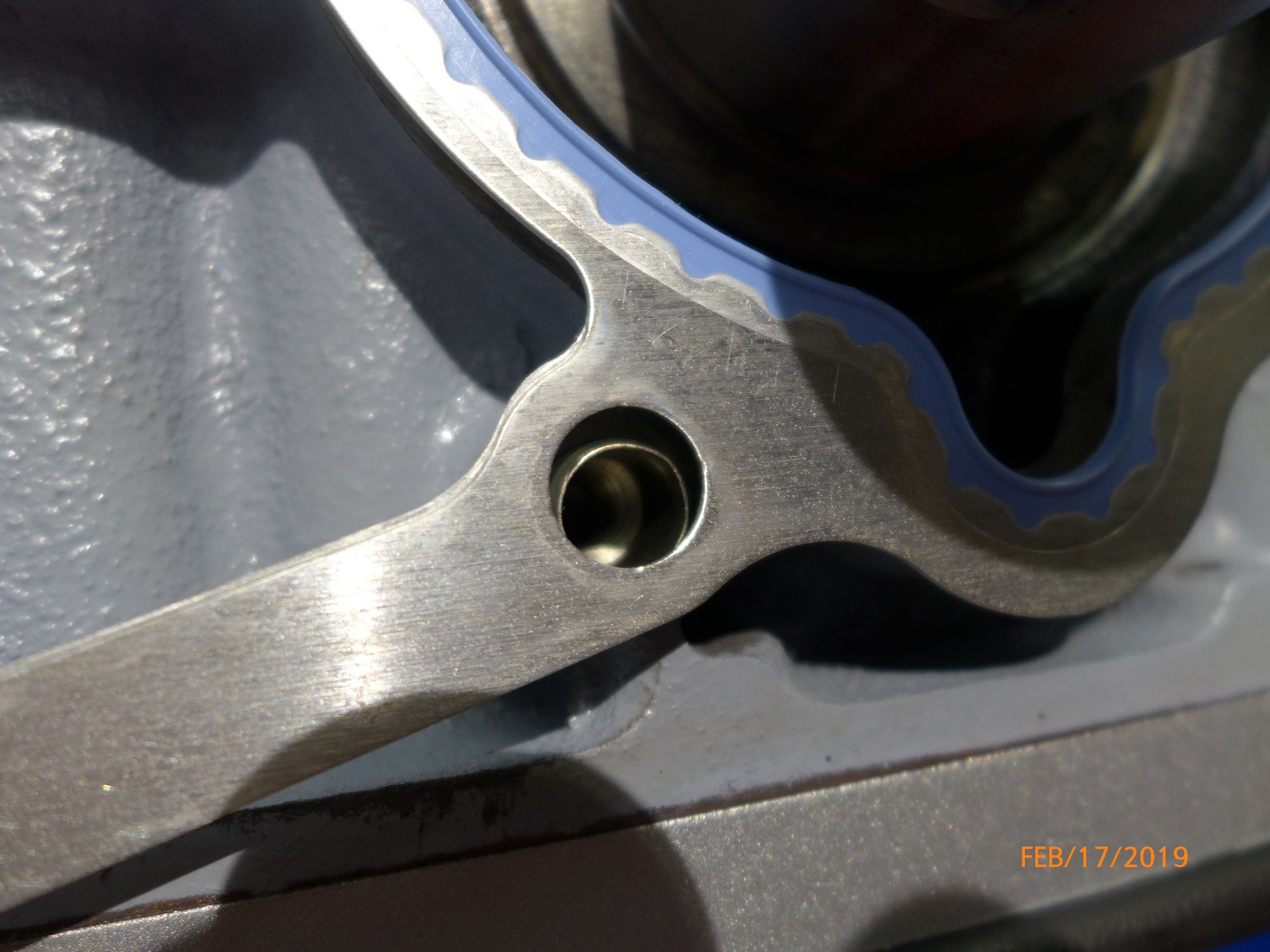

Then went to the front end, did a final cleaning on the mounting surface, and test fit the front gasket.
There are 2 dowels in the block for this gasket's alignment; 1 in the 1 o'clock position above the crank, and 1 in the 7 o'clock position below the crank. Notice the offset of the hole in the gasket for the 7 o'clock dowel. I believe this is a $50.00 gasket. All the seals positions, and bolt hole positions, were in their proper location. The punched hole for that lower dowel was improperly located. After using the Dremel and small stone, all was good.

I recall someone in the last two years maybe more that posted a photo of
his pump that has shattered parts.
New pump or reusing the old one I would still check the fitment with the feeler gauges.
I like that roller tool. Looks like what is used to set a tire patch once you have the adhesive on.
We bought it years ago to roll freshly hung wallpaper seams.
