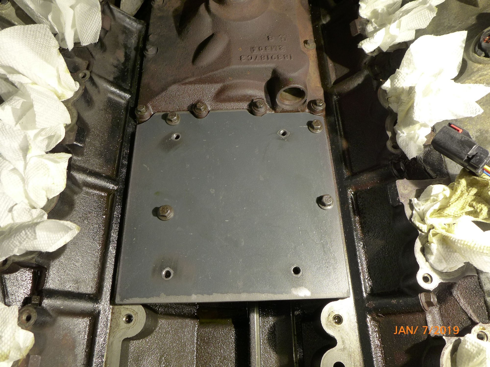

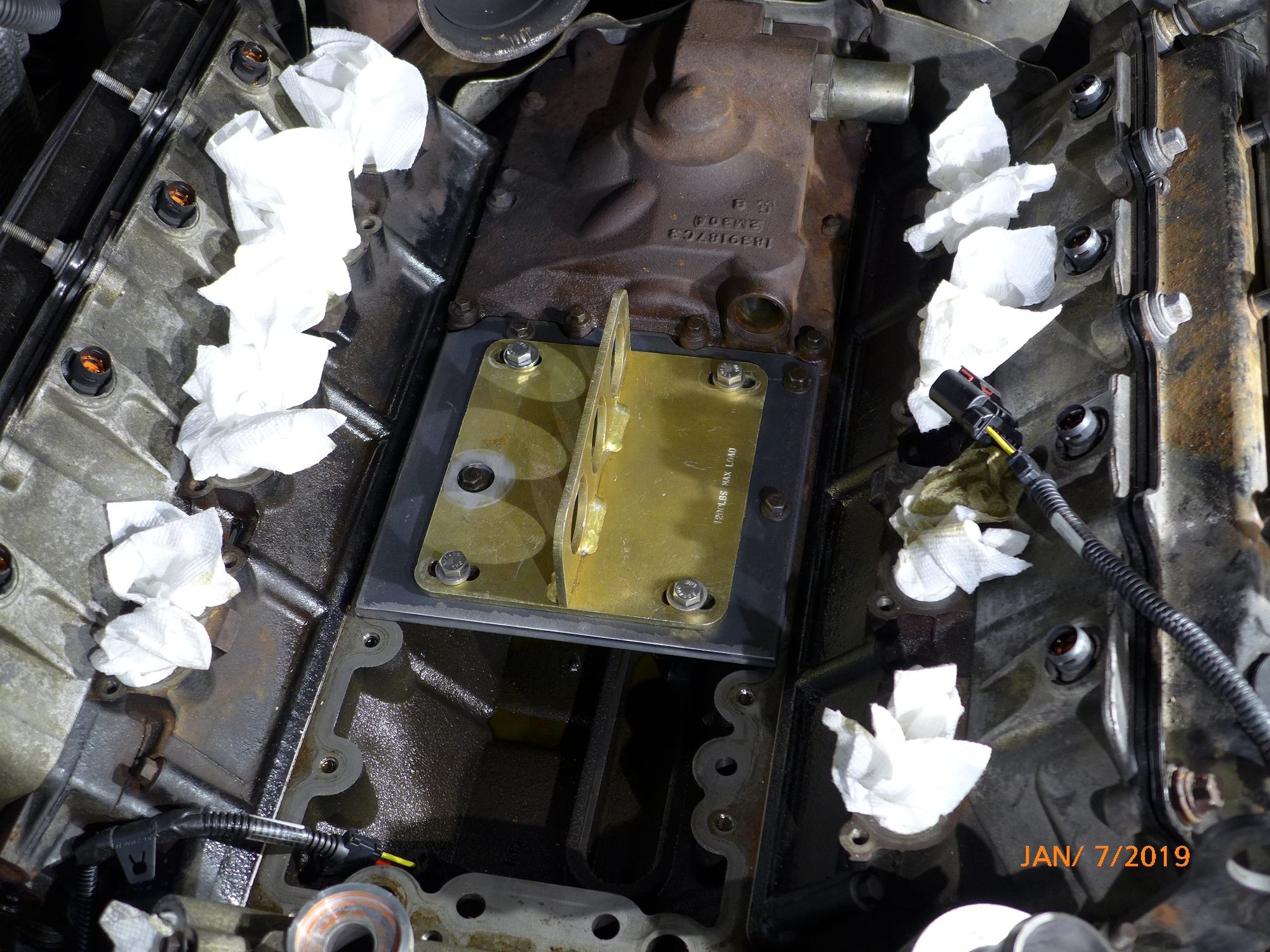

Used a piece of 3/8" plate and cobbled a base, then bolted it to the block using the holes for the turbo pedestal. Then added an old engine lift plate.

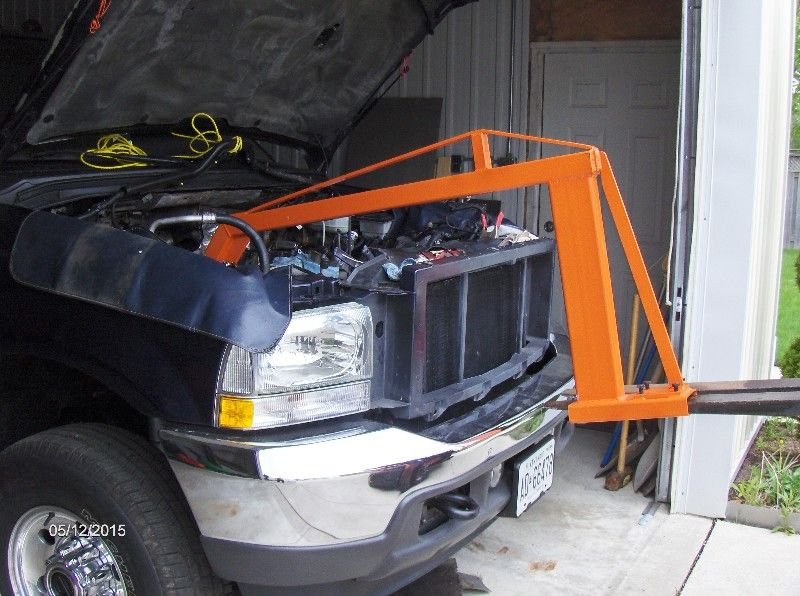

how i did it
i enjoyed working on my 6 liter
Nice engine hoist!

The Rebuild Starts
It's out.
