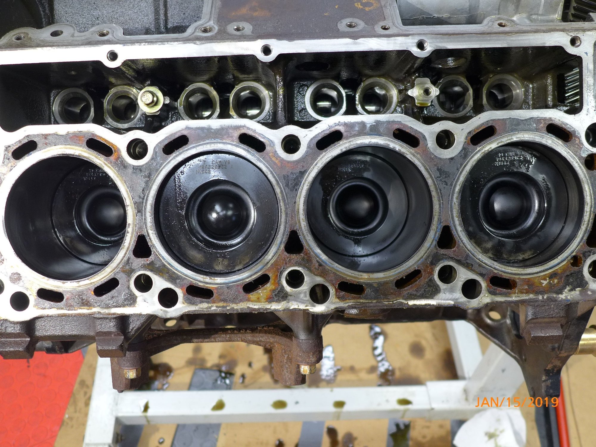

I'm surprised you opened the bottom end as it didn't look like the bedplate was leaking.
But while you're open, take a close look at the cam lobes as it's the best chance for viewing.

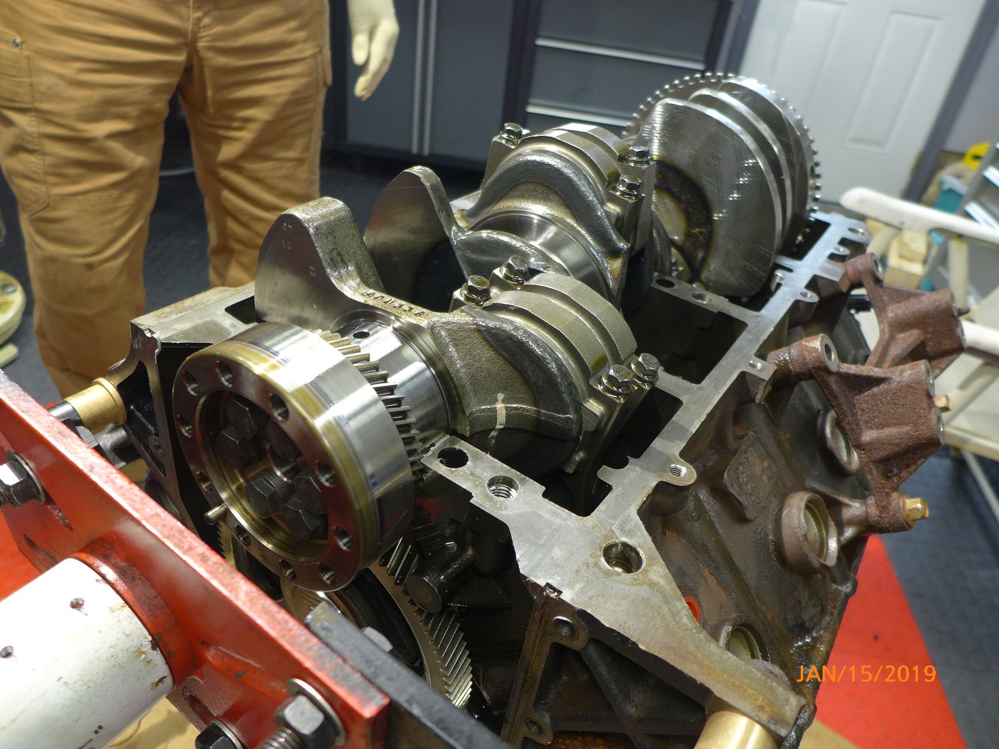

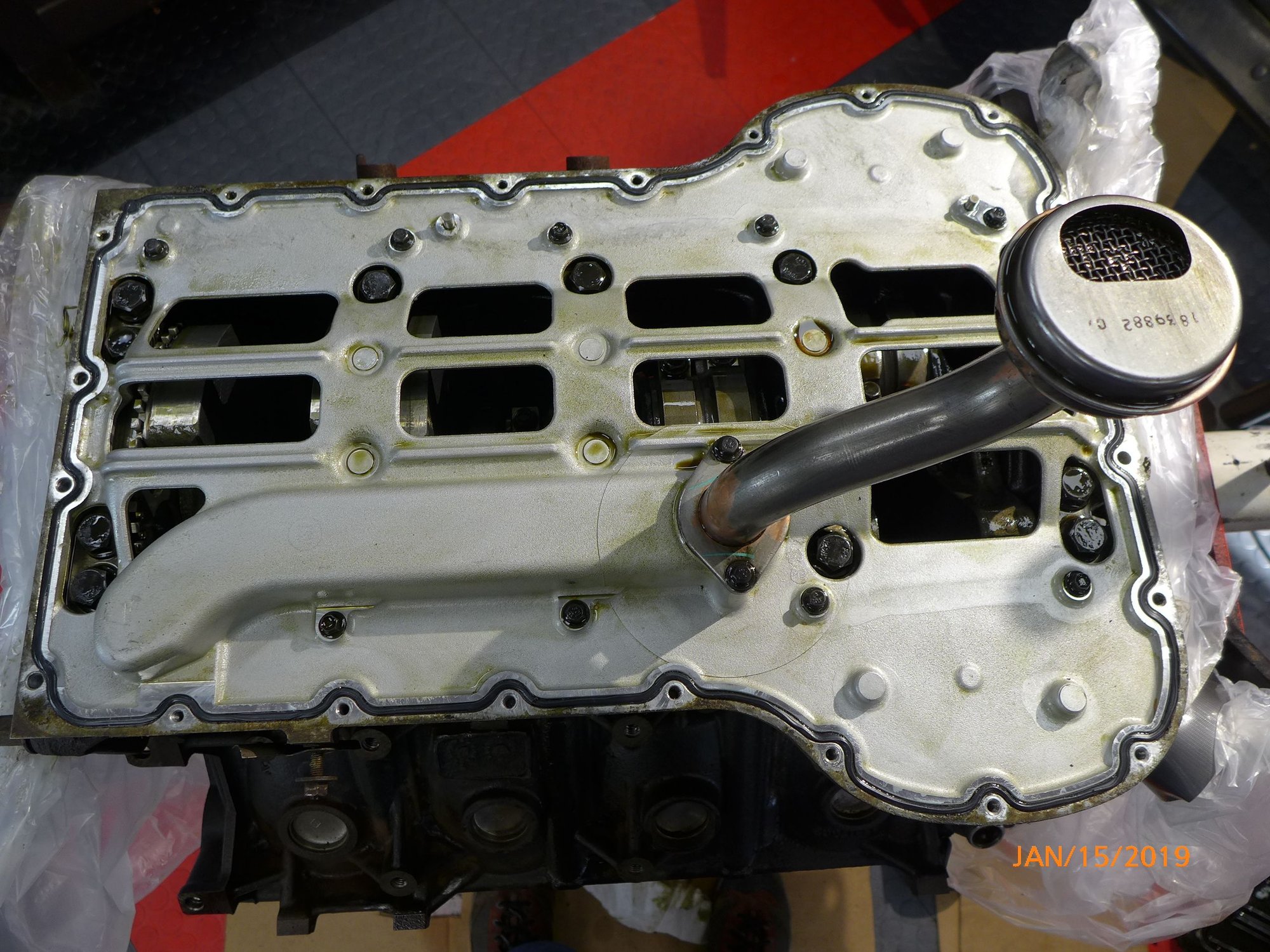

I removed the lower crankcase to inspect 1/2 of the main bearings. I'll also remove some random rod caps for the same reason.

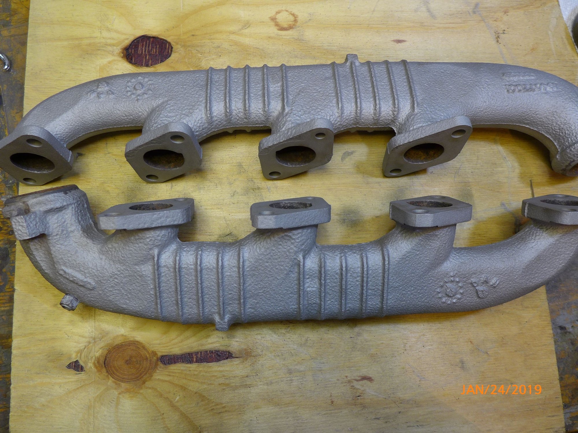

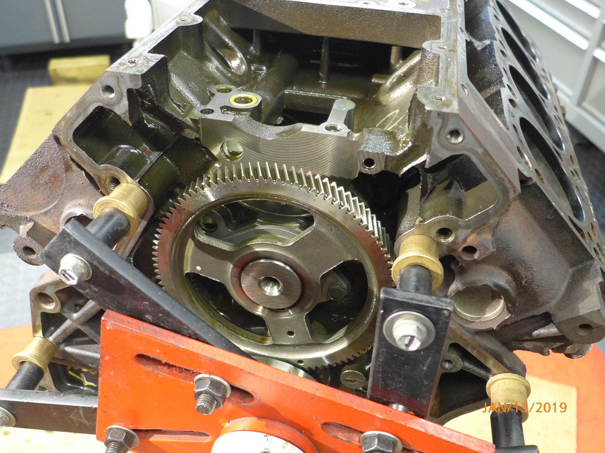

Prep Work

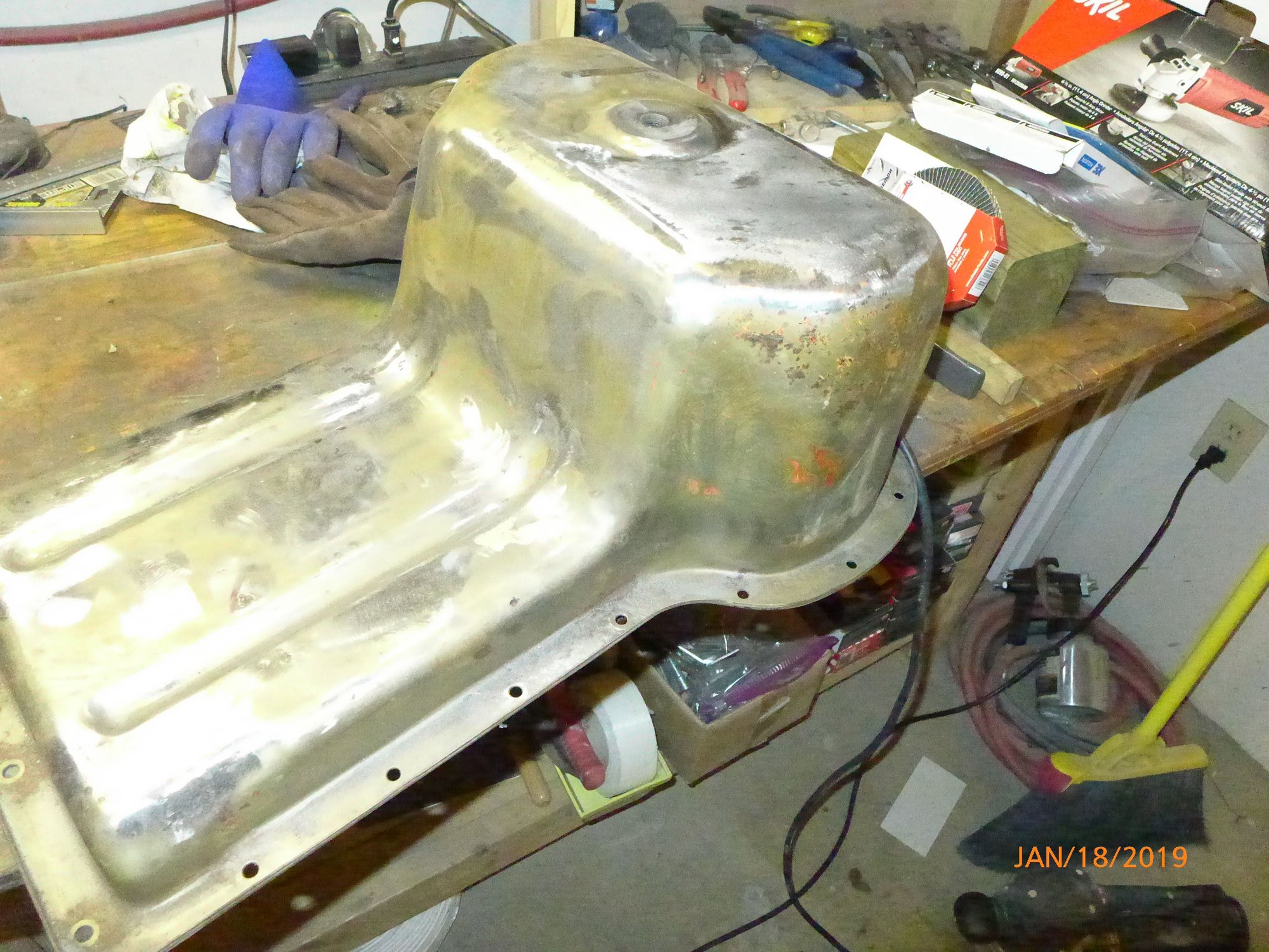

Eliminating rust and corrosion has been time-consuming. These exhaust manifolds required 4 applications of Eastwood Rust Remover gel, and then 2 hours of stainless steel grit blasting.
The oil pan was a bit nasty.

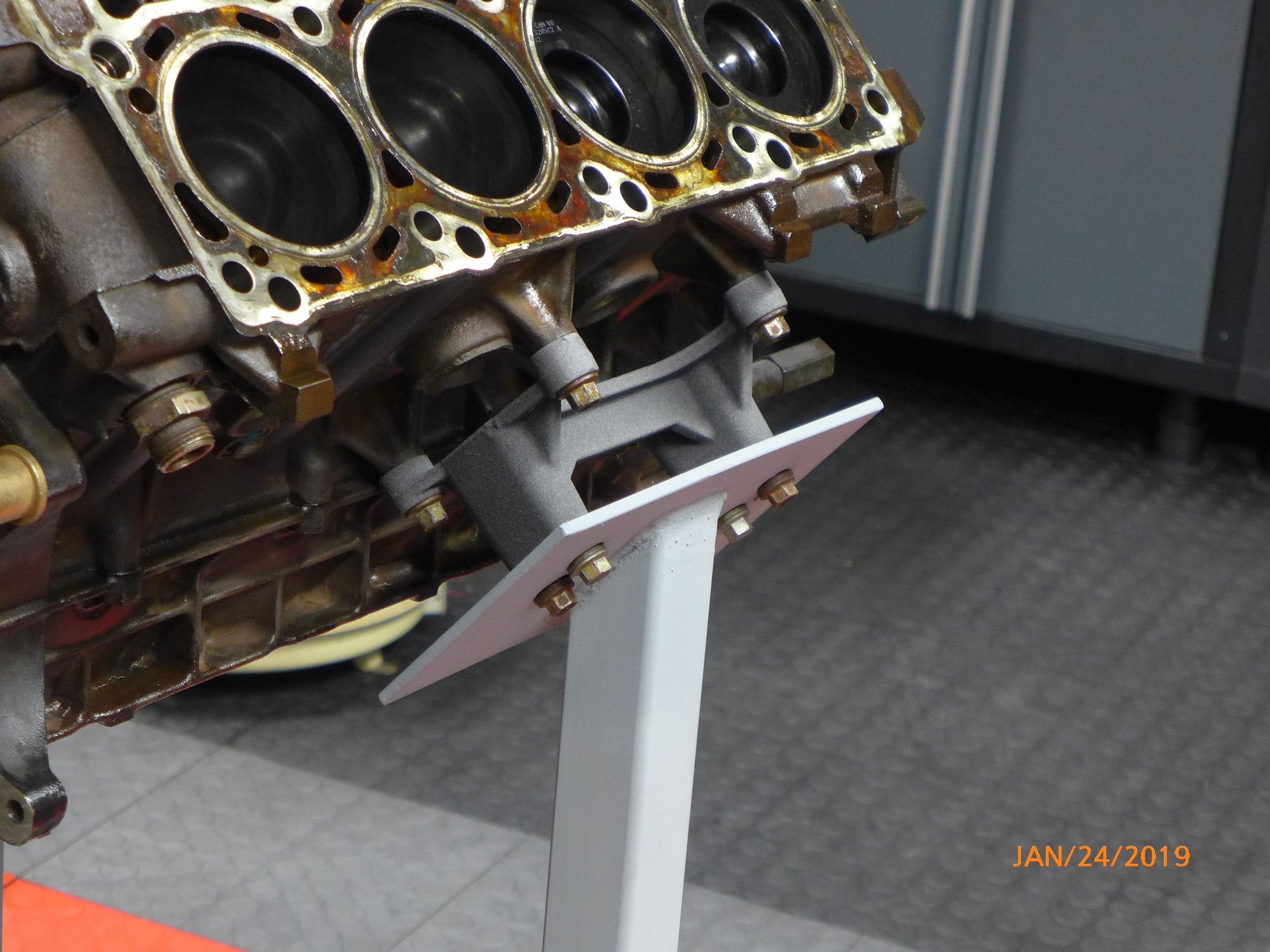

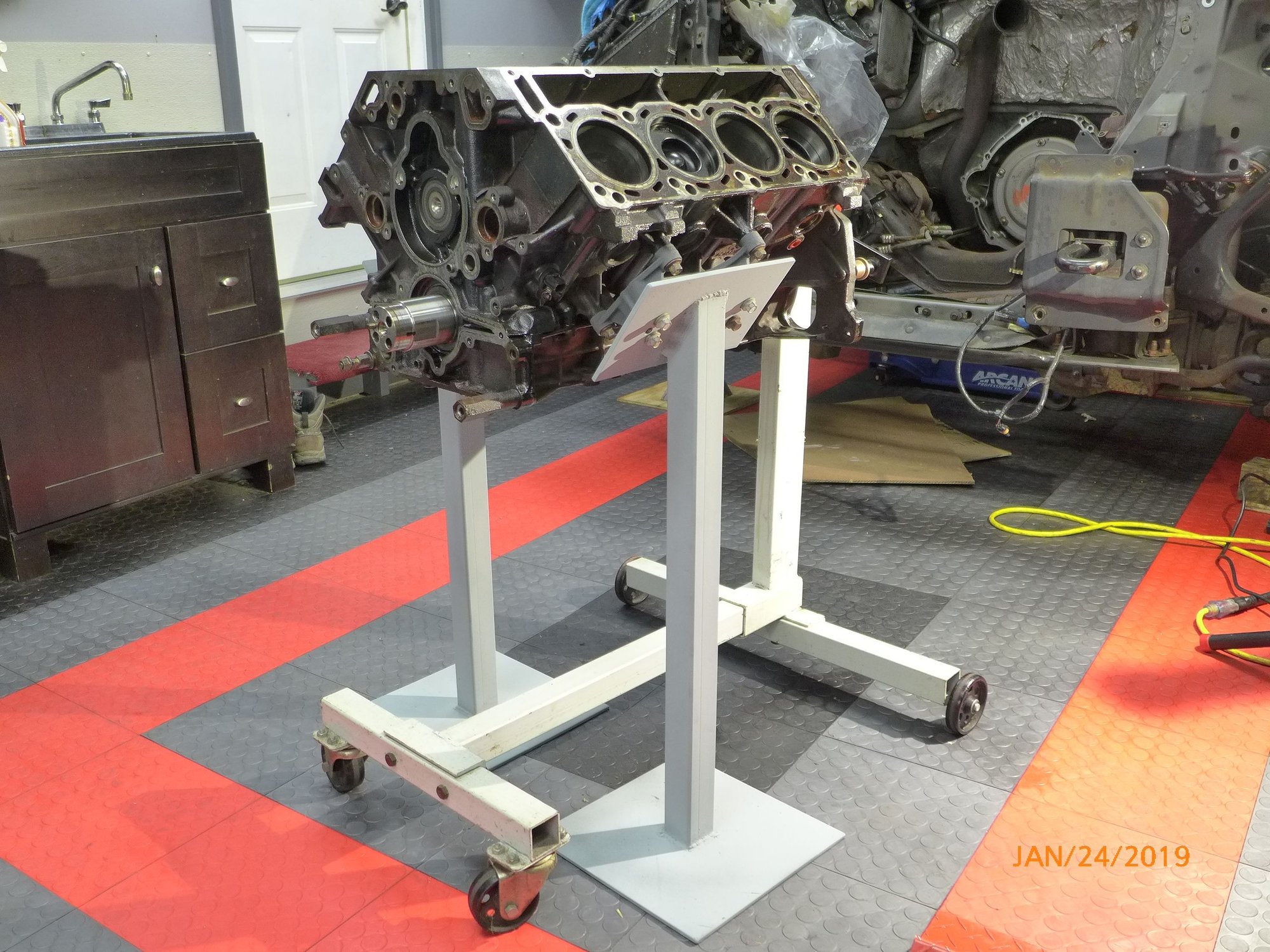

I bought some steel, did some cutting and had a friend weld the pieces. Now the engine is level and ready for stoning.

Wow, nice setup! Looks great

Nice support stands. Do high temp paints hold up to the heat of diesel exhaust manifolds? Can't stand the rust on mine.
Amen on the rust. Heck, after media blasting I packed the first manifold in a plastic bag, inside my house overnight. The next morning it had flash rusted over about 60% of the surface area. I blasted it again.
Yesterday I used these products; primer, paint and satin clear. I still have to oven cure as is listed in the instructions. Check back with me in a year, LOL.
https://www.vhtpaint.com/high-heat/v...eproof-coating
I tried that paint last year on my CAC tubes and it sucked. Sandblasted, primed, painted, satin clear coat and it would scratch off with a fingernail a week later. Had them powder coated after that waste of money.
