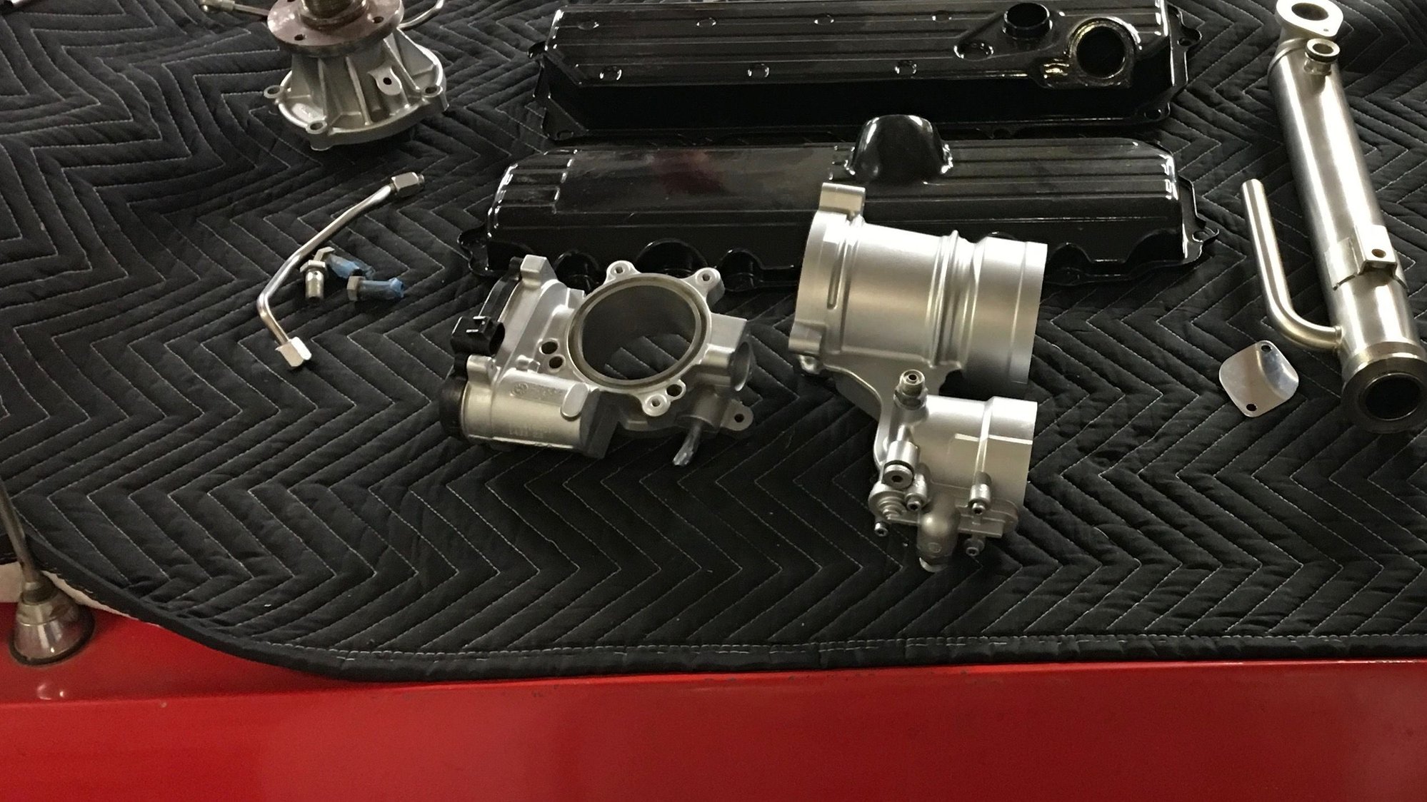

I am guessing the reason you did not take it out was because it would set some nag CEL lights.
The shaft that is felt behind is not that large and should not cause that much restriction to the air flow.
Now if your were trying to get every ounce of power out then that would be a reason to remove it.

The '03 reman came to me throttle body gutted. The electrical connectors connect, but there is nothing in there, so sensor, no boards, nothing. I could just cut off the wires.

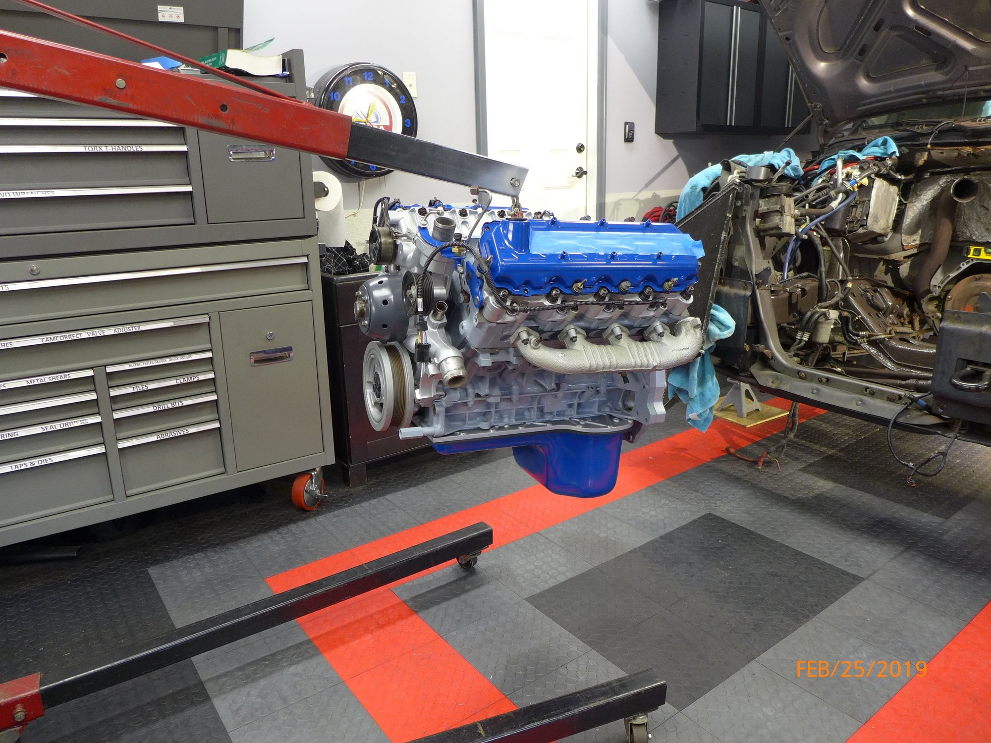

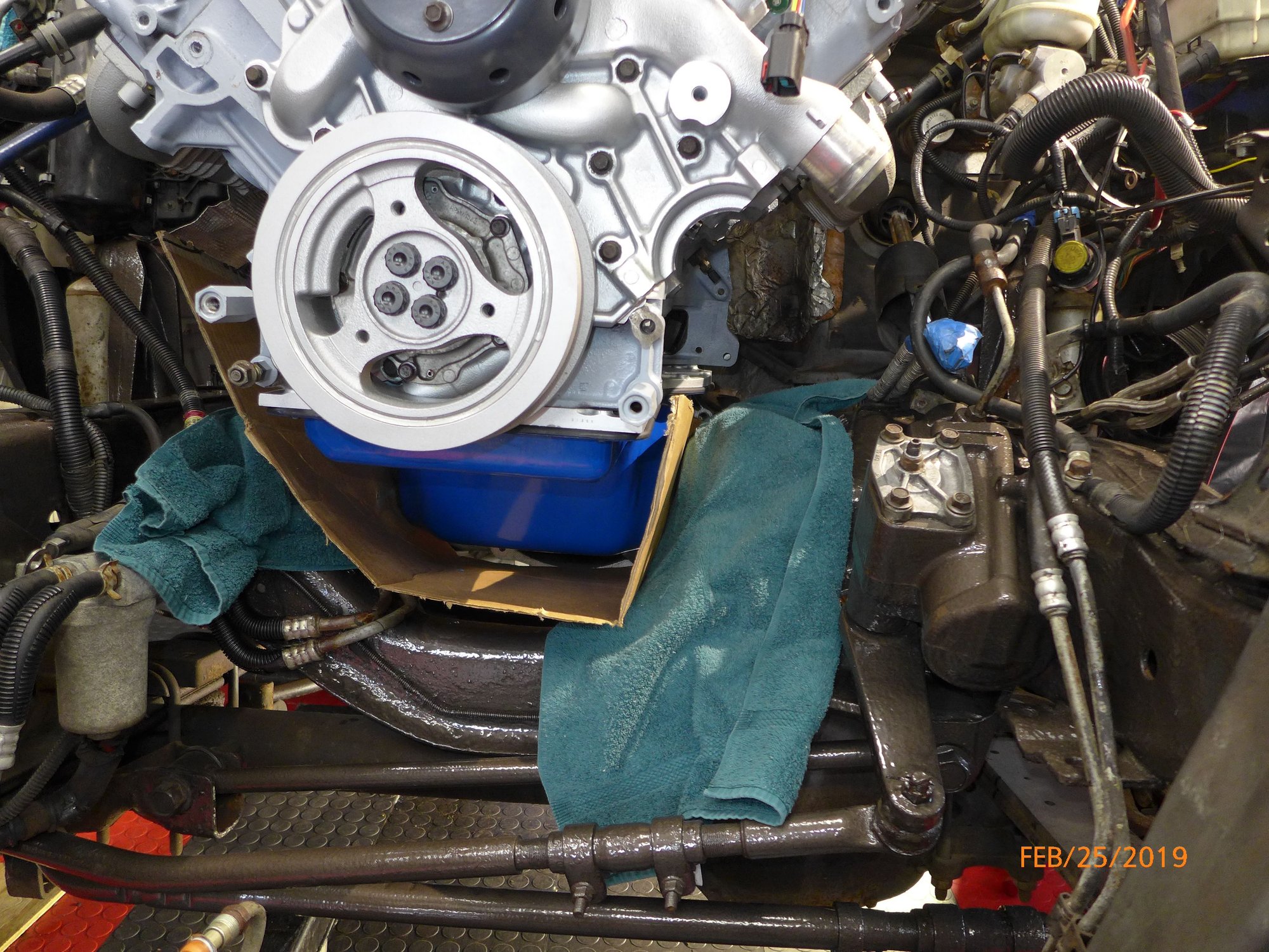

In The Truck
Heading for the engine bay.
Almost in place.
Done. Fully bolted to the transmission, motor mounts bolted to the frame.

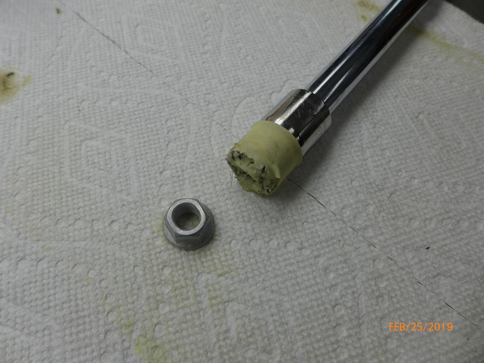

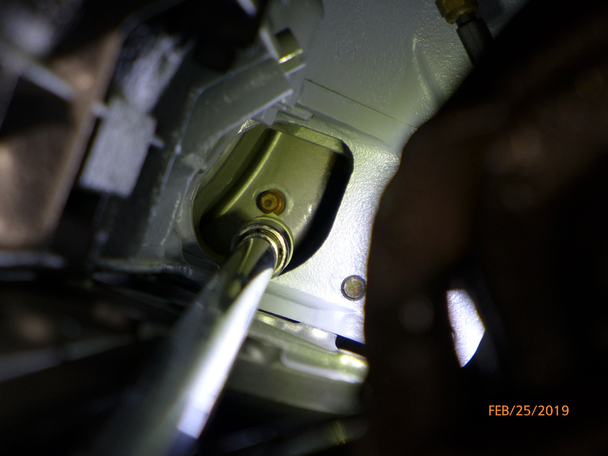

While stuffing each torque converter nut into the transmission at the end of a 36" extension, this cheap nut holder helped immensely. I cut an inch off a finger of a nitrile glove and slid it over the end of the 14mm socket. None of the 6 nuts fell out of the socket
Reaching into the transmission with a torque converter nut stuck in the end of the socket and 36" extension.
