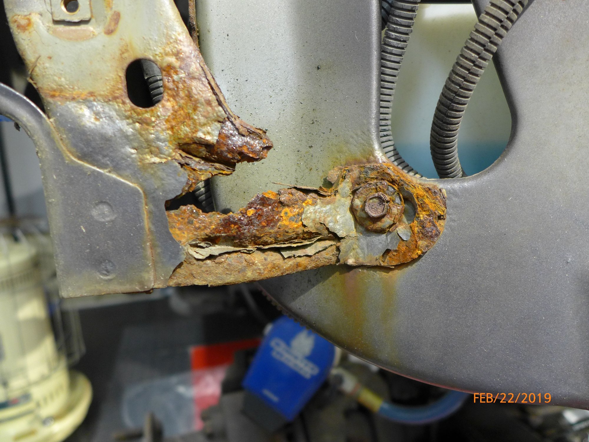

Rust
The engine bay was typically rusty, so I used some rotary brushes on the Dewalt drill and knocked off the crusty stuff. Next I painted over the rust with Rustoleum rust-inhibiting paint. It isn't great looking, but maybe it will help some.
This passenger side front fender brace was holding on with a prayer. I cut it off, fabricated a replacement, and am waiting for the paint to dry before attaching it..

I did mine with POR-15 mostly, and after a year and a half there are areas that show pops. Other areas I used Eastwoods and that has held.

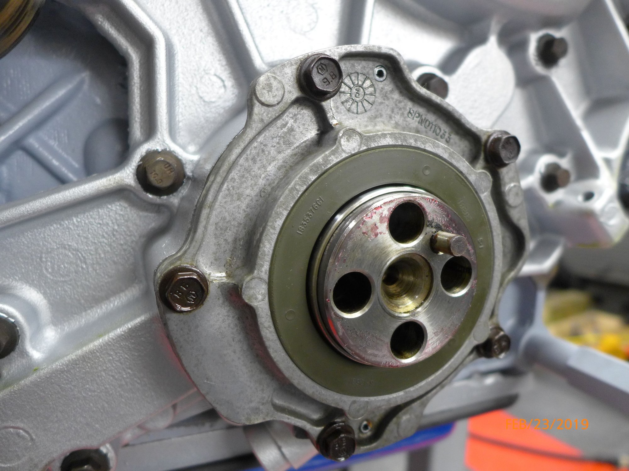

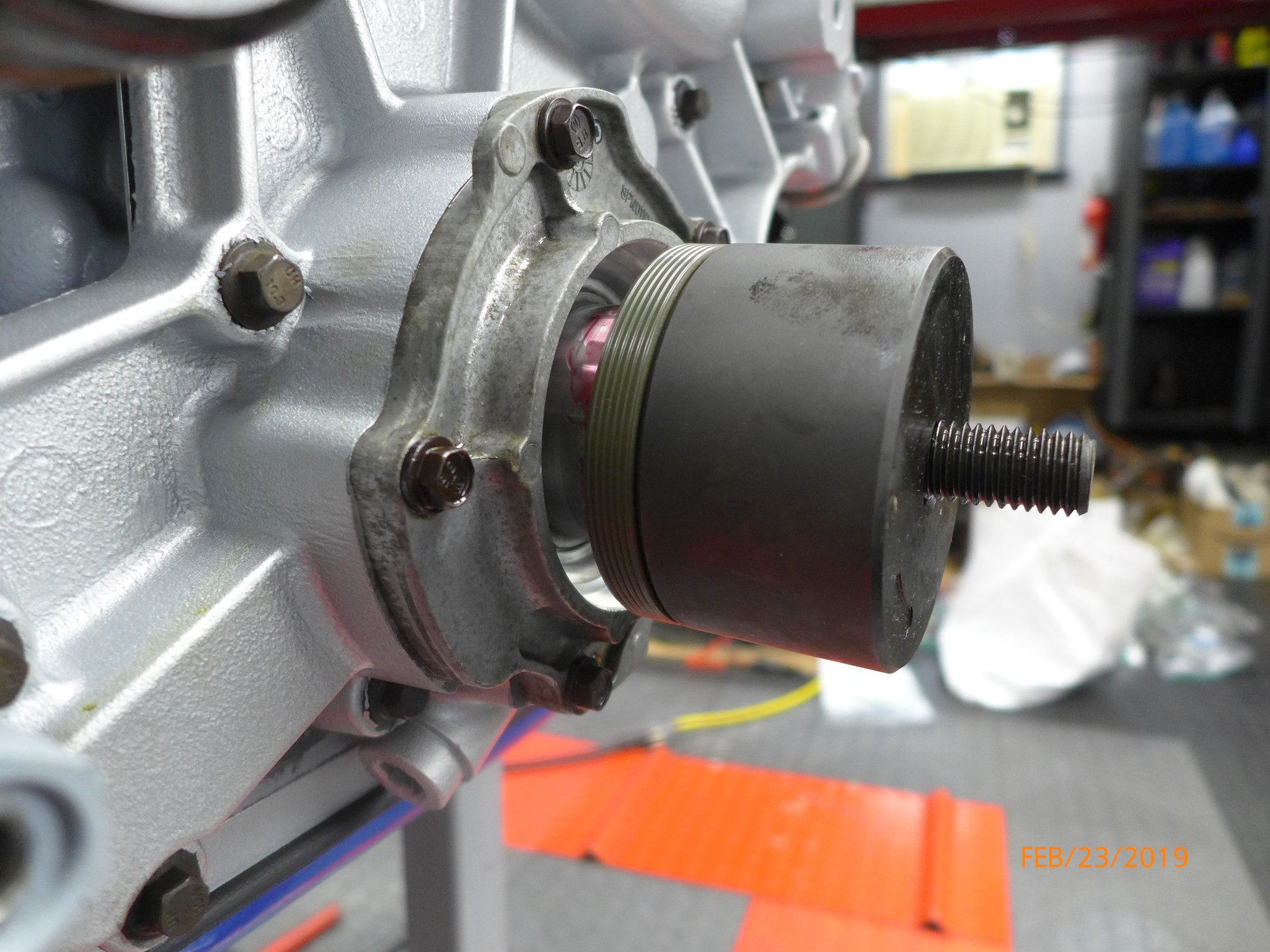

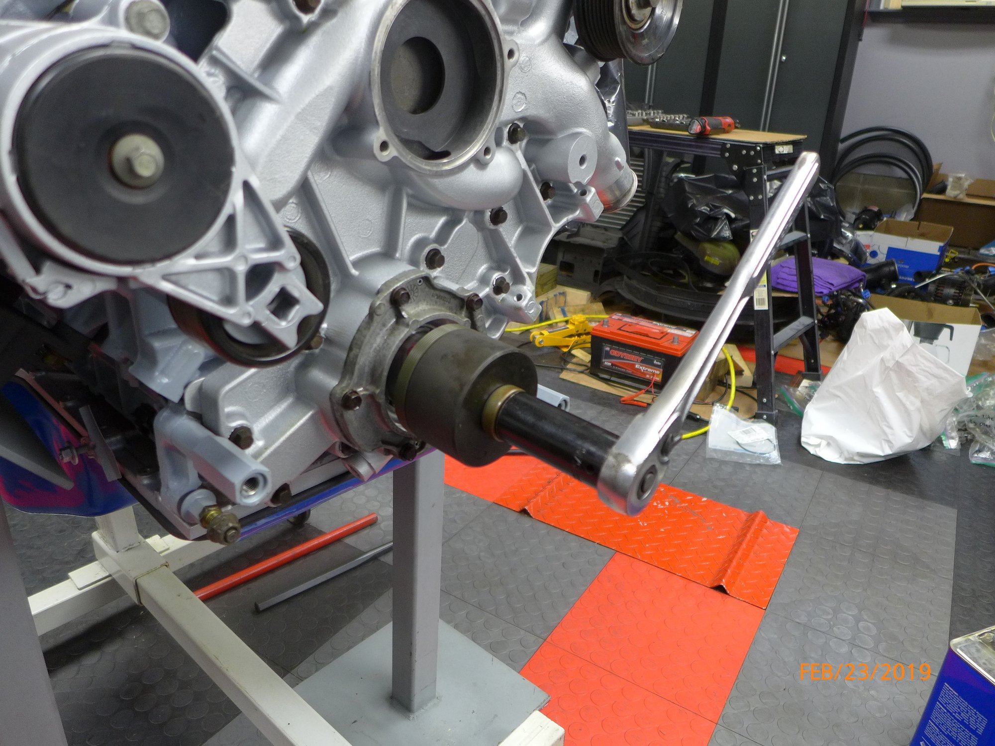

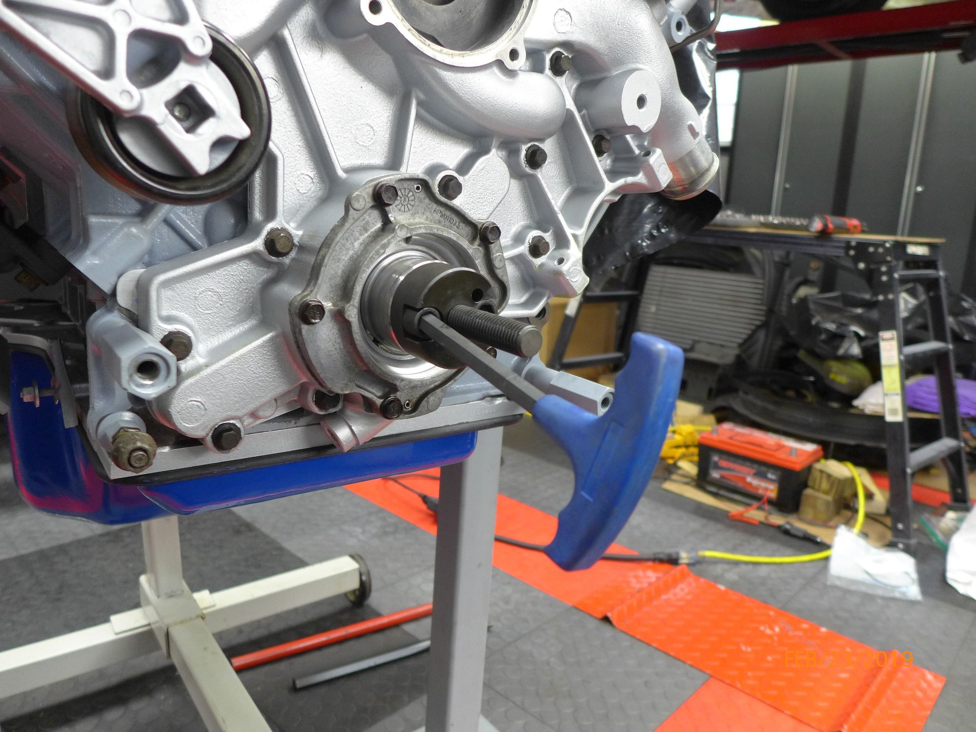

Oil Pump
The replacement oil pump from Auto Nation arrived yesterday, so now I can get back to finishing the front of the engine. New oil pump gears are in, cover is on. Placing the 1st part of the seal installer on the crank.
Now the new seal is loosely on the crank, with the installer shell pushing from behind.
Ready to push the seal in place.
Done.
Balancer is mounted next. I tossed out the TTY factory bolts and used ARP bolts torqued to 90 ft/lbs.

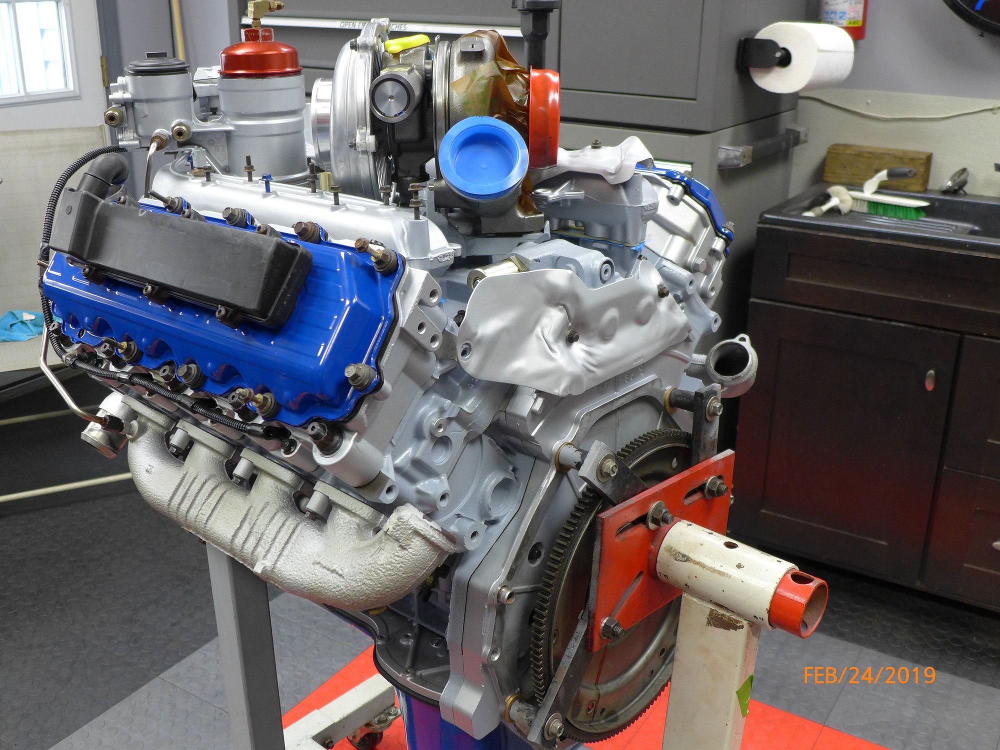

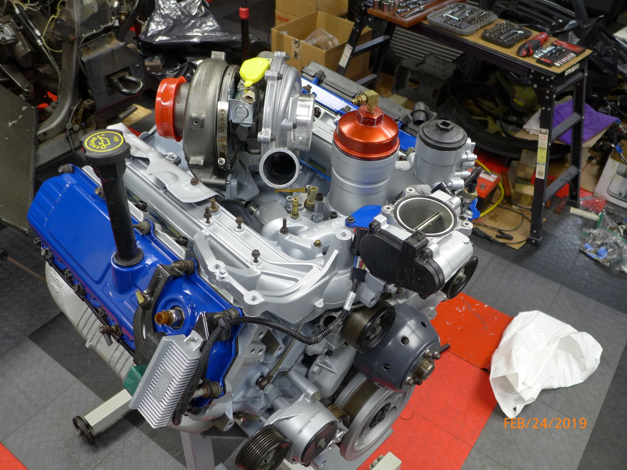

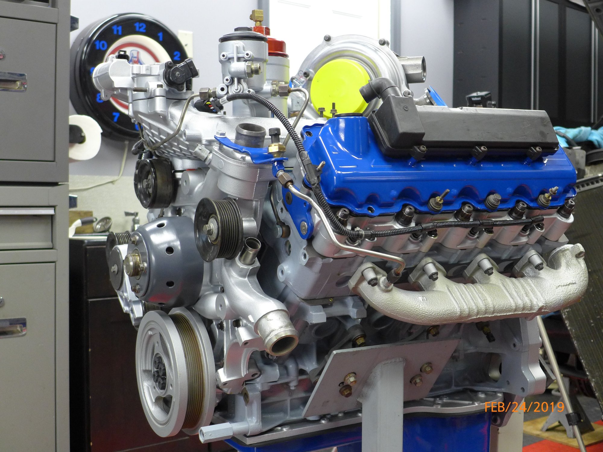

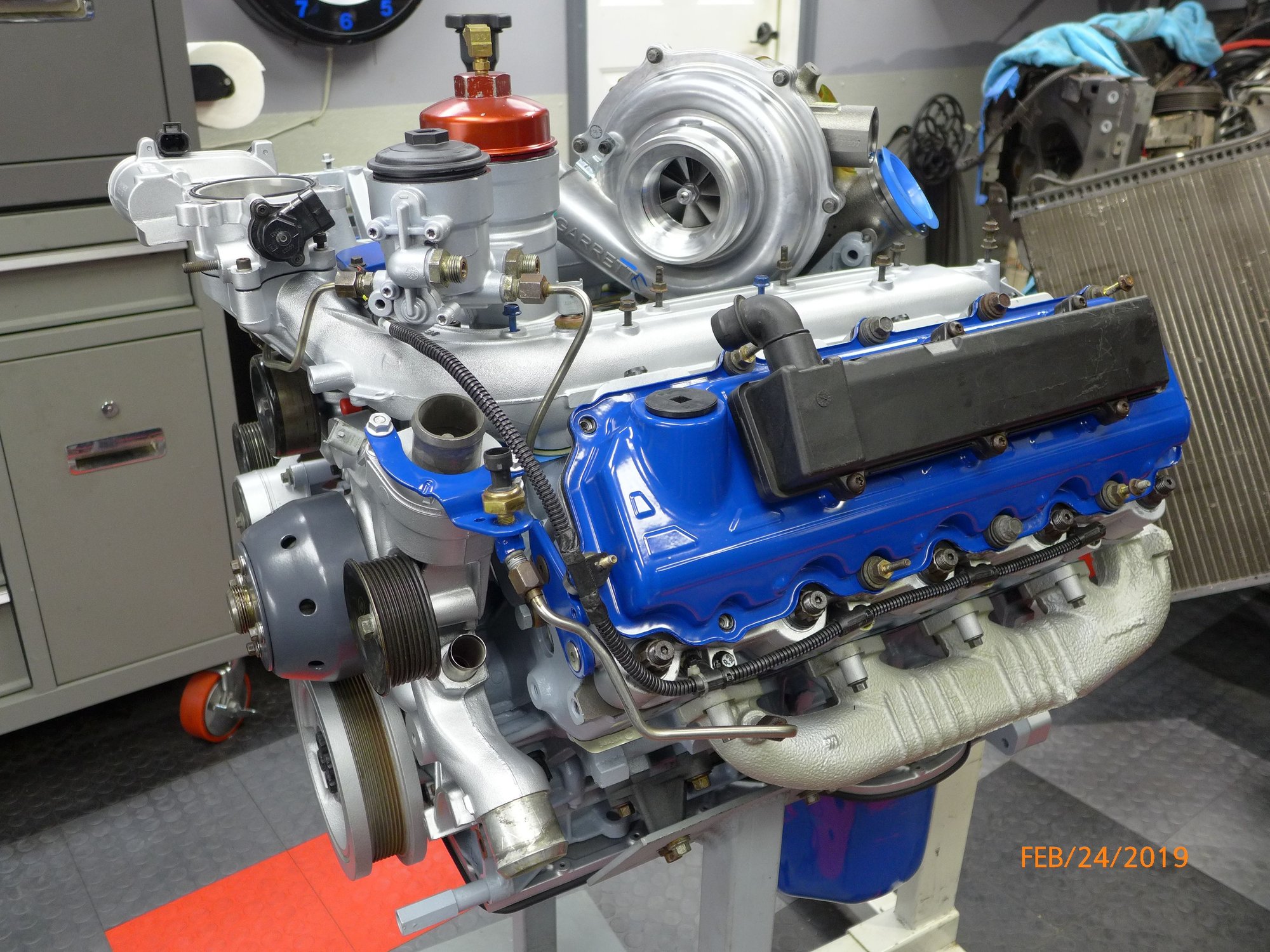

Ready to Install the Engine
Today I stacked a lot of the top end pieces on the engine to see what it looks like with them. Tomorrow a lot of those pieces have to come off for the installation, unless I decide to move it into the family room as a conversation piece.

Why not eliminate the throttle body? I like the grey BTW.
Old Feb 24, 2019 | 06:53 PM
  #283
SmackDaddy's Avatar
SmackDaddy
Joined: Sep 2016
Posts: 3,941
Likes: 240
From: Texas
Let her breathe!
Old Feb 24, 2019 | 06:57 PM
  #284
HTM101's Avatar
HTM101
Joined: Apr 2017
Posts: 278
From: Maryland
When I removed the throttle plate in 2004, I thought it was effectively the same as removing the throttle body. Is there more to be gained by removing the actual body?
I appreciate your comment on the color.

It just frees up clutter and gets rid of uselessness. Not necessary I guess.
I'll erase this in a bit so I don't clutter your thread but I'm a little partial to the grey.
This is my 6.9 I did 10 years ago or more.
