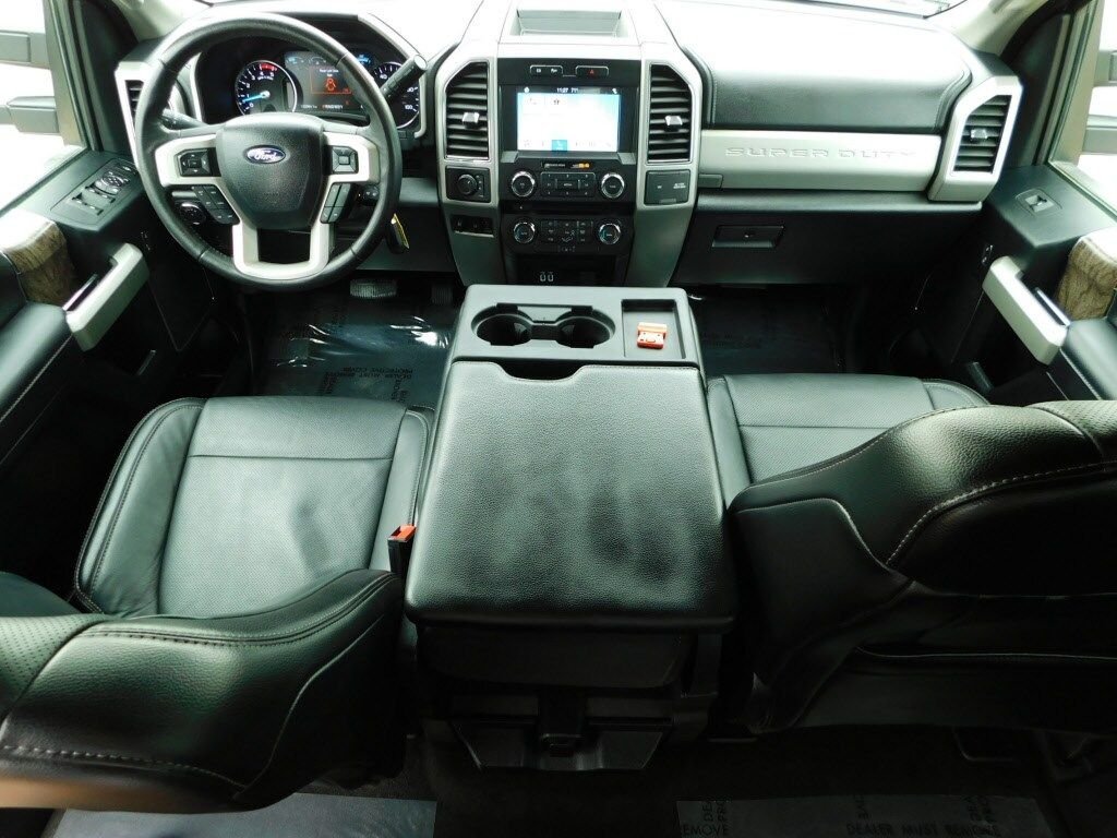

Hi, I’m new here and hate to start my first thread with a favor but...
Any chance you could put a parts list together for me? I just sold my 08 and picked up a 2018 f250 lariat, sadly the only thing I didn’t get was my center console and I don’t think I can live with it!
its black leather interior but I’m not sure what the trim is called? Maybe you would know from the attached pic?
any help is greatly appreciated!!!

I took my original list which was for XL/XLT owners and have added the changes in bold red for a Lariat with Ebony (black) interior. Prices have gone up a lot since I did this originally.
HC3Z-25043C36-AA = <043C36 Rear Cover/Support $11
HC3Z-2504567-BA = <04567 Rear Cup Holders with chrome trim $44
HC3Z-25045A36-CA = <045A36 Console (Medium Earth Gray) $233
HC3Z-25045A36-CC = Ebony
HC3Z-25045A76-AB = <045A76 Front Cup Holder and Trim (Medium Earth Gray) $117
HC3Z-25045A76-AA = Ebony
HC3Z-25045E24-BA = <045E24 Rear Vents (Armor / Medium Earth Gray) $76
HC3Z-25045E24-EA = Ebony (no heated rear seats)
HC3Z-2504608-CC = <04608B Side Trim (Medium Earth Gray) $21
HC3Z-2504608-CE = Obsidian
HC3Z-2504609-CA = <04608B Side Trim (Medium Earth Gray) $25
HC3Z-2504609-CC = Obsidian
GL3Z-1506024-BB = <06024 Armrest $129
HC3Z-2513546-AA <13546 Tray $12
HC3Z-2504608-AA <04608A Slider Door $68
HC3Z-2504608-BA = Sandalwood
FL3Z-1504338-DC - Dash Bezel RH (Armor) $38
FL3Z-1504338-FB - Obsidian Metallic
HC3Z-2504339-DA - Dash Bezel LH (Armor) $40
HC3Z-2504339-FA - Obsidian Metallic
FL3Z-15046B32-BA -Sync Dash Opening for Slider door $20
FB5Z-19A495-AB - Rear USB Hub $28
HC3Z-25672A40-BA Cap $5
HC3Z-25672A40-AA Cap $5
HC3Z-14A318-AH Wiring Harness $19
Ducts:
FL3Z-18C420-C
FL3Z-18C420-B
Fasteners:
W711656-S424(3)
W507125-S424 (2)
W707628-S424 (2)
W714972-S300 (11)
(6) M6x25mm Bolts
Last edited by h20camper; Feb 3, 2020 at 10:12 AM. Reason: Two Part # Corrections for Lariat Trim (Green)
