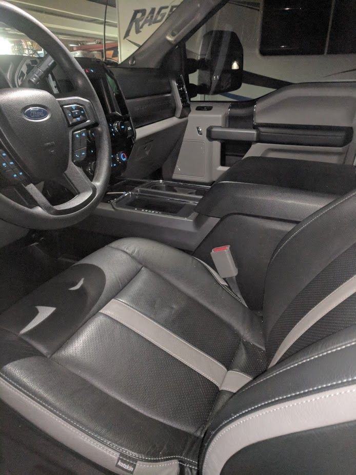

Got my console installed over the Holiday weekend. It wasn't cheap but was cheaper than an option if I had ordered it. It was definitely a worth while upgrade as its a very nice console.

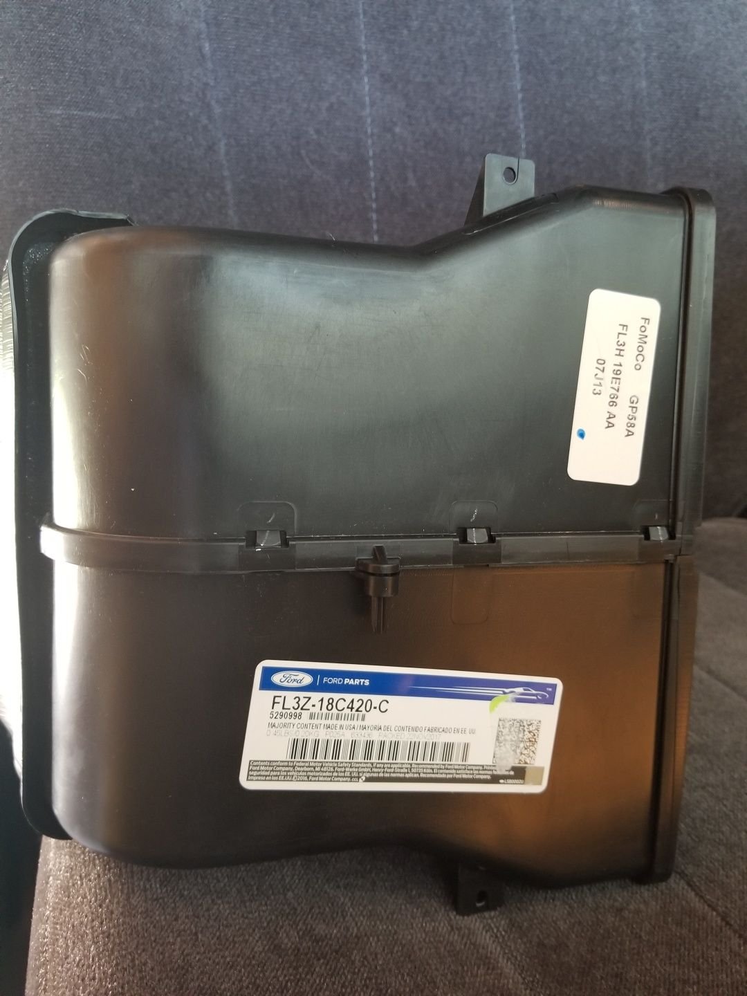

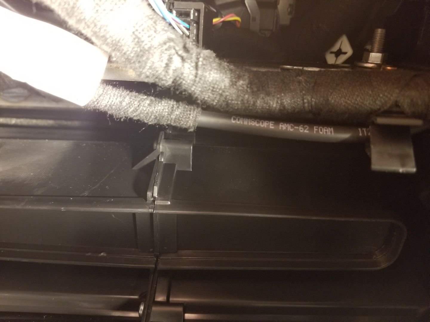

I bought the two HVAC duct work pieces for $20 so that the rear vents didn't work in just the heat (floor) mode. The under the seat ducts are only active in heat (floor) mode. I wanted them to work like OEM design.
Here is where you need to remove the cover at the bottom and attached the duct work.
Duct work that attaches to existing piece under dash.
Attaches to previous piece and then to console
All installed
