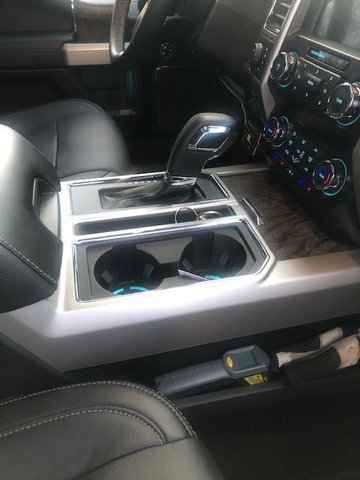

Do you mean like this?
Console shifter conversion
Why yes, yes it is! Is that your truck? Any details you can share?

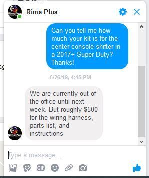

I know of one company, a rim repair company of all places, that offers a conversion kit. It's wiring and instructions for ~$500. A little rich for me when you need another $300+ in parts (shifter and cable...plus the console insert if you don't already have it). BoostedGreyGoose was working on a conversion too, so I am anxiously waiting for it.
That’s really slick! How’d you do that?
https://www.facebook.com/rimsplusrimrepair/
Yes that is my truck and I did the conversion a couple weeks ago. I had also talked to the rim guy and when I last talked to him he said he wasn't doing it anymore. So, after a little more digging and about to tackle it on my own I ran across another guy in Louisiana (of all places) who had done it too. He was selling the wire harness or a complete kit. Since I figured I knew what I was doing I wanted the harness only but after talking to him for a bit I decided to go with the full kit. There was a lot more to it then I had expected and I'm glad I listen to him and did the full kit. He uses all new Ford parts and makes the harness himself. I was extremely impressed with the harness it looks as factory as anything under the dash. His instructions were step by step and had pictures too. The install took about 5-6 hours but 2+ of those were because I broke a clip that holds the shift cable in place and had to fab one out of steel. (That story is one in itself) If I had to do the install again I could do it in a couple hours knowing what I know now. To say the least I am supper stoked with the whole thing. Money well spent as far as I'm concerned.
I know your wanting to know who this guy is and how to get ahold of him....well if I tell you then everyone will want to do the conversion and it will make mine less impressive.....just kidding...sort of. The guy is Thomas Leger at Platinum Performance https://platinumperformance.io/ . Tell him John Gill sent you. There is lots more to the story but I need to get out of the office and head home. Yes, I know I didn't say how much that is something you can talk to Thomas about. I will say that at first I thought it was kind of high but after I completed it I think it's a fair price. He is a real good guy and very helpful and knowledgeable about the conversion.
