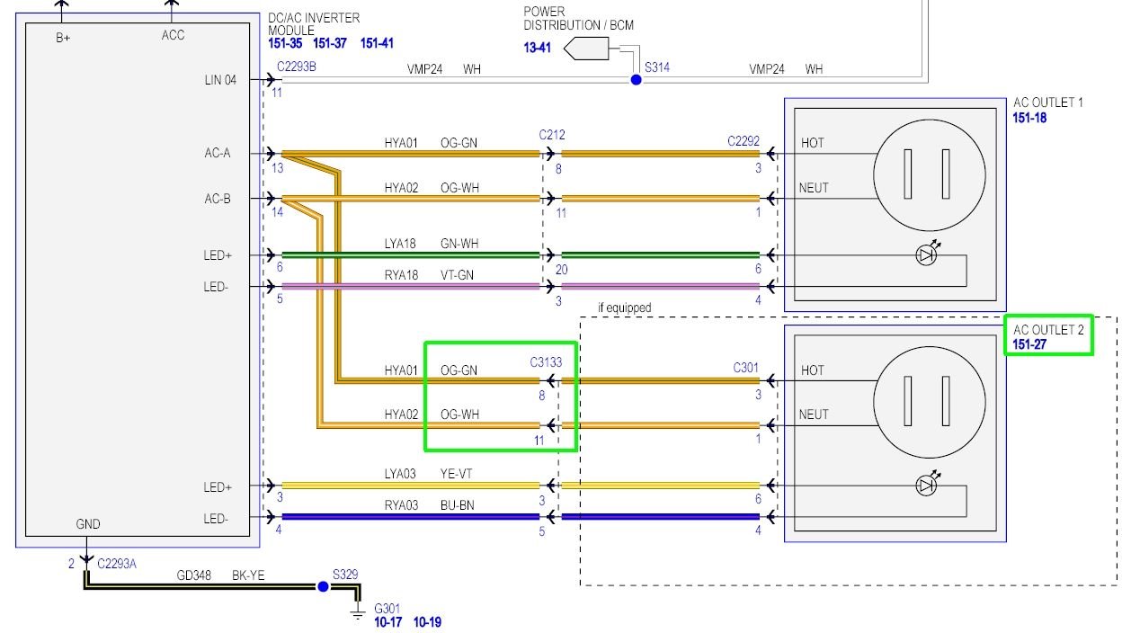

The AC Power from the rear console comes via the connector (C3133) on the floor next to the passenger seat. PINs 8 (Orange/Green) and 11 (Orange/White). The LED is PINs 3 and 5.

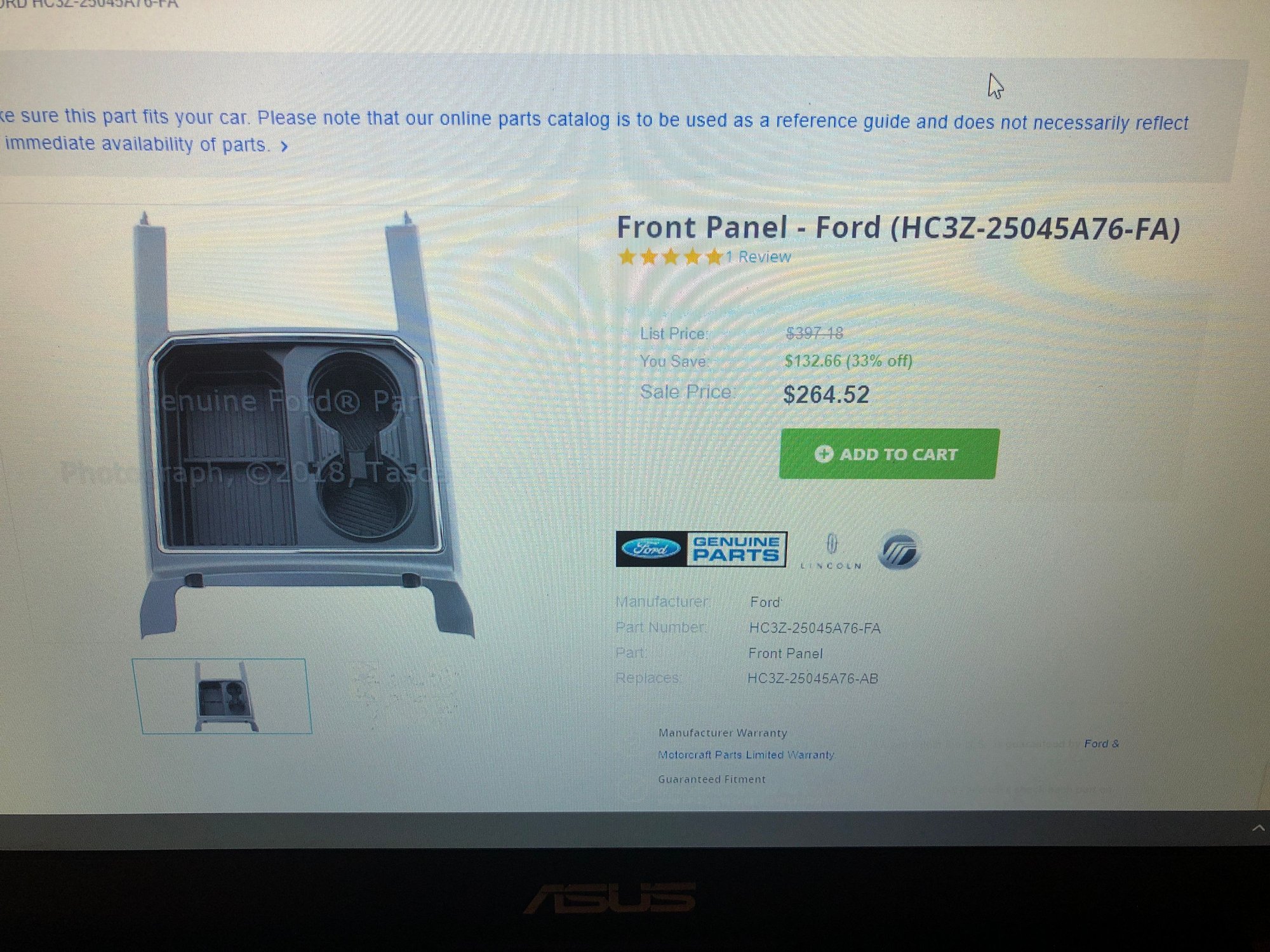

I know part HC3Z-25045A76-FA has the slider.
Part ending in AB was replaced with the part number here.
Here is a pic of what I have coming. I ordered it from Fairway Ford though.
[***************]-25045A76-FA

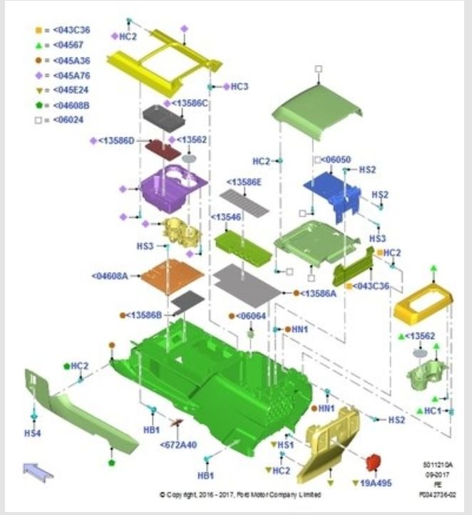

This picture should explain it. The main sides are part of the console itself. There is a lower piece on the side that are separate.
That's exactly what I thought. I was talking about the main body, not the lower front trim pieces. That's why I was surprised when you said you replaced the rear panel to match the color - I mean if the console was java color, and you replaced rear trim with grey, what did you do with the main body that's still java? That's what made me thing those main body panels might be replaceable, but it seems they are not.
