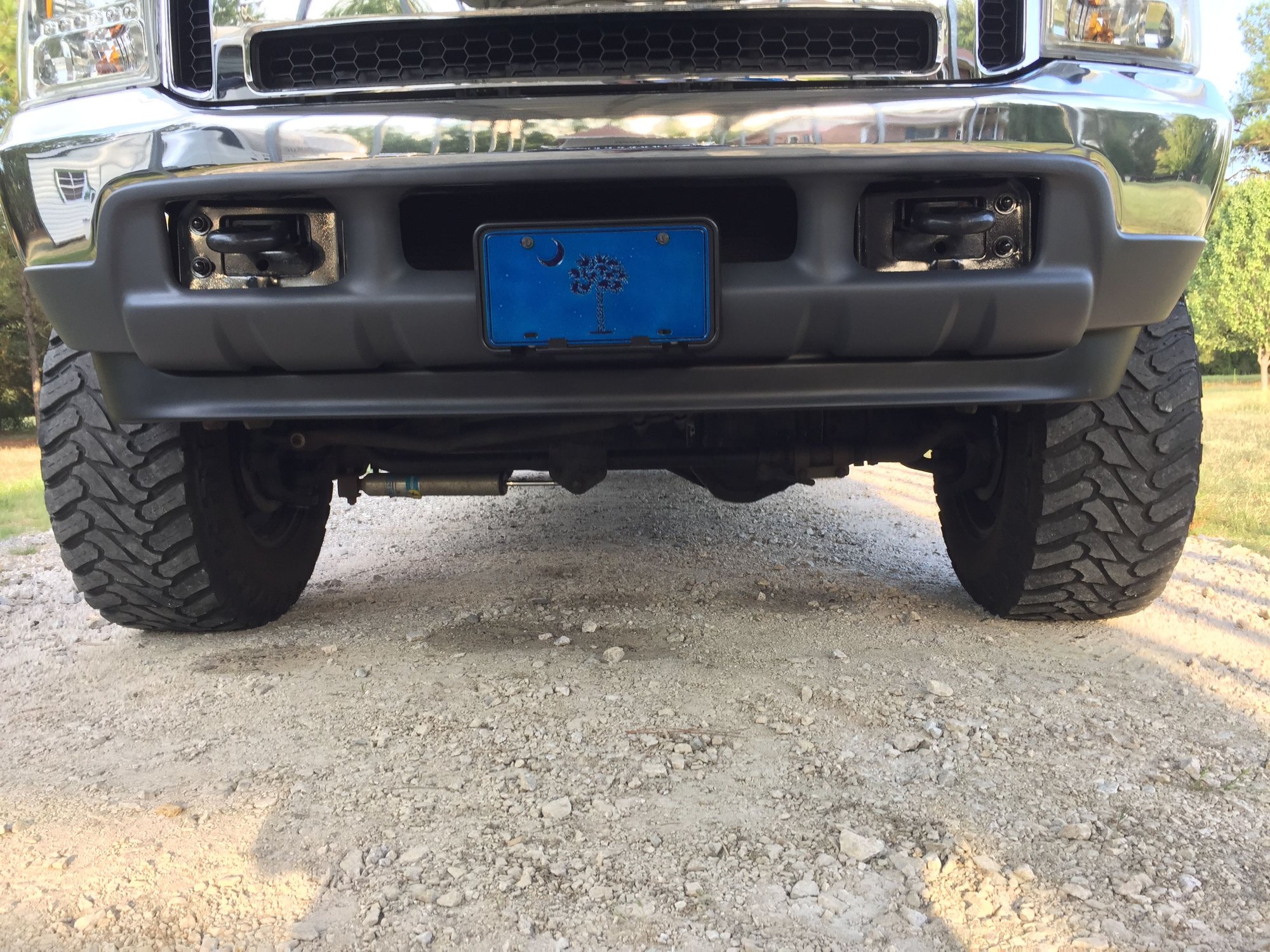

Didnt want to read the whole thread but.... The opening(s) where the air deflector meets the bumper.... did you change this? My truck, an '01 7.3 does not have this opening. Just wondering. Thanks.
Old Mar 24, 2022 | 05:17 PM
  #173
01__Excursion's Avatar
01__Excursion
Joined: Nov 2017
Posts: 3,096
Likes: 534
From: Rock Hill, SC
I had to do a little research for your answer as I didn't remember. No, I did not modify the lower valance openings, but I did replace the original front bumper a few years ago because the chrome was starting to fade. In doing so, I just ordered a new front bumper cover, and lower valance from the dealer. The original lower valance was hacked up by the previous owner to mitigate the larger tires from rubbing.
In looking at past pics, I had what you have now. Either I never noticed the change, (I'm sure I did), or I just accepted it and moved on. So current replacement under valance now has these 4 openings.
I remember when I replaced the rear bumper cover, it didn't come down as low on the face of the bumper, maybe 1/2" shorter, but I will be picking up the new rear bumper tomorrow at the dealer.
Pic from September 2016.

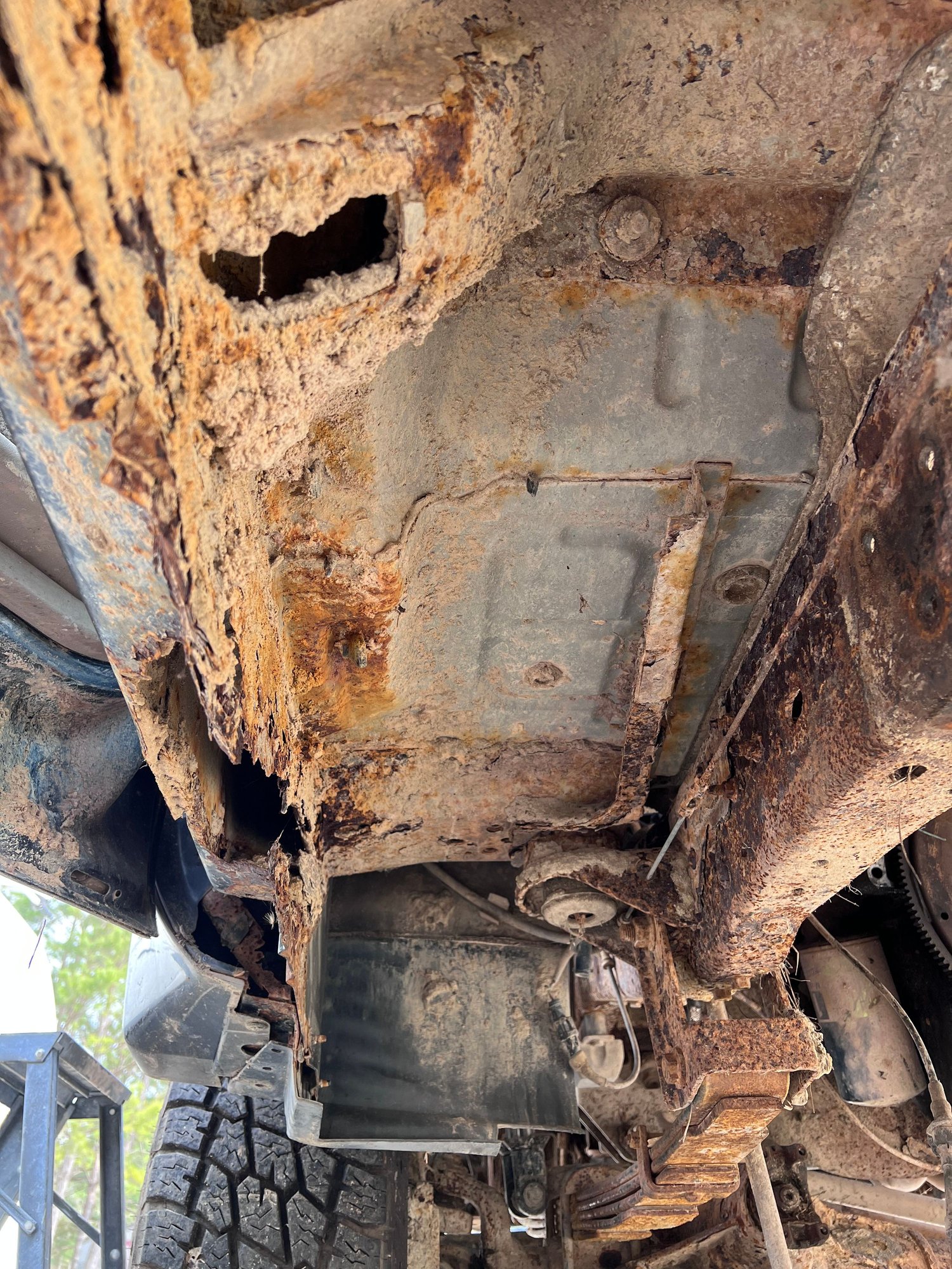

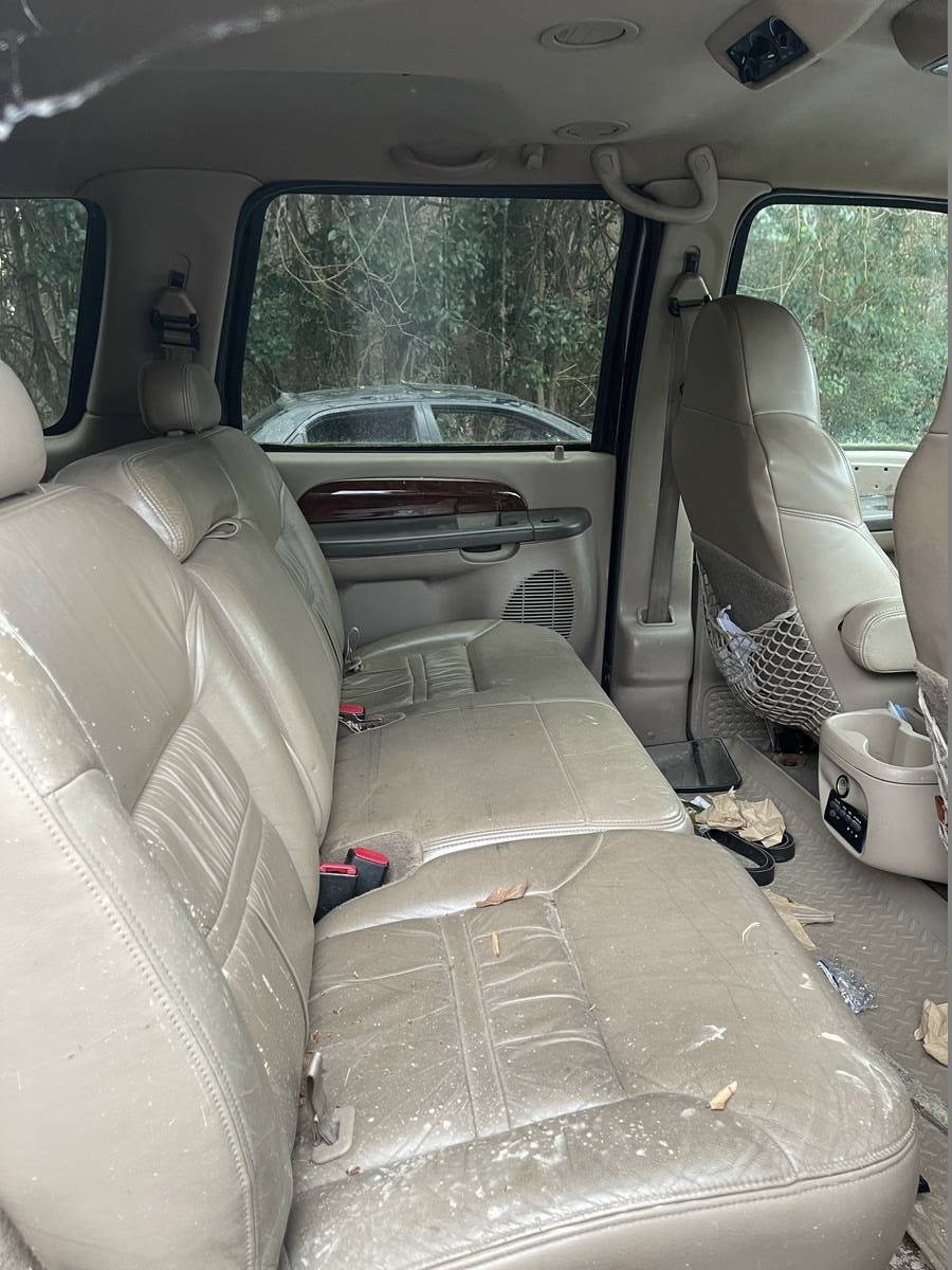

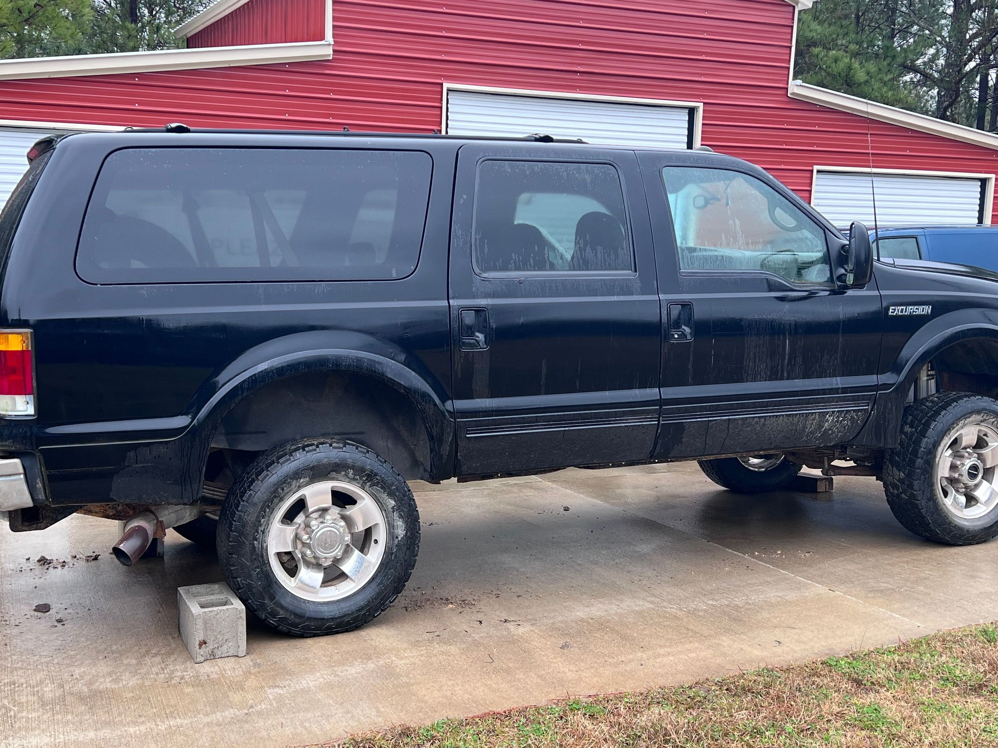

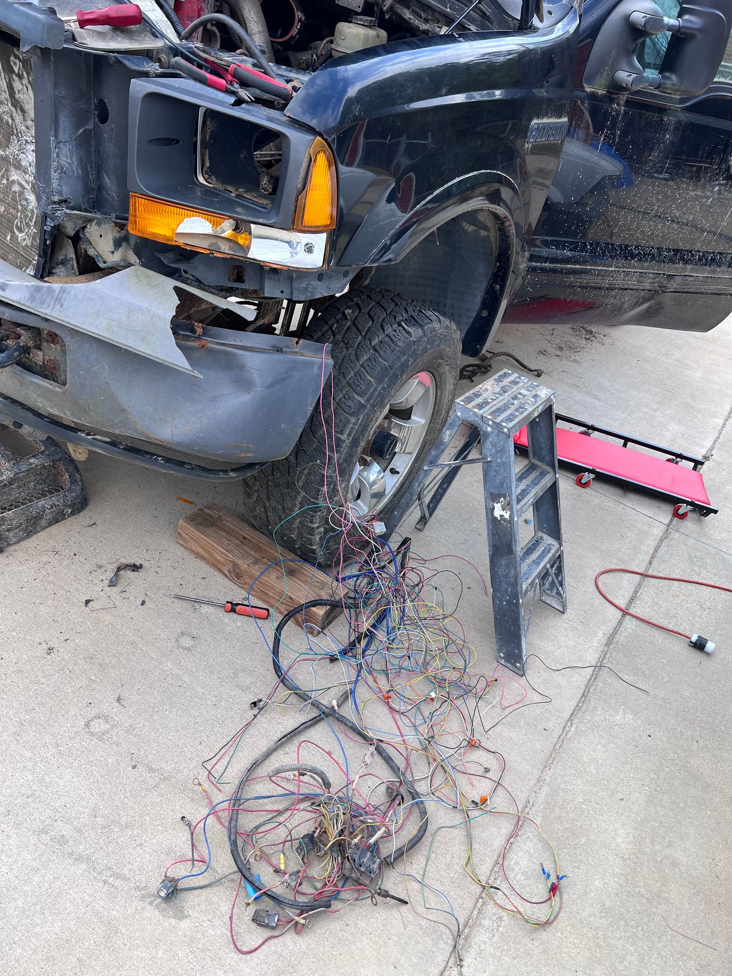

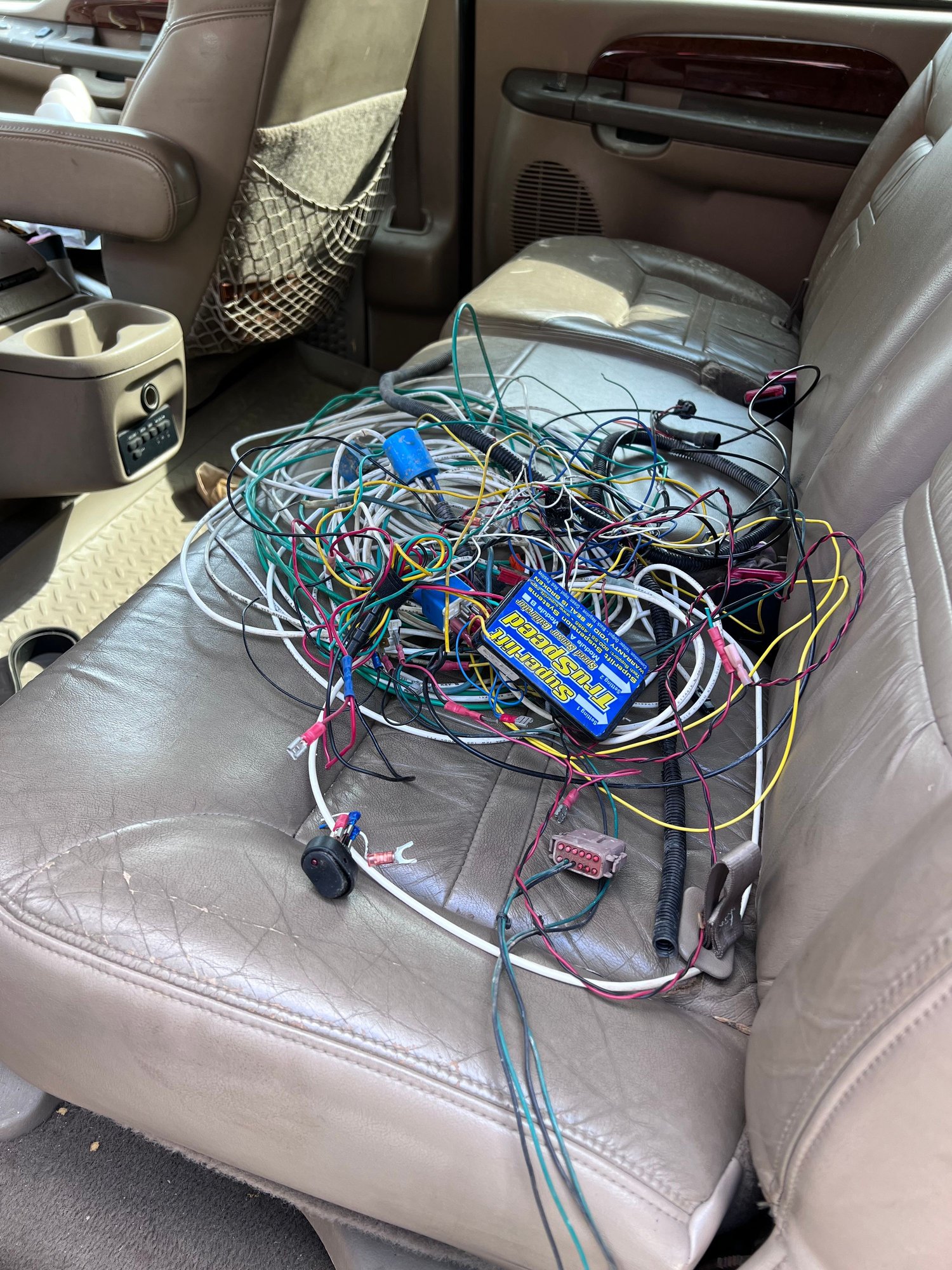

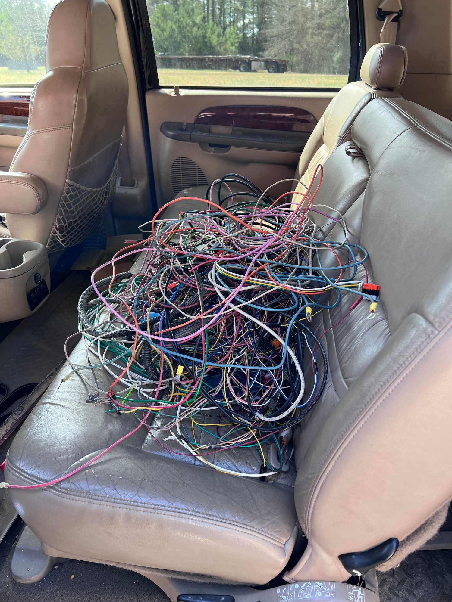

Late Feb I picked up a 2000 7.3 parts donor vehicle. This will provide a small stock of some critical mechanical parts, and engine if ever needed. It's rough, has tons of rocker cancer, but I plan to slowly pick at it. I was able to connect my transmission range sensor to the harness, and get this one started to verify what works, and how it runs. One of the things I decided to transfer over was the parking aid system. My X and probably many others that weren't fully equipped with it is partially wired already. Since the bumper, sensors, and sensor bumper brackets are still avail from Ford, I have already ordered them.
There was an unbelievable amount of accessory, and aftermarket wiring I have already removed. This was done so I could clearly understand what factory stuff works, and what does not.

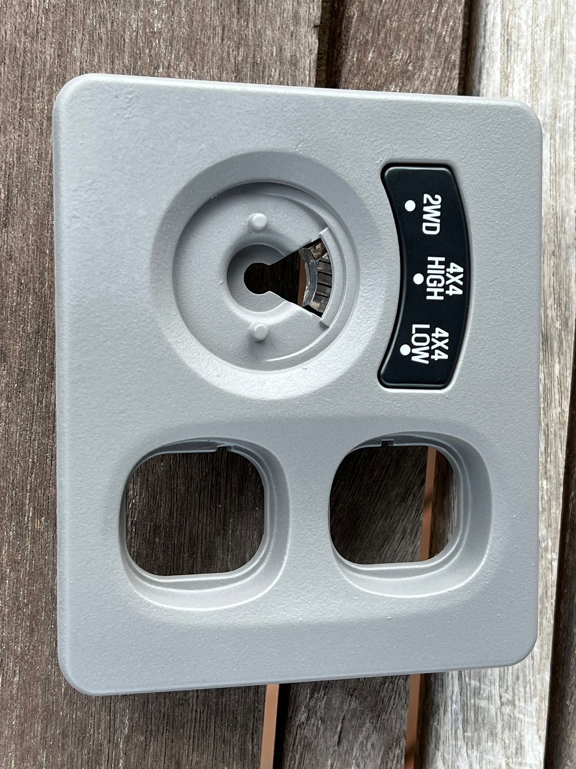

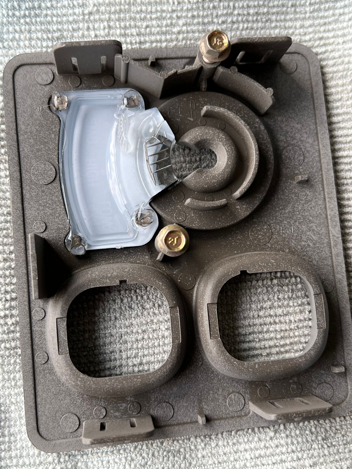

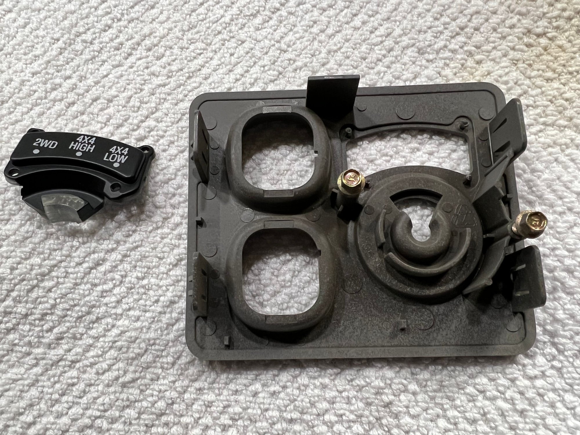

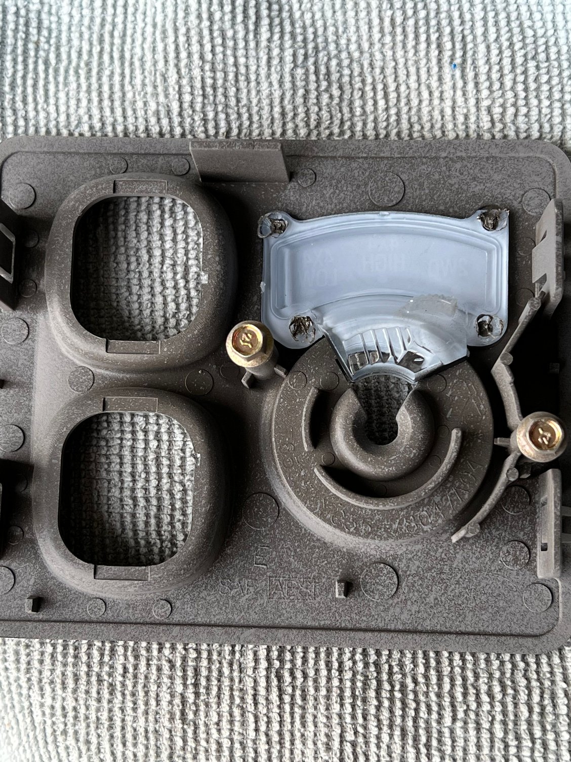

Found another 2001 in the semi local junkyard Saturday, had been there only a day. I grabbed the park aid system, and park aid dash trim from it to have another spare in case the black 2000 system had issues. The black park assist powers up, but defaults to off when the vehicle is put into reverse. This may be because the interior lights do not turn off when the doors are closed, I believe this is from the lift-gate door light switch, which I need to look at to verify then re-test the park system.
Started the simple task of changing the color of the trim from the Dark Parchment to medium Graphite. My original dash trim is actually black, but has that wood grain trim added to it from the previous owner. I will probably transfer that over too. I will still have a complete spare dash trim from the black 2000. I trimmed the plastic spot welds with an exacto knife, primed with a plastic adhesion promoter, then color sprayed. Re melted the welds, and used a little hot glue.

You do. There are also Weathertech mats in front, and either weathertech or OE in the rest. These are not my color, and will be listed when I clean them up.
I'm cheap too, nearly all of that wiring I pulled back through the way it went in. Good wire is always nice to have on hand.
