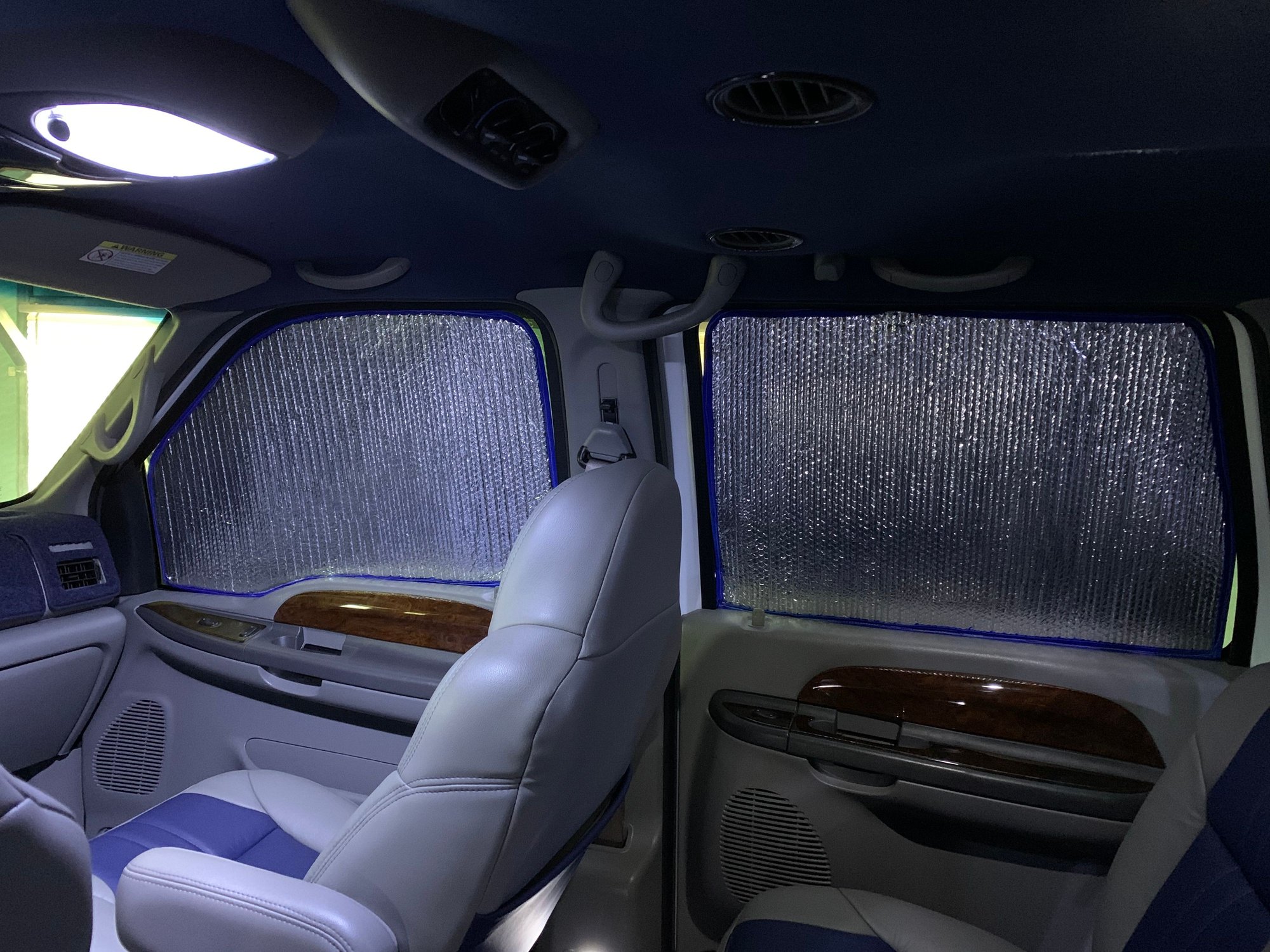

Banged these out a few years ago before the garage was built, and the leather redone. After the reflective material was cut, blue bias was sewn around the perimeter. Going forward I still use them when I leave the truck at the boat launch in the summer and man they make a huge difference, did all 6 side windows.

I'm really diggin' the custom shades. Texas summers are BRUTAL. I need to get on that before it starts really heating up. How do you keep them held in place?
Props on the the dome light. I took my overhead console apart and swapped in a VLEDS 26-LED 194 bulb in each location and repaired the passenger switch. It's better than stock, but they still leave me wanting more. I wish the color was closer to 4000K too. Perhaps one of these days I can get my hands on a second console and fabricate something special. My thing is, particularly for the interior, I want things custom and, so much as I can help it, I want it to look factory to the unassuming eye. The rectangular panels would irk me over time.

The solar material was cut slightly oversize so I just press fit all around the edges.

I will say it was a real bear rough cutting a piece of that stuff and holding it up against the windows and tracing on it with a sharpie marker, my rear quarter windows need to be redone as they are a little shy of being the snug fit I wanted. But this time I have a very close template.

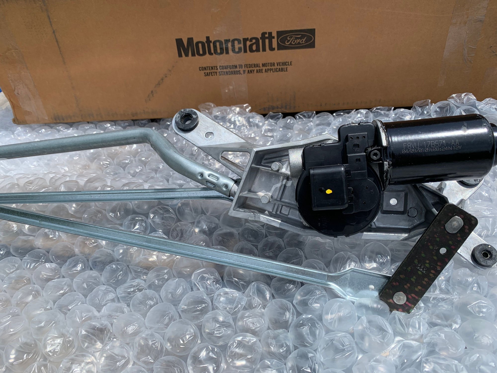

Decided to add a few more new and NOS parts to the X.
New cowl trims with washer nozzles, hoses and gaskets. found a NOS wiper motor and armature assy too, Ford discontinued the complete assembly, and only offers each separate at a much higher price. My armature assy was minus a bushing on the drivers side bottom and was very sloppy. A new long gasket that press fits on both cowl halves that contacts the hood was added too.
