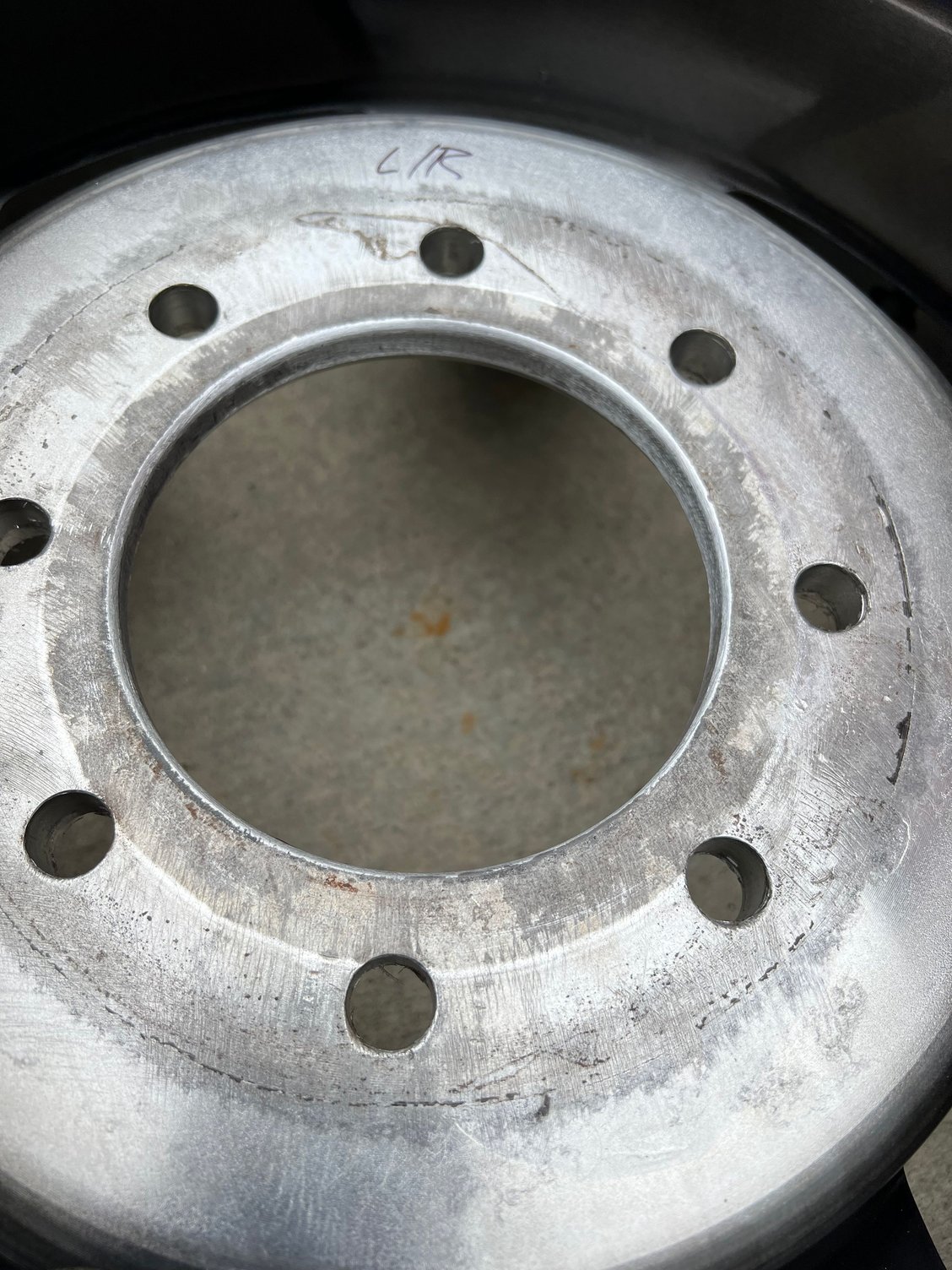

I'm not sure why they have such a snug fit in the rear, any ideas?
I'm going to try one of the fronts on the rear to see if I have the same issue, and probably try them on the X they easily came off of. I can work around it at home, but if there is an issue on the road, I'll have a problem.

I'd clean those rear hubs up good and give it a try. Are there any nicks/dents on the wheel itself where it fits on the hub?

It might also be worth using a Dremel or similar to lightly grind out the hub opening on the wheel a hair. You wouldn't be taking off enough to damage the wheel at all,just enough top clean it up essentially.

Not at all, my OE rims that these just replaced fall off like they are supposed to. This is only happening on the rear.

From: Rock Hill, SC
I though t about that, but that might make it too loose on the fronts. I did use a wire wheel on the drill to make sure no powder clear was on the inner surface. I need to play musical wheels between both X's, and wheel sets to see what's going on. The parts X did have the 2 sets of threads between both axles, the coarse, and fine thread. I can't remember, and I didn't check which axle was coarse or fine, but one of those axles was probably changed.

That would depend mostly on if those are hub centric or lug centric wheels. If they are hub centric then that won't work

Yes hub centric, they are OE 2004 direct bolt on Ford..

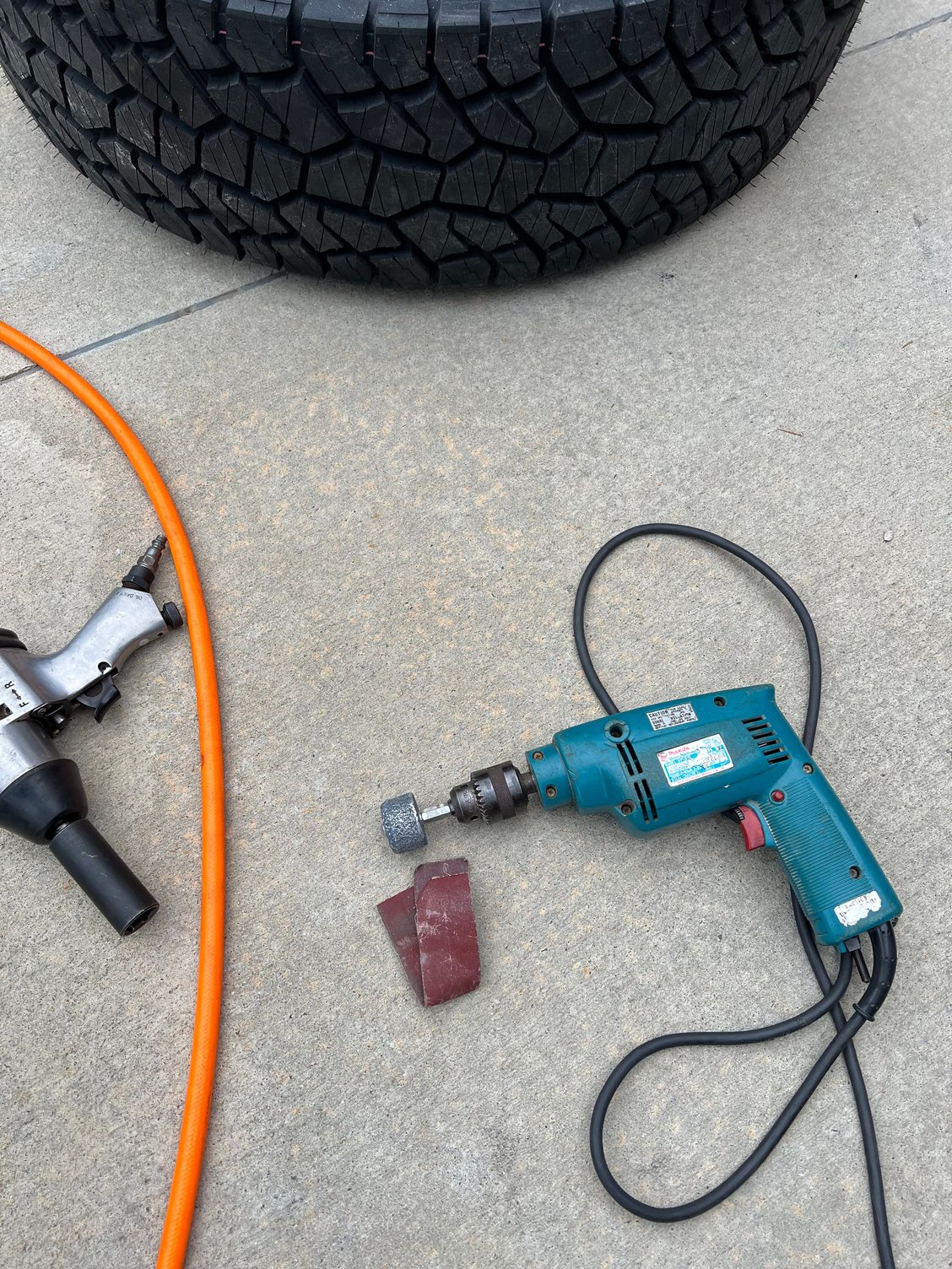

This is all sorted out, except the weights. Sometimes I just gotta be ignorant I guess. I used a stone bit, and some sanding cloth, and got both rear to fit as they are supposed to. As far as the weights, if they fly off again, I will see what other clip-ons they have, or just do stick on for the inner. Most of that aluminum on the stone is from the flat stock I used on the LED lights under the bumper.

Glad that you got the wheel seating sorted out, I was going to suggest the new powder coating was thicker than stock and was causing the snug fit.

Yes, that was surely part of it, but on the pass rear wheel, I actually used a rotary wire brush for the drill, and scrubbed all of that off, and still had a snug fit. So I was not ready to start shaving any metal from anywhere.

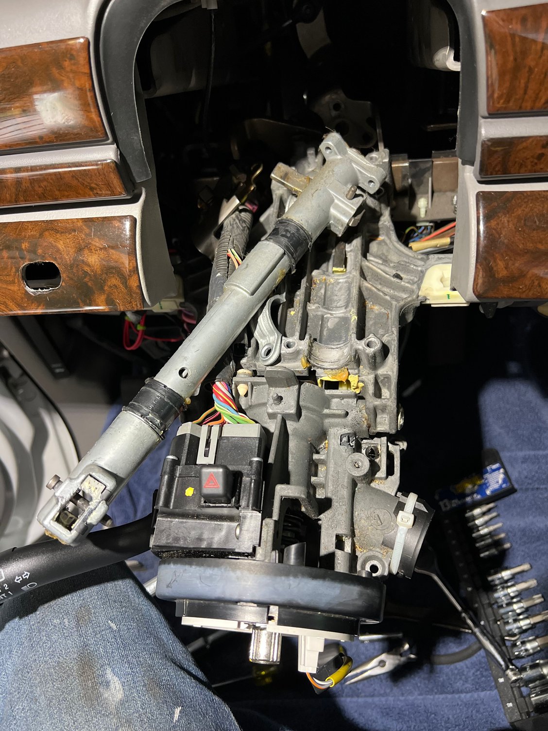

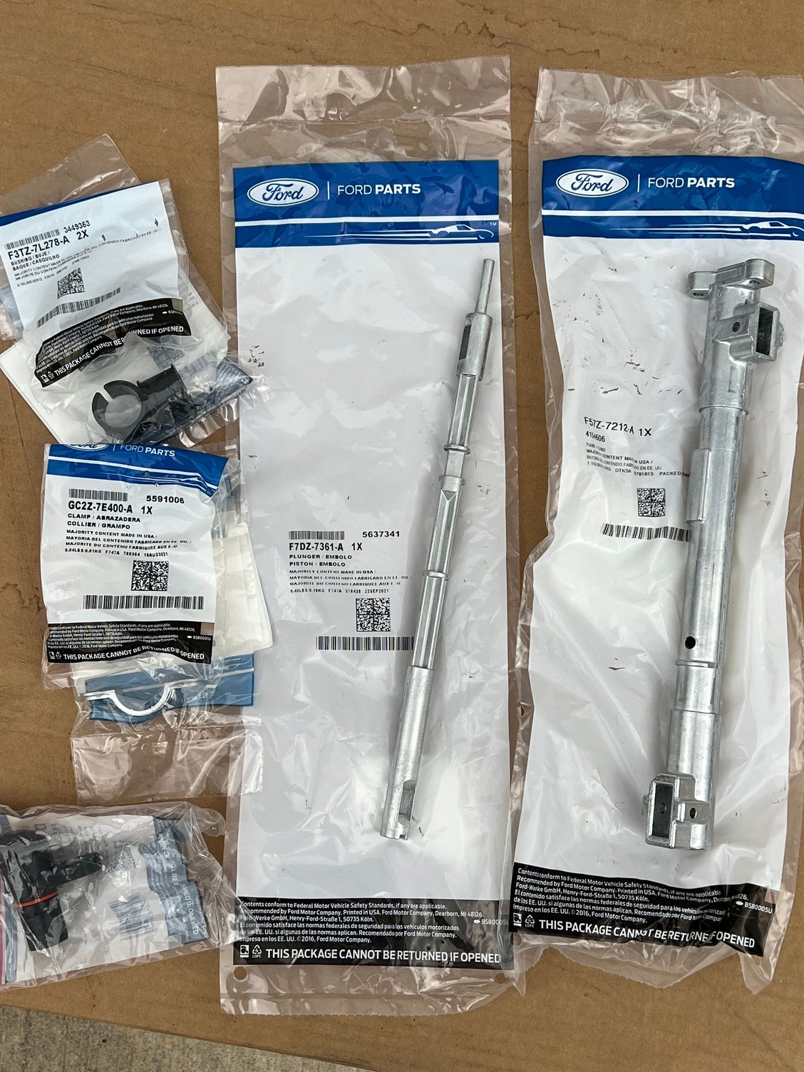

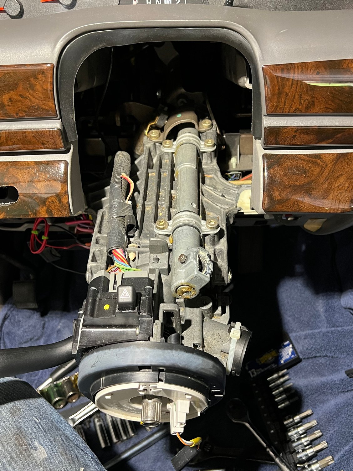

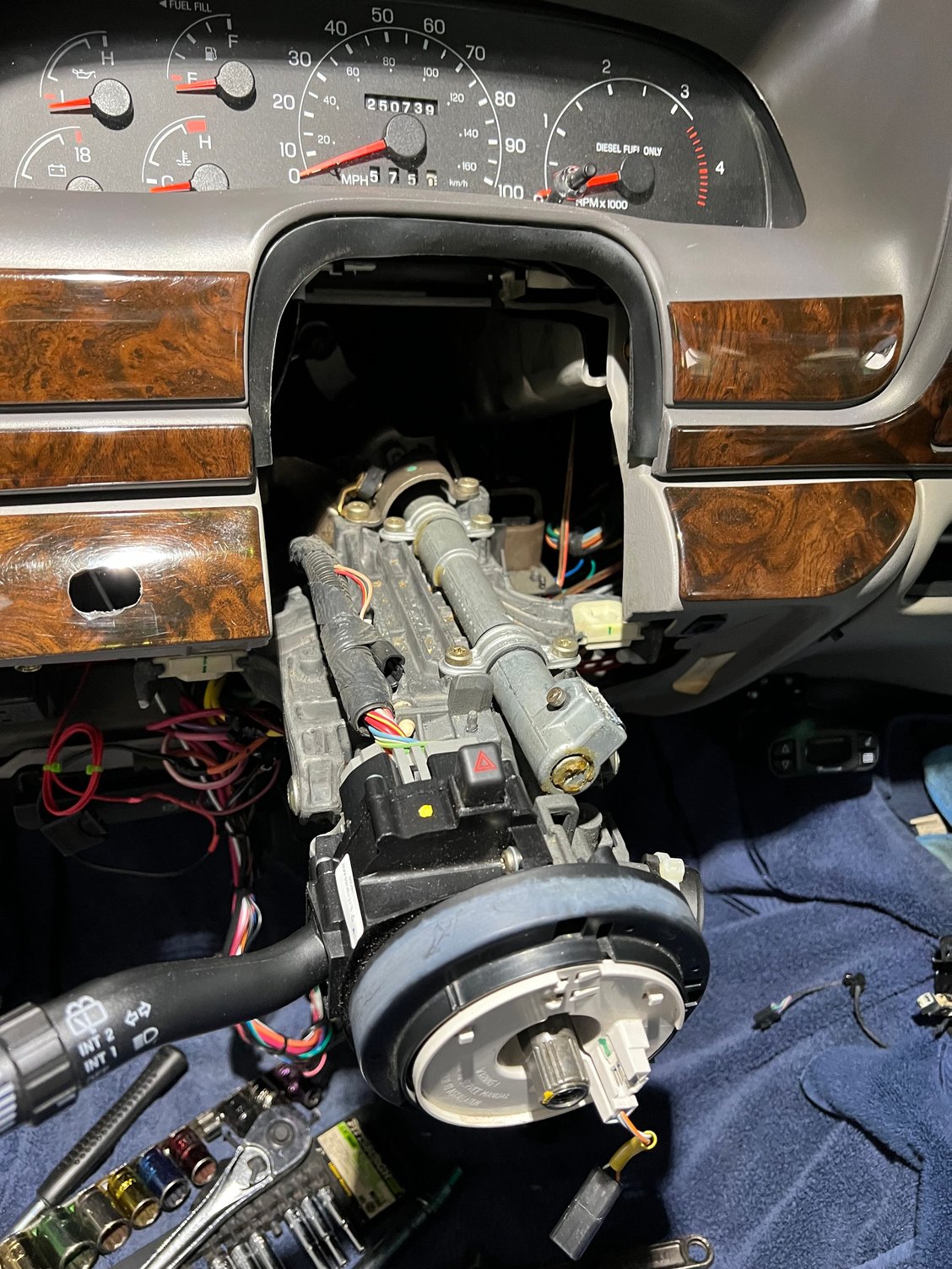

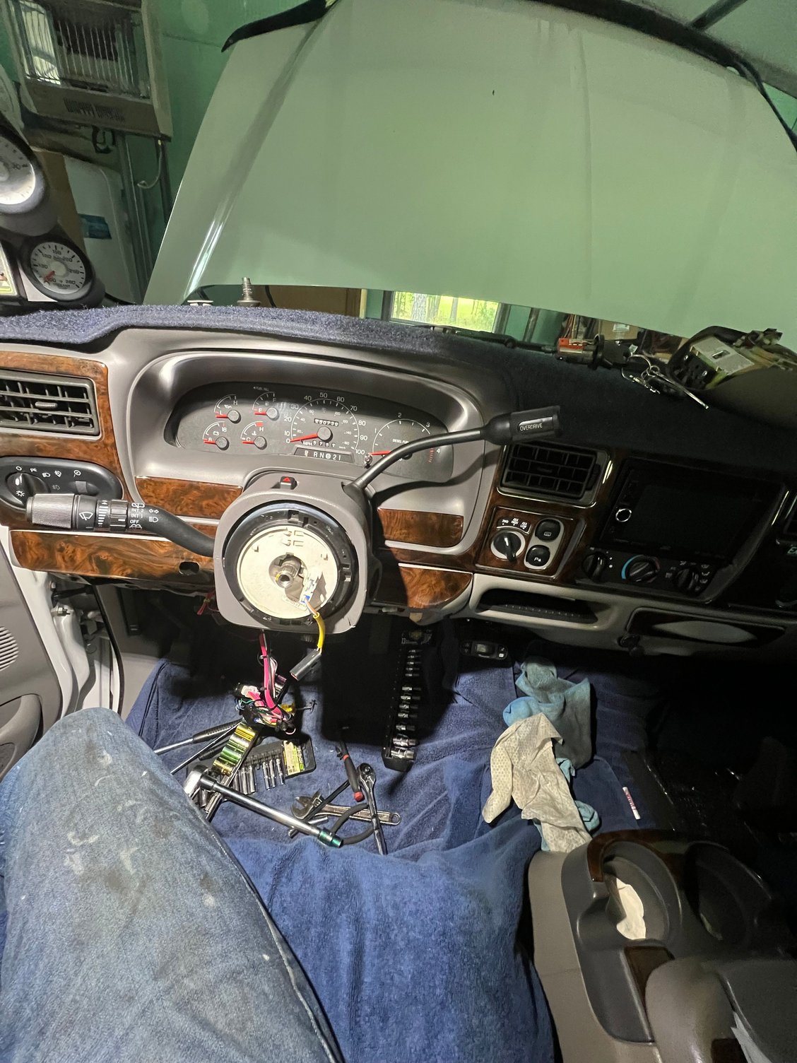

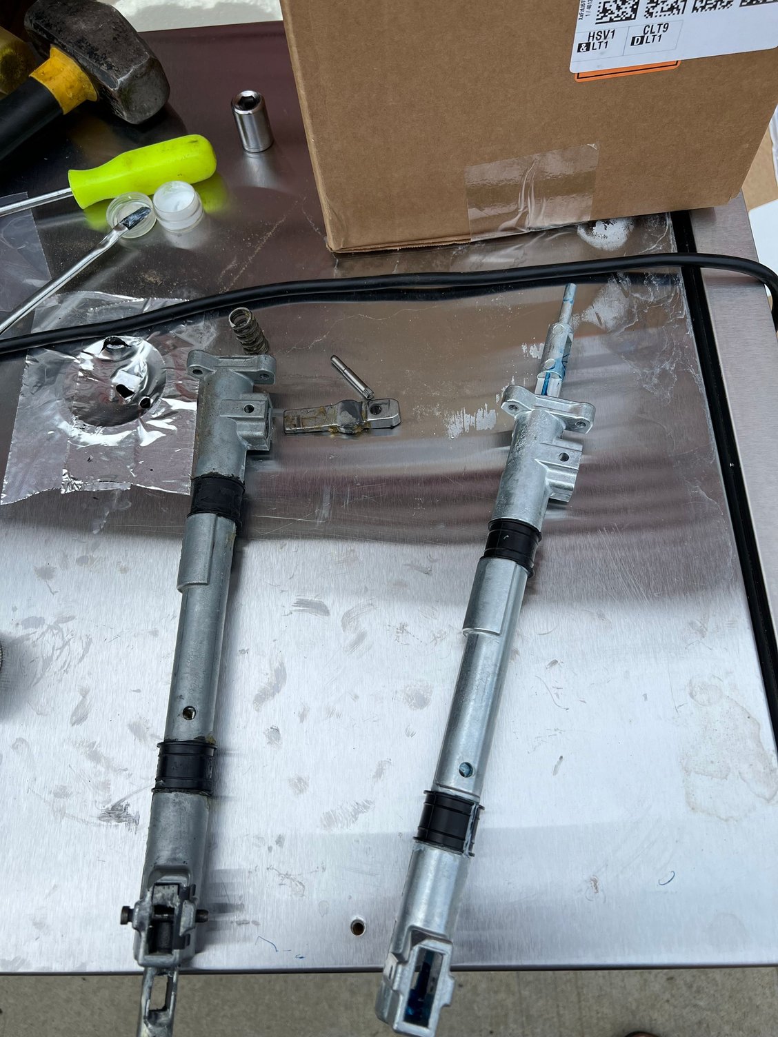

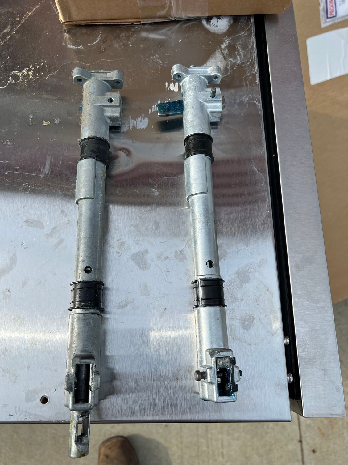

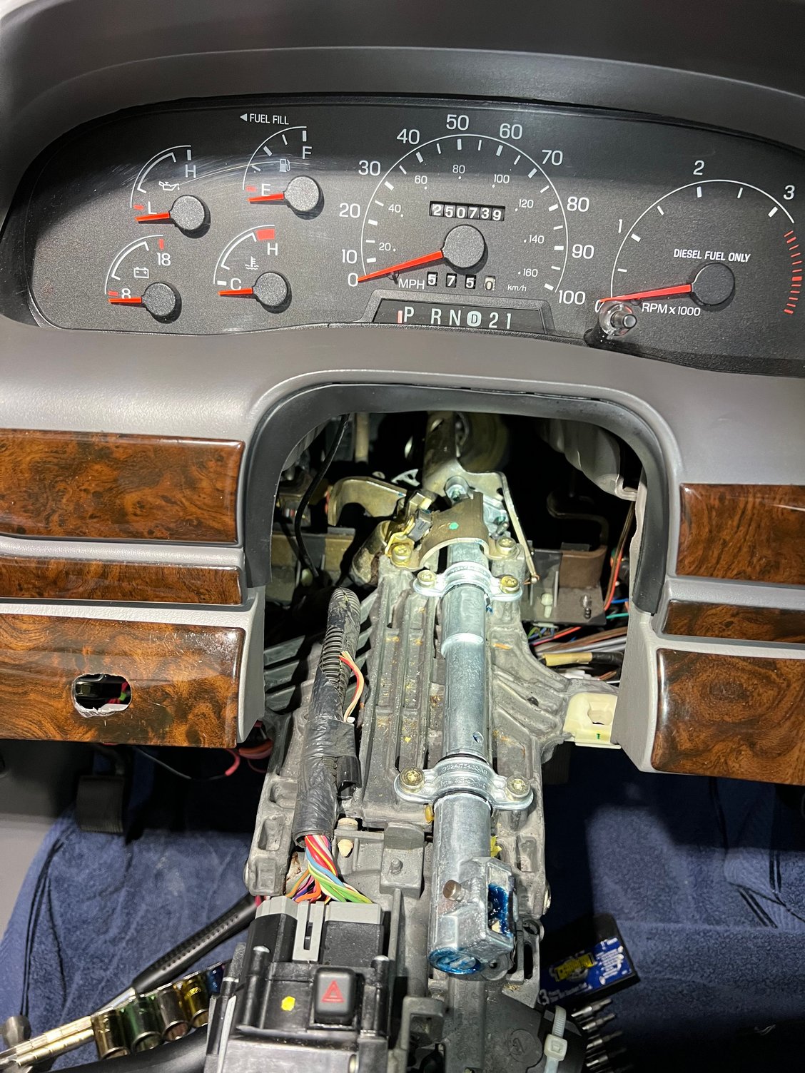

Been on my list, got motivated by Rainmaker. Replaced the shift tube, plunger, clamps, and bushings. Really straight forward, I pulled the steering wheel to have that out of my way.
Also replaced the rear diff speed sensor...

Shiny new parts in pretty FORD bags. Very cool to see!
How much did it take to remove the steering wheel? Was it stuck hard? Did you use a jar puller?
