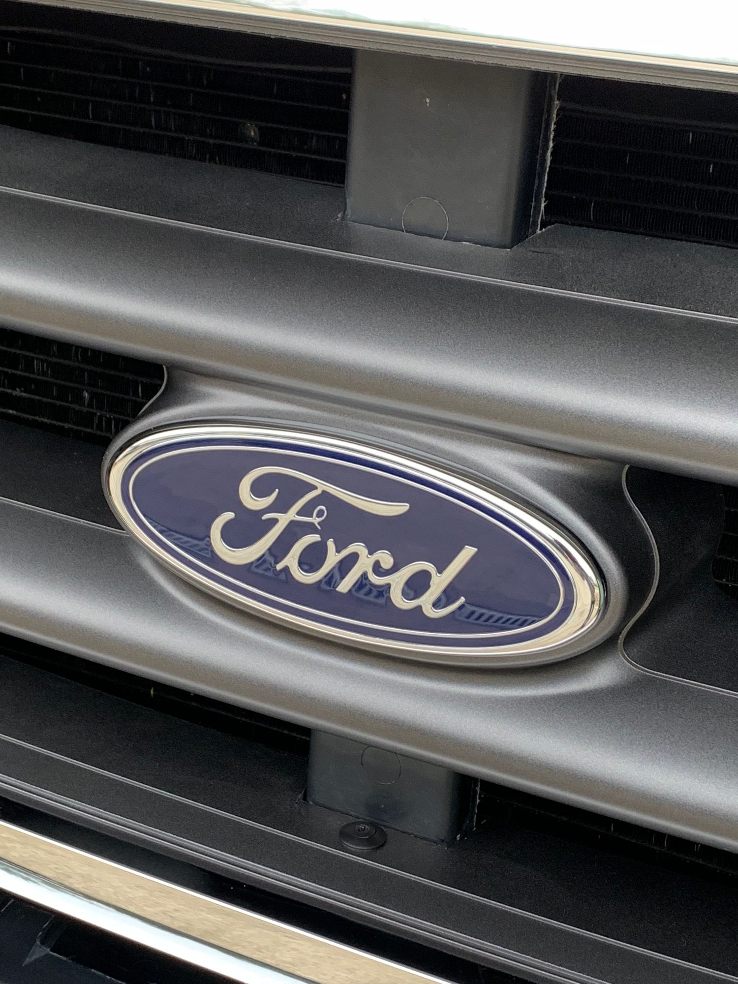

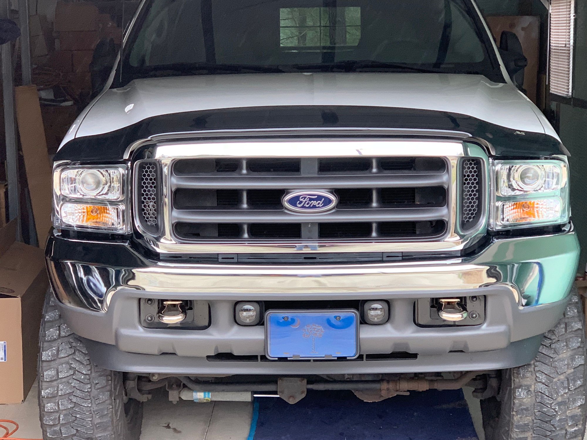

Quick trip to the dentist today. Purchased a new grill this week for the truck. I've been wanting to replace the existing one, it was new from the previous owner. An 05-07 style from Ebay, that was laser cut across the bottom to fit the original 99-04 headlight support and bumper, lots of stone chips to the chrome from my highway driving.
Since I had recently replaced the front bumper with the Ford OE correct year belonging to my truck, and knowing I was going to upgrade the headlights, I opted to replace the headlight support to the 05-07 instead of cutting my 99-04 support. The grill I chose is a 99-04 Superduty P/U style. Part# 1C3Z-8200-BAA complete with fade free emblem. I simply modified the grill to fit around the center structure of the support. A bracket and plastic screw retainer was added bottom center, and the steel clips were removed.

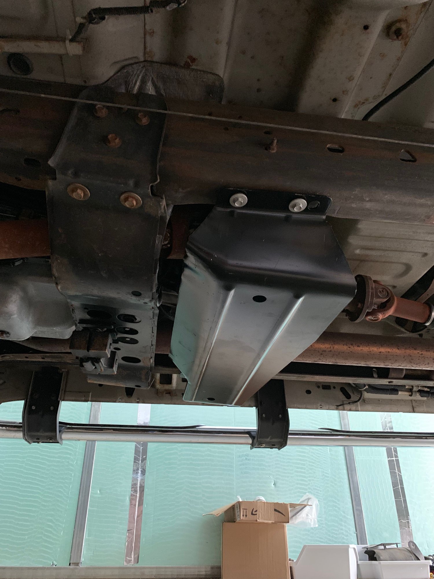

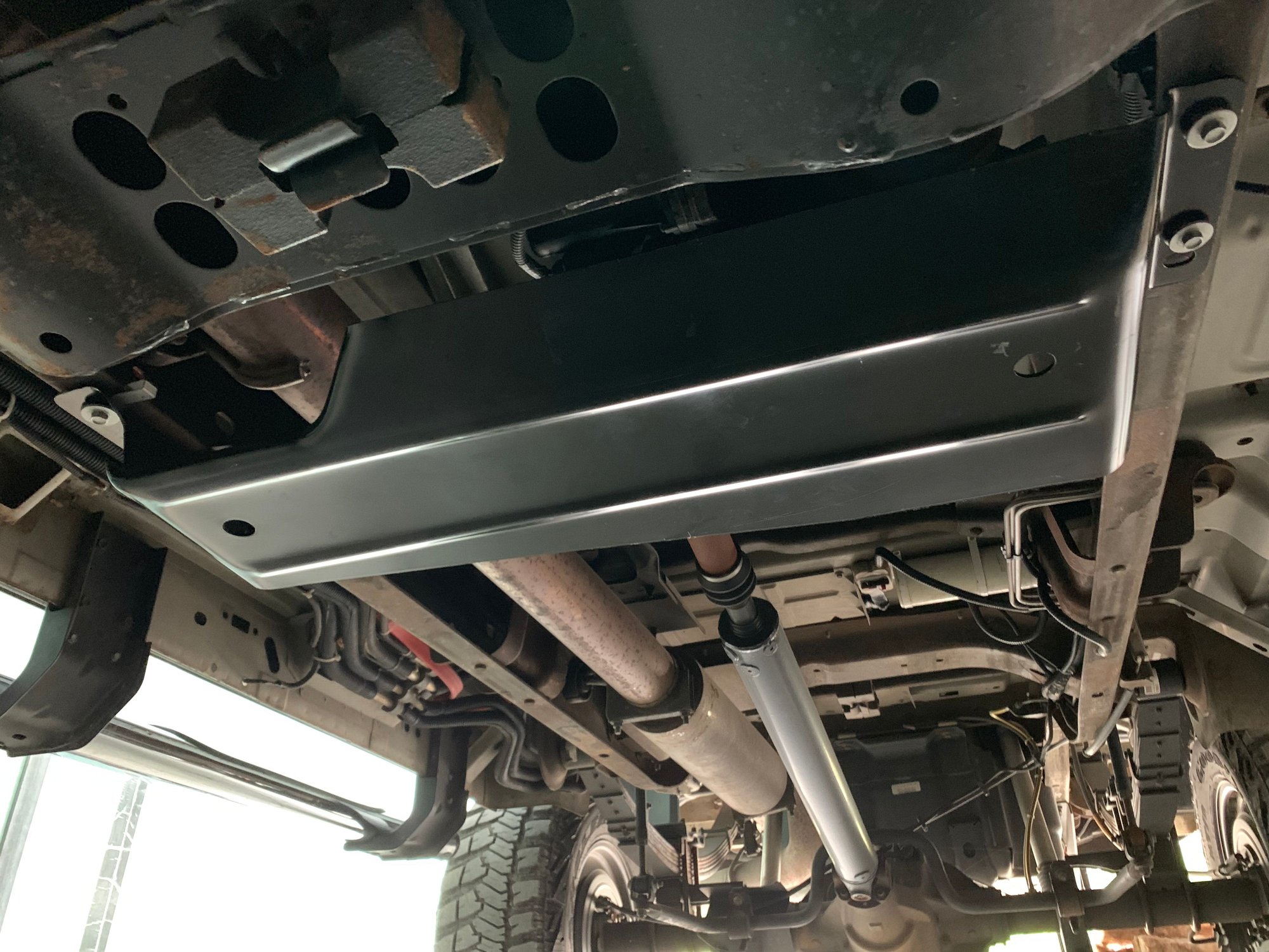

Mentioned here, https://www.ford-trucks.com/forums/1...ear-happy.html , I thought I'm all over this. So, 1 skid plate installed.

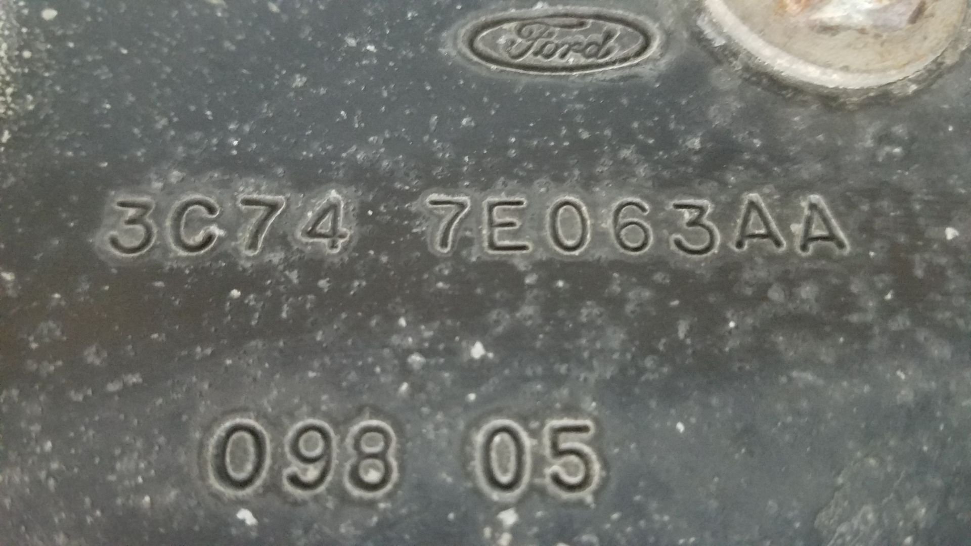

01_Excursion I went to order the same skid plate but on the Ford Parts Giant website it stated that the part you show, 8C3Z-7E063-A, is for a 2008-2010 F250 through F550 with 5spd. For my 2005 Ex it states to order 3C7Z-7E063-AA but obviously it fits your Ex. Not sure what gives?

My dealer parts guy had to do a little extra searching and found that the part number I bought was not a per application part for my year. But was a sub from the part that originally was. The parts site I usually use says your part number is discontinued.

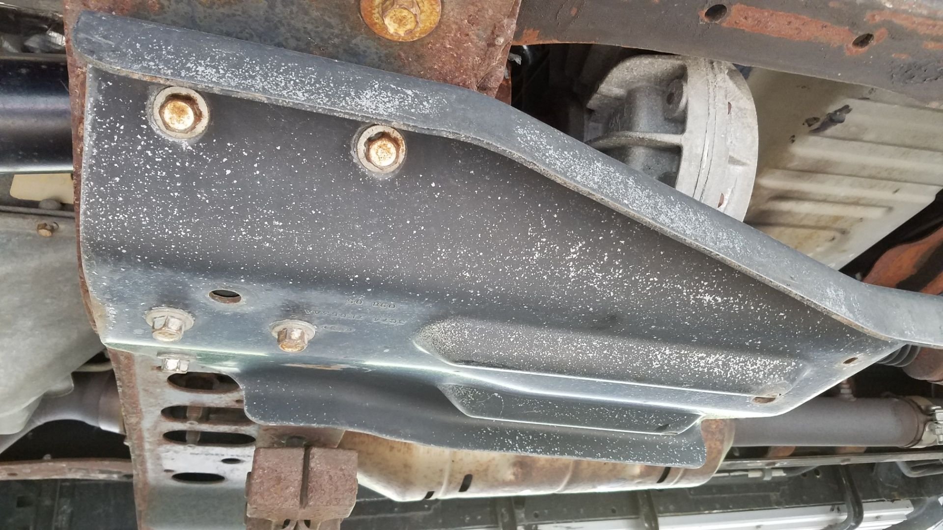

Looks like I may have to return the skid plate or stick it in the for sale section. I won't receive it until tomorrow but now that I went underneath the Ex I see that the plate I do have extends back to the area where the other type that goes from frame rail to frame rail would cross. I guess I could always remove my existing one and replace with the new one as it should afford a more protected area.
This part number doesn't even show up in a search

I didn't really think anything of it but there must be a difference between the gas and diesel skid plates. I don't think the new rail to rail one I ordered will fit on the one side due to the diameter of the catalytic converter.

I was just looking at that, and now I think I understand why mine had such a large cutout where a converter would be. It may fit, you seem to have the holes already in the frame.

Maybe it will. The one on mine covers a good portion of the cross member which really isn't needed. So maybe the new one will mount OK with the cat once I remove the existing plate. I'll see this weekend.

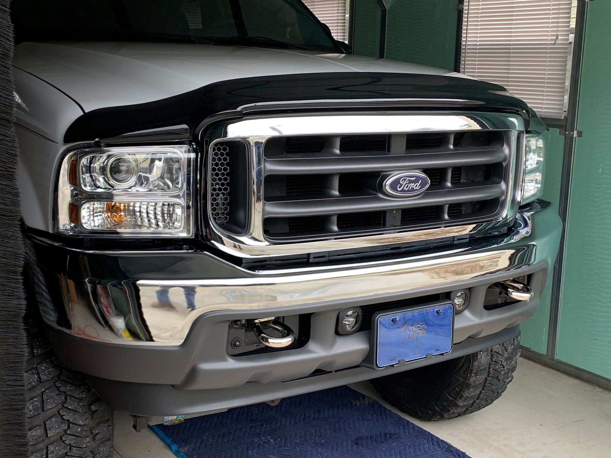

Those are the best looking headlights I've seen for the Excursion. Would you consider doing more conversions for people?

Those are the 2005-2007 actual Ford headlight housings that were gutted and retrofitted with chosen projector and bezel parts. After a failed attempt myself to retrofit a new pair of housings, I just bought another set of housings and sent them off for the up-fit. The headlight/grill support was updated to the 2005-2007 as well, the bottom of the support was cut to work with the original 99-04 bumper which I had just bought from Ford the prior year, and the replacement 99-04 F-250 truck grill was slightly modified to work with both.
