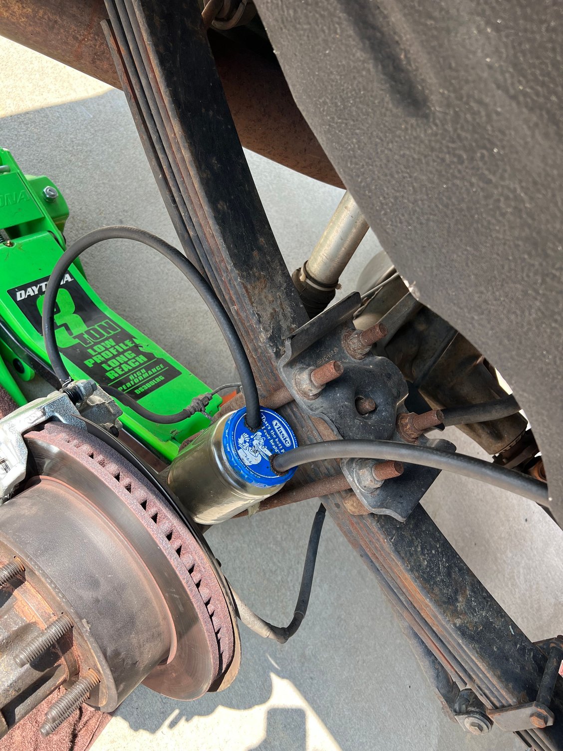

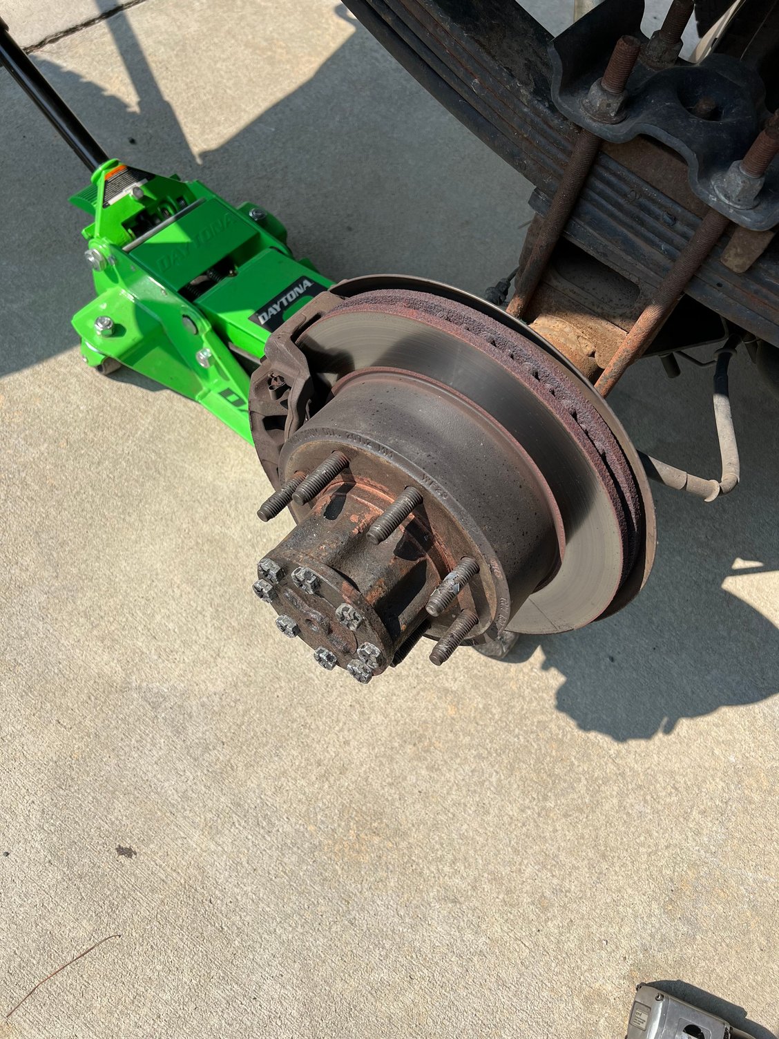

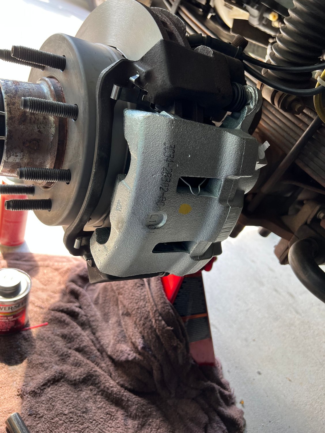

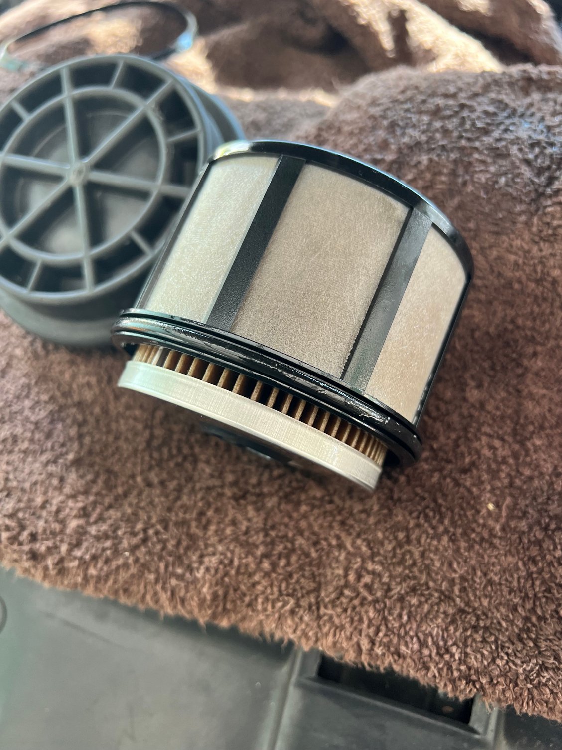

Caliper day today, went so fast I don't even know what happened...My rear rotors on the other hand, well they are a little fused to the hub as expected, since they're still OK, I left them be. The calipers ended up being brand new Ford, and not reman, I replaced the fuel filter too while I was there. The previous one was 1 year old.
Old Filter, cleaned than I expected.

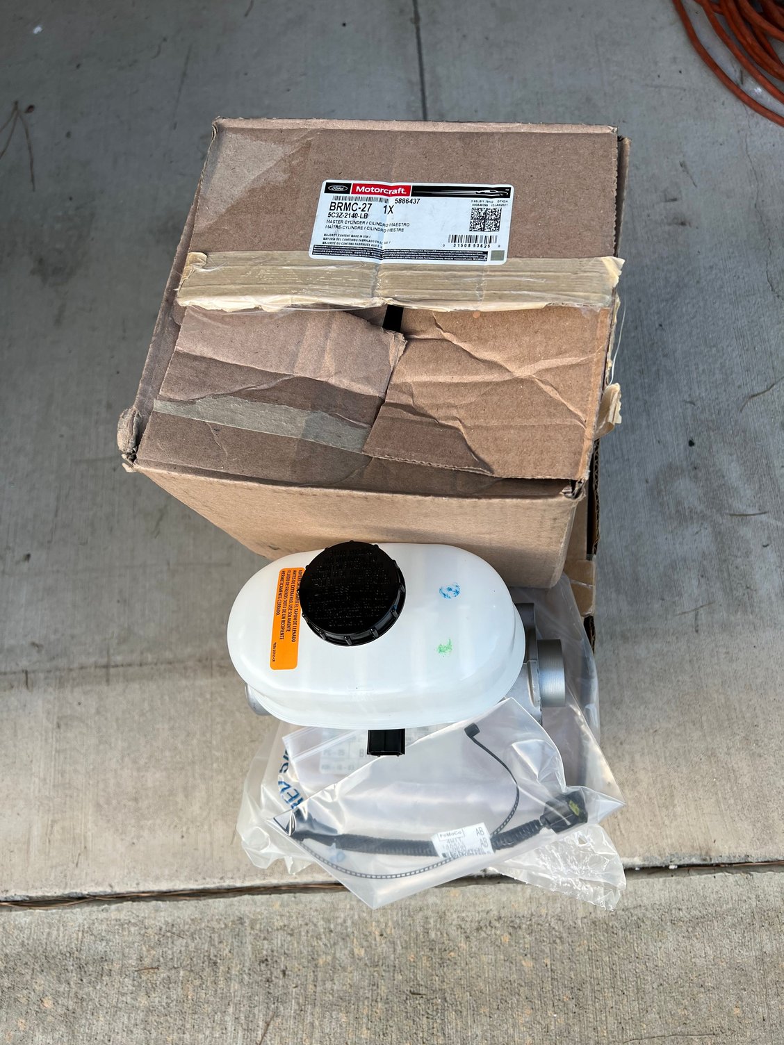

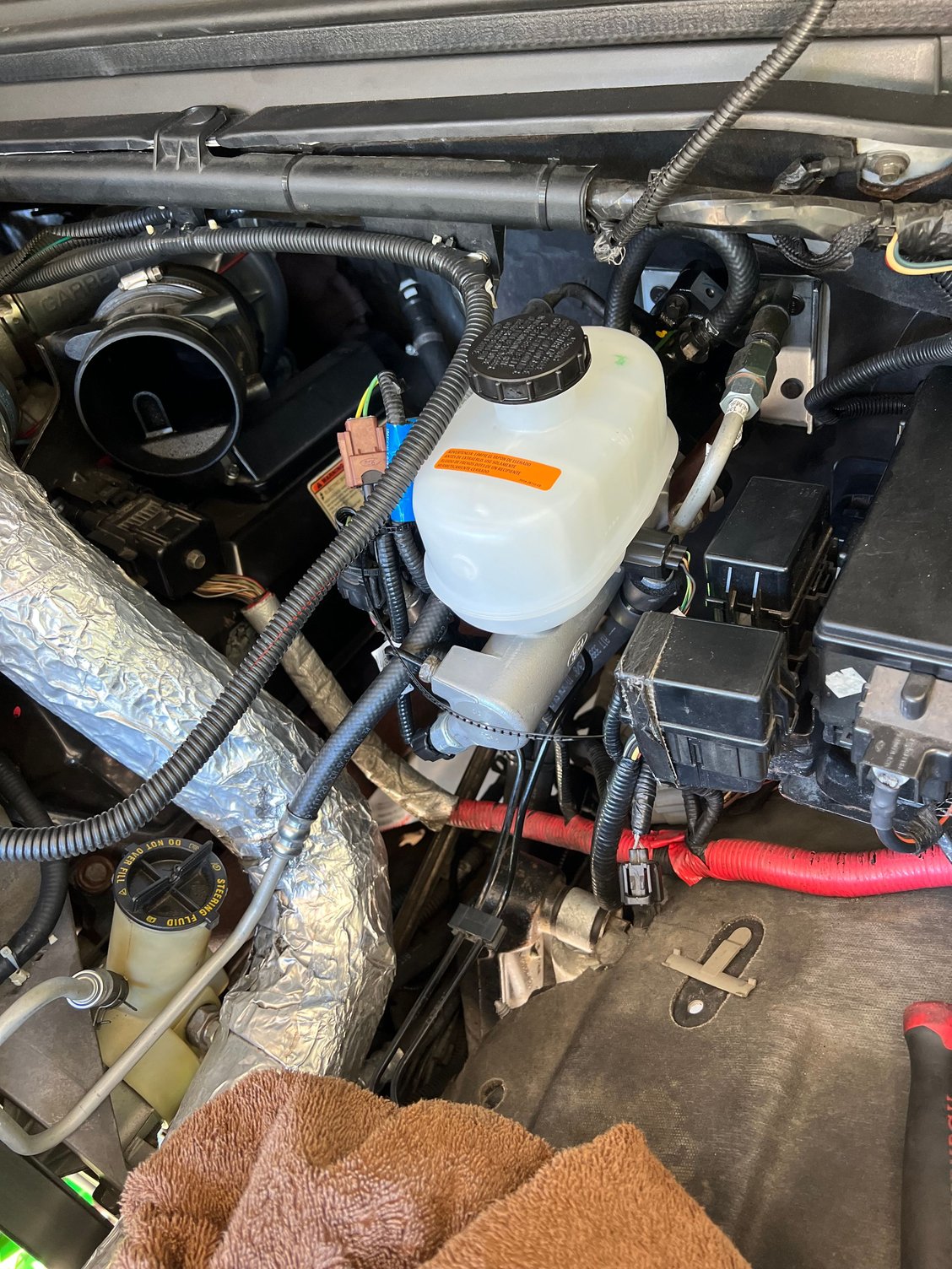

Following the rear brake parts replacement, there is a noticeable improvement in braking. Ironically the rear pads were at 95% material, I just put those on the shelf. So I decided since the rest of the brake parts are still avail new, I ordered the master cylinder, and front calipers. I'll tackle these over the weekend.

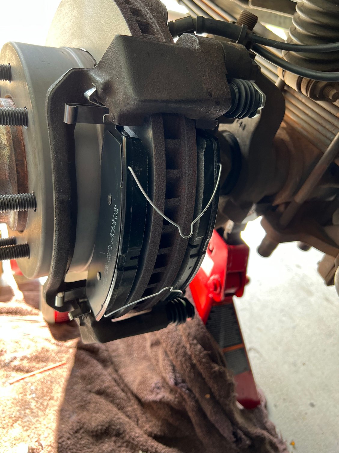

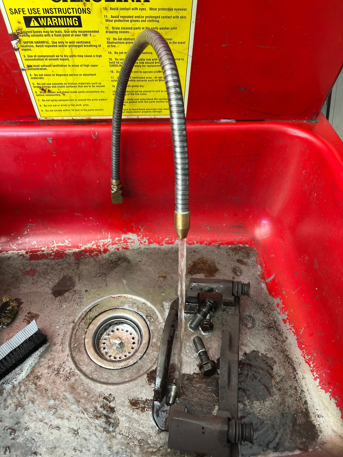

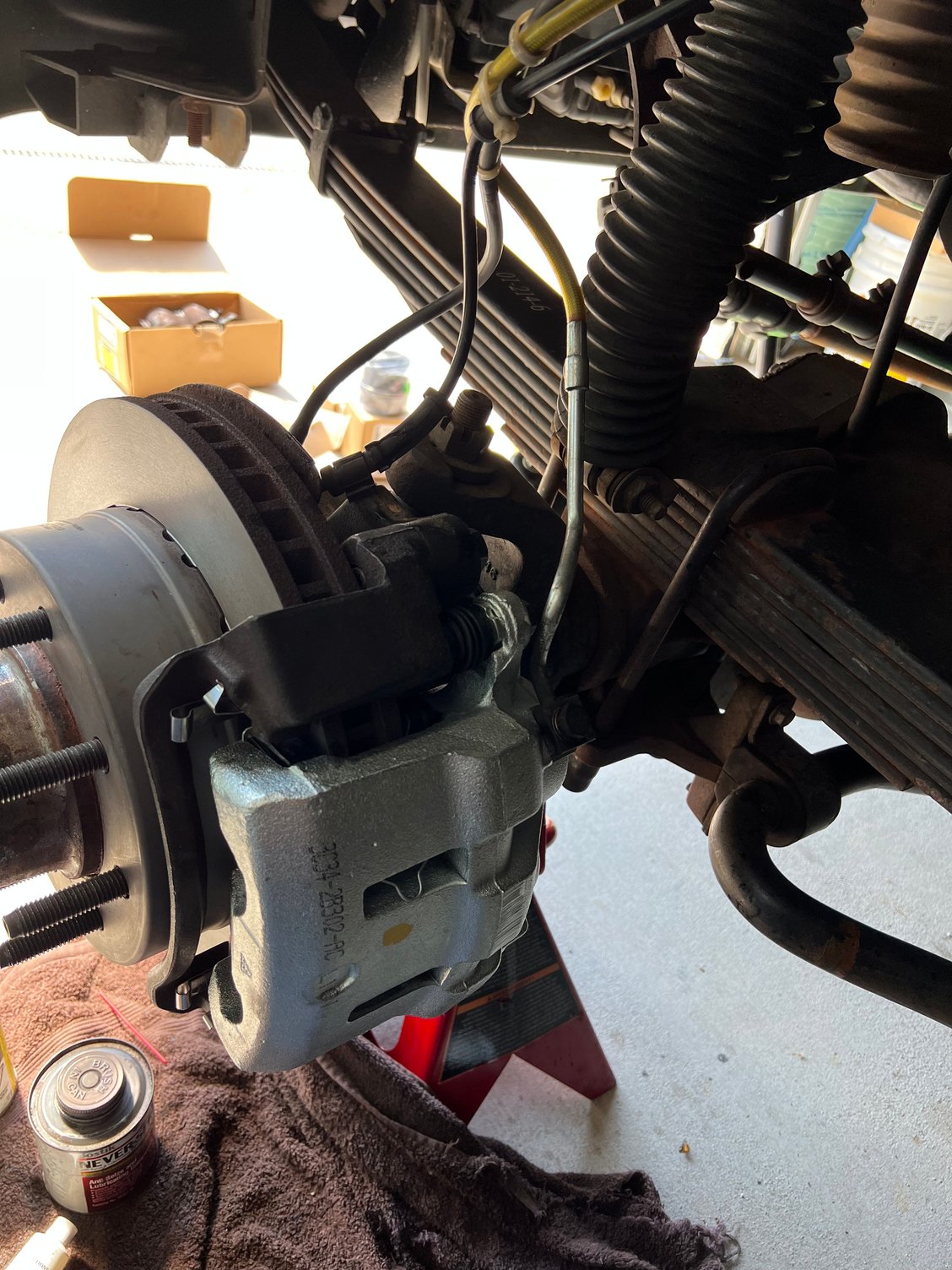

Today was very productive. Finished the brakes, with the exception of rotors, caliper brackets and front to rear brake fluid lines, (had previously replaced the rear axle steel lines), everything is new. I decided to get new slide pins, and OE hub lockers, my drivers side was starting to get a little stiff to turn, both lockers were replaced a 5 years ago, and trying to clean and lube the rotating **** was futile. Bleeding was not too bad, I bought a bench bleed kit for the master cylinder, but skipped it, and just bled it through the entire brake system, and used FORScan to bleed the ABS. 3 Quarts of fluid were bled in total. I Used my parts washer to clean the caliper brackets, and bolts.
i did correct the pad spring that is sticking out

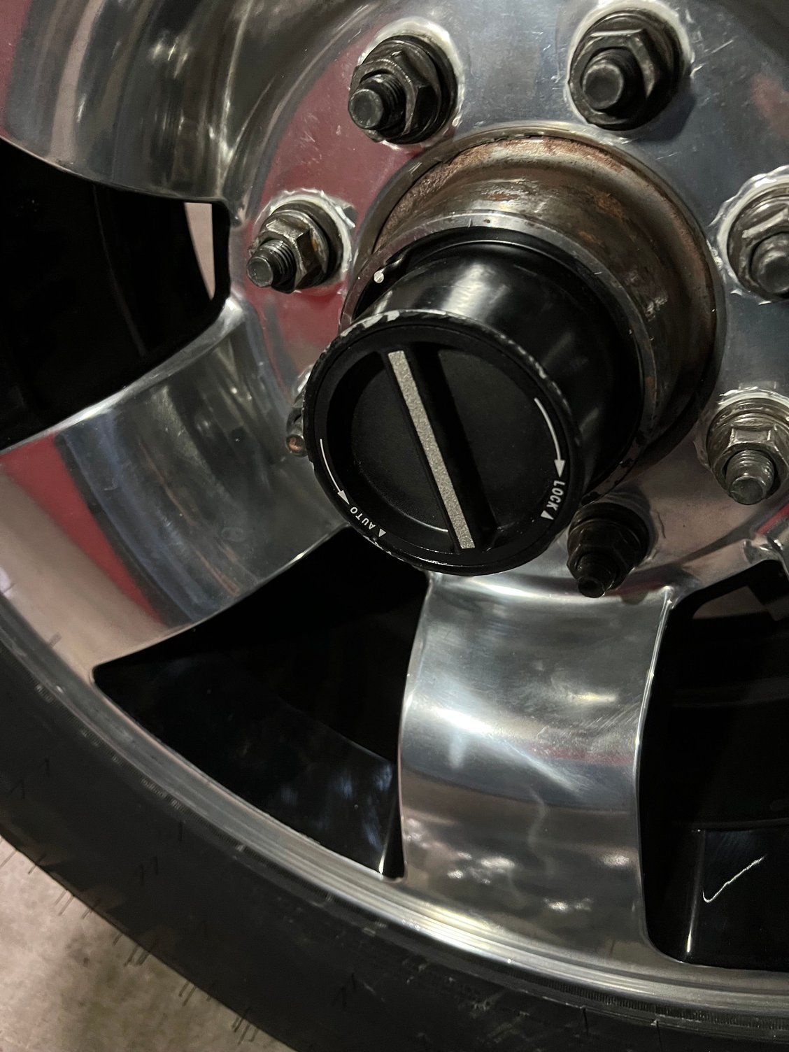

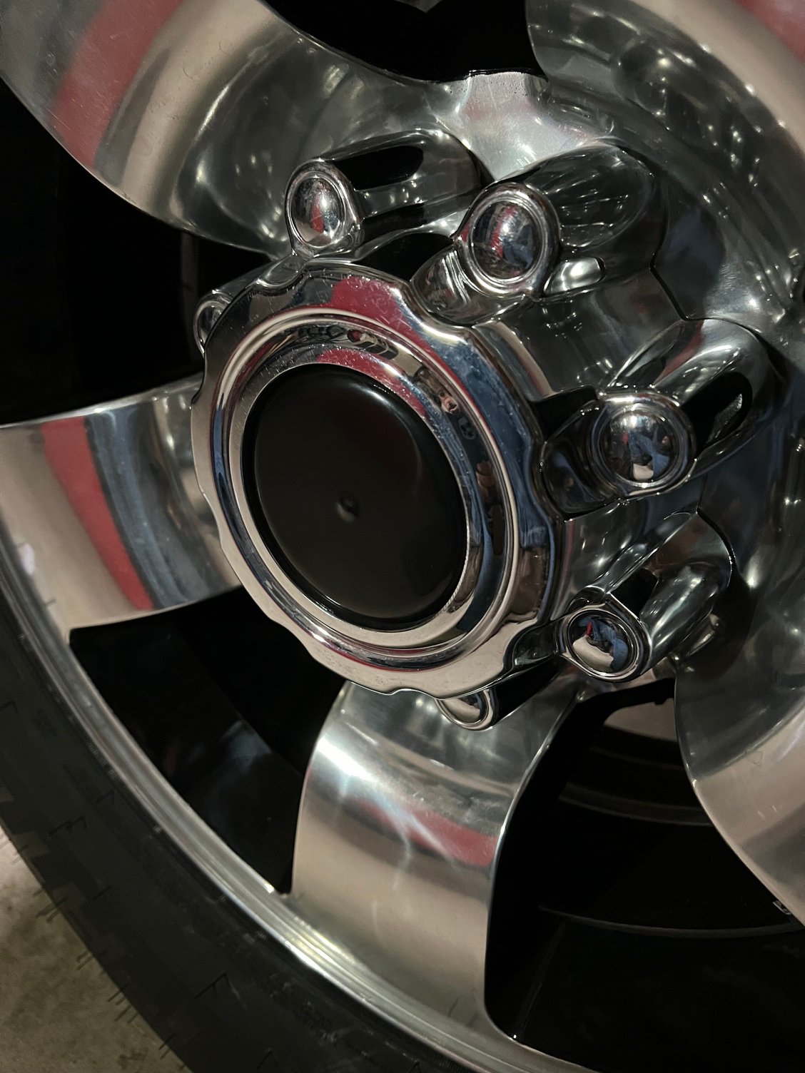

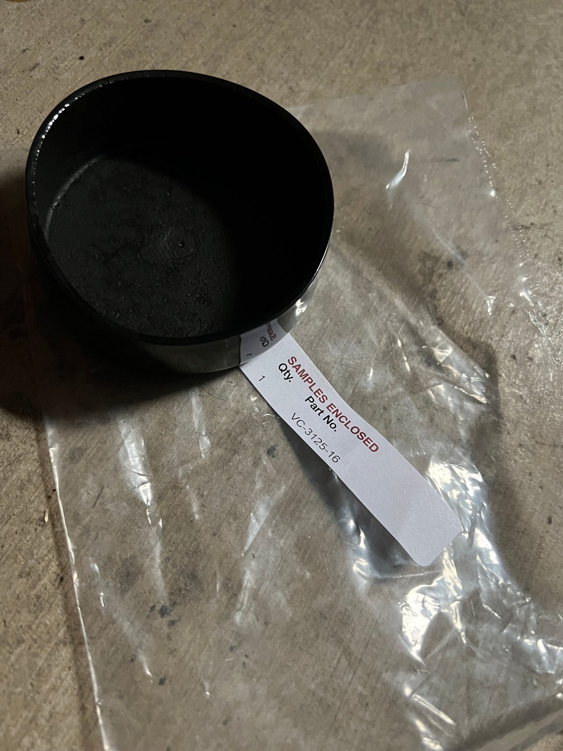

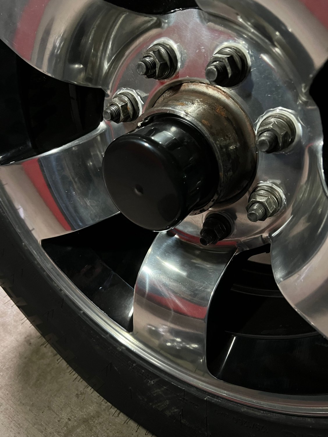

Ok, so I have come up with a harebrained idea to help preserve the manual operation of the new hub lockers.
From reading the https://www.guzzle7pt3.com/allube.php regarding maintenance on the ESOF hubs, I agree that the majority of rotational binding is from debris, and lubrication drying out behind the ****. I have a spare that I will destroy to see how it's assembled, and what actually causes the binding with the ****. Until then I ordered rubber caps to prevent road dust to enter and/or clog the rotational **** over time. My original lockers on the inside are totally fine, but one of them is getting stiff to turn manually. After cleaning, and trying a couple lubricants, it made things worse, especially since you can't take off the **** to properly clean and lube.
Since I'm able to pull the center chrome caps off with my fingers, removing the rubber cap if ever needed is possible on the roadside. I had the front hubs replaced with new Ford bearing hub assemblies a few years back, installed silicone hoses, new hose nipples, and a new OE under frame crossover hose set, so in short my ESOF works like it's supposed to, I may never need to lock manually going forward.
Knowing what the manual **** does behind the diaphragm, and hearing it when you turn back to auto, it sounds like it needs to release air from around the tiny gap between the **** and locker body, so that the object the **** is making push on the diaphragm can return closer to the inside of the ****. Anyway, if the small gap around the **** and the locker body is a breath point, than I'll just make a small hole in the center of my new dust boot. I'll test by lifting up the front of the X and activating, then de-activating the ESOF VIA the dash switch.

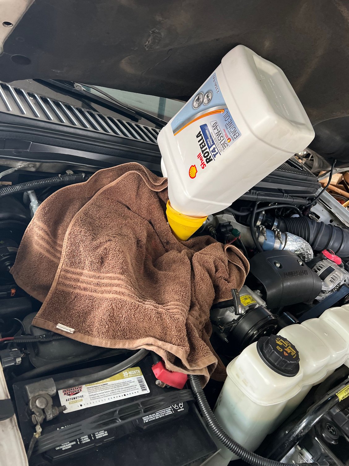

EBPV crank arm reconnected, oil changed, trans fluid, and filter changed. Once I deal with a squeaky belt issue, it's on to removing the rear end.
