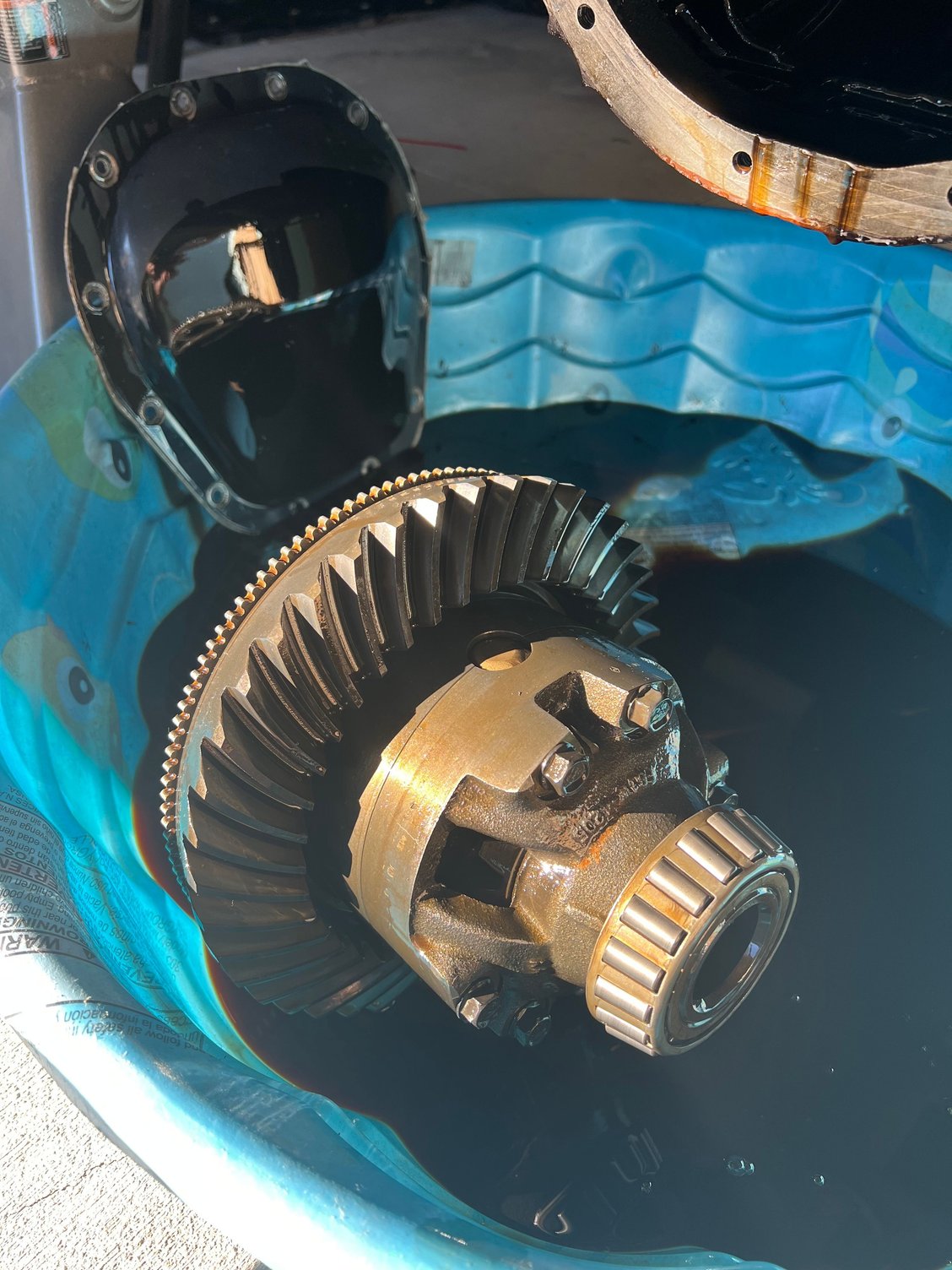

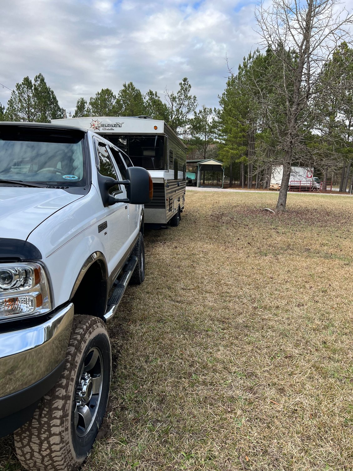

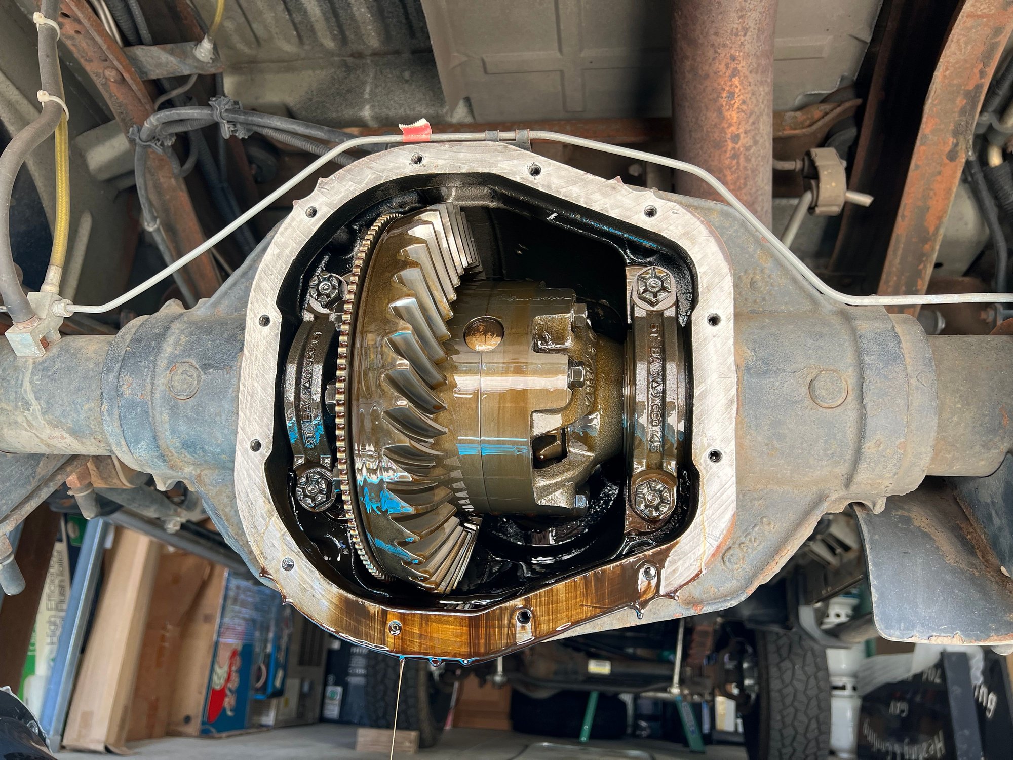

Gonna need a little advise/help on the rear end. I'm still waiting on the dealer to let me know what specialty tools they have that I can borrow, yes they will loan me tools, but I don't need every single specific tool listed in the shop manual, I just don't know what I can improvise on, or just buy a cheap knockoff.

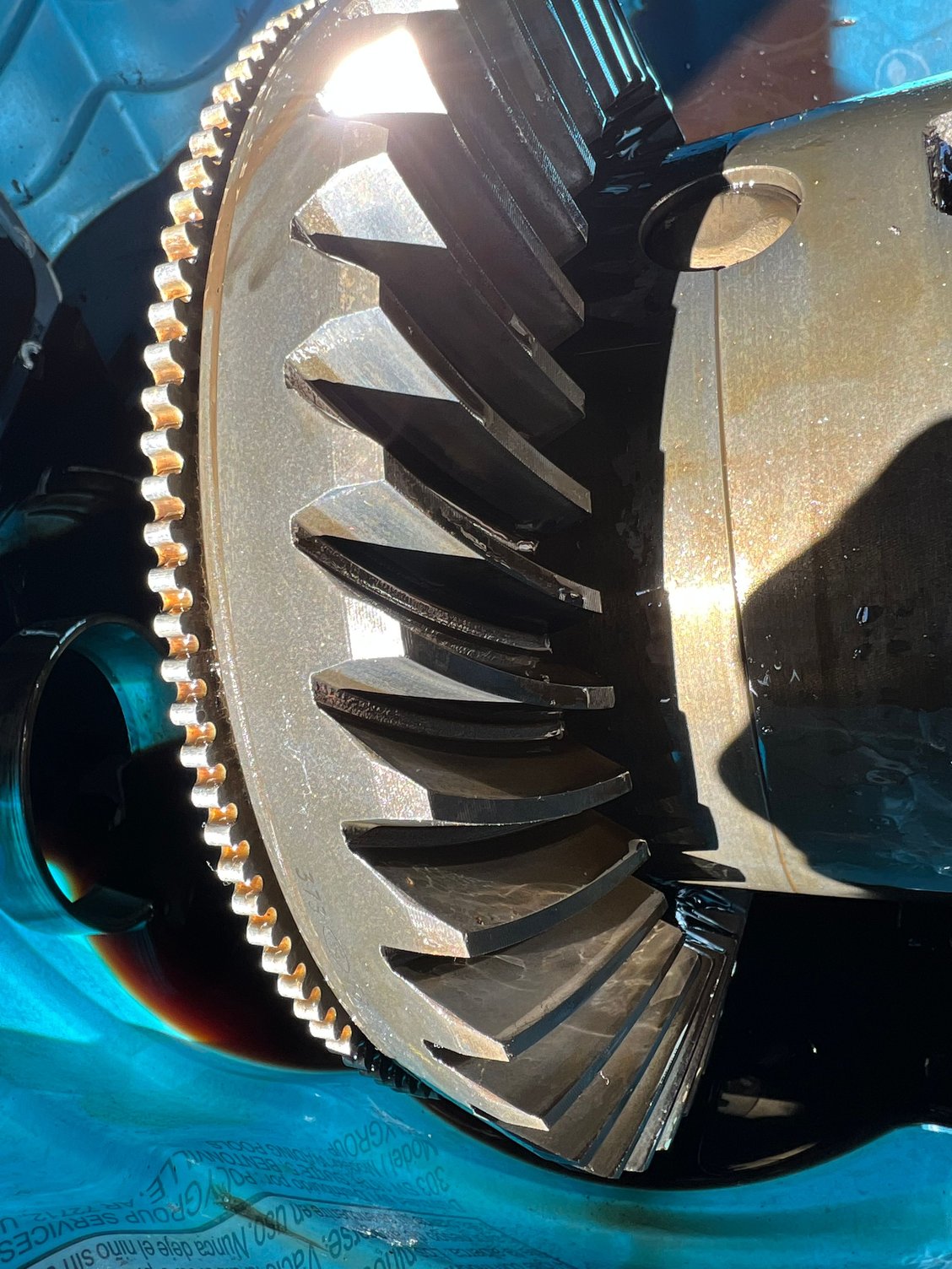

A recent "Sticky Situation" in my front yard with the camper proved the current limited slip clutch diff was fully slipping. To boot I have what sounds like pinion bearing noise under load. The rear end is all original to my knowledge, so I'm not picking and choosing, at what to replace, it's all getting rebuilt.

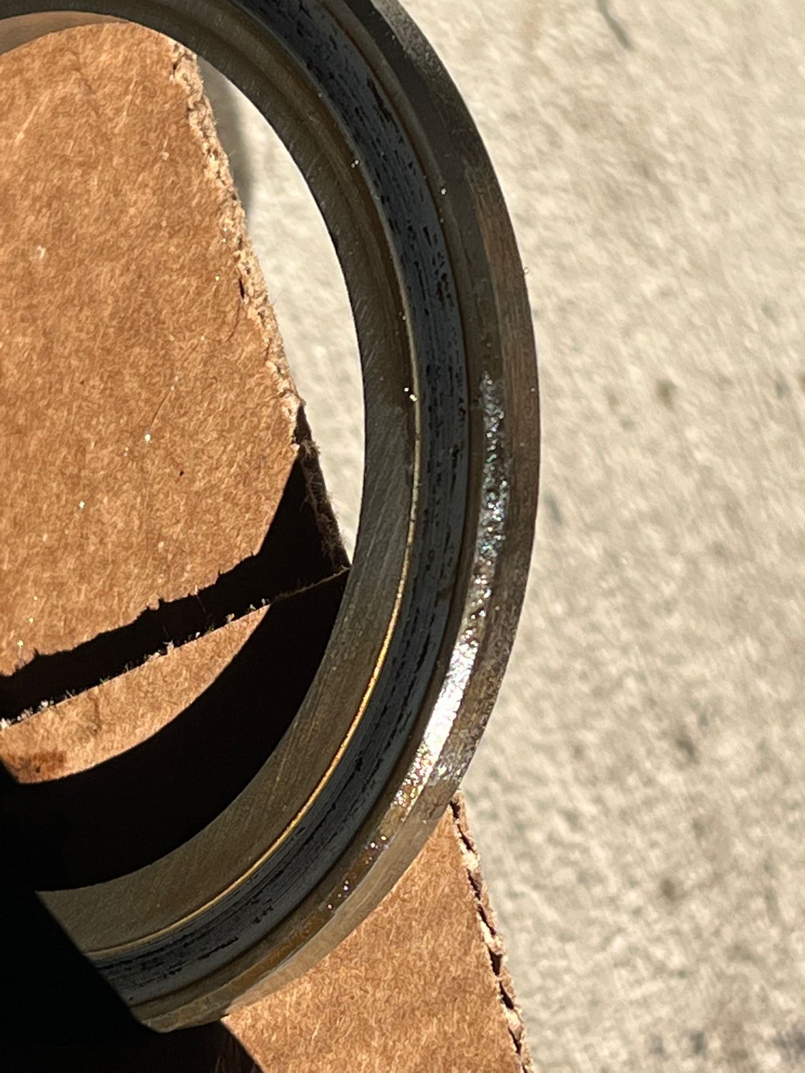

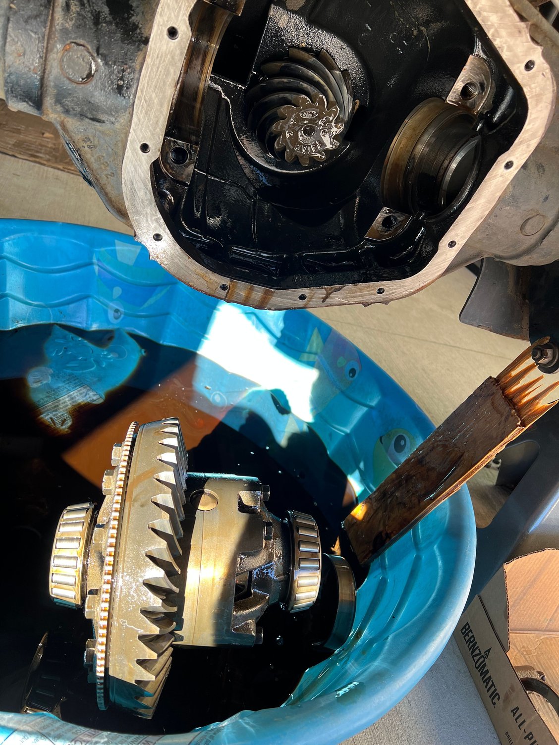

Got things started this weekend, have no clue what I'm doing, but things are making sense, and seem to be progressing OK. Haven't identified any bad bearings, or cups as of yet, but there are some wear points here and there which may be giving me my noise, including the axle bearings, or the LS bearings. I got things removed, and the outer pinion bearing cup installed, The Ford dealer loaned me 2 Rotunda kits but they are incomplete, and we never found a specific kit for this job. About a billion dollars later this weekend, I have ordered a ton of one time use tools, and 2 Rotunda kits. I'm feeling wear on the accell face of the ring gear teeth that has created a deeper area where the contact point has been, the right carrier cup appears to have been spinning against, or wearing into the right shim, there is a definite ridge there, and the outer pinion surface that contacts the outer bearing cup looks scored too. This may all be from loss of pre-load on the pinion bearing from age and wear.

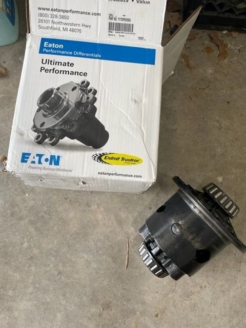

I took a similar, but slightly different, route , put a Eaton Detroit truetrac in the back.
And a basic lunchbox locker in the front (swapped a dana 60 in the front, lots of locker selection for the 60, not so much for the normal dana 50 that excursion's come with).

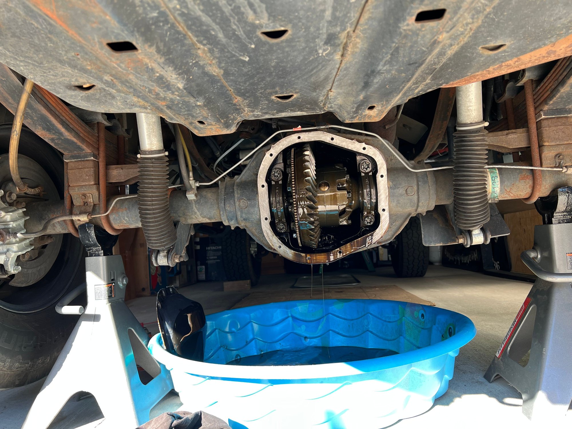

Originally Posted by WI Dan
I love the implication that the Ex is so big you need a swimming pool to service the differential fluid!!
That pool was bought for the top end injector work, and for cleaning the engine valley since the truck was in the garage for all of that work.

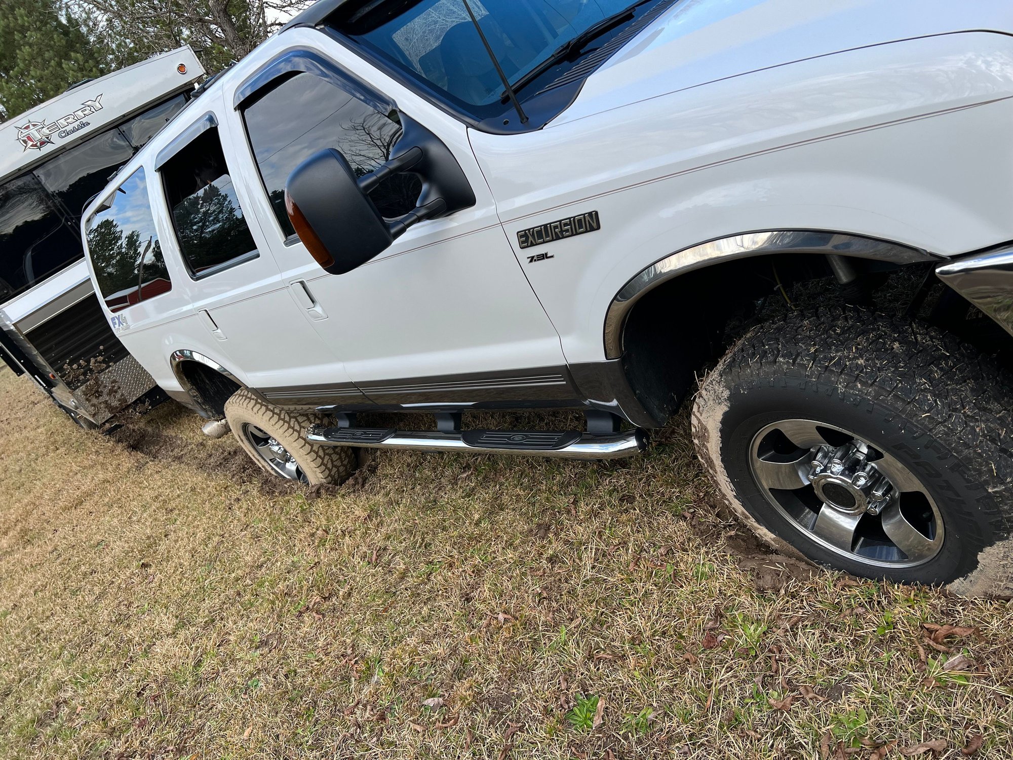

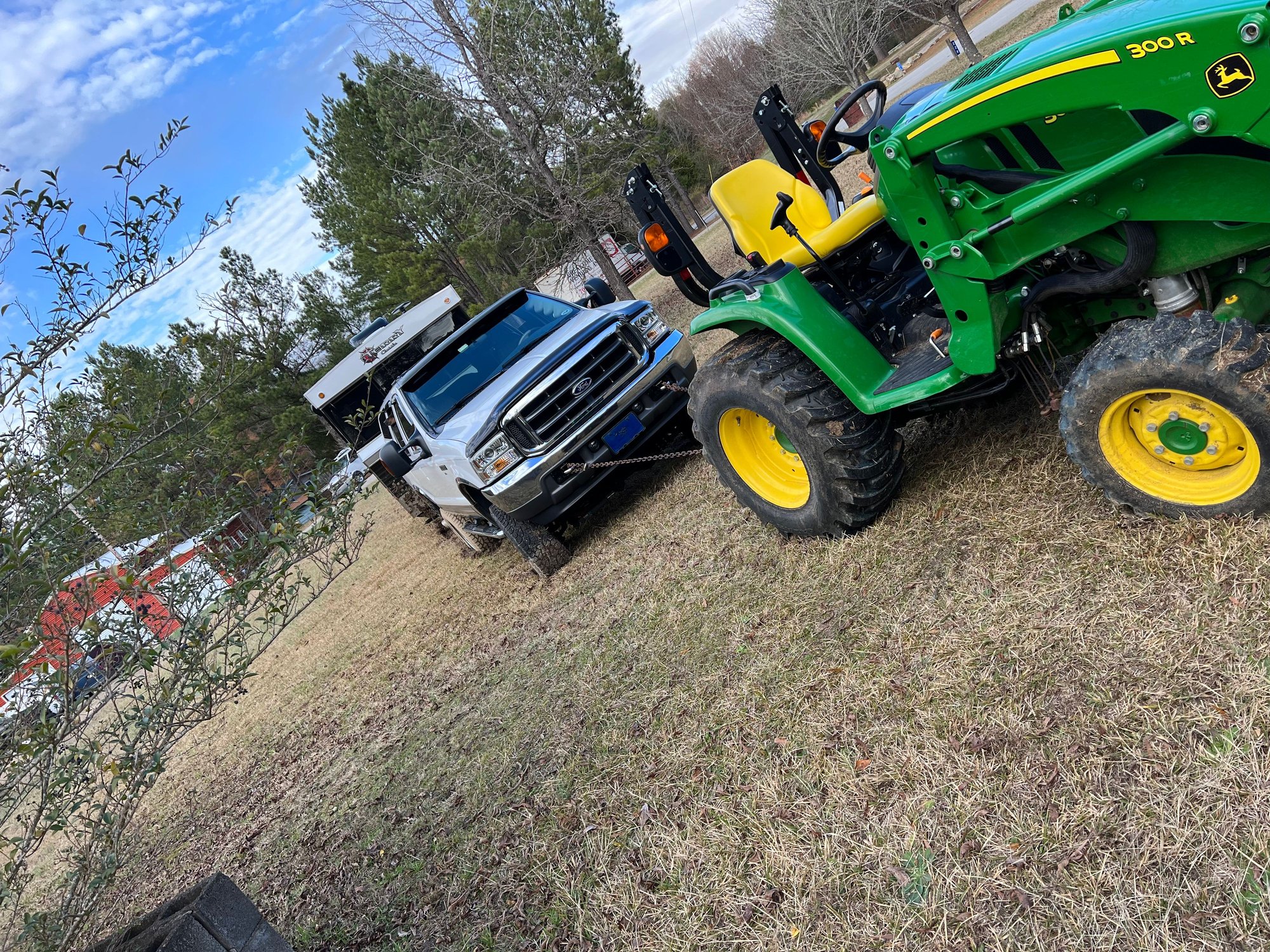

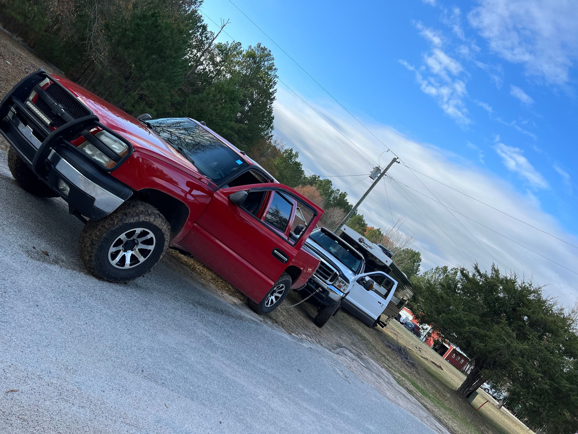

The embarrassing thing I never mentioned after getting stuck in my own front yard was how I got out.
I tried myself with the neighbors tractor, but even though it was in 4x4, i never knew to press the foot pedal to lock in the diff, so the tractor was just spinning it's wheels.
So,,, here comes the help....

A little bit of left foot heel on the diff lock pedal and that little tractor would've probably pulled you out. I have a similar sized Kubota tractor (an L3130 to be exact), and its pretty amazing how much work a little 31hp tractor can get done.
But getting an Excursion pulled out by a 1/2 ton Chevy,,,,just embarrassing.

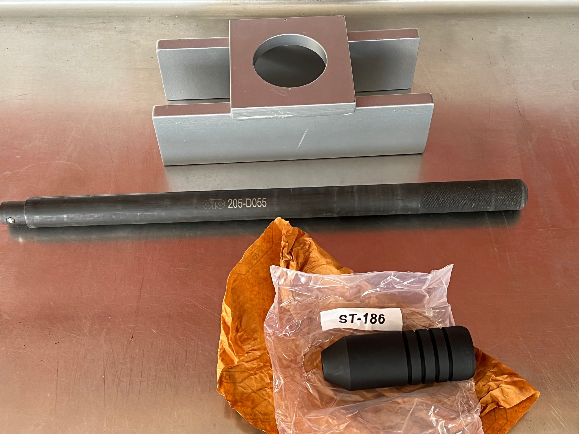

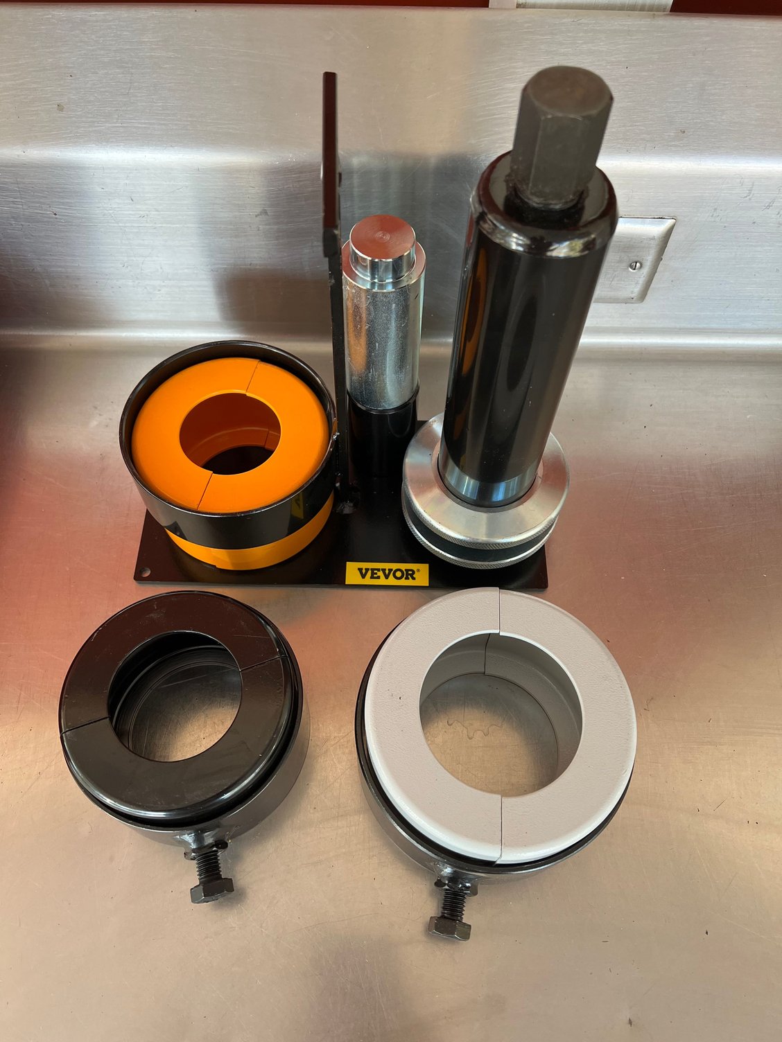

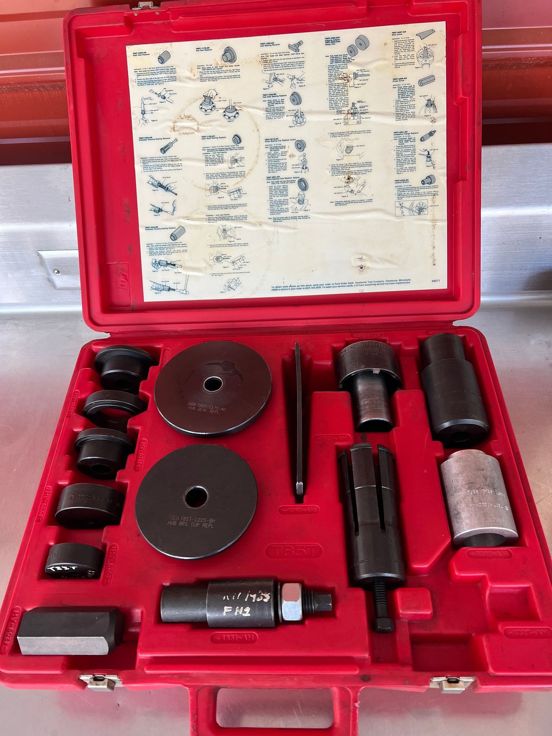

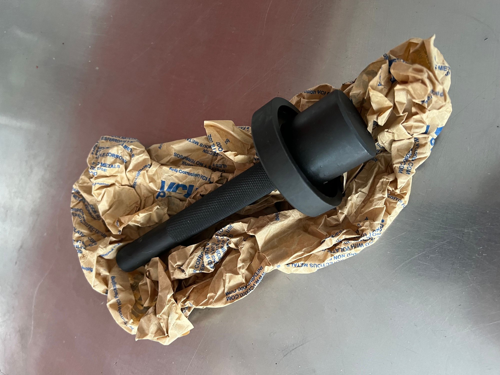

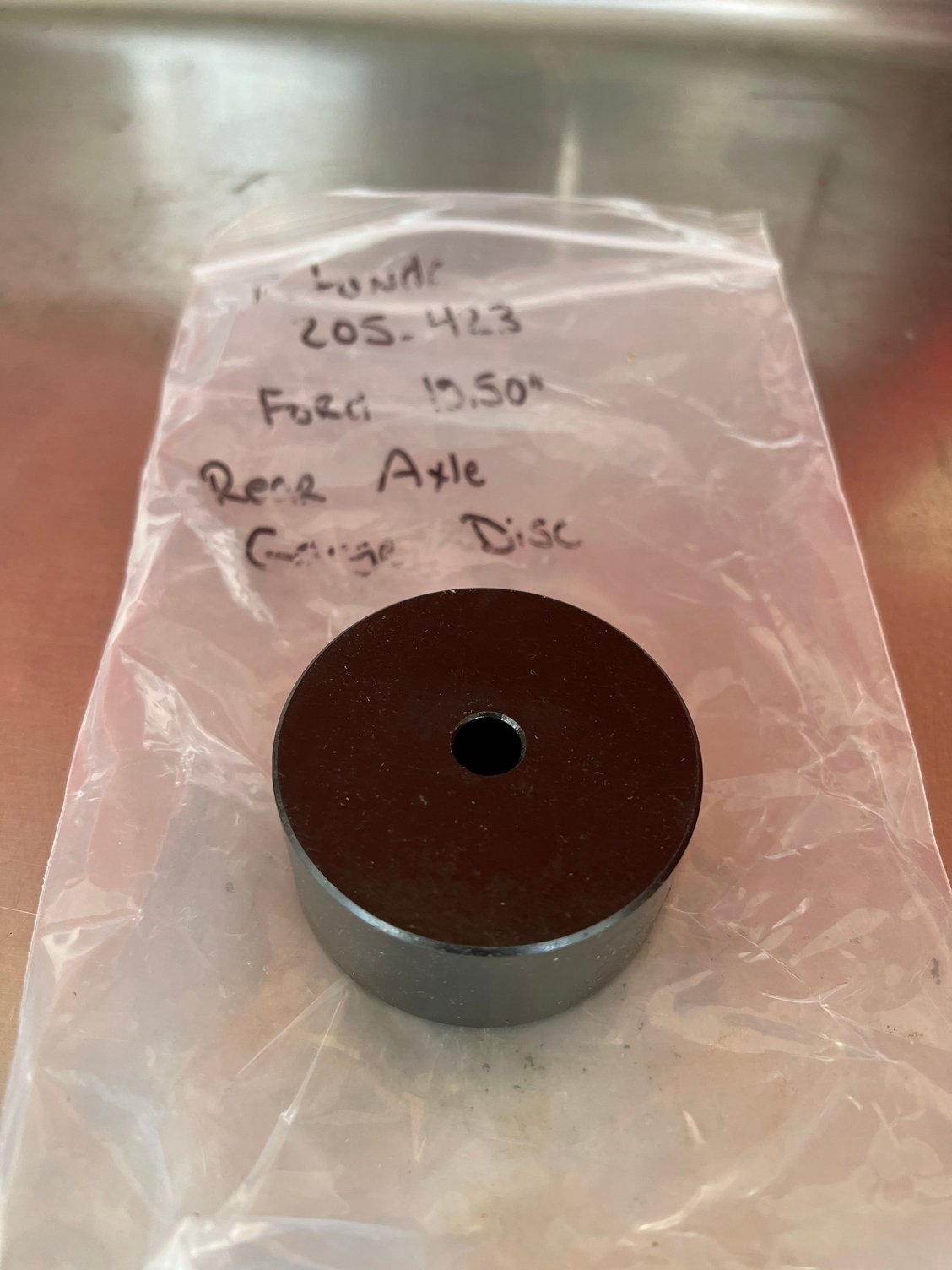

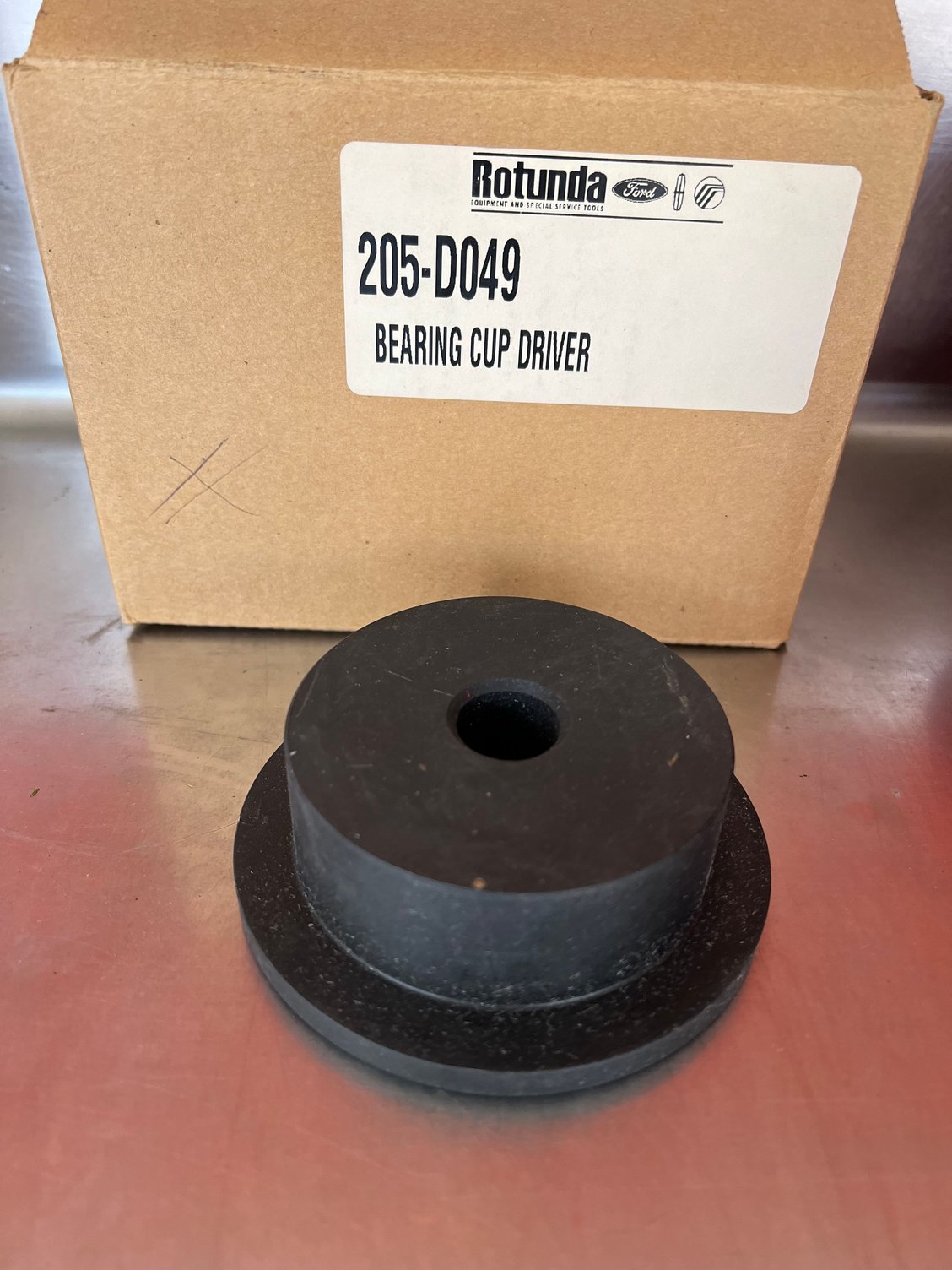

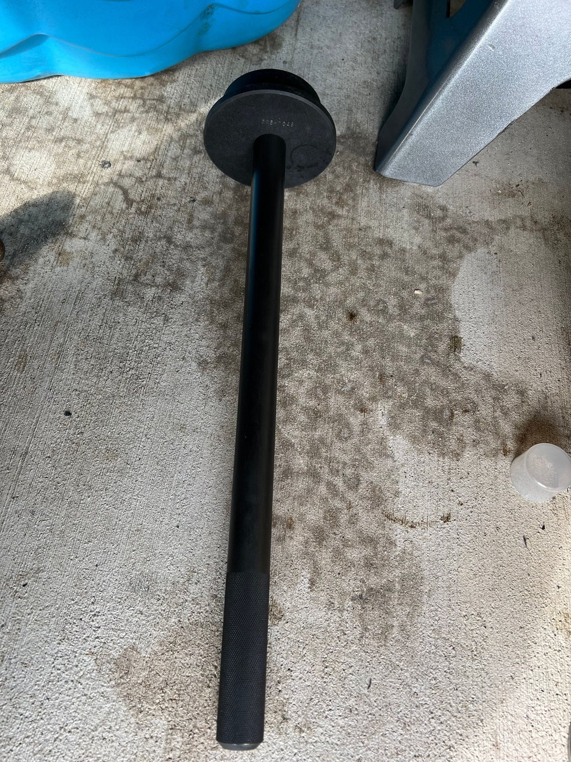

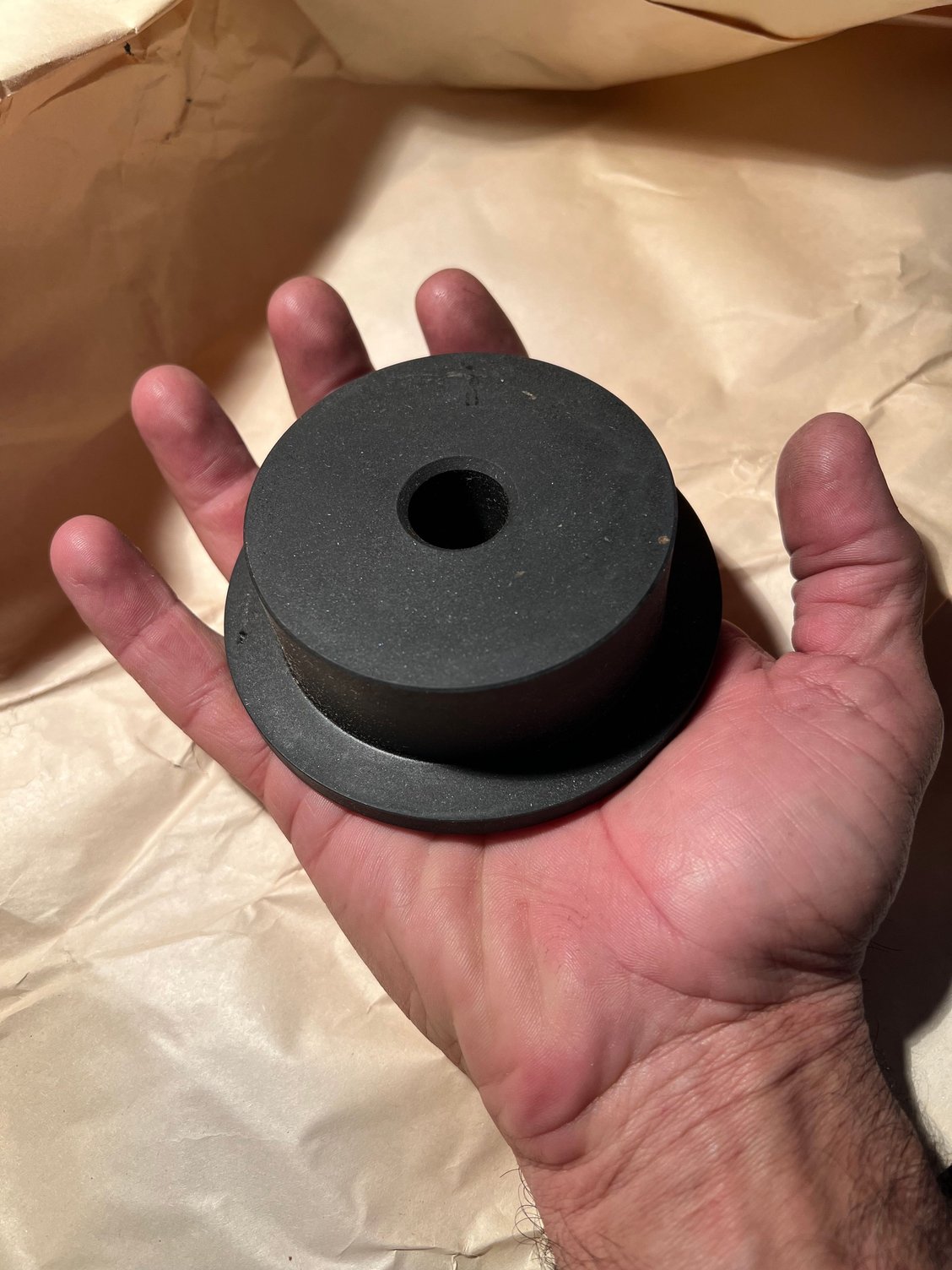

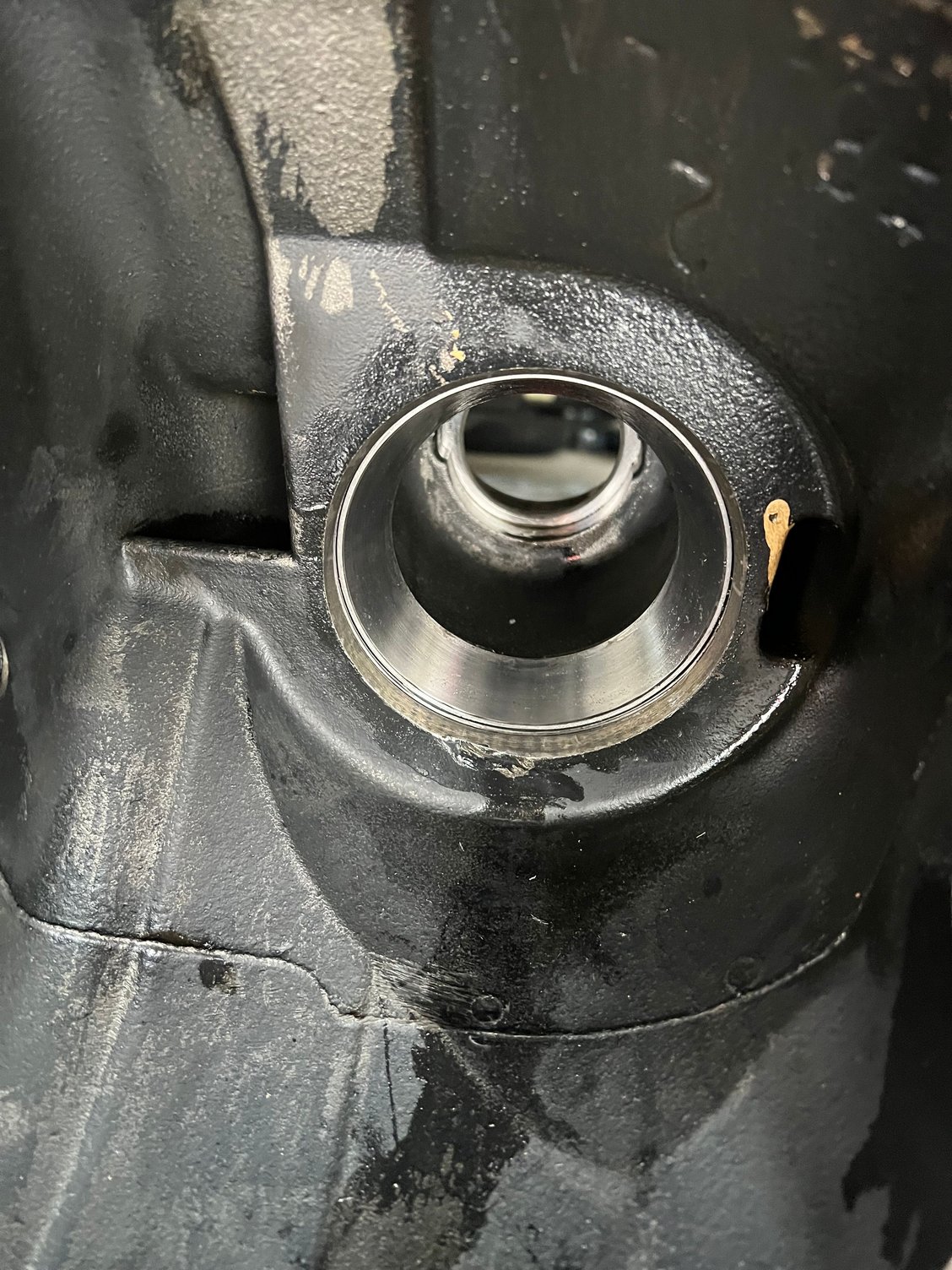

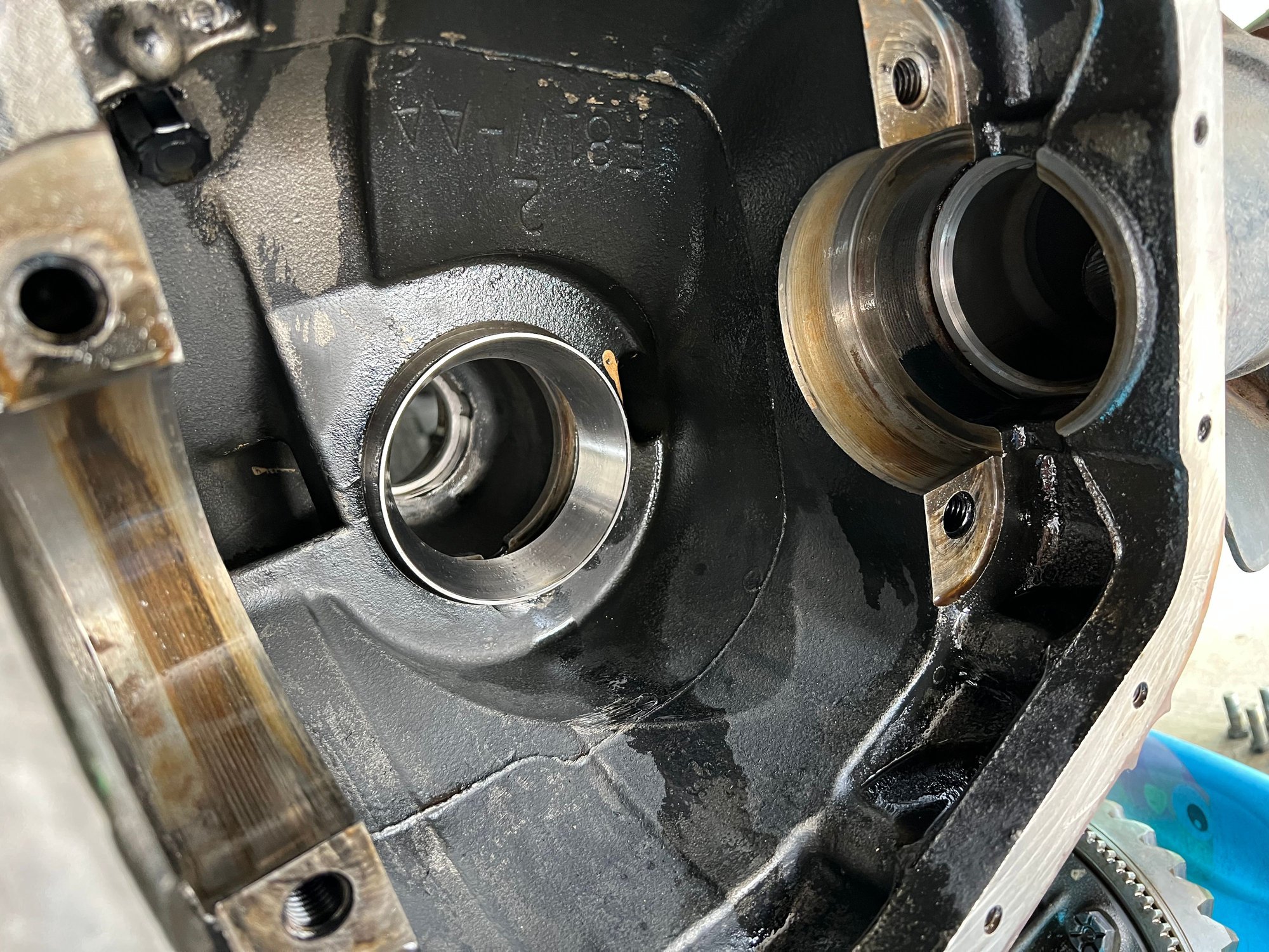

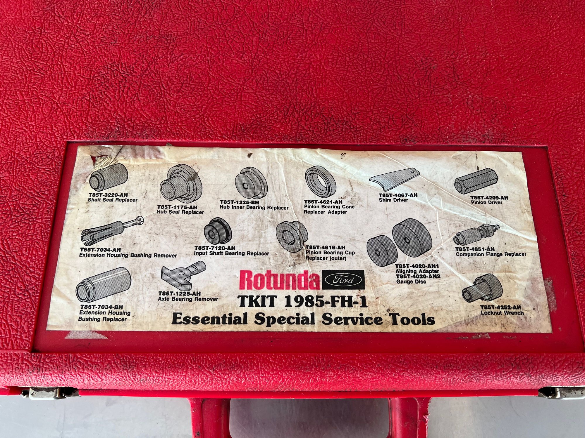

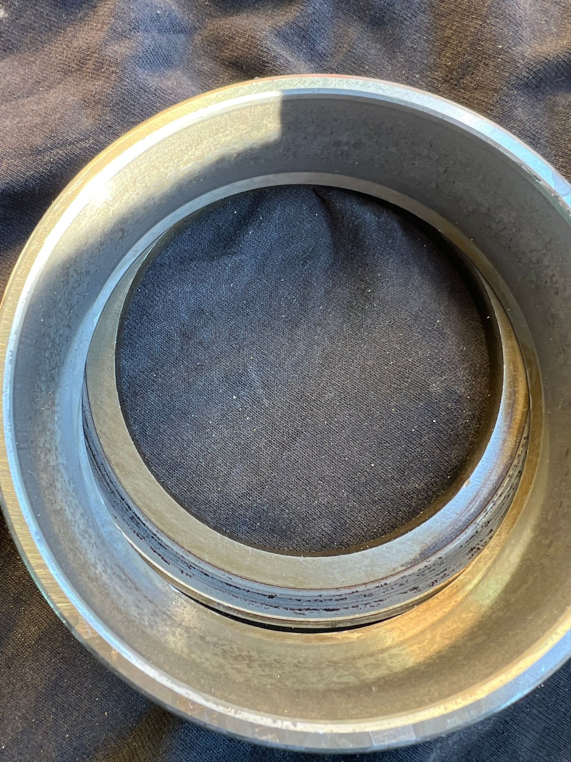

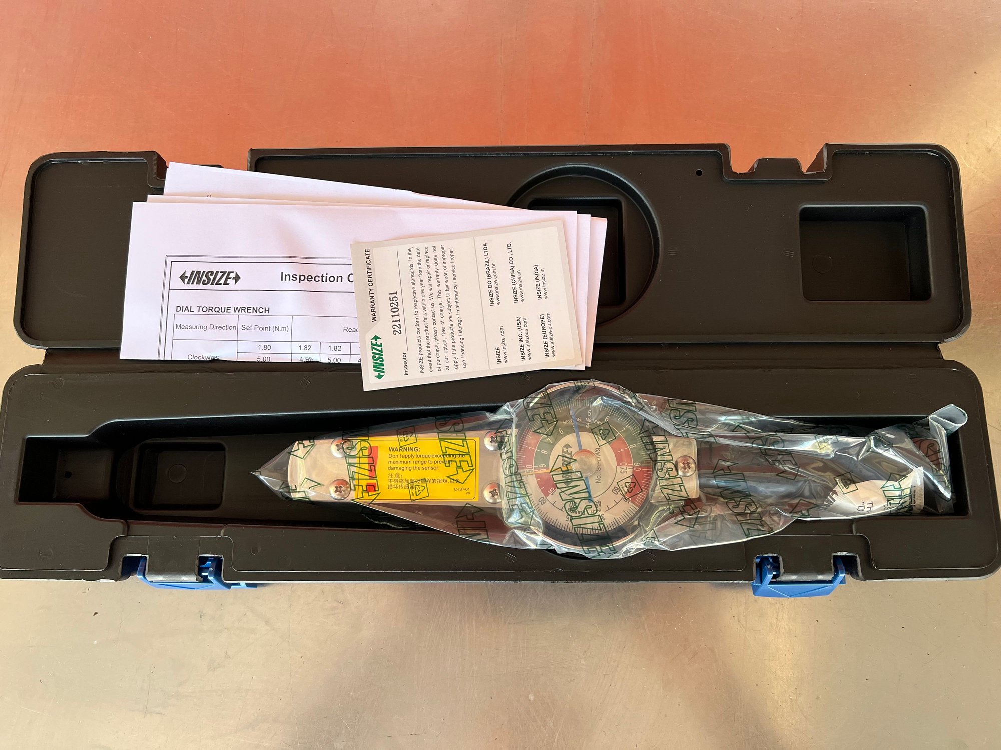

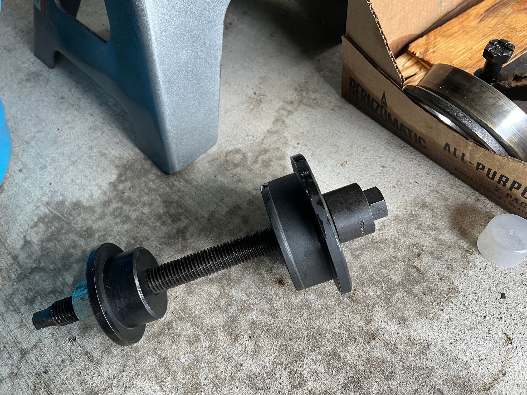

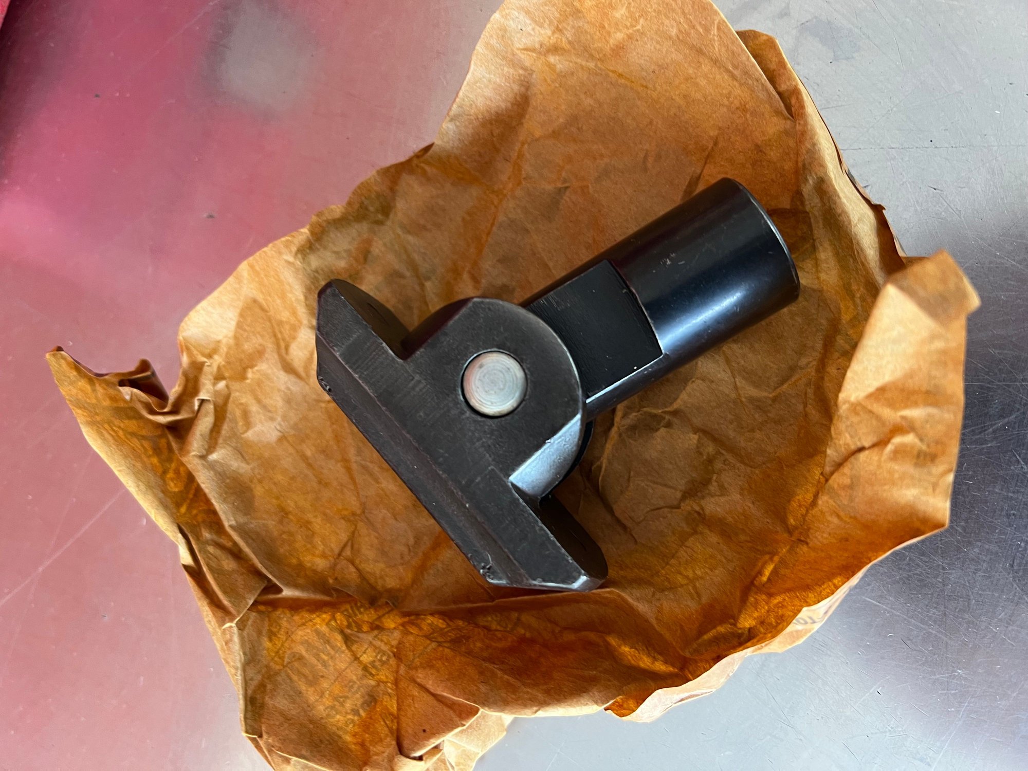

Didn't make much progress today. Ran to town, the post office for one of my tool orders, (sig required), received other tool deliveries (lots), and the press arrived today. Got the large pinion race installed, then put together the press, surprise, nowhere was it mentioned that the press was shipped with no hydraulic fluid, I think I have some.
The large bearing race installer can be used with one of the OTC driving handles, I have the long, waiting on the short to arrive. Because I was in a sitting position, it was tough to get the race to bang in straight, it kept going in crooked, so I switched to the OTC draw bar that I also bought, and installed both race drivers and draw bar between the races, and drew them in to their seats. Went in very smooth. Tomorrow, I should make some progress, the large bearing needs to be removed from the old pinion to see if there was a shim between the bearing and stop on the pinion. Then I can prepare the new pinion for installation. I am still waiting on one more Rotunda axle service kit to arrive.
I do know there are several shortcuts, I have watched many videos of the 10.5 being rebuilt. I chose to go the shop manual route with as many of the OTC tools I could round up as I have never done this before. Going forward, I will learn the the shortcuts as I perform the work based on the shop manual.
Bearing seal plate, T75L-1165-B, (205-090) Aftermarket
OTC large handle D81L-4000-A (205-D055)
Differential Gauge Handle T76P-4020-A11 (205-111) Aftermarket
OTC Large pinion bearing cup installer. D81T-4616-A (205-D049)
OTC Drive Pinion Depth Gauge. (205-423)
OTC Draw Bar T75T-1176-A, (205-098), Carrier bearing remover set 205-S419, Collets (205-430), sleeve (205-431), Step Plate (205-432)
OTC Axle Bearing remover T85T-1225-AH (205-224)
OTC Draw Bar, T75T-1176-A (205-098)
Universal Bearing Puller D84L-1123-A (205-D064) Aftermarket
Differential Carrier Bearing Installer D81T-4221-A (205-D044) Aftermarket
OTC TKIT-1985-FH-1
OTC TKIT-1985-FH-1
Rotunda T80T-4000-A Kit
VEVOR Carrier & Pinion Bearing Puller, Compatible with Dana 30,40,50,60,70, 80, Ford 10.25" Bearings, Pinion Puller Tool with 3 Clamshells, 45# Steel Clamshell Bearing
Eastwood 12 Ton Floor Shop Press
1/4" drive Inch Lb torque drive by Insize.
2-3" micrometer
Race Started
Large race installer with ram handle
Draw bar with both race installers
Installed race.
