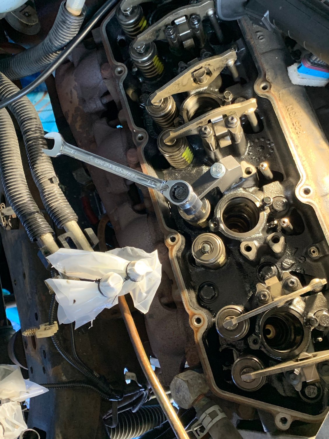

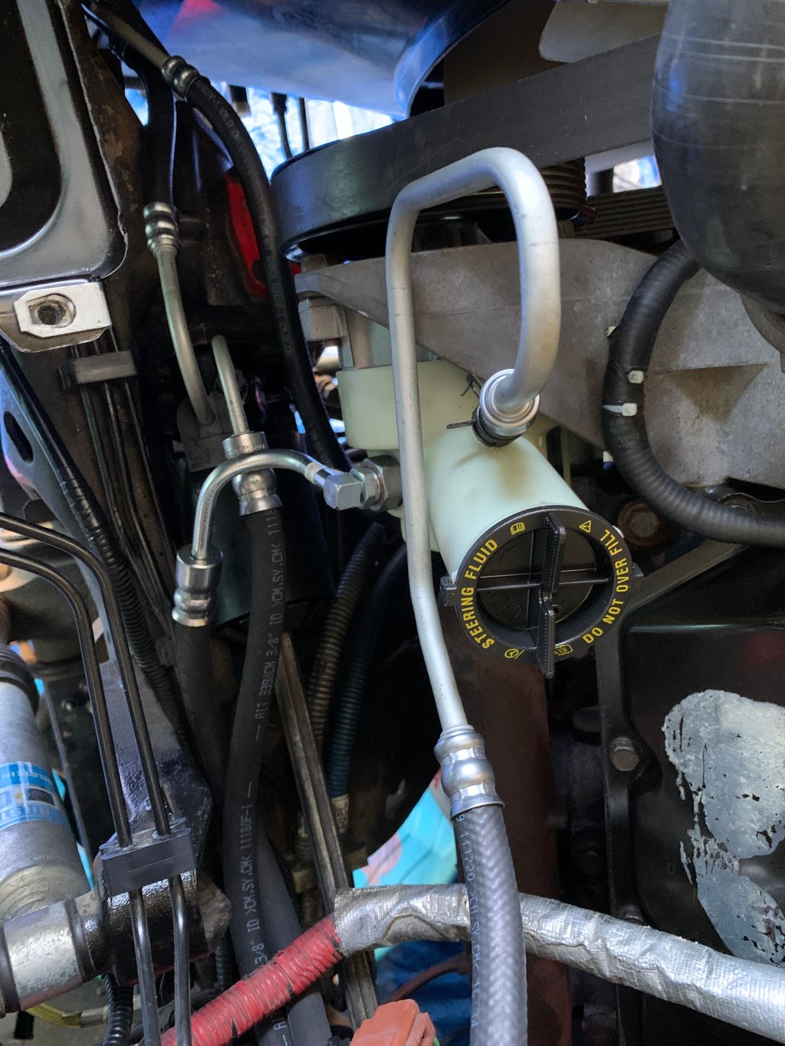

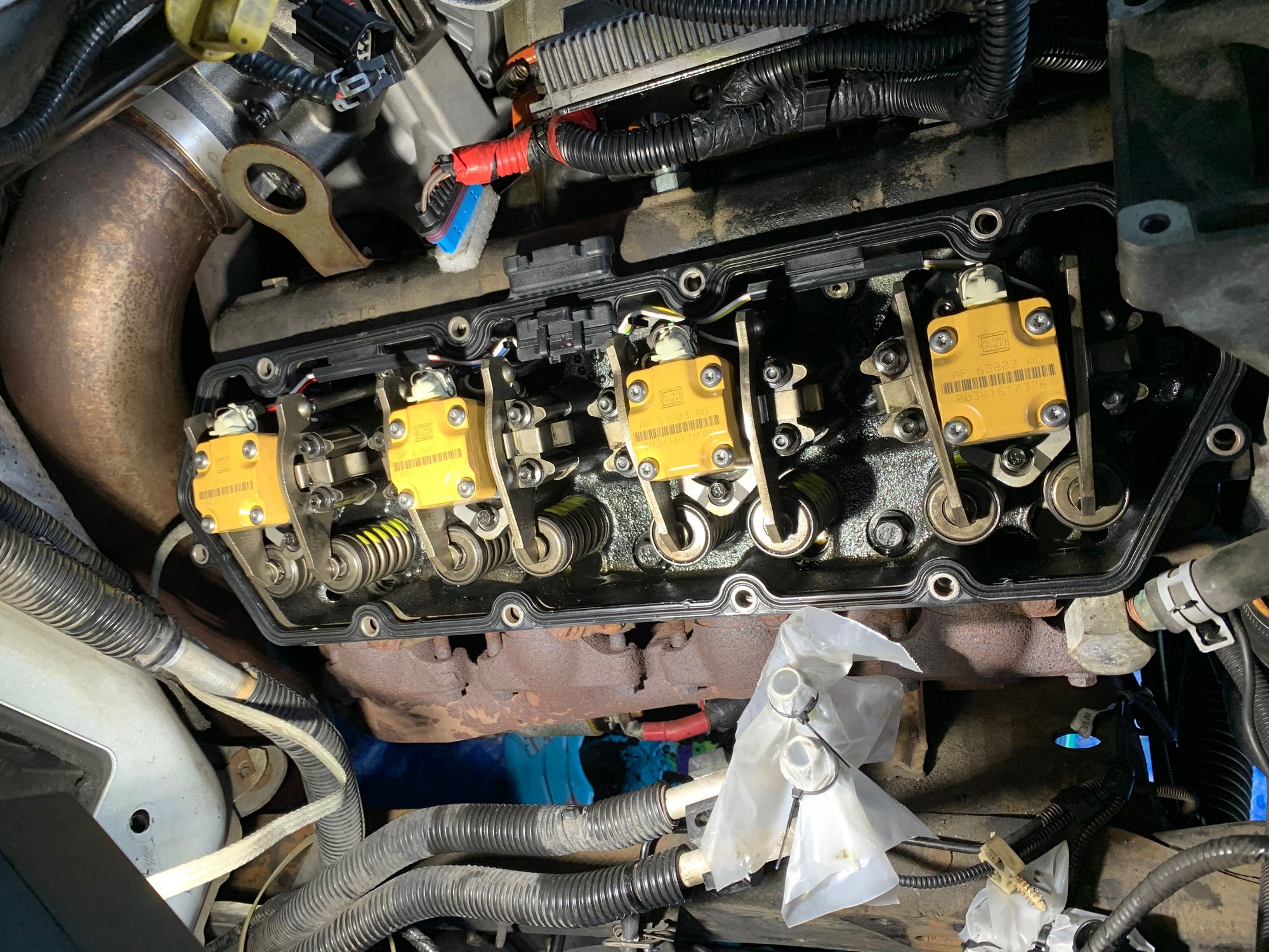

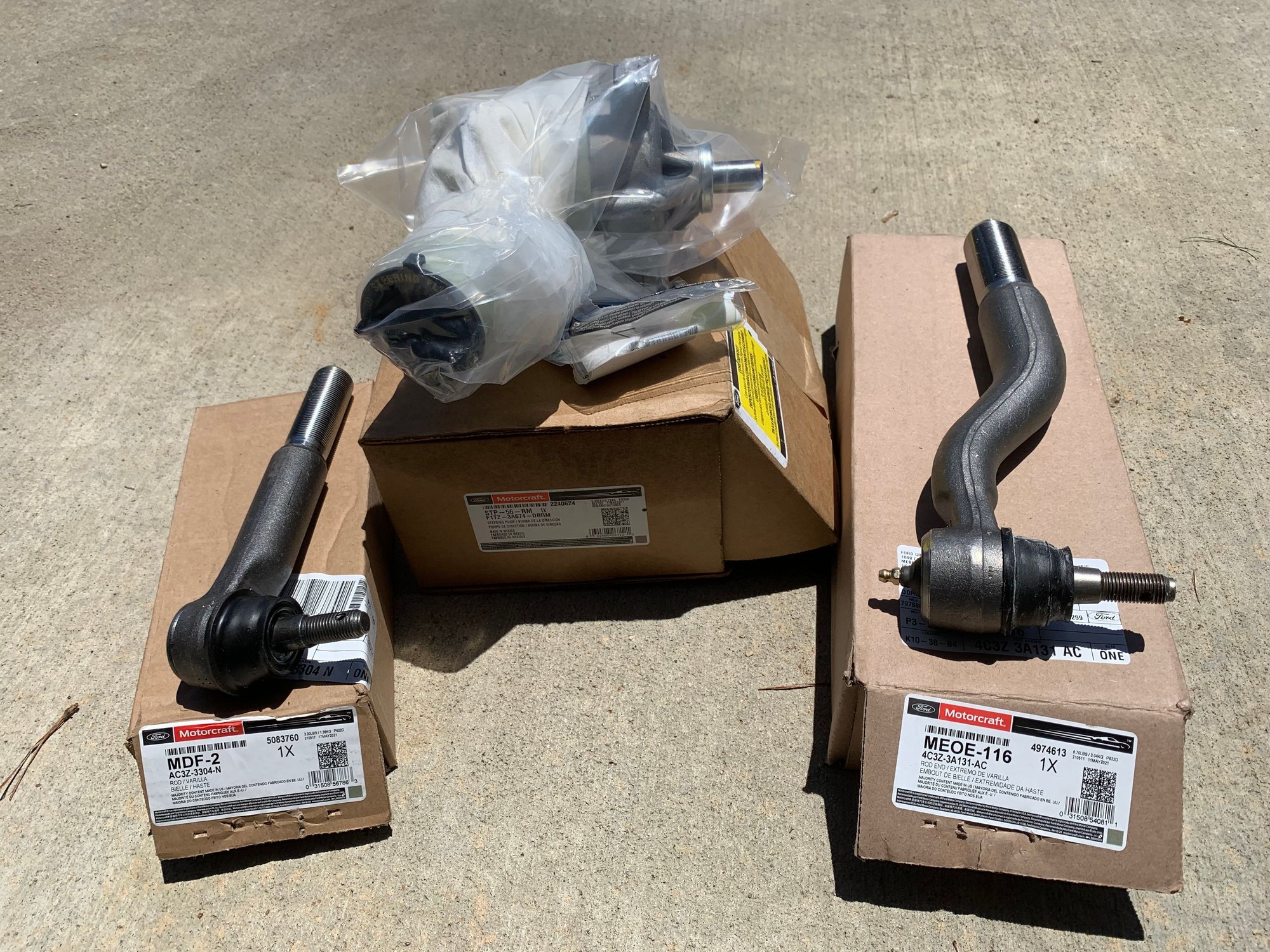

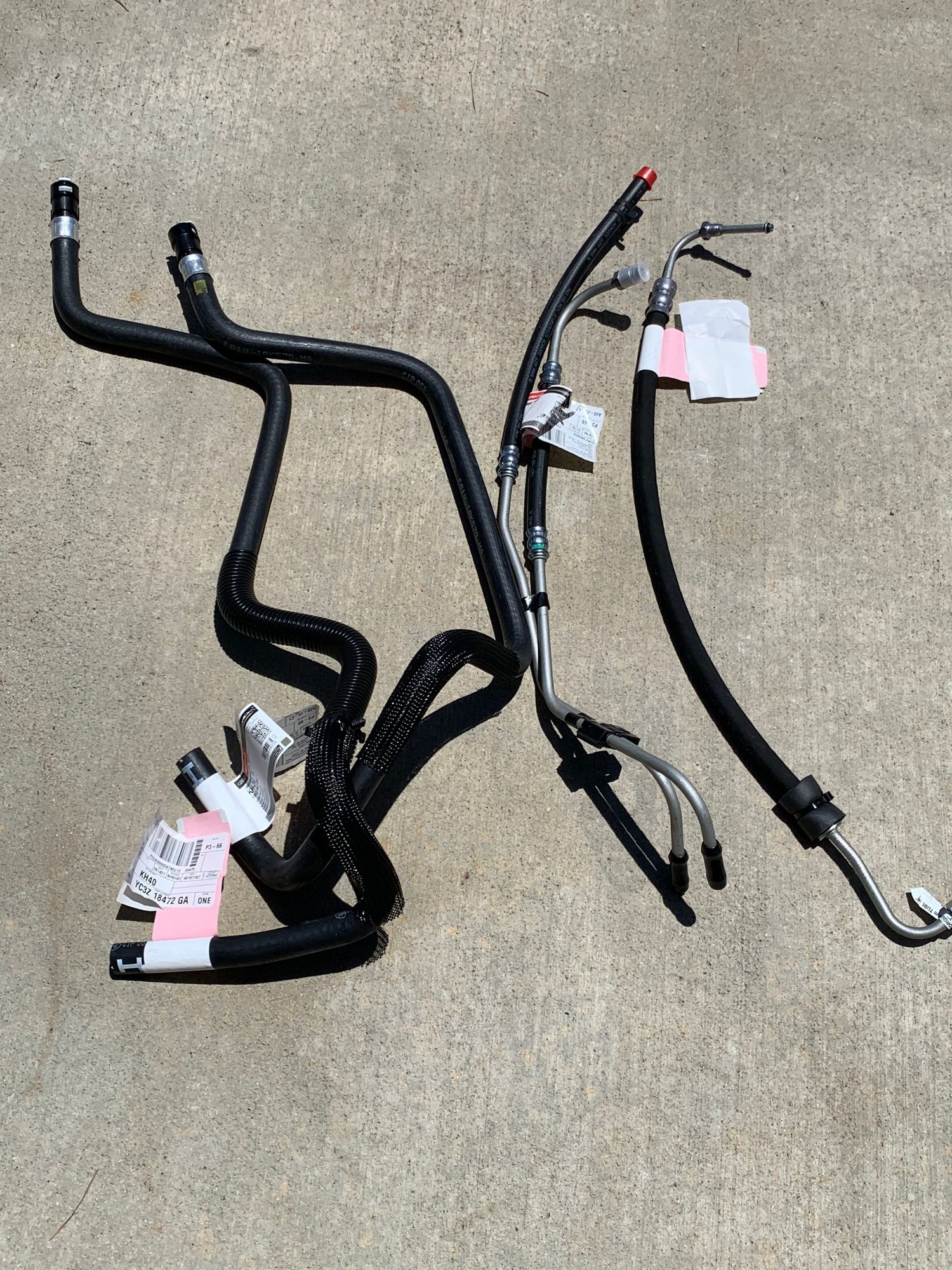

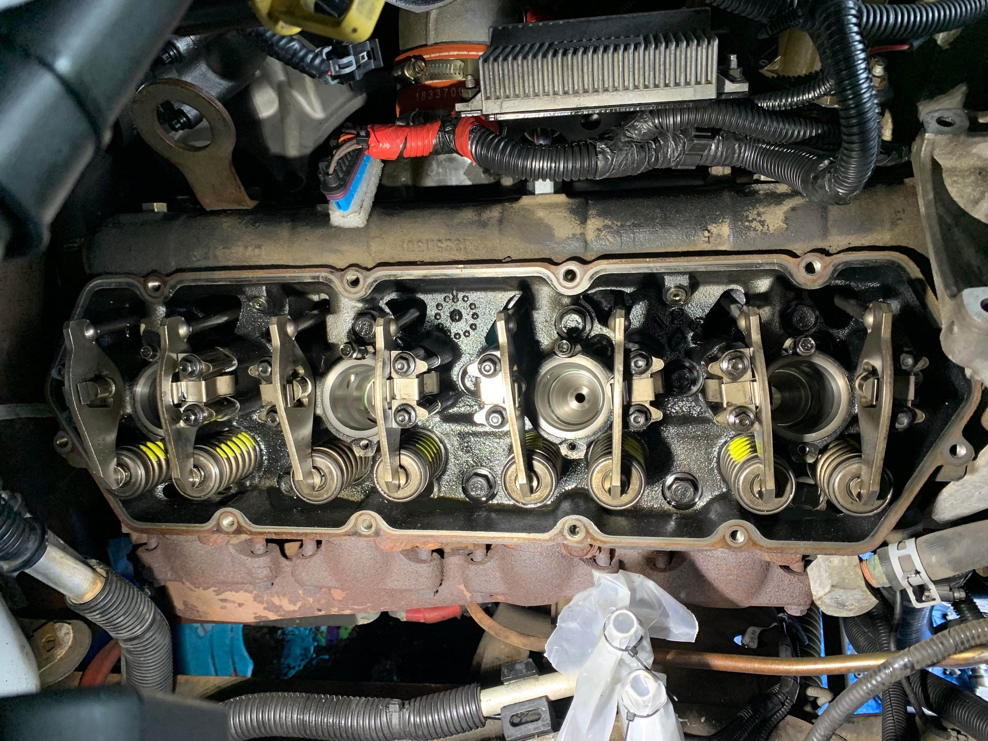

I think all of the stuff I've ordered, and plan to replace is finally here. I'll possibly be wrapping this up by the weekend. Got all the pass side injectors installed today, the cups have been in for 3 and 4 days, this Tuesday and Wednesday I had to remove all of the valve springs and shim them, long story, but I had passed on using them, but installed them after talking to Clay at RiffRaff. New power steering pump and all the power steering hoses are installed, heater control valve is installed, have a few new rubber heater hoses to install too. The steering linkage parts I may have a truck shop install, then align not sure yet.

If you want, now's a good time to add some padding to that 90 degree fitting on the pump - it can rub on the CAC pipe.
I had some superficial damage to the sound insulation on mine, but some have had it wear a hole. I used an old ignition coil wire boot and zip ties to protect this area. You can also use a Dorman 47028 elbow.

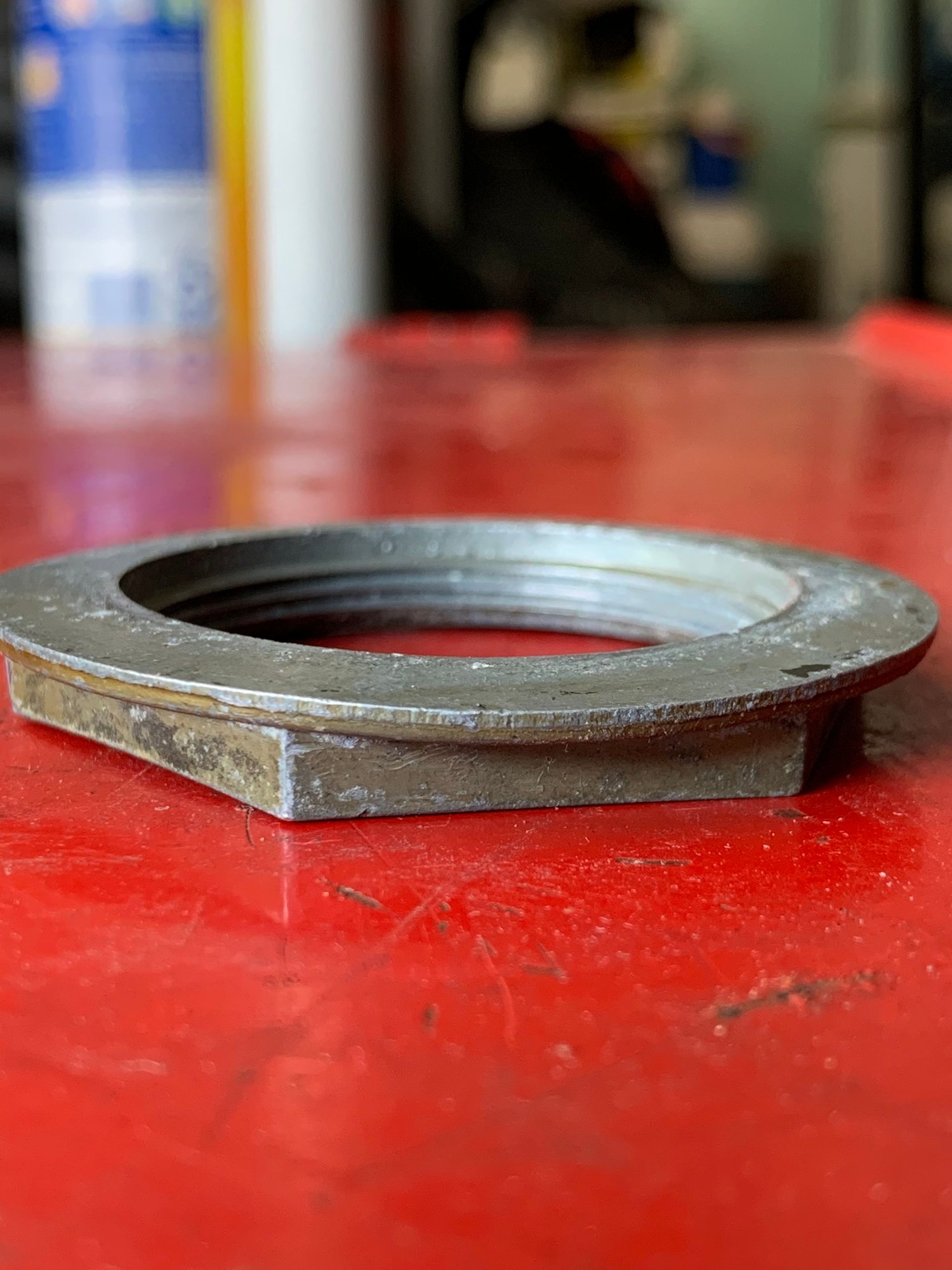

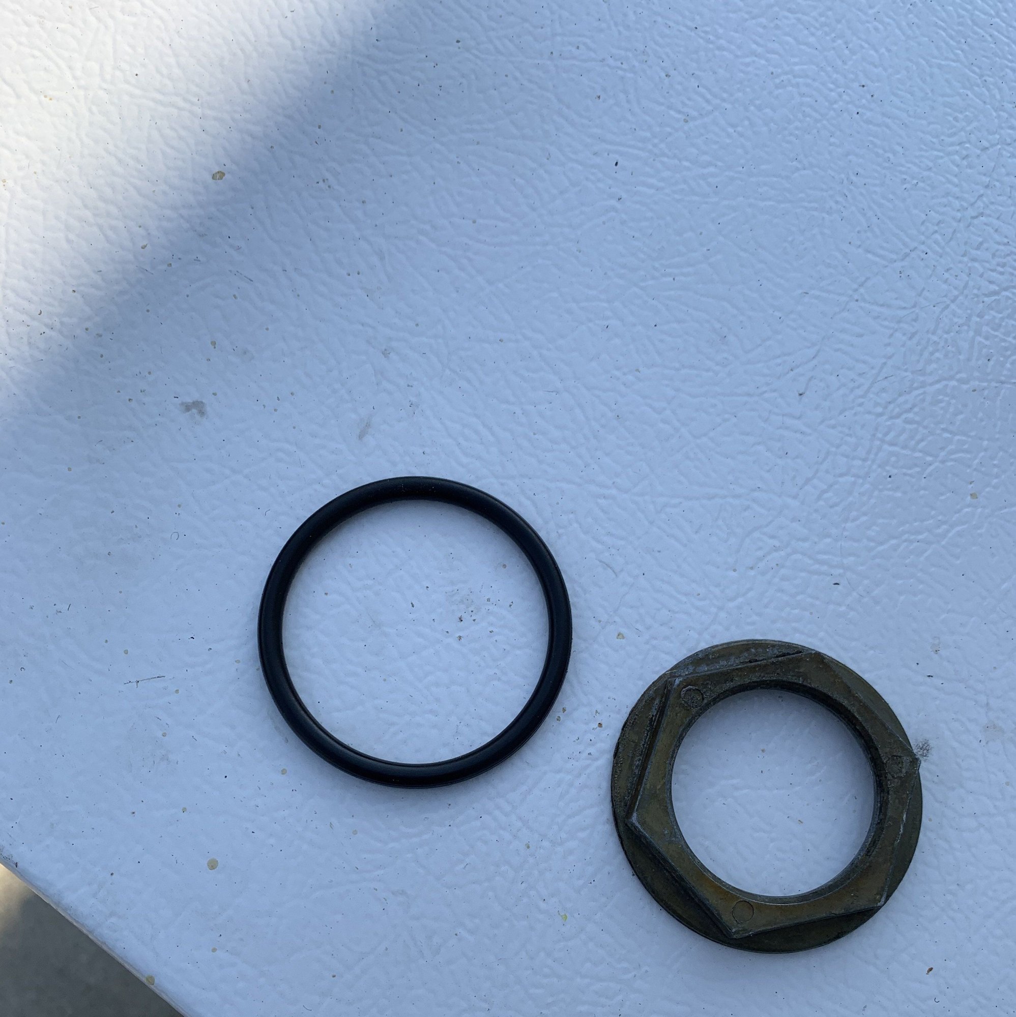

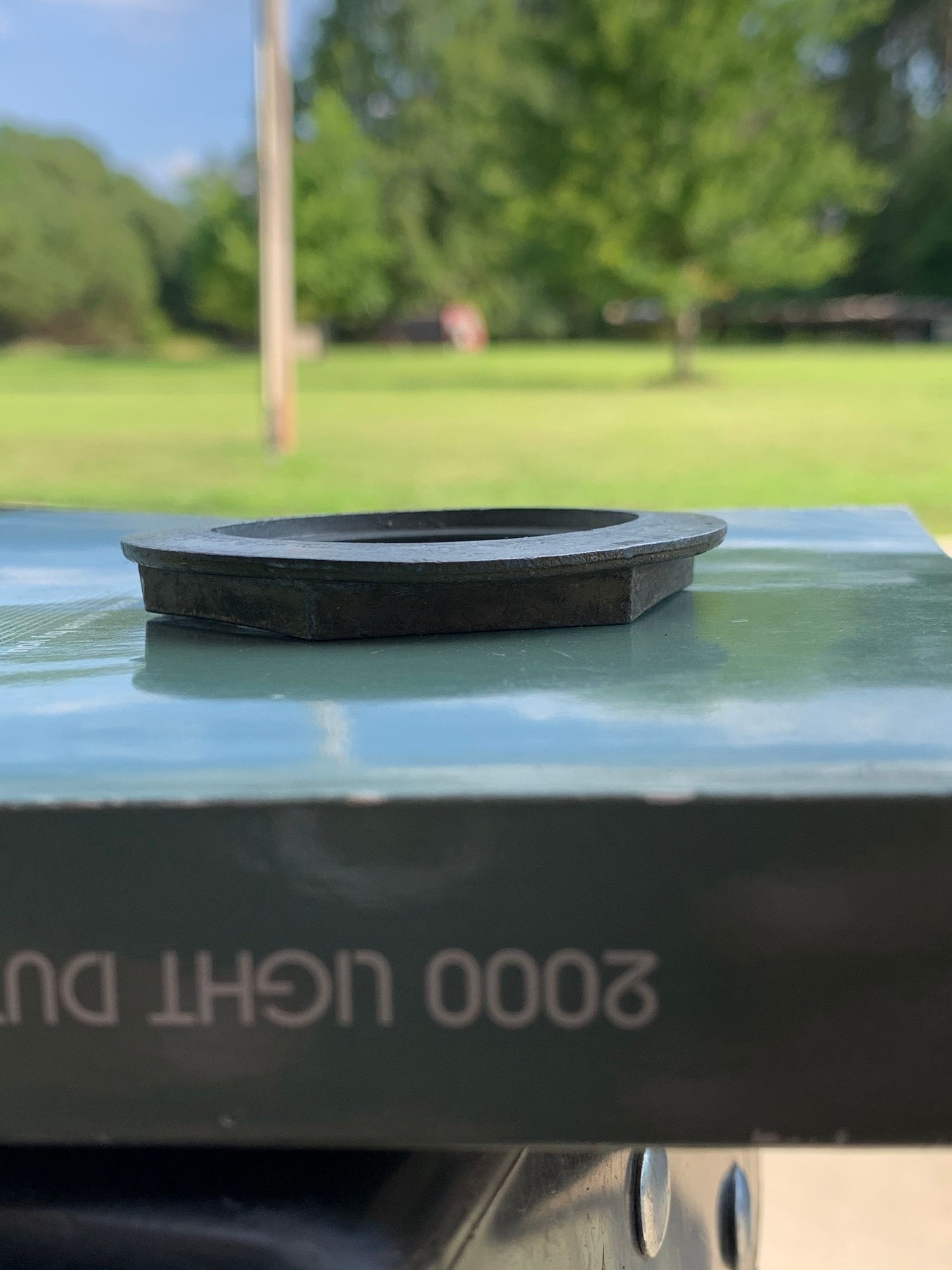

After my struggle to remove the dipstick tube nut securing it's welded bracket to the valve cover stud, I noticed that the tube adapter at the oil pan was now loose, never a sign of oil leak there either, I inspected the adapter, proceeded to snug the 2" nut, that didn't work. The internal adapter fitting and O ring were allowed to fall back and rest on the edge of the pan baffle shelf while I inspect the nut. This ended up being another discovery of definite failure like the injector cups. The nut is heavily distorted, I'm guessing someone has tried to tighten it in the past, or the factory just over tightened it, so I retrieved the swollen O ring, and sent the internal adapter to it's grave for the next few years. After looking at a few options including an external weld on type, I just ordered the Strictly Diesel adapter for now. Meanwhile I'll button up what I can.

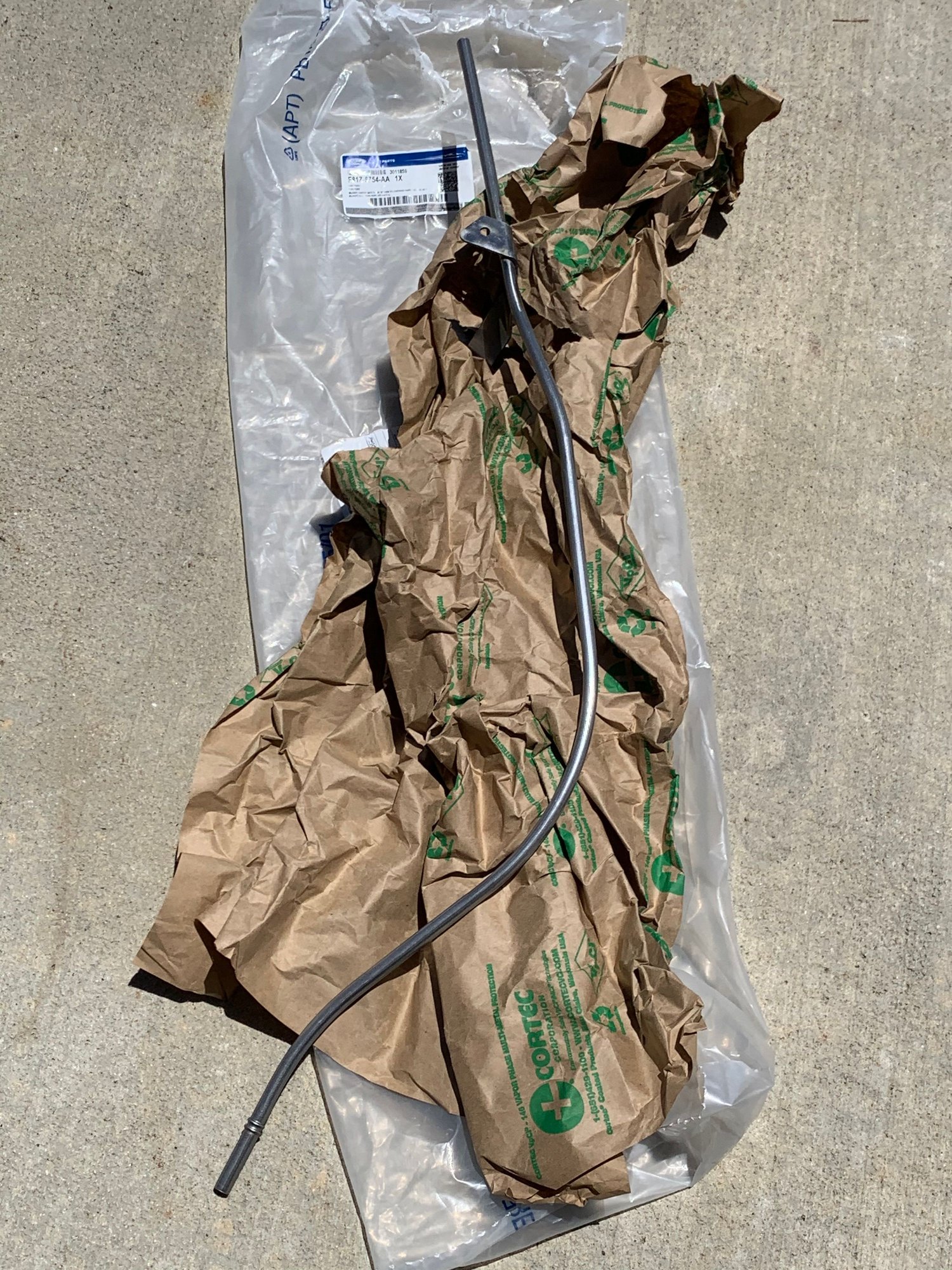

Dipstick adapter arrived today, and already installed.

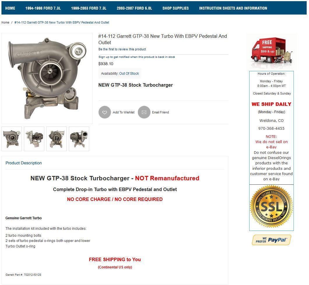

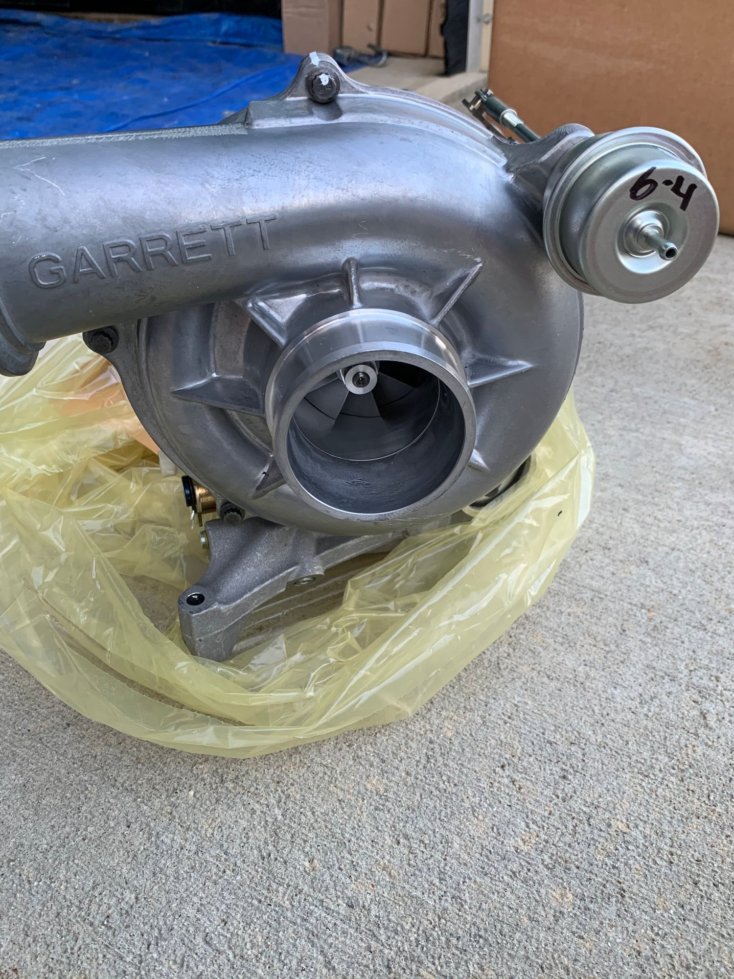

Talked to Bob @ Diesel O Rings today for an hour, was going to buy the GTP-38 cartridge, but they have a new from Garrett, a GTP-38 with EBPV pedestal OE turbo that I purchased today. So I will end up with a brand new OE turbo and pedestal and leave it there.

The one I bought from KC is a stage 1 with the .84.

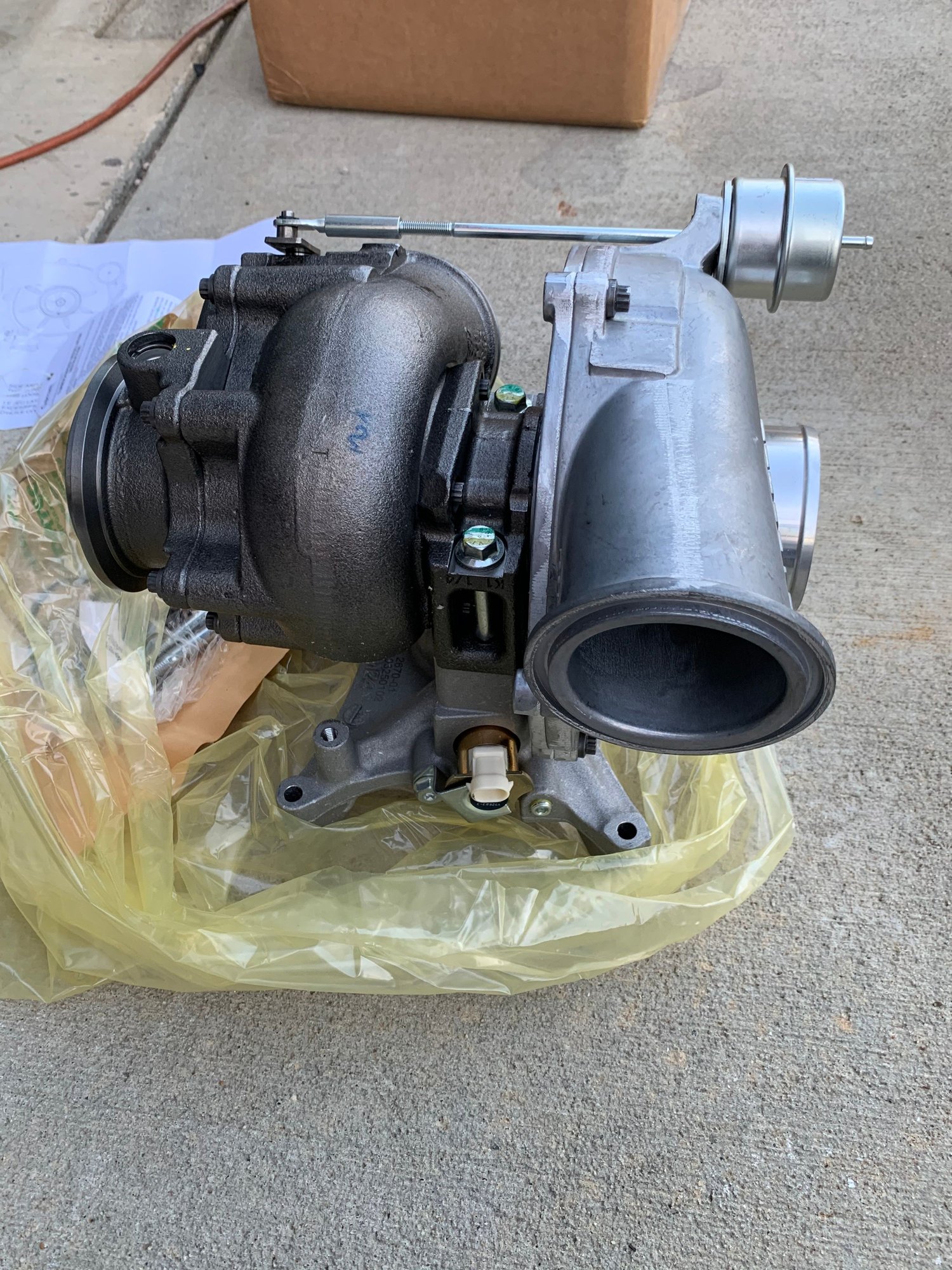

The last one pictured, which I did not have a chance to install this weekend is the OE Garrett.
