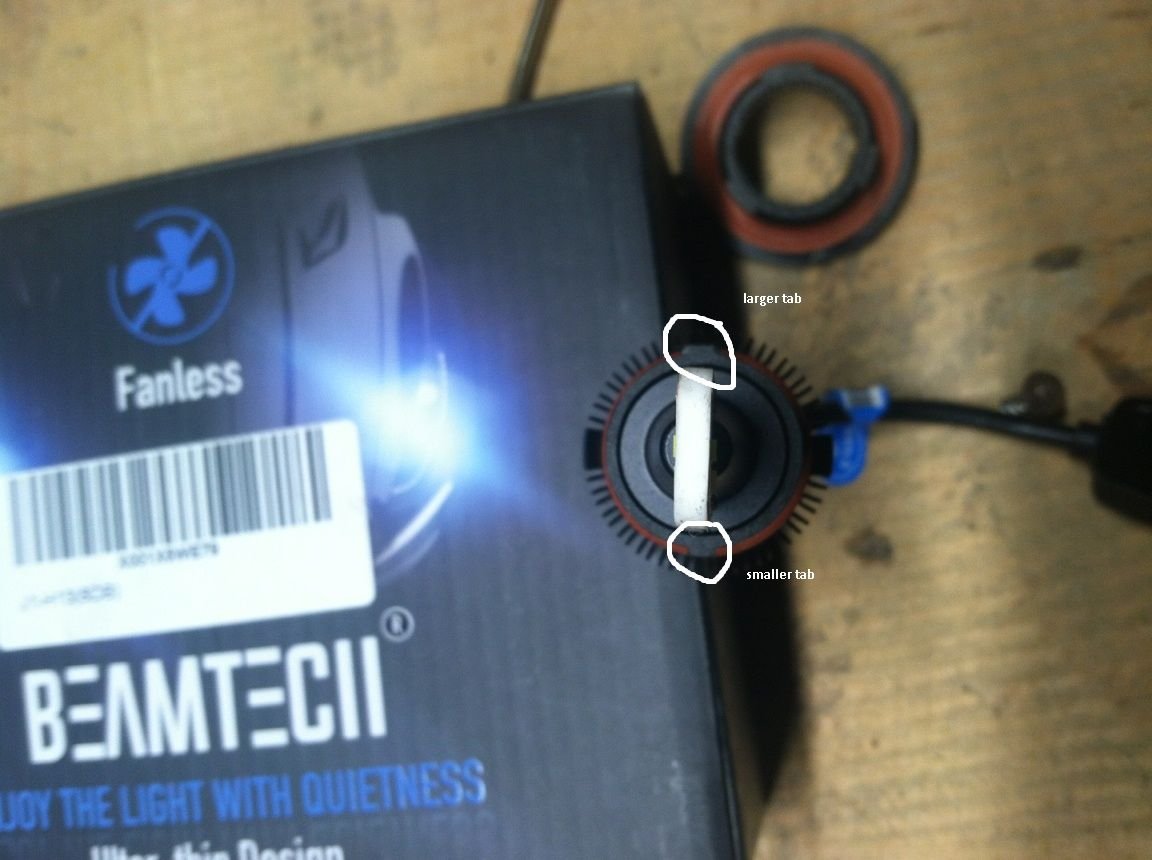

I have rotated my led bodies 90 degrees. The best I could do so far was shine the lights on my garage door to see the improvement. I can't road test until it's dark.
I DO NOT recommend buying the J1 H13 bulbs for a Super Duty vehicle. I will make another post with pictures. If I try now it deletes my text. I DO recommend removing the front grill to work on the lights. Yesterday I installed them by reaching behind the lights, that was a royal pain in the ***, and my finger tips still ache. Today I removed the grill. It was an easy removal and made the job MUCH easier. I do have the front camera and a washer line, they both unhooked at the grill once it was popped open.
To take pictures, I removed one light assembly, it will be the first picture. The second picture will show the led body separate from the screw in part. There are three tabs, 2 the same size, the screwdriver is pointing at the larger tab. SO, that part can only go into the headlight fixture one way. Inside the circle I drew 2 red arrows at two channels the led body slides into. The third picture I circled the two tabs, it may be hard to see, but one is larger than the other, so the light was designed to go in only one way. I had to make it go in the opposite way in order for my lights to work properly. The body goes into the circle that tightens to the light housing, and because there are two tabs, it only rotates 90 degrees. Installed the way Beamtech made the light, it was upside down. So I had to force it in the "wrong way" in order to make the body position up and down with the high and low elements aligned properly. For this reason I do not recommend the J1 style of H13 bulb. Go do Beamtech.com and you will see the difference J1 vs S1. That being said, I do not have any radio distortion, and they change back and forth from high to low beam just like the factory lights did.
Hopefully this helps someone else out before you buy these bulbs.

pictures to go with the prior post
