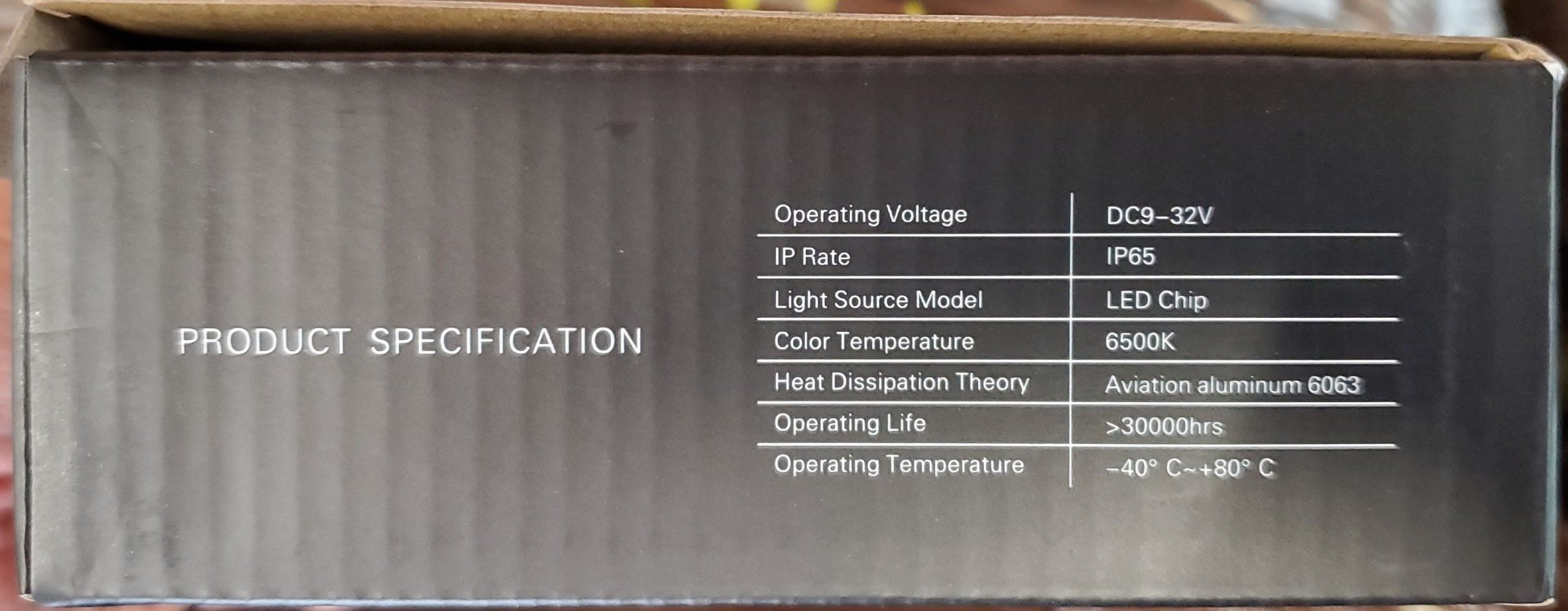

Originally Posted by my_crib_too
Anyone else know what the differences are between these two outside of lumens?
Bruce
I was wondering the same thing ,when Poncho did his maybe the 8000s were the only ones out in the h13 from beamtec .
Maybe google or another search outside of this forum might shed some light .

I went to their website while they do have 2 different h13 bulbs both have the same specs ,how ever one has a bigger heat sink and works better with ecu controlled headlamps but both show the same lumens on their site .

The 8k lights look to be previous gen SMD type LED’s The 10k lights look to be the current COB type, which are much brighter and more efficient.

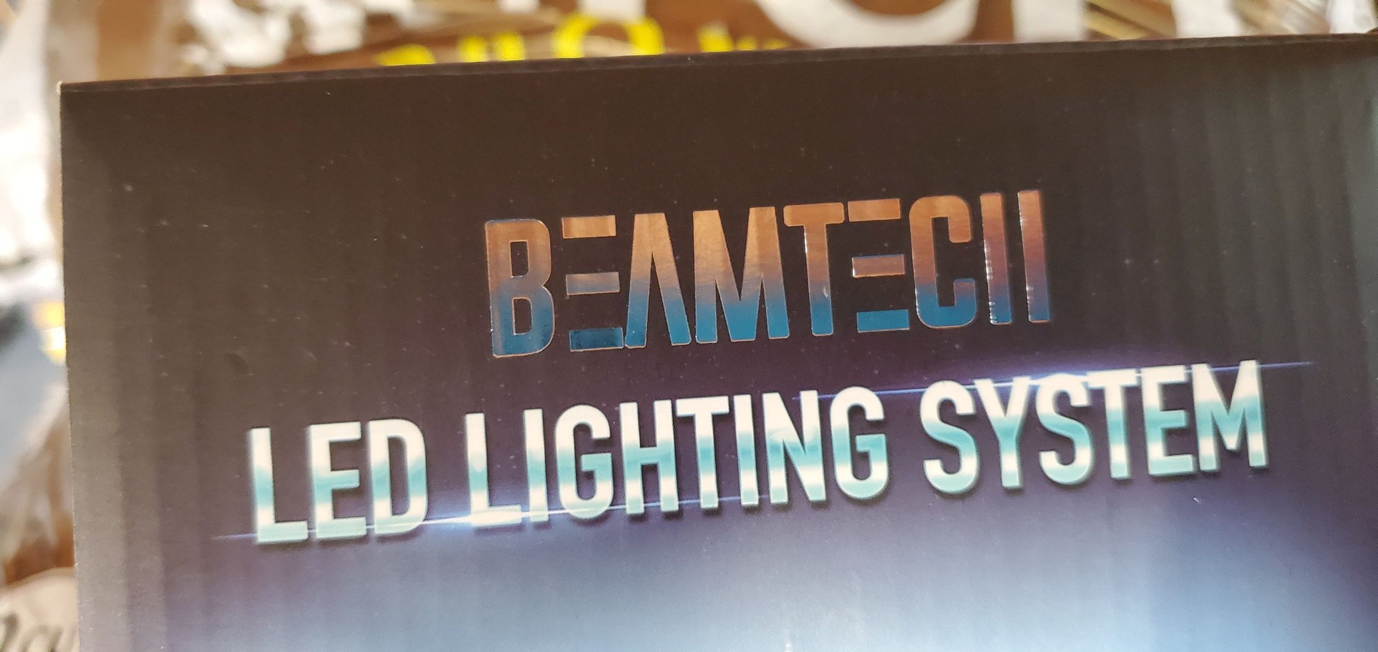

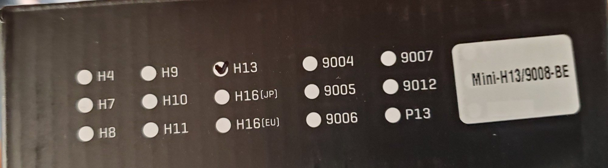

Amazon has two styles of Beamtech H13 LED Headlights. Which one is most correct? Are both plug and play without having to purchase extra resistors or harnesses? Reprogramming?
Bulbs,6500K 10000 Lumens
Bulbs, 6500K 8000Lumens
This is my understanding, Clocked at 3 and 9, I need to order 4 of them, installation is about an hour without having to take the entire front of the truck apart. Anything else that I need to know about these style bulbs. I already have read about, installing the factory LED Option and LED in a non-LED light is bad.
2019 F250 Lariat.
Bruce...
Originally Posted by DEW34
I found the 10,000k bulbs on beamtech these are the ones with the fan in the base , you have to go to their site look in the top right corner for the magnifying glass icon type in h13 and the 3 bulbs they make will appear . 2 8ks 1 10k I think the 10k bulbs could be the older design .
Installed the 10K bulbs this afternoon and I am impressed. Way better than the factory lights. No flicker or radio interference. They really light up the space in front of the truck. Nice, sharp cutoff line too. I like them after a 20 minute drive.
I din't take much apart on the truck. The air snorkel on the passenger side, that's one plastic clip and nothing on the driver side. Thumb hurts because some were difficult to turn to get out. Thanks to members here, I knew to look for the red washer that sticks to the light fixture from the old bulb. Had to clock three of the four bulbs to get the desired 9/3 position. I'll update after I use them more.
