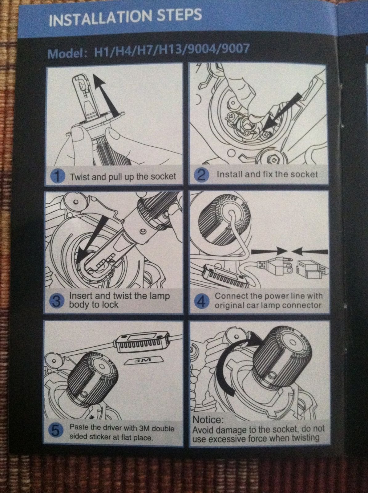

another page of Beamtech directions
The picture in step 2 is confusing to me. Now looking back, I see they have you remove the body from the socket and screw the socket first into the headlight housing, then install the led body into the socket. This gives me hope that I will be able to rotate my led bodies without unscrewing the socket. The "socket" does not show accurately, it has two tabs like the factory bulbs, tabs that are used to twist it clockwise into the housing. I now wonder if screwing the socket into place without the body installed would have been easier? At the time I made sense to me to install it all at once, thinking that once installed the body could not be rotated, especially after seeing how difficult it was to get it fully seated.

Those round cooling fin bulbs are a Different animal than the Ovals we’ve been installing.
If you install the Ovals as an assembly with the flat exterior part of fins at 3&9 o clock then it’s Correct.
no need to mess with the Allen Screw.
