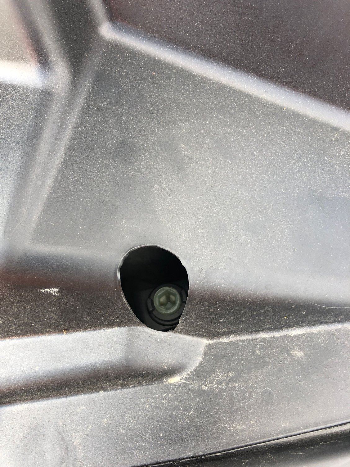

When I carry weight in the box, I get flashed. How would I adjust the headlights down when I do this?

Turn the headlight adjusters "down", or clockwise 1/2 - 1 full turn with an appropriate sized flat-blade screwdriver. This should amount to an approximate 3/4" - 1.5" drop at 25'.

Adjustment screws down in the hole pictured. Plastic phillips head. The procedure is in the owner's manual. Tells you where to mark a wall, garage door, etc. and how far back from it to be when making the adjustment.
