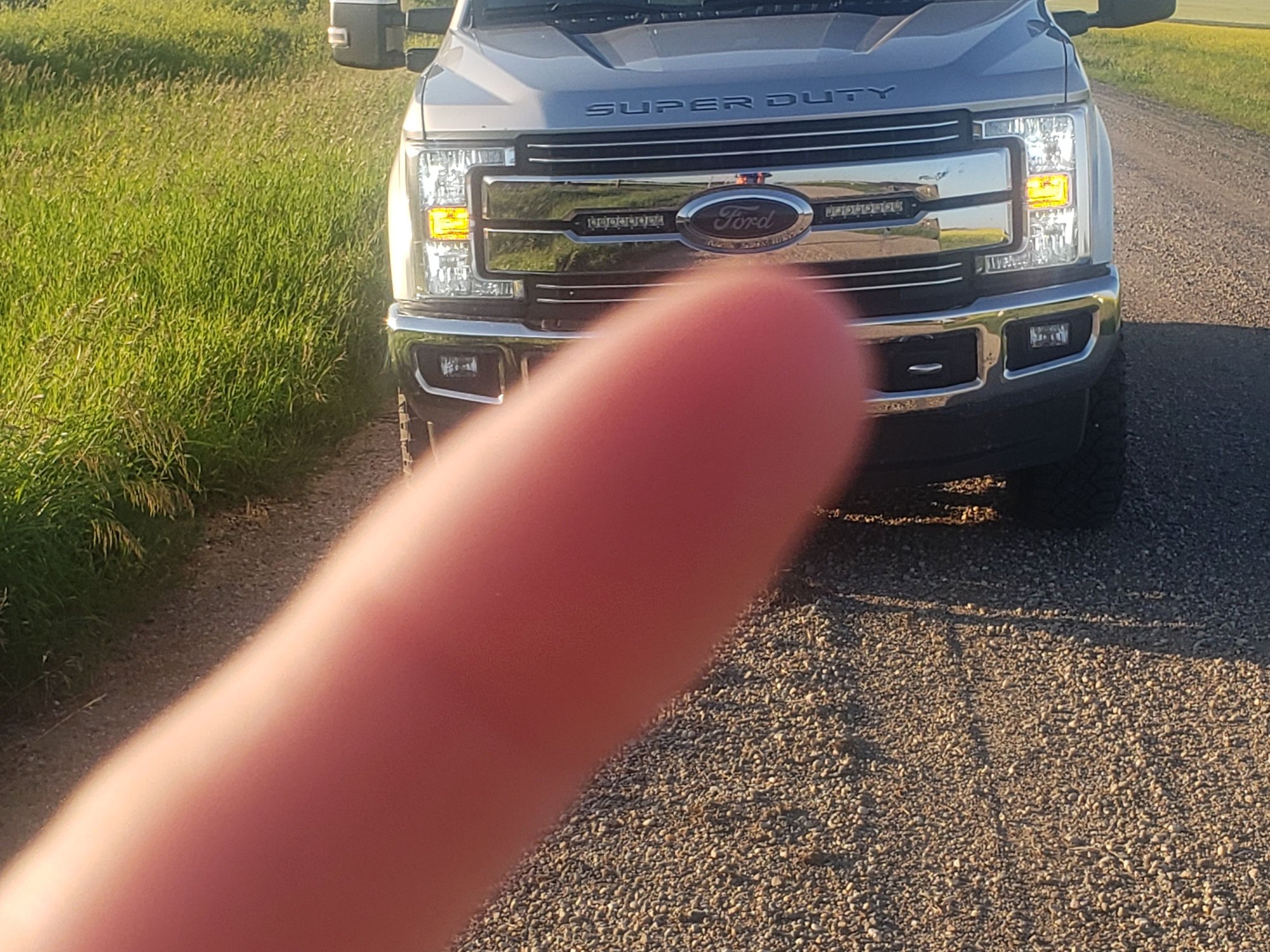

Pic of switchbacks with Beamtechs with headlights on/
second pic is hazards on. Look yellow in pic but are amber in person.
The switch back turn turn signals are a great look! Thanks for posting the pics!
